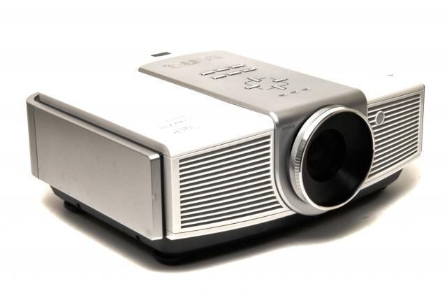

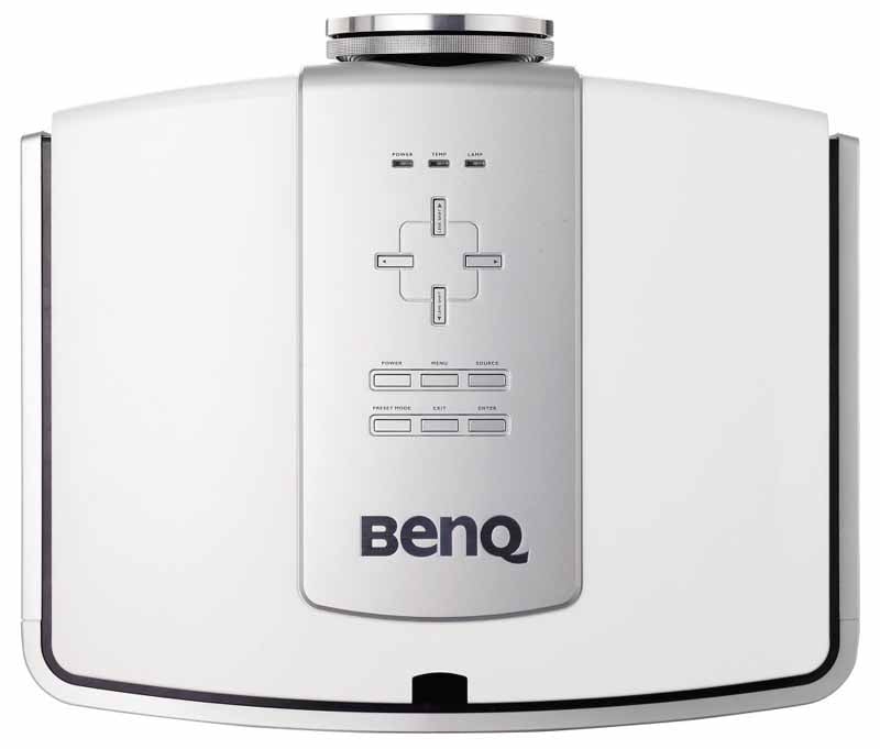

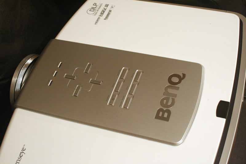

Physically, the W5000
is an impressive projector. While not exactly elegant, it is a true machine. From my first glance at its
exterior I had to pop my eyes back in their sockets when I saw the enormously
deceptive size of the lens hood. The W5000 exudes high build quality, from its
looks, to the 21 pound weight and convenient side-entry lamp replacement.
The top of the projector houses a real slick-looking control panel for menu, power, and source controls. You can also activate lens shift functions and toggle through presets. Three small lamps give you a quick overview of power, temperature and lamp status (you really only want to see one light on.) The enclosure itself is a beautiful mix of white and silver with some black trim thrown in for good measure. I'd easily cast my vote for having this thing show up as a small Decepticon in next year's Transformers 2 movie. Lamp access is via the left side (no need to remove the projector from its mounted position) and the filter can be replaced easily from the right side of the unit. Unlike most projectors I've seen, all four feet are adjustable. If you're not mounting this to a ceiling or other permanent fixture, however I think you'd be doing yourself a disservice.

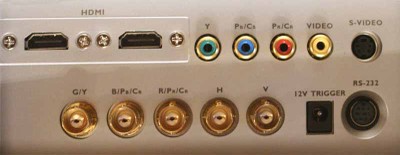

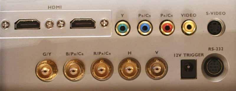

Connections
BenQ provides a pair of HDMI inputs and dual component video connections, though the second is a BNC-style RGBHV input. Composite and S-video are included and should never be used with a projector at this price point. The RS-232 connection is a funky 8-pin din connector that requires a cable in order to connect to most serial control devices. Finally, a 12V trigger allows the projector to control a drop down projection screen or other device based on the status of the W5000.
Dual HDMI, Dual component video (including 1 via BNC), 12V trigger and RS-232C control.

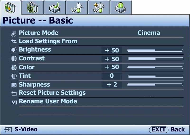

Picture - Basic
The
name of this menu section is accurate. It provides access to the basic picture
controls such as Brightness, Contrast, Color, Tint, and Sharpness. You can also
select the Picture Mode which is accompanied by any number of presets designed
to work well in different scenarios. As you'll see in our calibration section,
we highly recommend starting with Cinema Mode. Nearly any time you affect the
Picture mode you'll hear the rather "grating" sound of the powered
Iris system as it changes to accommodate the new setting.

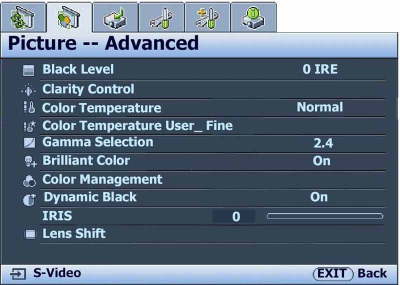

Picture - Advanced
Once
you are in the correct picture mode you can make many other adjustments to help
bring out the best picture quality possible. Black Level should be set to 7.5
IRE, not 0 in order to get the best response possible. We were not able to
achieve below black (blacker than black, or BTB) no matter what we tried,
however we weren't unsatisfied with our black level response. The Clarity
Control has its own submenu of four functions. Noise Reduction only works on
standard definition content (we recommend a setting of +2). Detail Enhancement
seemed fine at +1. Both Luma Transmission and Chroma Transmission looked better
to us in the Off (0) position, however it will definitely cause colors and high
contrast areas to pop. We just felt it added too much edge enhancement and took
away the film-like nature of the projected image.

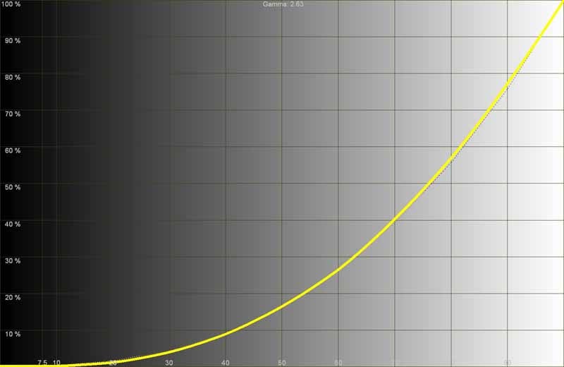

The Gamma can be set, and after calibration we did indeed achieve close to the 2.4 setting we configured. Brilliant Color definitely cause colors to pop, but we felt it to be a tad artificial and not accurate. Skin tones looked oversaturated. We left it off both during and after calibration. The saturation of specific Primary and Secondary colors can be dialed in using the Color Management menu system. We didn't go this far, and indeed our results didn't indicate much of a need to affect global color saturations. Dynamic Black controls the secondary Iris system. We left this off for calibration, but enabled it afterwards. Not once did we notice it engaging during normal use. Of course, with our primary Iris set at just +2 the secondary iris (Dynamic Black) was doing very little overall.
The last item on this menu (which can also be accessed directly via the remote) is the vertical Lens Shift which we found incredibly useful. The W5000 can go +120% and -80% vertically. In our inverted ceiling-mounted position that meant it had more negative (down) range than up. In either case, it's an ample amount of lens shift and should do well for nearly any installation.

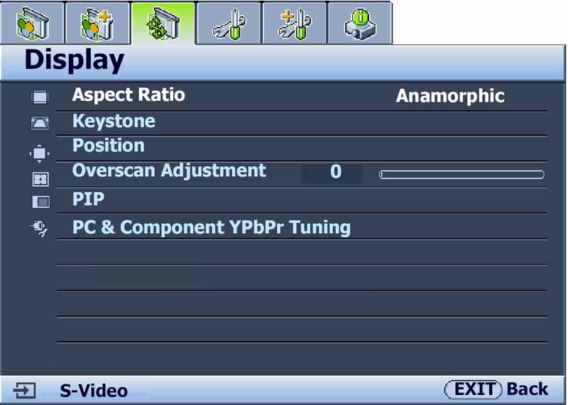

Display
The
Display menu is well laid out, however the Lens Shift would have been better
placed here alongside Keystone and Position functions which both digitally
alter the position of the image on the screen. Overscan Adjustment, as we
mention below, has a strange interaction with the Silicon Optix video
processing engine in that it needs to be set to +2 for best (smoothest)
deinterlacing response. We didn't notice any problems when progressive material
was sent to the projector. The PIP functionality is cool, however the second
source is only possible with S-video or composite sources. You cannot
simultaneously run two HD channels using the PIP mode. This is unfortunate;
however most of those with digital cableTV set top boxes will find they have
that functionality already built in.

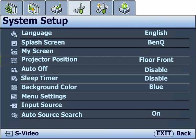

System Setup
This
menu contains the items which will likely be configured once and then never
used again. This includes the Projector Position, Language, Splash Screen
(which can be customized), Sleep Timer, Menu position and Auto Source Search. I
tend to disable auto source search, simply because the projector tends to freak
out when the cableTV switches resolutions - as it so often does when moving
between HD and SD channels. Custom Installers can use a laptop to set a custom
client screen with their logo (and perhaps phone number) as the startup screen.
Not a bad idea to make sure you get the follow up calls should your client
decide to do further upgrades.

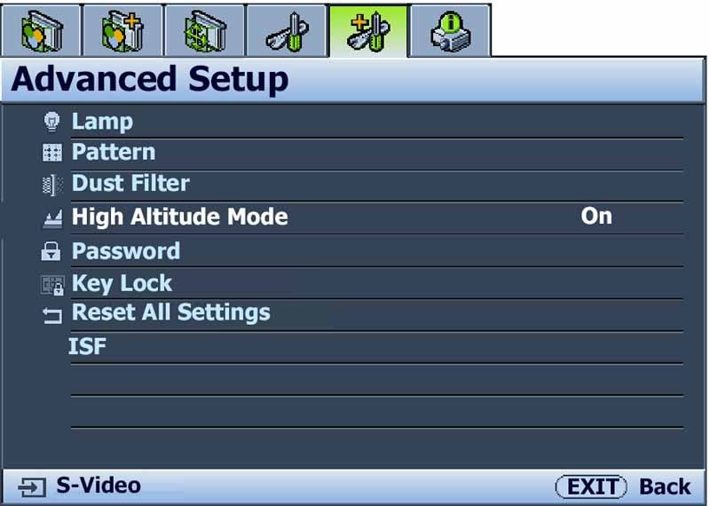

Advanced Setup
Advanced
setup contains such items as your Lamp Power level (we recommend Whisper as the
fan is noticeably louder with Normal
mode). You can activate High Altitude mode if you like excessive fan noise (or
I suppose if you live at high altitudes where the fan won't be as successful at
cooling down the lamp). The ISF password is also located here (I could tell you
what it is, but then I'd have to... you know the rest). You can
password-protect the settings and there is also a key lock function (which is
terribly easy to engage (too easy if you ask me) that can be turned off by
holding down the remote control's Exit button for 5 seconds. Key Lock disables
all remote control functions as well as the physical buttons on the projector
itself. This is a good idea for presentations or conventions and is certainly
better than a black piece of electrical tape over the IR sensor.

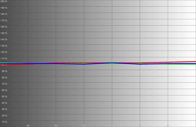

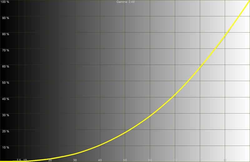

Final Gamma (right) was
between 2.4-2.5, a slight but marked improvement over the original 2.6 (left)

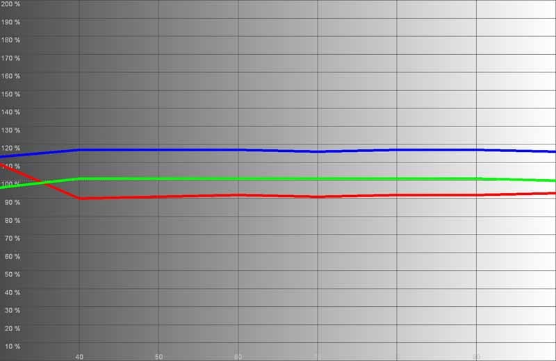

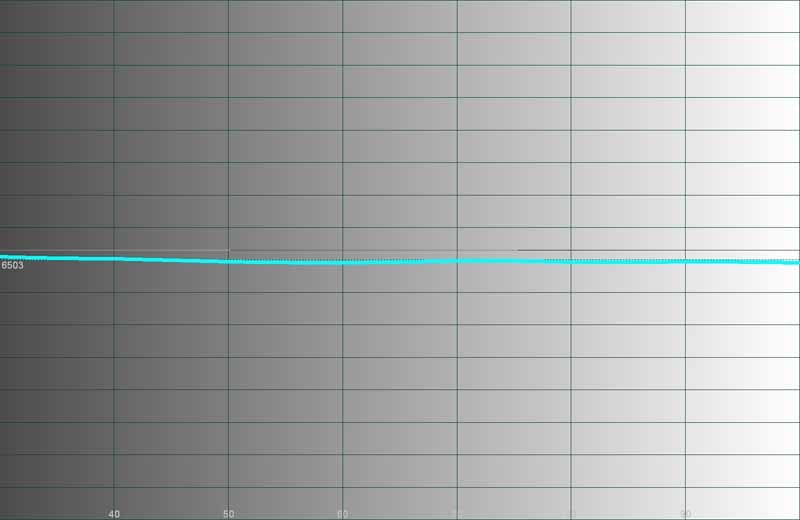

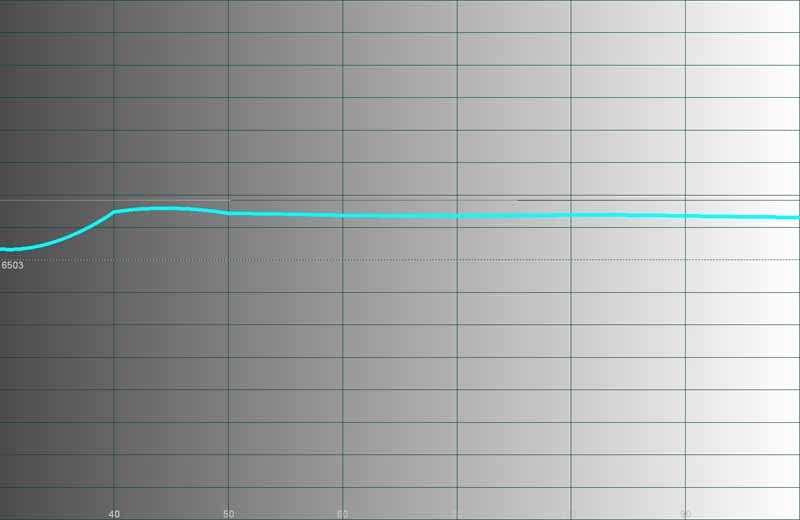

The grayscale,
initially dominated by blue (left), ended up nice and smooth after our
calibration (right)
Color temperature
dropped from its initial 7500K (left) to an almost spot-on 6500K across the board
(right)

Comments on Bench Testing
We encountered two really bizarre events as we calibrated the projector and explored its many features to find the optimal settings. The first we discovered while running the Jaggies #1 test. The rotating bar on the screen, while smooth, seemed to "judder" around rather than smoothly spin on its central axis. Changing the Overscan Adjustment setting to +2 (minimum is +1) fixed this and resulted in smooth spin. As near as we could tell the video processor had some issue with the +1 (lowest) setting.
The second event occurred when we attempted to experiment with the Dynamic Black setting. Once activated, the projector began making mechanical noises (not iris-related) that sounded like it was unable to control the black levels - and indeed the screen bore this out, with a constantly changing light output level. At first, disabling the Dynamic Black fixed it, however soon the noise came back and the Dynamic Black was once again out of control. After power cycling the projector this never again occurred.
In testing for rainbow effect we noticed two things. First, we could easily see RBE with any test pattern that showed a thin white line on black. Second, we couldn't see RBE in most of our real-world test material. This presents the scenario that if the on-screen image shows high contrast white on black you'll likely see it, but with 99% of viewing material this won't be an issue.
Recommendations
I like having Overscan essentially 'Off' so I'd like to see a firmware fix that addresses this particular video processing anomaly. I'd also leave it up to the user as to whether or not they engage Luma and Chroma Transmission in the Clarity Control settings section. My preference was to leave them off to avoid any edge artifacts, however you may prefer the increased color and luminance detail. I have to say, this is one of the most detail-rich, most naturally sharp projectors I've seen in a long time, so my preference for leaving these particular enhancements 'Off' didn't make me feel as if I was missing anything.
Noise Reduction seemed best when set to +2. It did an incredible job of reducing mosquito noise in the picture and I didn't encounter any disjointed "floating object" effects so often experienced when the noise reduction hits the edge of an object and unnaturally "floats" it over the background. There was no blurring on the Motion Adaptive tests we did, in either the HQV disc or real-world examples, so the noise reduction system is good for both static and moving images. Noise reduction does not, however, work for HD sources and it is grayed out when any progressive or 1080i signals are received. The Film Detail lock was as quick as anything I've seen, meaning that the HQV processor can recognize and grab onto an unflagged 2-3 pulldown scene with no difficulties.

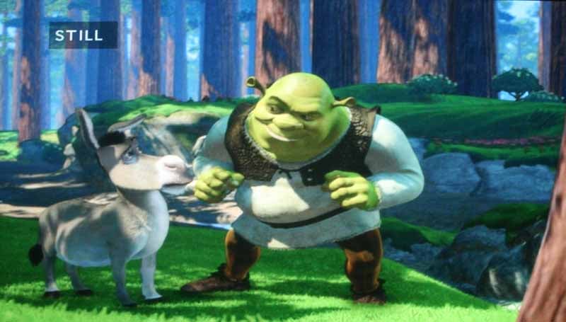

DVD:
Shrek
An
oldie, but goodie, I wanted to put something up which showed the excellent
film-like color reproduction possible with the W5000. Shrek seemed like a
perfect movie to use and we also got to see more of how well the BenQ projector
handles SD content upconverted to its natural 1080p resolution.
Colors popped but maintained a film quality
provided Brilliant Color was left off
Brilliant animation moments like this delivered
shadow detail and opportunities to see (a lack of) banding in difficult areas
of images such as fire on a kettle.
