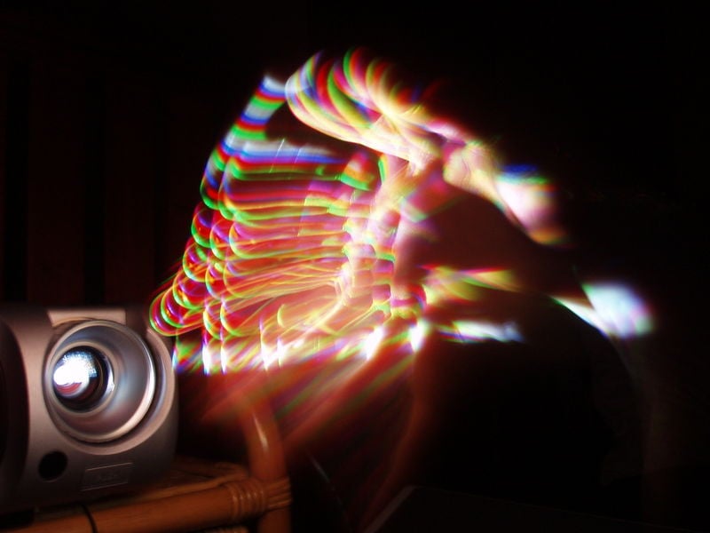

Its full of pretty rainbows!
It's full of pretty rainbows!

  • 3-chip systems with no rainbow effect issues

DLP made some huge improvements with its DC3 chipsets, but recent advancements seem to be incremental at best. That's not to say that Epson's new D7 panel update is anything to write home about, but DLP is all but evenly matched with LCD - except that LCD offers more features, options and configurability than DLP at the same price points. In most theater rooms I've seen, black levels, previously the ace-in-the-hole for DLP, is all but a non-issue in models priced around $2500. Rainbow effect remains and it will continue to remain until DLP breaks down and allows 3-chip systems to hit the budget price market.
