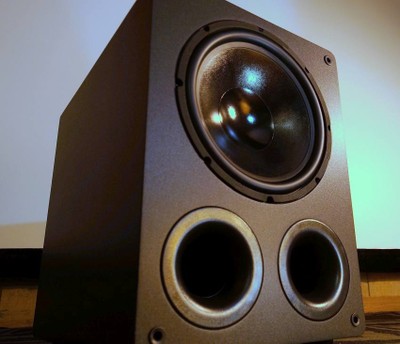

At 20.5” high and 22” deep, the VTF-2 mk5 is probably not many people’s idea of a small subwoofer. That is not to say it is gigantic but perhaps on the large side. It has a rugged vinyl black finish that is not quite as fine as the satin black on Hsu’s higher end subwoofers, but it does present a clean appearance and would not be as easily scratched. The VTF-2 mk5 will not dazzle anyone with beauty, but, with its rounded edges, it has a clean simplicity that would be innocuous in a room’s corner. It is a perfect height and shape to serve as an end table for those who want some near-field punch and can accommodate that kind of placement. With grille on, it is simple and smooth black box, but with grille off, a gleaming cone and two sleek ports exudes a readiness to rock. I prefer the VTF-2 mk5 with the grille off!

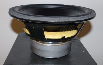

HSU VTF-2 mk5 Driver
Examining the driver, the first thing that jumps out about it is the beefy magnet in the motor; a stack of two ¾” iron pieces with a 6.25” diameter which form the bulk of the 16 lbs. weight of the driver. The basket is made from stamped steel of a decent thickness with a rib on the spokes for additional rigidity. A butyl foam surround holds a treated paper cone that meets a nomex spider at what appears to be a 2” diameter former. A bumped-out back plate has a pole vent for thermal management. The VTF-2 mk5 driver uses shorting rings to reduce flux modulation. Altogether, this driver looks to wisely allocate the bulk of the cost to the motor.

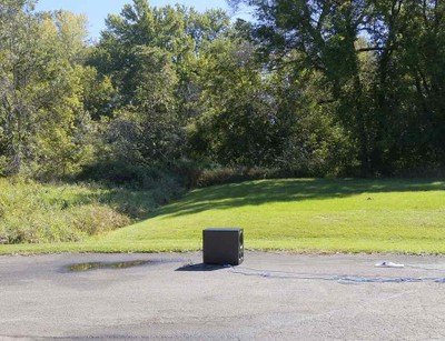

The Hsu VTF-2 mk5 was tested using ground plane measurements with microphone at a 2 meter distance in an open setting with well over 100 feet from the nearest large structure. The sub was tested with woofer facing the mic. The subwoofer’s volume knob was set to maximum, Q control was set to 0.7, and the low-pass filter was switched off. Weather for testing was recorded at 62° F with humidity at 40%.

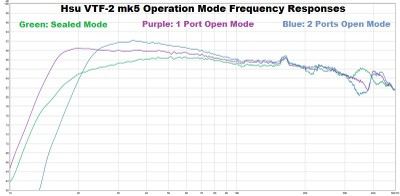

Frequency responses of the main operating modes of the VTF-2 mk5
From the frequency response sweeps we see that the VTF-2 mk5 is impressively flat, especially in 1 Port Open mode, easily meeting Hsu’s claimed +/- 2 dB from 18 to 200 Hz response. 2 Ports Open mode sees a rise at the lower end of its response with the Q Control at 0.7, but when turned to 0.3, it also falls well into Hsu’s claimed response of +/- 2 dB from 22 Hz to 200 Hz. Even the sealed mode holds an impressively flat response down to 20 Hz, although the shape of the response is very different from the ported modes. In any mode the VTF-2 mk5 has enough linear upper frequency bandwidth to be used well above 200 Hz if so desired.

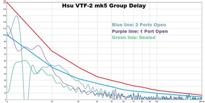

Group delay is the measurement of how much time it takes for individual frequency bands of an input signal to be produced by the speaker. It can indicate that some frequency components are developing slower than others or are taking longer to decay. It is generally thought that 1.5 sound cycles are needed for group delay to be audible at bass frequencies, although there is an argument that group delay should remain under 20 ms to be completely unnoticeable, but that is likely meant for mid and upper bass frequencies. The group delay of the VTF-2 mk5 steers well away from anything that could be audible. The points where group delay rises above 20 ms or even 1 cycle are too deep to be perceptible. The VTF-2 mk5 exhibits very little overhang or stored energy. The sealed mode naturally makes the best showing here, since there is no lagging wave exiting a vent. In the other operating modes the frequencies in the port’s output range look to have the most group delay, and that is an expected result.
I’d say 1-2% THD at 95dB is excellent for a ported sub at any price, since the residual distortion will always be from the ported driver’s mechanical non-linearities. At modest SPL, under 100dB, a properly-designed sealed sub with the correct driver will have lower THD, since compressed air is essentially perfect and at lower SPL, the air—not the driver’s mechanical suspension—dominates the distortion. At higher SPL, ported subs have lower THD, since this situation is reversed and the air in the port doesn’t distort, while a sealed sub has to provide 4x the excursion for 6dB more output, so the sealed driver’s mechanicals do dominate the distortion at that point.
