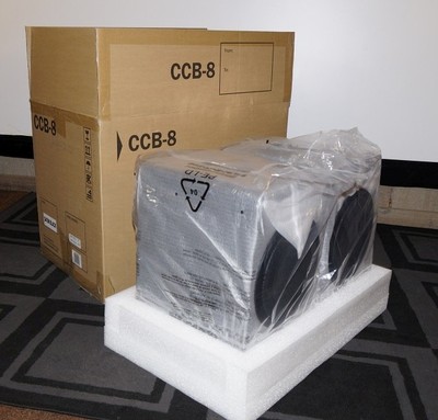

The CCB-8’s come packed in a heavy-duty cardboard box and sandwiched between two thick foam pieces. They are wrapped in a plastic bag on the outside and a cotton bag on the inside, to protect them from both moisture and scuffs and scratches. The owner’s guide is fairly standard, but it does include some good advice about placement. Due to the unique design of those speaker, some attention should be given to placement and positioning section of the manual, since their advised positioning differs somewhat from traditional bookshelf speakers.

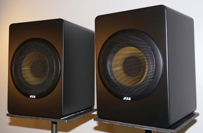

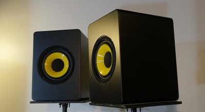

The appearance of CCB8_single9R.jpgthe CCB-8 speakers is a bit unusual from ordinary bookshelf speakers. A yellow cone with a black dustcap set against a fine satin-black cabinet begs a visual comparison with some kind of mechanical eye. The black metal grille does temper that likeness a bit by dimming the yellow. The grille is attached magnetically, so no grille guides clutter the front baffle. The CCB-8 is on the large side of bookshelf speakers, with a 15” height, a 10.5” width, and a 12” depth. Anyone intending to use these with bookshelf speaker mounts will need a heavy-duty mount, not just for their size but also their 22 lbs. weight. The satin-black finish is sleek, and, with the addition of the rounded edges, do lend the CCB-8s a sense of style beyond mere utilitarian. However, this speaker, without its grille, is not a conservatively styled speaker. It has personality, and it will clash in a home with traditional decor. That can be alleviated somewhat with the optional rosenut finish which does take the edge off the yellow cone and makes the CCB-8 look more refined. The bottom line is that it is a speaker with a peculiar style that is bound to turn some people off. Personally, I like it, however I like it when speakers have character. I prefer it when speakers look like speakers and do not pretend to be an innocuous piece of furniture.

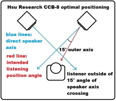

One peculiar feature of the CCB-8 is the recommendation by Hsu to toe the speakers in front of the listener where the listener ends up 15 degrees off the direct axis. In fact, the CCB-8 is engineered from the ground up to be listened to off axis around a 15-degree angle. The reason for this is because Hsu is leveraging a phenomena known as ‘time-intensity trading’ to create a strong stereo image across a wider listening area, so that listeners do not have to sit in a single position to experience good imaging. Time-intensity trading is, in very simple terms, when our perception of hearing can be fooled into thinking something sounds closer to us than it actually is, because it is louder.
The two primary ways that we determine the location of a sound is the differences in the time arrival of the sound between both our ears and differences in amplitude of sound (that we perceive as loudness) between our ears. If we hear something sooner in one ear than the other, the origin of the sound will be perceived to be in the direction of the ear which first sensed the sound. If we hear something louder in one ear than the other, the origin of the sound will be perceived to be somewhere in the direction of the ear that sensed the sound to be the loudest. That, of course, is a very simple explanation of these seemingly common-sense aspects of our hearing, which are called Interaural Time Difference (ITD) and Interaural Intensity Difference (IID), respectively.
In normal stereo speaker systems, the closer you are to one speaker, the more the stereo image shifts in its direction, so the imaging will very often be heavily weighted toward the speaker that you are closest to, and this is due to ITD and IID. It is because of this that the listening position of a stereo system is always right between the speakers, usually forming an equilateral triangle with the speakers themselves, and with the speakers toed-in to face the listener directly. But what if you could alter that effect by compensating the time arrival difference between right and left ears with the amplitude difference between right and left ears? This is the logic of the 15-degree inner toe-in of the CCB-8s. If you are sitting off center in a system that is built for such an arrangement, the speaker facing you will be louder, but that isn’t the speaker that is closest to you and so will have a later time arrival. By balancing time arrival with loudness, we can preserve a sharp stereo image, even when we are sitting off the “sweet spot.’ The is the effect achieved with time-intensity trading, and it is something that a constant directivity design like the CCB-8 should excel at; in fact, a wide-dispersion speaker would not work well for this kind of setup. For a more comprehensive guide on time-intensity trading in speaker placement, read Bill Waslo’s article: Setup of Controlled-Directivity Waveguide Speakers.

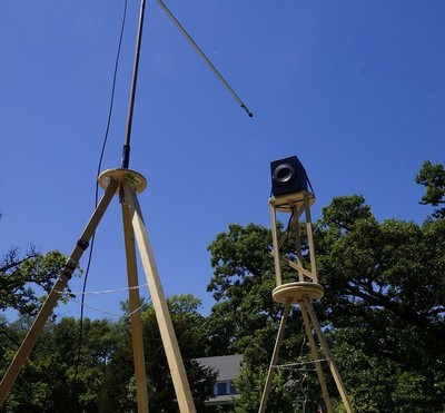

The Hsu Research CCB-8 bookshelf speakers were measured in free air at a height of approximately 9 feet and gated at 14 ms. At this window gate, some resolution is lost below 140 Hz, and accuracy is completely lost below 70 Hz and so that range should be ignored. The microphone was placed 1 meter away from the speaker at a height level with the tweeter. All measurements are unsmoothed.

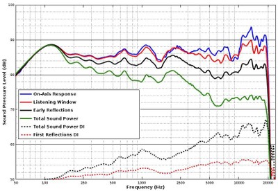

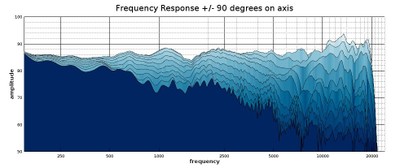

The direct-axis frequency response curve for the CCB-8 is not perfect but it is not bad either. It should be kept in mind when viewing these curves that this speaker was not intended to be listened to on its direct axis, but around 15 degrees off axis. The 100 Hz bump is more of a measurement anomaly than the speaker’s actual low frequency performance. Up to 10 kHz, the response is respectable, if imperfect. It stays within a +/- 3 dB window, although we do see a slight bump and dip near the crossover frequency of 1,500 Hz. These narrow ripples and dips are imperfections, to be sure, but the overall response stays within a baseline amplitude, and, in terms of audibility and accuracy, this is much more preferable to wide bands of elevation or depression. Once we hit 10 kHz, the treble hits some spikiness on direct axis that rapidly falls down as we go off axis, although there is still some of it at 10 degrees off axis. If listened to on its direct axis, this is likely to make the CCB-8 a bright speaker, but we see in the directivity indexes and sound power that this elevated treble is very directional. One interesting feature that can be gleaned here is to see how the horn affects directivity above the crossover point, where the dispersion becomes much more restricted.

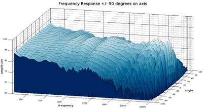

Hsu Research CCB-8 Bookshelf Speakers horizontal frequency response +/-90 degrees from axis: 3D view
Hsu Research CCB-8 Bookshelf Speakers horizontal frequency response +/-90 degrees from axis: 2D view
The above graphs depict the CCB-8’s axial response out to 90 degrees in 10-degree increments. As was alluded to by the directivity indexes, the CCB-8s rapidly narrows its dispersion pattern above the crossover point. The dispersion of treble frequencies is tightly contained. We also see the high-frequency response above 10 kHz has come down substantially at 20 degrees without heavily impacting the rest of the response. This speaker’s most neutral overall response looks to be between 15 degrees and 25 degrees, and it is at this angle that it is best listened too. While our measured response at 15 degrees is not bad, they do not match Hsu’s claims of +/-2dB from 50 Hz to 20 kHz. Those who suffer from high-frequency hearing loss (a huge chunk of the older adult male population) might benefit from listening to the CCB-8s on the direct axis, but most listeners would be more comfortable listening at the said 15-25 degree angle.

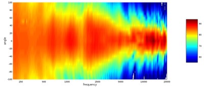

Hsu Research CCB-8 Bookshelf Speaker Polar Map
 The above polar map of the horizontal dispersion of the Hsu CCB-8 speakers depict the same information as the two waterfall graphs above it, but tells the story in a different way that can offer further insight regarding its behavior. In this graph we get a better idea of the kind of controlled directivity that is occurring at high frequencies. Dispersion is kept nicely uniform above 5 kHz. Below 5 kHz there is some broadening to the mids, and that looks to be the horn’s way of controlling the tweeter’s output. The dispersion seen here overall is not as broad as other speakers I have measured, which is exactly what one would expect from a constant directivity design. As we saw with the waterfall graphs, the most linear axis looks to be around 15 to 25 degrees.

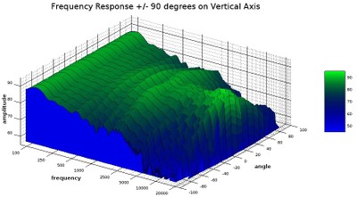

Hsu Research CCB-8 Bookshelf Speakers vertical frequency response +/-90 degrees from axis: 3D view
 The above graph depicts the CCB-8’s frequency response behavior on the vertical axis. As one would predict by its design, there is not much difference in performance between the vertical and horizontal axis. Orientation does little to affect its performance, so it can be used on any of its sides without any serious acoustic penalty. This can be handy for those who want a powerful bookshelf speaker but have a height restriction of less than 11.” The absence of any lobing artifacts demonstrates why the CCB-8 makes for a good center channel speaker. On traditional center speakers, woofers are aligned on a horizontal plane, and this will cause cancellation artifacts off-axis, sometimes as close as 10 degrees off-axis. This can result in an erratic sound for those who have to sit off to the side of the direct axis of the center speaker. The Hsu CCB-8 has none of these drawbacks. One drawback that it does have is that, since the upper treble on the direct axis is elevated, users may want to aim the tweeter above or below the listening position by 15 to 25 degrees. In my own listening, I aimed the tweeter over my head when seated at the listening position for an approximate 15-degree angle.

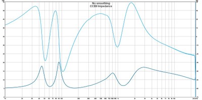

Hsu Research CCB-8 Electrical Impedance and Phase
The impedance profile of the CCB-8 doesn’t exhibit anything problematic. We can see that the port tuning frequency is just above 60 Hz. That was performed with two ports open, and if we sealed a port, that saddle shape would move down in frequency. Hsu states the nominal impedance of the CCB-8 to be 6 ohms, and that looks to be correct. Our measured impedance minima shows 5 ohms, but Hsu states 4 ohms in their specifications. No reasonably engineered amplifier would have a problem with this load, and even budget AVR amps should be able to handle this without too much of a problem. The toughest part of this profile would be the 5-ohm dip just under 200 Hz, but the phase angle is not very steep here.
Hsu reports the CCB-8 sensitivity in half-space at 94 dB at 1 meter for 2.83v, and our measurement of 93.8 dB largely agrees with their specification. Of course, half-space sensitivity converted to full-space sensitivity means a drop of 6 dB, which puts the CCB-8 at 88 dB sensitive full-space by their own specifications. That is above average for a bookshelf speaker, but do not mistake its half-space spec to mean it is a high-powered speaker that can handle THX Reference levels in a large room. The half-space sensitivity specification is simply the result of the setting it was measured in. In a medium-sized room, the CCB-8s can get louder than most people would ever want, but those who like loud-listening in a large room are going to need some much larger speakers.

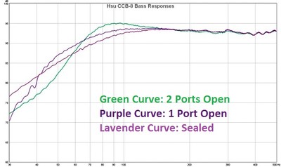

Hsu Research CCB-8 port sealing effects
We did groundplane measurements to gauge the effects of sealing the ports on the CCB-8. Sealing the ports will only affect the low frequencies, so we restrict our window to that region. Leaving both ports open gives a slight rise at 90 to 100 Hz of almost 2 dB. Sealing one port gives the CCB-8s the most neutral response and also a bit more low-frequency extension. Sealing both ports effectively rolls off the response at a gradual 12 dB/octave slope starting at 100 Hz. Those who like beefier bass would be advised to leave both ports open, and this configuration necessitates a subwoofer crossed over at 80 Hz. While the use of a subwoofer is recommended with the CCB-8s, if no sub is available, sealing one port would be the preferred mode of operation, since it provides the most deep bass at tangible levels between all modes. Those who want the flattest response should also run the CCB-8s with one port sealed.
