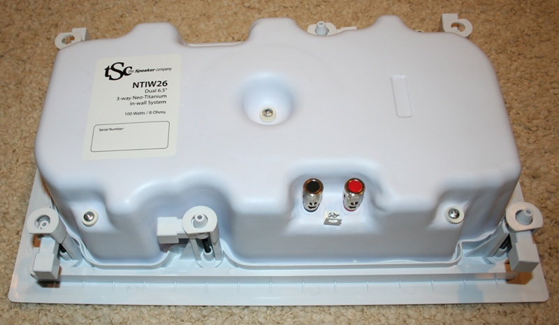

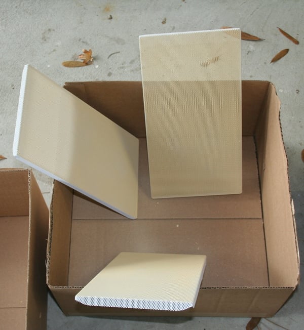

The speakers arrived double
boxed (of sorts). Basically, every one of the speakers was wrapped in
bubble-wrap and stuck in a box surrounded by foam packing peanuts. All four of
the boxes were then boxed together in a single larger box. The problem with
this packing method was that the bevels on the speakers, while rounded, are quite
thin and sharp. On three of the boxes one corner of the bevel pierced the side
of the box despite the bubble-wrap and peanuts. Since there were also some
packing peanuts in the larger box, only one of these edges pierced all the way
through. While there was no damage to the bevels of any of the speakers, it was
a little disconcerting. As you can tell from many of the pictures, the speakers
had no branding on the front and one was actually missing any sort of branding.
These were pre-production speakers and probably the first batch of speakers they received. It's a
testament to how rare in-wall speaker reviews are that they would offer up
their earliest speakers.The Speaker Company (tSc) has assured me that they will pack these speakers in 5-ply brown cardboard boxes with custom molded styro inserts, a manual and mounting templates. The packaging is designed to survive a “two way” trip should someone decide to return them.

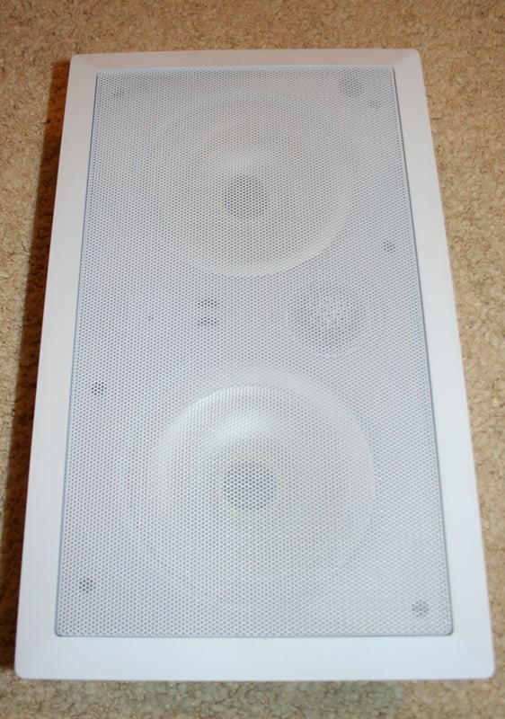

While there is nothing inherently wrong with an in-wall or in-ceiling speaker without a backbox, I pretty much universally prefer one. To me, it makes placement much easier as sonically the size of the air gap behind the speaker becomes moot. Open back speakers must make some assumptions about the size/shape of the wall in which they are installed - and how do they know whether I have 8 or 10 foot high walls? Additionally, if they assume a well insulated wall, then that provides one sort of "box" for the speaker. If they assume an interior wall without insulation, that provides a different box. I'm not big on assumptions and having a backbox makes them moot. The NT series of in-wall speakers all come with dedicated backboxes.

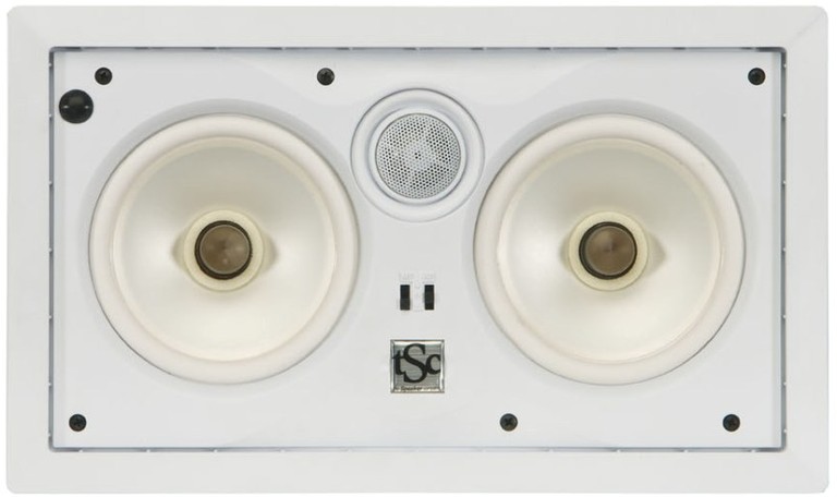

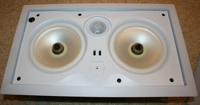

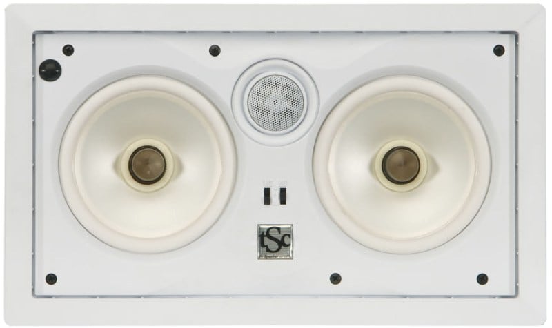

Each of the speakers are an
MTM (Midrange-Tweeter-Midrange) design with the tweeter slightly offset to help
reduce lobing effects. The speakers are all white except for a gold aluminum
phase plug and a few black screws. Personally, I'd preferred if the NT speakers
had all white hardware (namely the black screws and the two black adjustment
switches) as they are gorgeous to look at without the grills on. Of course,
being an Audioholic, I'm one of the few that would actually do that so I'm not

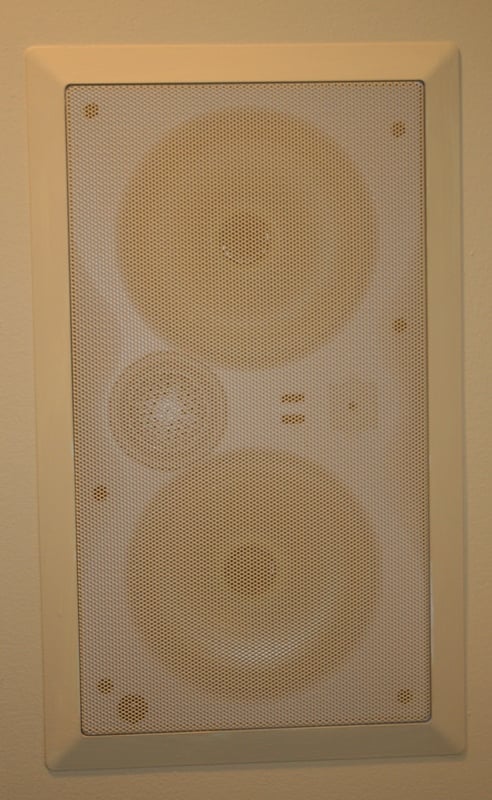

going to hold that against them. In-wall speakers are made to disappear in the
room. Also included was an acoustically transparent foam layer that is meant to
be placed between the grill and the drivers. This helps the speaker blend into
the room as the white baffle can be seen behind the grill under direct light.
In the room in which they were installed, this wasn't an issue so we decided to
leave it off. For those of you keeping score, these speakers look remarkably similar to the MB Quart Alexxa series sold in the Audioholics E-store for more than 2x the price.
The tweeters are titanium domes with the woofers being titanium wet powder coated poly cone. The tweeters swivel slightly with a firm push for fine tuning. With swiveling tweeters I rarely see any sort of mechanism to let you know when they have been reoriented straight forward. The NTs are no different. This is a feature that I believe should be standard on such speakers as it is easy to move them and not be sure that they are orientated the same direction. In addition, there are two "tuning" switches that will either boost or cut your highs or mids by 3dB. This is the sort of feature that is absolutely essential to in-wall speakers as placement options are often extremely limited and sonic distortion may very well occur based on that placement. The drivers also feature butyl rubber driver surrounds which are moisture resistant and suitable for use in bathrooms, kitchens, saunas, and even under outdoor eves. All of the speakers are magnetically shielded.
The backs of the speakers sport dual spring-clip binding posts that pretty much only accept bare wire. I suppose you could use pins but that would be a waste. I generally don't like this sort of connection as they tend to be weak but these were higher quality than others I'd seen. It took a good deal of force to depress the spring and I was very confident that the wires were being held securely. I wouldn't be surprised if on the unimaginable chance that the speakers actually fell out of the wall, you'd find them dangling on the end of the speaker wires! They were that secure.
The installation method is very straightforward. There is a beveled lip (the ones that pierced the boxes) that sits on top of the drywall. Behind that there are six clips that turn and compress as you tighten a screw from the front. These are meant to grip the drywall and are similar to "old work" electrical boxes you may have installed at one time or another. You'll want to try and give yourself about an inch of clearance on either side of the speaker opening in order to give the clips enough drywall to grip. The mounting hardware does not give you enough room to grab on to a 2x4 if one is available (at least on the 4" side) so you don't want to cut either of your edges right up against a stud. In this case, a studfinder is definitely your friend. The clips run down little tracks and are held in place by a sort of ring at the top. On one of the speakers, the ring was broken and missing and the clip kept popping out of the channel. Luckily, this was a wall that I had direct access to from behind (see below) and I literally held it in place while it was installed. Honestly, six connection points is probably two to many so I don't think missing one would have been a problem. Also, it was traveling down toward the drywall, it was just really, really hard to screw. With enough elbow grease, I might have gotten in down anyhow.

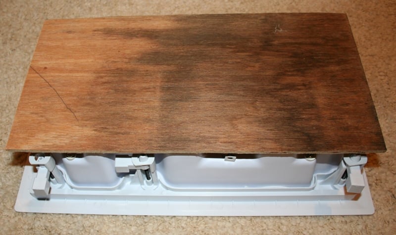

You're going to need a template.
I mentioned that I had one of the pre-production sets of speakers received by tSc. This meant limited branding but more importantly it meant zero additional material. Essentially, I got speakers in a box. No manuals, no directions, no templates… nothing. This isn't a problem really since installing in-wall speakers isn't exactly rocket science so we made do. At the time of the review, even some of the online information was wrong so we really had to double check everything. The first thing we did was to make a template. The NT speakers by tSc make this an easy task with the small lip about an inch inside the beveled edge. Each of the speakers needed a hole that was 14" tall (or wide depending on how you orientated them) with the 25's needing a 7-1/8" and the 26s needing a 7-3/4" wide hole. While I was all prepared to cut something out of cardboard (the easiest way), my father (whose home was getting the speakers) wanted to use plywood. A few rips with the circular saw later, and we had our template. The overlap with the mounting clips makes it so your hole didn’t have to be exact as long as it wasn't too small.

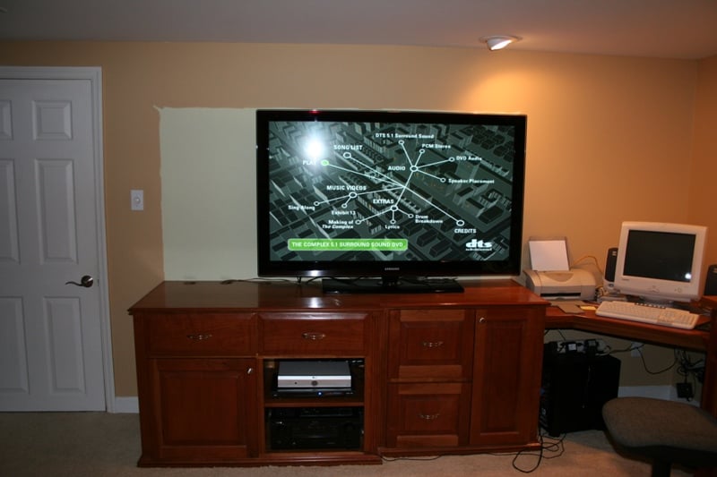

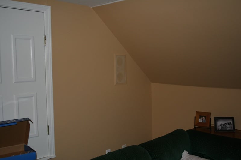

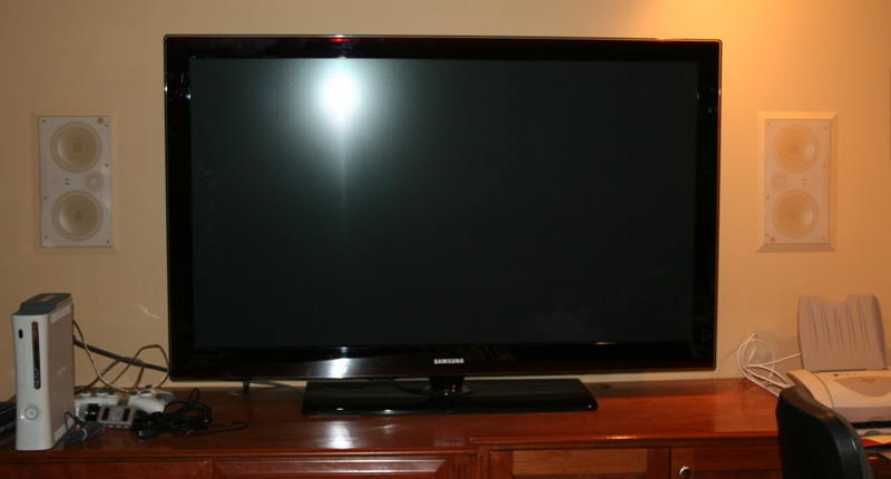

The next step was placement. The room the speakers were going into was a bonus room built up in the attic. As such, we had unparalleled access behind the walls. Recently, my parents had installed a bathroom up there which limited some of the access but we could still exit the room directly behind the right wall and walk around to behind the front wall. Getting to the left and back wall was more of an issue but it was doable by climbing over the top of the room and (theoretically) dropping down the wall from above. The wall of the back of the room was angled because it was flush with the roof (basically a hip roof) though it wasn't much of a problem since we could push a wire down from above if we needed. Fortunately, we already had the wires run to the back of the room (just not to the right places) so half of our work was done for us.
The way the room was laid out, the couch was on the right side of the room with an open area to the left that eventually led to a bathroom. This made for placement issues with the left surround speaker as it ended up being nearly 10 feet further away from the listening position as the right surround. The original speakers (JBL Home Theater in a Box) were placed in the corners which I wouldn't have condoned even if it would have worked for in-walls. While surrounds generally should be placed to the left and the right of the seated position, I opted to place them behind the couch as it would create a more symmetrical placement and would still sound pretty good (especially to my decidedly non-audiophile parents).
The best laid plans and all of that…

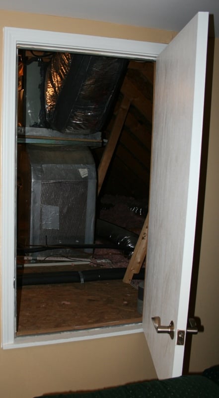

It didn't take long with a studfinder to realize that my initial idea wasn't going to work. Where I wanted to place the left surround was jammed up with studs and by the time we found a large enough opening to accommodate the speaker, it was placed almost a third of the way into the couch. Well, that wasn't going to do so we quickly reconsidered. With a little bit of planning, we decided we would place them on the side walls even though this would again have the left speaker 10 feet farther away from the listening position. "Hey," I told my father, "you can only do what you can do." This is one of the limitations of in-wall speakers and too often people have grand plans for placement (like me) without ever exploring if their plans are even viable. Since my parents live 6+ hours away, I at least have an excuse for not testing it out with a studfinder first. Above the distance issue, the two side walls did not have symmetrical stud placement. This meant that one speaker was a bit (a few inches) higher and farther forward than the other. It couldn't be helped. Again, when working with in-walls, these are the problems you come across.

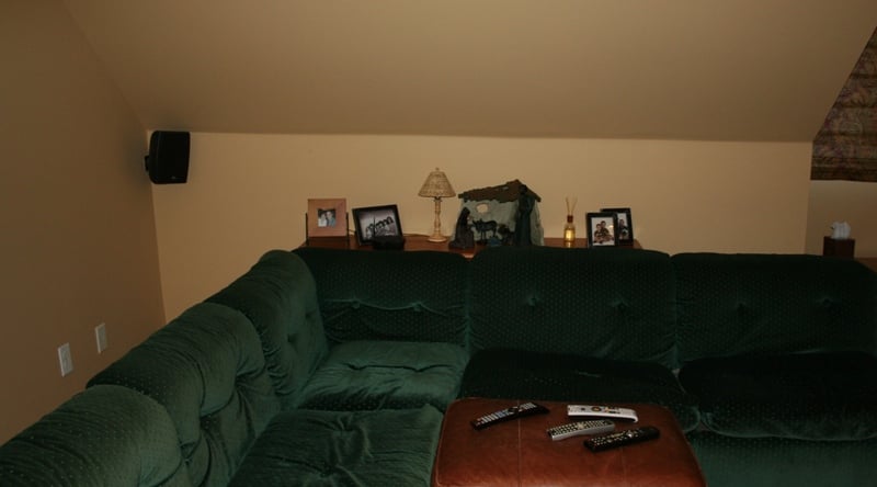

Back of Room (notice, no left rear speaker, it's way off to the side)

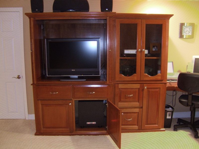

When my parents bought their initial system, it consisted of the JBL speakers, a 32" JVC CRT display, and an Onkyo receiver. Good gear for the most part especially for the time and the amount of money spent. They did make the classic mistake of thinking that they'd have this same gear forever. When they bought the TV, flat panel prices were in the 10's of thousands and seemed completely out of reach. A few years later and they're ready to upgrade but can't. Why? They have a huge entertainment center that was custom built for their TV. Not only that, but when it was constructed, they didn't consider speaker placement and ended up having to put the fronts way up on top of the entertainment center which made the TV (my mother's words) "look like it had horns." Needless to say, she'd push the speakers back to reduce the offending imagery. Sonically, this wasn't helping the JBLs any.
Fast forward a few years and they want to upgrade to a flat panel but can't because of the size of the cabinet. After a few days of, ahem, discussion, they had the top of the thing lopped off and purchased a 58" Samsung plasma! Hurrah! Now we're talking! But this introduced a new problem - there was no room for a center channel. Sure, we could install one near the ceiling but that would look sort of silly. We could wall mount the TV and install one underneath but again, the display would be near the ceiling and look off. The options quickly settled down to either installing a box speaker in a cabinet or forgoing the center altogether and going for a 4.1 system and a phantom center.
They opted for the latter.
Given the amount of sonic and visual improvement they were about to make to their setup, I considered this a win on all counts. In-wall speakers had the benefit of appeasing my mother who really didn't want to see the speakers anyhow, and they appeased me in that I wouldn't have to pull my hair out every time I came over and saw where my mother had relocated the speakers. From my father's point of view, he got what he wanted most (a bigger TV) and got better sound as well (or so I promised him). As it is for many people, the TV was the easy sell; it was the speakers that tended to get the most frowns.
I wanted to see if I could change that.

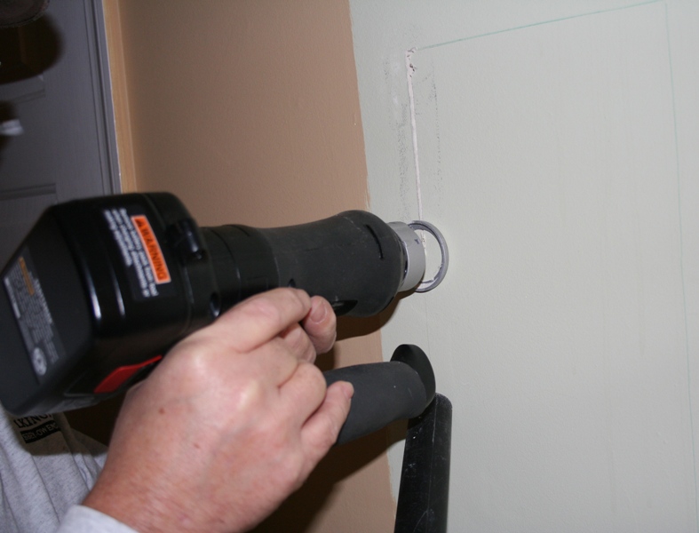

The last part of the preparation was the tools. My father just got a hand held, battery powered rotary saw. We decided to use that to cut the holes in the walls. Was it easier than a manual drywall saw? No. It also wasn't faster nor did it provide a straighter cut. But it was cooler to use. We also had on-hand a cordless drill, a cordless screwdriver, a drywall saw, a snake (stiff piece of wire for re-routing the speaker cables), a pencil, a level, a tape measure, and a vacuum cleaner. After placing the template on the wall, we leveled it, checked our measurements, and drew it in with a pencil. Cutting the holes was pretty much a snap with the router. One of us would cut the hole while the other held the hose of the vacuum near the cut to catch the majority of the dust. It's wasn't 100% but it did cut down on the cleaning afterwards.

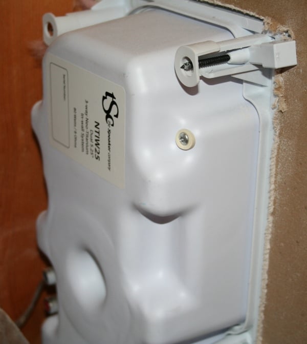

tSc Setup and Installation Pt. 2

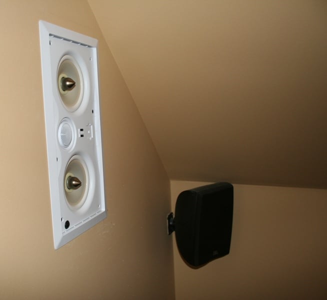

Once we got all the holes cut, it was a simple matter of running (or re-routing) the wires. In the front, we just ran them along the wall behind the entertainment unit and punched a hole underneath the speaker location. For the most part, we were close enough for the other person to reach down into the wall from the speaker cutout and grab the wire. For the side speakers, we had a bit of a problem with the left speaker. Because of the added bathroom, we didn't have access to the left wall. The original wire was run to the corner. Our new location was a few feet in from the corner on the wall. I climbed on top of the ceiling with the intention of dropping down on the other side and just plucking the wire out and moving it manually. Unfortunately, there was about a ten foot drop on the other side through a 3 foot by 1.5 foot opening. I could probably make it down but I wasn't sure I could make it back. My father pushed the snake up through the speaker cutout until I could see it, I attached the wire, and he pulled it back.
Author's Note: There are as many ways to run wires around a room as there are rooms. Check out Editor-in-Chief Clint DeBoer's excellent series of install articles for some ideas. The key is that there is always a way. Article 1, 2, 3, 4, 5.
Now that we had the wires run, it was simply a matter of installing the speakers and locking them down. Since we had leveled our template before we cut the holes, the speakers went in with a snap and were true. The cordless screwdriver made things a lot easier and comes highly recommended. Just be sure to use the clutch function, or stop when it starts to strain or when you see the drywall start to bend. You don't want to over tighten them. As I mentioned, the only problem I had was with a ring on he mounting clip that had fallen off and was causing the screw to pop out of the channel. You could probably power through this but I had the ability (since it was the right wall with attic access) to just walk into the attic and hold it in place.
Once the speakers are in place, wired, and installed, it was time to do what we should have already done - test them. Since I knew that the wires were good and had worked in the past, I waited until after I installed them for tests. I advise against this. Believe me; I was sweating as my father's Denon AVR-1708 went through the test tones. Luckily all was well and everything worked perfectly.

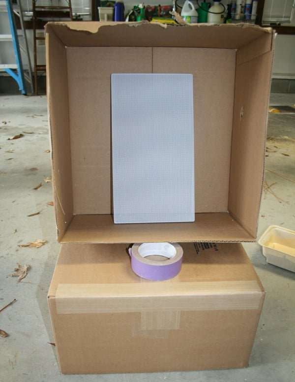

The last thing to do was paint. My parents used a special blend of paint for that room mixed by a local shop (it even bears my mother's name) so getting an off-the-shelf spray can for the grills was not an option. For the bevels, I could have painted them before installation but didn’t. I'm a pretty good free-hand painter so I just did it on the wall. This pretty much insured that you'd rip the paint off the wall if these were ever taken out to which I say, "Good!" They shouldn't be taken out anyhow. I tried not to get any paint on the inside edge where the grill would sit but that is pretty much an impossibility. Even if you could, I don't think that you should as you'll certainly risk seeing white from some seated positions.
For the grills, we ended up grabbing a spray can solution that consisted of a small reservoir for the paint, a can of compressed air, and a plastic unit to make them work in concert. If I may make a small digression, this solution was barely adequate and was almost more trouble than it was worth. The real problem I was trying to avoid was filling in all the little holes on the metal grill with paint and then having to go back and poke them all clear with a toothpick. I was pretty sure that would happen if we used a brush. The problem was that the spray can was out of commission as much as in commission as it would get too cold and lock up, the paint would clog and it would lock up, or it would just lock up and need to be cursed at occasionally.
If you do use a spray method for the grill (and I do recommend it even with the aggravation we had), don't put more than 2 coats if you can help it. And that is two light coats. The point is not to fill the holes in the grill. The more you layer on; the most you fill those holes. Also, I'd recommend three full days of drying before installing the grills. While paint may feel dry to the touch, it isn't. If you install those grills too early, you're pretty much guaranteeing you'll never get them off (or at least you won't without damaging the paint). Since the speakers have the midrange and high boost and cut switches as well as a swiveling tweeter, you're probably going to want to adjust them from time to time.
What we ended up doing was setting up a sort of mock "paint booth" using the boxes the speakers came in. We propped one up on top of the other and leaned the grill back into it. This made cleanup a cinch since we were planning on throwing away the boxes anyhow. We used a third box for drying. The system worked pretty well and between the time it took to switch out the grills, realign the boxes, and keep the sprayer in working order we could pretty much keep working continuously. Within an hour, we were done.
Author's Note: Having a hard time getting the grills off before installation? Push in the mounting brackets and let the heads of the screws do the work for you. After installation, I use a grill pick (looks like an ice pick with the tip bent at a 90 degree angle). You'll have to get creative.
