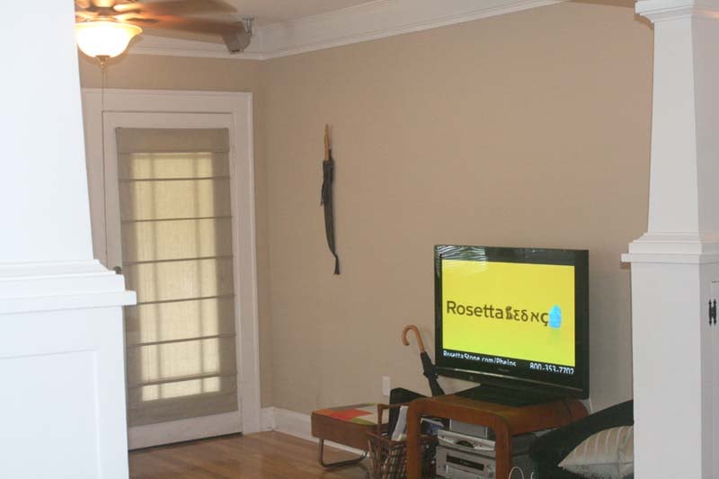

I quickly realize a few minutes after pulling up and checking out the living room that this install was going to be much different than the last one for a number of reasons. First, the owner (let's call him Joe - 'cause that's his name) was very concerned about a pair of Bose speakers. They were "too big for the room". Instead, he wanted to use his much smaller (dare I say dainty?) set of Sony satellite speakers. This was unfortunate, since this home could easily support a full 5.1 bookshelf system and even some floorstanding speakers. The second reason this install would be different was that I'd be going solo. Joe had to leave shortly for a meeting soon and I'd be fending for myself. Fine, I'd go ahead and install his "chick speakers" without him.

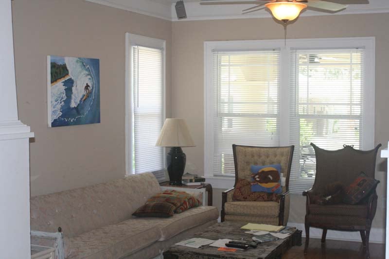

Glancing around I saw that the room, which was oriented to a corner-loaded position, could be quickly reconfigured so that the audio system could be placed against the East wall, giving us the ability to create a rectangular listening area. Of course, it meant that we had to leave a couch on the exposed front porch - but what's that in comparison to good sound? Fortunately, Joe said he wanted to toss the couch anyway… good riddance, better sound.
Once we decided on the configuration, we also settled on ceiling mounting the speakers. This was a very similar job to the last one and I was able to get started much more quickly. I also brought slightly less equipment, opting instead to go with plenty of wire, but not enough to drag a line across town.

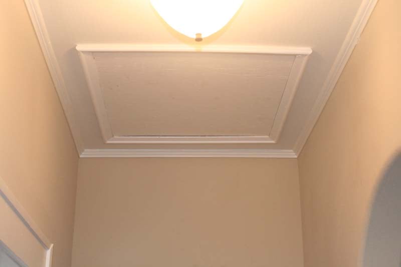

Attic access was in the hallway adjacent to the listening room. I was actually able to measure distance to the desired location for the drop into the wall cavity. This was good since there wasn't a ton of other objects to help, save a power outlet which typically drop next to a stud. I measured over 18 feet or so from the opening and pulled myself up into the attic using a 5-foot ladder. As the ceilings were 9 feet tall, this was no small feat.

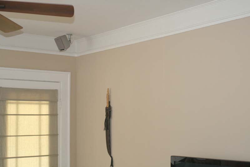

I moved the ladder over to the living room and marked off my four ceiling speaker positions. Unfortunately, I hit a stud on the first hole (left front). Moving over 2 inches I got a clean hole. I was using a bit that was just big enough to get the wire through as I didn't want air escaping from the attic and would like as clean a look as I could get (you can always caulk afterwards). Working my way around the room I got the remaining holes drilled with little difficulty (though there was lots of dust.) To mark each position in the attic, I inserted a piece of electrical wire (either hot, neutral or ground) from a short pierce of romex. To hold the wire in place I simply bent the bottom end in a loop so that it caught in the hole when fully inserted.

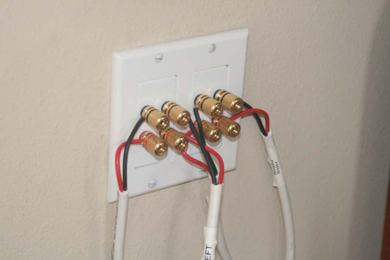

The final step for today was "pinning out" the wires and labeling them as I put on the wall plate. To do this I simply stripped the wires which were coming out of the ceiling, leaving about 18 inches. I connected the red and black wires to form a short (on purpose). Going back to my plate location where all four wires come together I used my voltmeter's audible short-tester mode to see which of the four cables was shorted. Once I found it, I labeled it accordingly. Rinse, repeat. I used a Rhino 3000 labeler (oh my goodness this thing is convenient) which was supplied with the C.I.T.S. kit and marked the physical cables in the event we had to go back and diagnose anything that might be amiss.

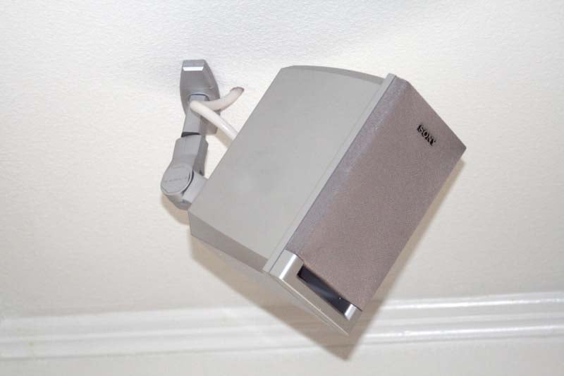

With all the hard work completed, I arrived at the home to mount the four speakers and place the center channel and subwoofer. Stripping the cables took me longer than I expected, but it was done quickly enough and I was ready to secure the mounts to the ceiling. We used a set of Sanus WMS5 mounts in silver which matched the Sony speakers we were installing and promised to be both flexible and secure enough to handle the satellites.
Mounting
Once each mount was mounted (we found studs for all 4 positions to ensure we wouldn't have to worry about falling speakers) we then took each of the speakers and secured the surface mount clips to the single threaded mounting socket of each. This made mounting the final speaker easy as it simply entailed using an allen wrench (provided) to secure the speaker to the ceiling bracket. We placed the center channel directly underneath the display (now a Panasonic plasma display) and the sub was located to the right of the display stand on the floor.
