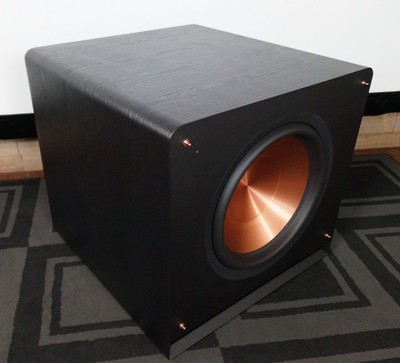

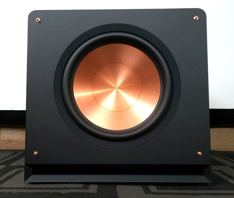

Klipsch RP-1600SW Appearance

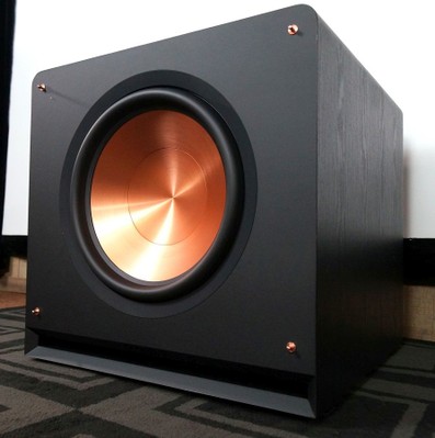

1600 grille4  1600 8

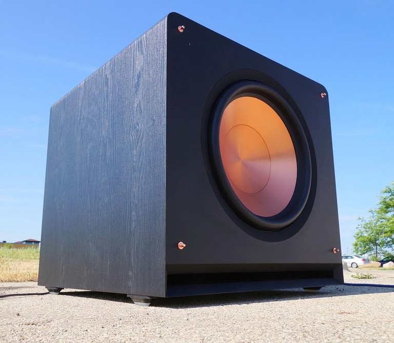

Needless to say, the RP-1600SW is a large subwoofer, and it won’t be easily hidden, so its appearance will matter. Klipsch has given it a tasteful and restrained appearance so it shouldn’t stand out too badly in a normal room despite its size. As with most other subs, it is basically a big black box. It has about a 23” height and width, but it does extend a bit more out in depth at 27”. I have dealt with larger subs, but it is still a big one. It has an ebony vinyl finish that helps it fit in with furniture, and its rounded edges go a long way toward softening its appearance. For those who want it to have a more subdued appearance, the grille hides the driver pretty well as well as giving it a bit more curvature in front. However, once the grille is removed, it becomes far more conspicuous, courtesy of Klipsch’s unique metallic copper cone. 1600 knobsKlipsch’s trademarked cone style is on full display in the RP-1600SW sans grille, and it is certainly unmissable for any visitors or household occupants. If boldly placed, it will certainly become the subject of conversation. In addition to the cone, Klipsch also uses copper-looking grille pegs (actually made from steel) on the front baffle. Usually, manufacturers try to soft-pedal grille attachment points, but Klipsch has decided to accentuate them with copper so that they complement the cone. The front baffle also has a status LED in the upper left corner that indicates the operational state of the sub. One other aesthetic aspect worth mentioning is the rear volume and low-pass filter knobs, which have a unique retro styling as though they were taken from radios from the 1940s. As far as large subs go, the RP-1600SW doesn’t look bad, and Klipsch has done a good job of allowing buyers to either mute the sub’s looks with the grille or letting its traditional Klipsch styling blaze freely for the world to see.

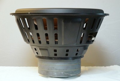

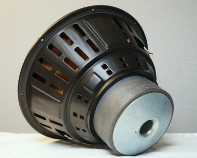

1600 driver2  1600 driver motor3
The motor is a massive one with triple-stacked magnet slugs that measure 2 1/2” tall with a 7” diameter. While that is impressive, the important value is the amount of flux that it produces within the gap which isn’t known to us, although we can safely assume it will be a lot. The motor is vented through the pole piece as well as under the spider. Klipsch uses two spiders to hold the former in place, and that will help restrict travel in one plane of motion as well as make it more difficult to knock the former out of alignment. Within the motor is a 2 3/4” diameter voice coil made from aluminum. Most coils are made from copper or copper-clad aluminum because of their extra conductivity, but solid aluminum is still very conductive while being significantly lighter than copper. If the coil were made from copper, it would end up being significantly heavier than an aluminum coil in order to handle all of the wattage that is required, and the extra weight would reduce the driver’s sensitivity.

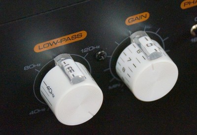

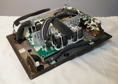

1600 amp panel  1600 amp

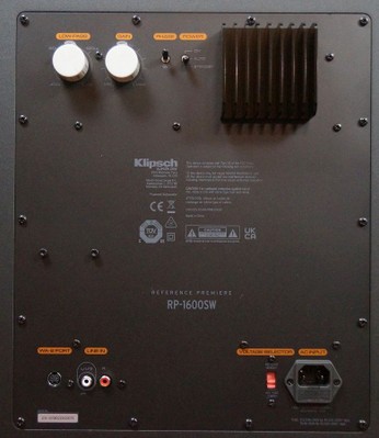

The driver is powered by an 800-watt RMS class-D amplifier which is a hefty unit with some large capacitors. There is a chunky heatsink on the backplate to help with cooling. Even though class-D is very efficient and runs cool relative to class-AB, 800-watts RMS is a lot and will still produce heat, so the heatsink will come in handy. The amp controls are fairly basic: gain knob, low-pass filter knob (40Hz to 160Hz), 0-180 degree phase switch, and an on/auto-on/off switch. Connectivity is also fairly basic with just a pair of RCA inputs (one of which is an LFE connection), although there is a port for Klipsch’s WA-2 wireless subwoofer signal kit (an optional accessory at $199).

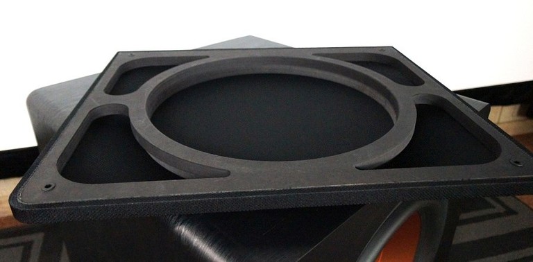

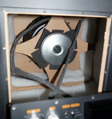

1600 hero4   1600 interior
The enclosure is a hefty affair with 3/4” thick side panels and a 1 1/2” thick front baffle. There are two window-pane braces within the enclosure, and one of them is used to support the driver motor. Also helping the enclosure rigidity is the thick slot port panel that runs the width of the sub. The slot port is flared on both ends to mitigate turbulent airflow, and Klipsch calls this design the ‘Aerofoil’ slot port. There is some polyfill-type stuffing lining the interior walls of the sub, although I wouldn’t think enough to make a difference. The feet are some elongated rubber bumpers that look like they would be sufficient to damp cabinet vibrations from transmitting to the floor. They look like they would work better than the usual rubber cones, and more manufacturers should look at this type of design for heavier subwoofers. The grille that Klipsch provides for the RP-1600SW is a heavy-duty MDF piece that extruded a circular space forward in order to give the cone room to move. Typically, grilles have pegs that go into grille guides mounted on the front baffle, but Klipsch has reversed that here and uses grille guides in the grille itself with pegs on the front baffle. As was mentioned before, I think this was an aesthetic choice so that the copper grille would have other copper elements to complement it on the front baffle.

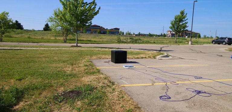

1600 outdoor testing

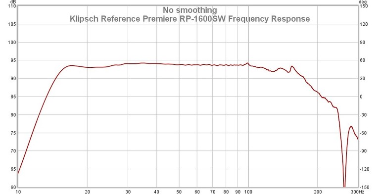

Testing on the Klipsch RP-1600SW was conducted with the microphone facing the woofer at a 1-meter distance with measurements scaled back to a 2-meter distance by subtracting 6dB. The temperature was recorded at 76F degrees with 23% humidity. The subwoofer’s gain was set to maximum, phase was set to zero, and the low pass filters were set to bypass.
1600 frequency response
The above graph shows the measured frequency response for the RP-1600SW subwoofer. What we have here is a beautifully flat curve from 16Hz to almost 160Hz, and it’s a shame that typical room acoustics are going to badly mangle this pristine response. At least we know that the sub itself is almost completely neutral out of the box. Any tonal abnormalities that end users will hear will be a result of the room, not the sub itself. Many subs can achieve very flat anechoic responses through DSP magic, but this one is particularly flat. I like Klipsch’s target response of a 16Hz extension before any drop-off. 16Hz is the lower limit of almost any acoustic instrument, namely the fundamental of the lowest pitches of larger pipe organs (although there are a couple of organs that have huge 64’ pipes with fundamentals at 8Hz, but they are too rare to matter, and 8Hz is well below human audibility anyway). It’s also worth noting that the upper-frequency extension enables users to try higher crossover frequencies than the typical 80Hz. That can be very useful, especially in multi-subwoofer setups.

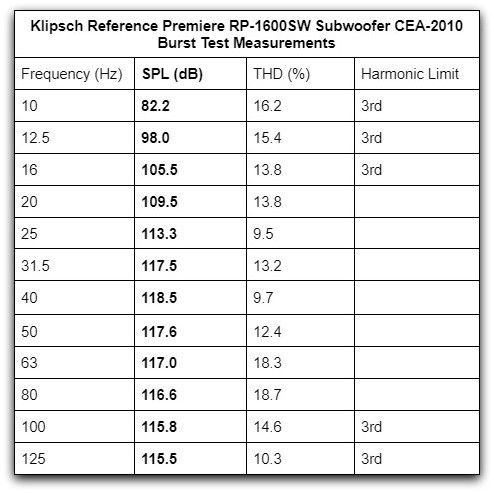

1600 CEA 2010 table2
Bassaholic ExtremeThe above CEA-2010 measurements are short-term bursts that show the subwoofer’s clean peak SPL before heavy distortion sets in. Our measurements have been referenced to 2-meter RMS, which is 9dB down from the standard requirement for the measurements to be shown at 1-meter peak. However most publicly available CEA-2010 measurements are shown at 2-meter RMS, so we followed that convention.
The RP-1600SW puts up some very impressive numbers, especially in deep bass. 105.5dB at 16Hz and 109.5dB at 20Hz puts this sub in the company of some of the more powerful ported 15”s that we have dealt with in the past. 98dB at 12Hz would be impressive, but it was accompanied by a great deal of audible port chuffing noises that the test software wasn’t quite reading as typical noise, so I wouldn’t expect serious infrasonic output from this sub without a more serious port noise penalty. Mid-bass headroom is also quite good, averaging 117dB out to 80Hz. 118.5dB at 40Hz is a brutal amount of headroom considering that frequency is where the lower notes in many electronic bass music genres hover around. Needless to say, these numbers easily net the RP-1600SW a Bassaholics ‘Extreme’ Room Rating, meaning it should be able to handle a 5,000 cubic foot room with no problem.

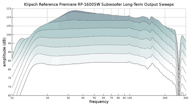

1600 compression sweeps
Testing for long-term output compression was done by first conducting a 20-second sweep tone where 50Hz hit 90 dB with the subwoofer 1 meter from the microphone (graph has been scaled to 2 meters for easy comparison with our other review measurements). We then conduct further 20-second sweeps by raising the gain by 5dB until no more output could be wrung out of the subwoofer. These tests show us the long-term continuous headroom that the RP-1600SW is capable of.
We can see that the RP-1600SW doesn’t really change its response shape until the 105dB sweep, so it retains its tonality up to very high loudness levels. Above 105dB, it does give up some deep bass, but it still has some gas in the tank around 40Hz well past 110dB. Again, that makes this a beast for loud electronic music. But it packs a lot of punch for movies too and can continuously produce over 105dB at just under 20Hz, so those after some super deep bass grunt get that in the RP-1600SW. I should say that at the higher drive levels in this testing, the port started to audibly complain around 20Hz and below, and we can see where it started compressing in this range. It can continuously output over 110dB from 25Hz to 100Hz, so it is not lacking in dynamic range. Klipsch delivers some serious dynamic range here.

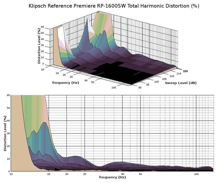

1600 THD
The above graphs show the corresponding total harmonic distortion to the long-term output graphs. Essentially, they depict how linear the subwoofer remains for the corresponding drive level seen in the long-term sweeps. The quantity being measured is how much of the subwoofer’s output is distortion and is shown here as a percentage.
The RP-1600SW demonstrates good performance here, without even being able to exceed 10% THD until under 25Hz. Distortion is pretty well-controlled, even at the highest output levels, until just above 16Hz, but if the sub is pushed hard at 16Hz or below, the system will complain. However, it should be kept in mind that output is plummeting rapidly below 16hz, so what distortion would be produced there would not be very loud in level. Port chuffing can become a problem below 20Hz at high enough drive levels so the RP-1600SW isn’t a great candidate for chasing after infrasonic bass (chuffing artifacts wouldn’t show up in these graphs since that is more broad-spectrum noise than precise harmonic products). However, 20hz is still very low, much lower than the tuning frequency of most ported subs, so few users will be disappointed by its deep bass performance. In listening to content, port turbulence wasn’t something I ever noticed, but in outdoor groundplane testing, the sub certainly wasn’t immune to audible turbulence at lower frequencies. At nominal levels, the RP-1600SW maintains very low distortion levels down to 16Hz, so those who do not plan to drive this sub to maximum volume have extremely clean bass to look forward to. But even those who run this hard will be met with fairly low distortion levels.

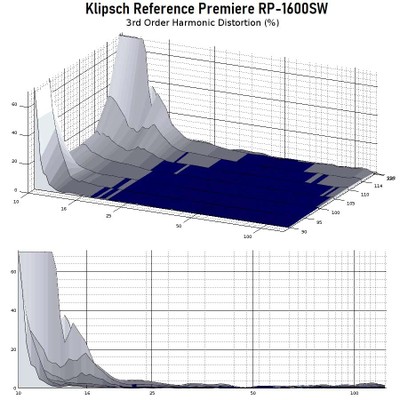

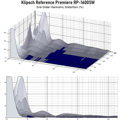

1600 2nd order harmonics   1600 3rd order harmonics
The above graphs depict measurements of the constituent harmonics from the long-term output sweeps and are what the total harmonic distortion measurements are composed of for the 2nd and 3rd harmonics. These individual harmonics can give us a clue as to what might be the cause of some quirk or non-linearity. We are only showing the 2nd and 3rd here because they more or less reflect the higher even-order and odd-order behaviors, although higher-order harmonics tend to be much further down as a percentage of distortion compared to the second and third.
Above 16Hz, we can see that the RP-1600SW’s distortion is dominated by even-order harmonics. Given the consistency of the 2nd-order rise in level with amplitude as well as the 2nd-order distortion dip at 40Hz, I would guess it stems from inductance. There is not a lot of it, so inductance seems to be fairly well-controlled on the whole. The good news is that even-order harmonics are more difficult to perceive than odd-order, so the distortion profile of this sub is rather unobjectionable. Odd-order products are essentially negligible at any drive level until we get below 20Hz. In my listening sessions, this subwoofer sounded very clean, and that is because it is clean.

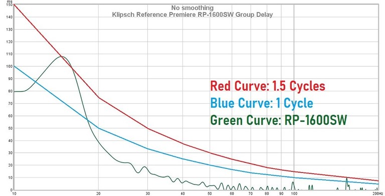

1600 group delay2
Group delay is the measurement of how much time it takes for individual frequency bands of an input signal to be produced by the speaker. It can indicate that some frequency components are developing slower than others or are taking longer to decay. It is generally thought that 1.5 sound cycles are needed for group delay to be audible at bass frequencies, although there is an argument that group delay should remain under 20ms to be completely unnoticeable, but that is likely meant for mid and upper bass frequencies.
The RP-1600SW puts up another very good showing in this metric, not even crossing our worst-case scenario of audibility until well below 30Hz where it doesn’t matter very much, owing to human difficulty in perceiving such deep frequencies. In the frequency bands that matter the most, the RP-1600SW has superbly low group delay, averaging 5ms from 50Hz to 150Hz. We can see that port tuning is 16Hz from the peak in group delay, and it does hit 1.5 cycles, but that is such a low frequency that even a 1.5-cycle delay isn’t likely to be audible. The time domain performance exhibited here is nearly textbook for a ported subwoofer. There is very little decay in music ranges, and the region where there is lag is too low in frequency to matter for human hearing.

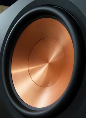

1600 cone2Before bringing this review to a close, I will briefly go over the strengths and weaknesses of the product under evaluation, and, as always, I will start with the weaknesses. Thankfully, the weaknesses of the RP-1600SW are few. However, it is not perfect. Its most significant disadvantage is obvious: it is a very large and heavy subwoofer. I have dealt with larger and heavier subs, but at 110 lbs., buyers will need to be aware that getting this thing into place is not a one-person job. And with a 23.5” width and 27.35” depth, it will have a substantial footprint. Then again, serious deep bass performance cannot be had from a small system. Large quantities of air have to be displaced for powerful deep bass performance, and a large transducer is an inherent requirement to do that. So, I am not criticizing the RP-1600SW for its size but rather advising interested buyers that they should have a realistic idea of what to expect if they are not able to see one in person before placing an order.
A minor problem that I noted was that somewhat loud drive levels under 20Hz could push the RP-1600SW into port turbulence. It needed to be pushed to make that happen, but it didn’t need to be pushed really hard. Again, I should say I didn’t hear any port chuffing in actual listening, and it was only obvious using pure test tones. However, for how much Klipsch touted their Aerofoil port system that was supposed to inhibit turbulence, the RP-1600SW was definitely not immune to chuffing. In my experience, no ported subwoofer is immune to chuffing, but the RP-1600SW can succumb to turbulence at unexpectedly low drive levels. I think the problem may be that the port is tuned just a bit too deep for the enclosure and driver combination. It should be noted that port turbulence doesn’t endanger the sub in any way; in fact, I was not able to overdrive the sub at any drive level, so the RP-1600SW is well-protected against damaging itself with any signal. Nonetheless, users who want to blast film content with high infrasonic bass may be met with fluttering noises from the subwoofer’s port, especially if the LFE level is hot.

Klipsch wanted to bring a monster subwoofer to market, and I think they did a good job with the RP-1600SW. The performance is formidable even among other large subwoofers on the market. It is good enough that it should be considered for those looking for subs for dedicated home theater rooms rather than just beefy living room systems. The sound of a single RP-1600SW is very impressive, and two or more in a multi-sub setup would doubtlessly be phenomenal. It is a strong choice in this segment, and it is abetted by a 5-year bumper-to-bumper warranty which some of its rivals cannot boast. I enjoyed my time with the RP-1600SW, and I would advise any subwoofer shopper to give it close consideration, even among products from audio manufacturers who are more subwoofer focused.
