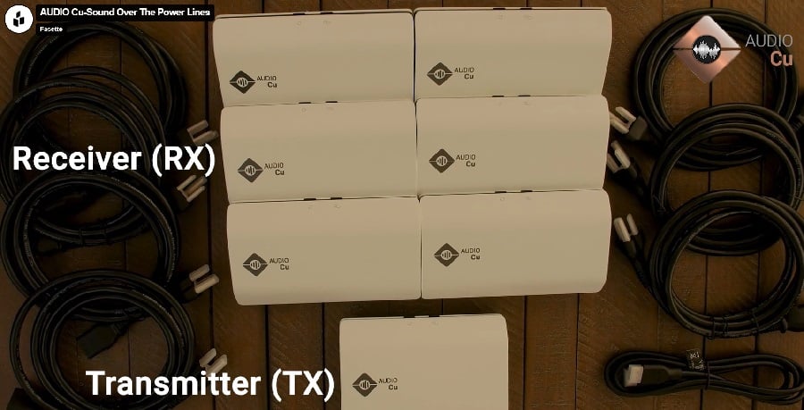

AUDIO Cu’s technology completely replaces the traditional audio-video receiver (AVR) and speaker cables to provide "a seamless solution for distributing sound to speakers and subwoofers throughout the home." The system can support up to 10 different audio channels per setup, allowing for configurations ranging from basic 2.0 stereo systems to immersive 9.1 surround sound, including Dolby Atmos setups as advanced as 7.1.2.
I always appreciate when companies design versatile products that can be used with multiple systems, some of which you may already have in your audiophile arsenal. In this case, AUDIO Cu allows you to customize your home audio setup using virtually any wired speakers. As long as the speakers feature traditional positive (red) and negative (black) terminals, they can be connected to the AUDIO Cu system, so you're not locked into a specific brand.

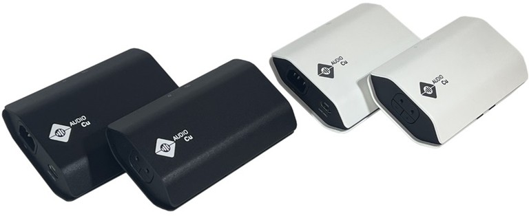

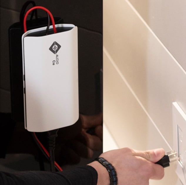

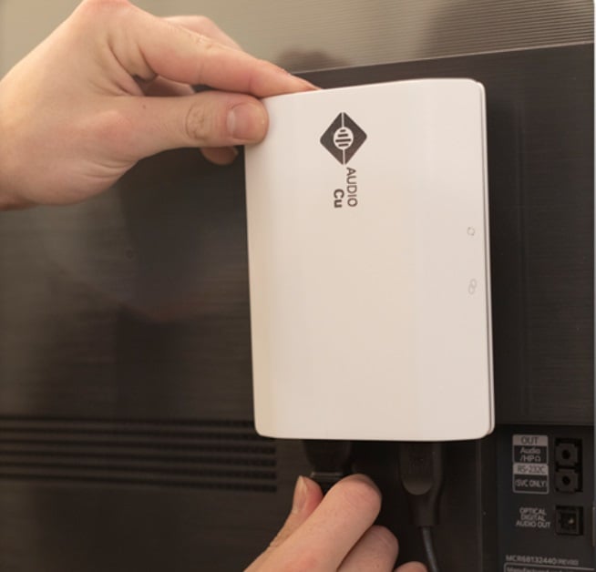

An AUDIO Cu setup is based on a transmitter and a series of receivers that not only accept the information but also power the speaker with a 65-watt @ 4Ω amplifier. For a 5.1 setup, you would need one AUDIO Cu TX transmitter unit ($800), which plugs into your TV or streaming device, and six AUDIO Cu RX receiver units ($400 each: 5 speakers and 1 subwoofer = 6 AUDIO Cu RX units). Each AUDIO Cu RX unit has regular +/- speaker terminals and a line out for a subwoofer or external amplifier. With the TX transmitter ($800) and six RX receivers ($400 each), the price for the system comes to $3,200 plus installation, but Fasetto offers the 5.1 system for $3,000. It's certainly NOT cheap, but it's damn convenient when you absolutely can't route speaker cables from your AVR to your speaker locations in your room and you still want a truly immersive surround experience.

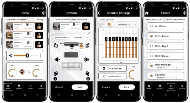

You can control individual speakers or entire systems using a mobile app available for both Apple and Android devices, which should allow for easy adjustments and access to a variety of audio presets and listening modes.

Audioholics has recommended Dolby Atmos setups as low as $1,500, including speakers, so the $3,000 price tag for a 5.1 setup may put some people off. Besides not including speakers, the price also does not include installation. Currently, the AUDIO Cu system is only offered through local installers. The setup time is roughly 1 hour, with no speaker wires to run, so that does simplify things. The AUDIO Cu system can support up to 32 speakers and subwoofers within a single household. The system would work not only for home theater enthusiasts but also for event setups, where high-quality sound and flexibility are essential.
