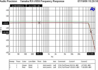

Yamaha RX-V659 Full Power Bandwidth Test (2CH Driven, 8 ohms < 0.1% THD+N)
At full continuous unclipped power (132wpc x 1;
8 ohms, 120wpc x 2; 8 ohms;
full bandwidth with less than 0.1% THD+N), the RX-V659 still maintained excellent bandwidth
linearity with a -3dB point of 65kHz despite the fact that we were driving the receiver way beyond its rated 100wpc
power specification. This was the type of performance we got from a $400 AV receiver only 13 years ago. You don't get an amp section this good in most AV receivers costing twice as much these days. Yamaha conservatively rated this receiver to be 100wpc and it over delivered. Bravo!

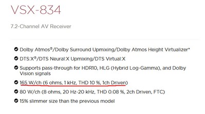

While most AV receiver manufacturers still rate power of their products 2CH driven FTC method, it's often buried in the user manual or shown below a much less conservative rating method as follows:
1CH Driven, 1kHz @ 6 ohms < 10% THD + N
Note: 10% distortion represents hard clipping on an oscilloscope and is only -20dB below the fundamental. This is very audible and should NOT be considered to be a usable long term power rating.
Top Image: Pioneer VSX-834 ; Bottom Image: Yamaha RX-A3070

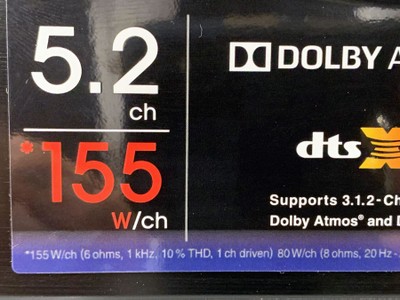

The Dreaded AVR Power Sticker
Dreaded 1CH Driven, 6-ohm, 10% Power Sticker on Newer Denon AV Receivers
This is really a 150 wpc receiver inflated to 260 watts.
Despite 2CH power specs are on most manufacturer websites, they still often stamp a 1CH driven, 6-ohm, 10% power sticker on the front of their AV receivers which is what the consumer sees first. BIGGER numbers sell to the uninitiated.
Sticker on Front Panel of an Onkyo Receiver Displayed at Best Buy
Notice how the inflated 155wpc power is the primary selling point of this product with very small fine print below disclosing the actual power is almost half that rating at 80wpc per FTC.
In our opinion, the 10%, 1CH driven power spec is a nonsense way of rating a multi-channel product and is only done so to inflate power ratings. A 150wpc receiver normally rated with 2CH driven can now be rated as 260wpc with this 1CH inflated power rating method. This gives the illusion that their AV receiver is much more powerful than it really is. It doesn't even account for the fact that said product couldn't deliver anywhere near this 260 watt power figure with multiple channels driven simultaneously.

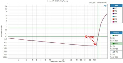

Understanding the Power vs Distortion Curve
Rating at least 2CH driven, full bandwidth, ensures the end user gets a product that can deliver real rated power for stereo music operation. It allows them to plan accordingly when matching speaker sensitivity and room output requirements to how much power they may need.
Denon AVR-X3300W Power vs Distortion (2CH Driven)
The horizontal line represents the linear operating region of the amplifier (where the noise floor dominates) while the vertical curve upward past the knee represents the distortion dominant region. Amplifier power should be rated to the left of the knee, NOT at the distortion dominant vertical region.

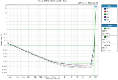

While some enthusiasts may rightly want All Channels Driven (ACD) tests all the time, it’s often impractical and not a real world test condition since there is never any time when real program material will require full-bandwidth power from ACD simultaneously. It's particularly impractical to rate ACD, especially in products with more than 7 channels of internal amplification because they will often exceed the available power from your wall outlet even if they were capable of delivering it.
Marantz SR8012 ACD Power Test
We currently do test ACD for receivers with up to 7CH driven in most of our reviews as you can see in the Marantz SR8012 power vs distortion graph above.
