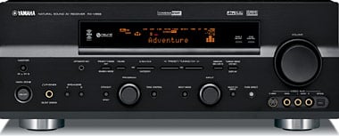

v659.jpg The Yamaha RX-V659 is a receiver cut from a different cloth from what we are accustomed to in this price class. It shared many of the virtues of its bigger brother - the RX-V2600 such as a large E-core transformer, large capacitor bank (71V 12,000uF Caps x 2). 50V caps would have been plenty to achieve 100wpc, though using 71V caps gives Yamaha plenty of design margin and added headroom since the rails can safely been swung much higher. There is nothing wimpy about the amp section of this receiver and as you will find in the Measurements & Analysis section of my review, this receiver is an overachiever and delivered MORE than its rated power.
The RX-V659 employees all burr brown 192kHz/24bit DACs and Yamaha's Top Art construction found on their more expensive receivers. All in all, I liked what I was seeing under the hood of this new budget Yamaha receiver and looked forward to determining if the sum of the parts equated to good performance and sound quality... a signature hallmark of Yamaha's high end receivers.

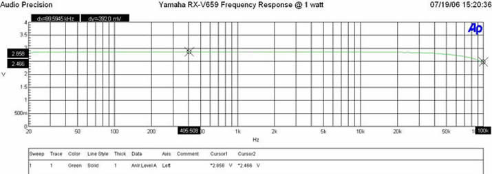

Power Bandwidth
RXV659-1watt
Yamaha RX-V659 Frequency Response at 1 watt
The Yamaha RX-V659 possesses a wide bandwidth amplifier topology with a -3dB point in excess of 100kHz.

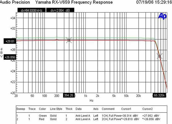

Full Power
Yamaha RX-V659 Frequency Response at Full Power
At full continuous unclipped power (132wpc x 1; 8 ohms, 120wpc x 2; 8 ohms; full bandwidth with less than 0.1% THD+N), the RX-V659 still maintained excellent bandwidth linearity with a -3dB point of 65kHz despite we were driving the receiver way beyond its rated 100wpc power specification. Into 4 ohms, the RX-V659 was able to deliver continuous power levels at a whopping 200wpc x 1 and 170wpc x 2 with less than 0.1% THD + N. The amplifier section of this receiver is truly underrated. I never encountered a budget A/V surround receiver that could deliver this kind of power before. Truly amazing.
Keep in mind most review publications don't do continuous power measurements and they usually publish power measurements into clipping at 1% THD + N. Our measurements are very conservative and it is clear that this receiver is a true workhorse for its asking price.

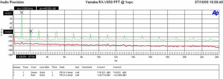

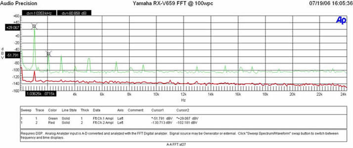

FFT Distortion Analysis
RXV659FFT1watt
FFT Analysis @ 1 watt
At 1 watt into 8 ohms, the RX-V659 exhibited impressively low distortion (9.031+74.521)dBv = 83.56dBV or 100*alog^-1(-83.56/20) = .007% THD + N which is very clean as expected.
RXV659FFT100watt
FFT Analysis @ 100 watts
(29.067 + 51.791)dBv = 80.86dBv or 100*alog^-1(-80.86/20) = .009% THD + N which indicates as per my power measurements, the amp section in this receiver is too conservatively rated. Most impressive for a $1000 receiver let alone one that costs roughly half of that!

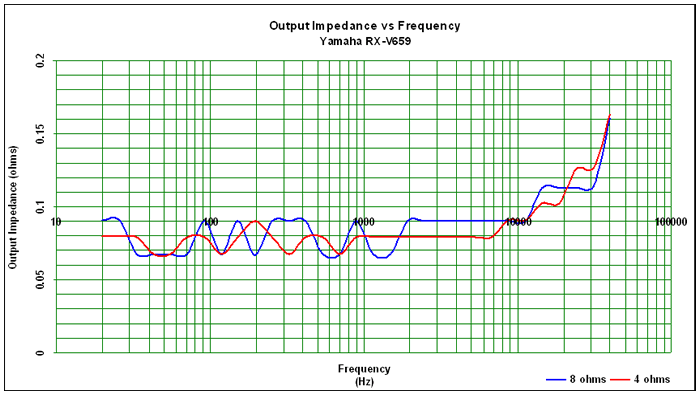

Amplifier Output Impedance & Damping Factor
The amplifier output impedance fell right within our desired 100 mohm or less mark for the entire audible bandwidth up to 10kHz with just a slight increase above at the upper 20kHz frequency range. This is the type of performance I like to see in an A/V receiver and not expected for a product of this price class.

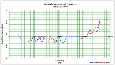

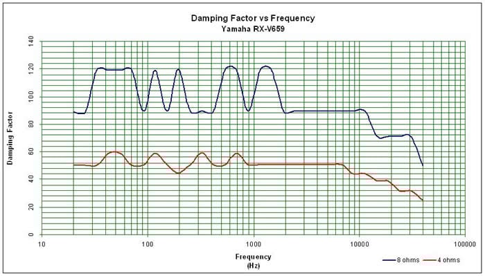

damping
Amplifier Damping Factor
The amplifier damping factor is about what I expected based on the measured output impedance. It is uniformly good across the entire audio frequency range and falls slightly under the 90 mark above 1kHz we like to see on uncompromising designs. All in all, this is quite an impressive result and rivals some of the earlier and more costly Yamaha receivers we have reviewed in the past while also exceeding our minimum 50 value we like to see in amplifiers for 8 ohm loads and even does so with 4 ohm loads as well. We've never seen such stellar results in a receiver of this price class.

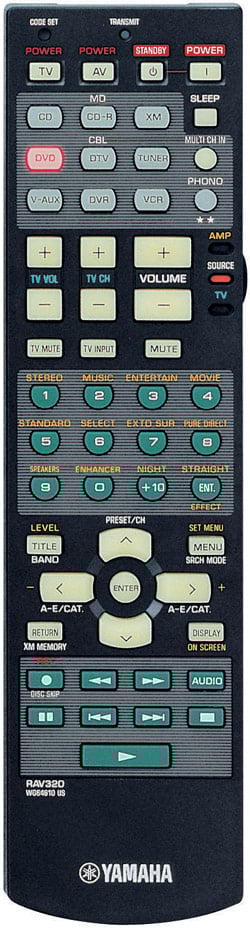

RemoteThe RAV remote controls are easy to operate, and have powerful feature sets though this model is somewhat limited in function compared to some of their higher end units. Now all we have to do is get Yamaha to fully backlight the RAV354 and we can retire the clapper.
  • Fits nicely in the hand, new thinner design
  • Dedicated receiver volume
  • Source switch for controlling inactive components
  • Seafoam button labels unreadable in dark, even with backlight
  • Backlight barely lights up keypad
  • Non learning remote - must rely on factory presets to control other products
The RAV320 is a basic functional remote one would come to expect in a product of this price class. It has no LCD display, no learning functions and very limited preprogrammed user codes for other manufacturers. Bottom line if you wish to operate your entire system off one remote, don't try to do it with this one. Very cost effective and excellent universal remotes can easily be had for $100 or less from brands like Harmony and Universal Remote. Leave this function to the companies that focus on nothing else but remote controls. The RAV320 did what it was supposed to do quite well - operate the RX-V659 receiver. Nothing more could really be stated here.
