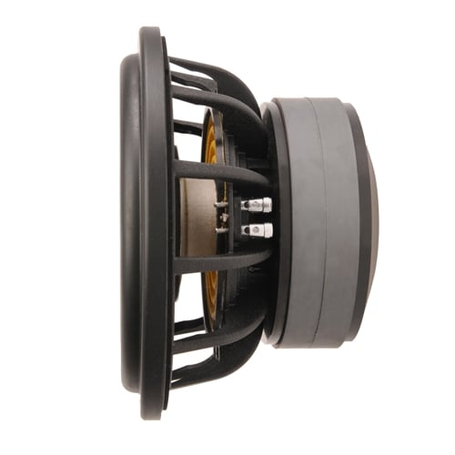

The 12” high performance, long-stroke, FEA-optimized woofer is designed for high output and low distortion. Suspension geometry and VC length prevents bottoming of VC against the back-plate.
The PB12P Plus DSP subwoofer is designed to pass CEA-2010 at max drive levels at all test frequencies (20 – 63 Hz) within intended pass-band in both bass reflex tuning modes. This sub is designed for high bandwidth linearity with respect to distortion-limited output to ensure excellent clean output capability in the 16-32 Hz octave where most subwoofers traditionally struggle.

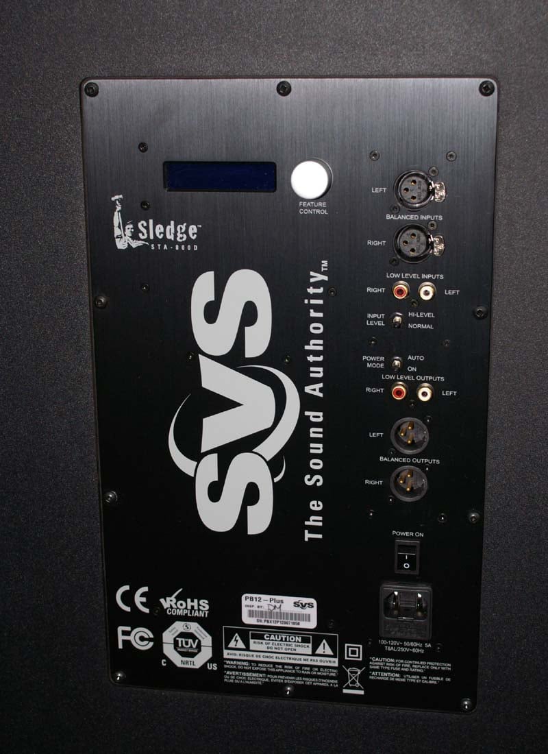

While I have no bones with the amplifier performance, I did get a little frustrated trying to operate the amplifier with only one knob, which handles several functions. This is not an uncommon approach with DSP, as all the settings are software based, not hardware based, so you do not turn a potentiometer (volume control) to reach the value, you simply dial in the number and the software does the calculation. Just tell it what function to do, and then select the value. While ALL the other amplifiers used had dedicated knobs for each function, being software controlled the SVS amp required you to tap the single control knob like a mouse (twice fast) for it to go between functions. At first I found it frustrating. Frankly, I don't care for having to guess what the programmer wanted to do, and I am not one of those folks who can pick up an Iphone and just start using it. Everyone else at Audioholics thinks I am not too hip, and they may be right. SV Sound has an online PDF format manual for those wanting to find out about using the products, so I guess I am complaining for being old and lazy. Seeing as how I have been around subwoofers for 20 plus years, I have no patience for these kind of ergonomics. I am old school and I want a knob for every function! I guess I will have to cope.
If you are comfortable with this kind of control, you will not find any issues with the parts efficient and completely digital SVS approach. In all, it took me about 4-5 minutes of playing around to get it, and that is without cracking the manual open. If you read through it, it should be very easy to set up. An advantage of the SVS approach is that their amplifier has a user selectable low pass filter with adjustable frequency and slope (12 or 24dB per octave) at the touch of the button. The amplifier also has a high pass filter for the line level outputs with the same frequency and slope selections as the low pass filter. This will allow the user to implement a true crossover (for both frequency and slope) between the satellite speakers and the subwoofer for 2-channel applications. The amplifier also includes a digital delay on the line level outputs to compensate for the latency of an external subwoofer equalizer, so that the subwoofer and the speakers can be time-aligned in 2-channel applications. These aren't features any of the other amps could boast about in our subwoofer shootout comparison.

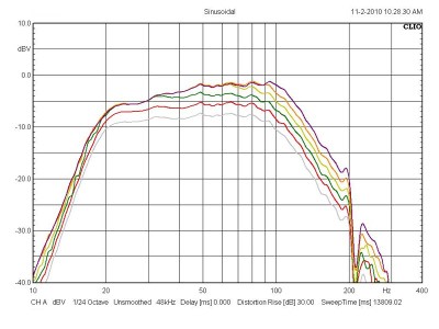

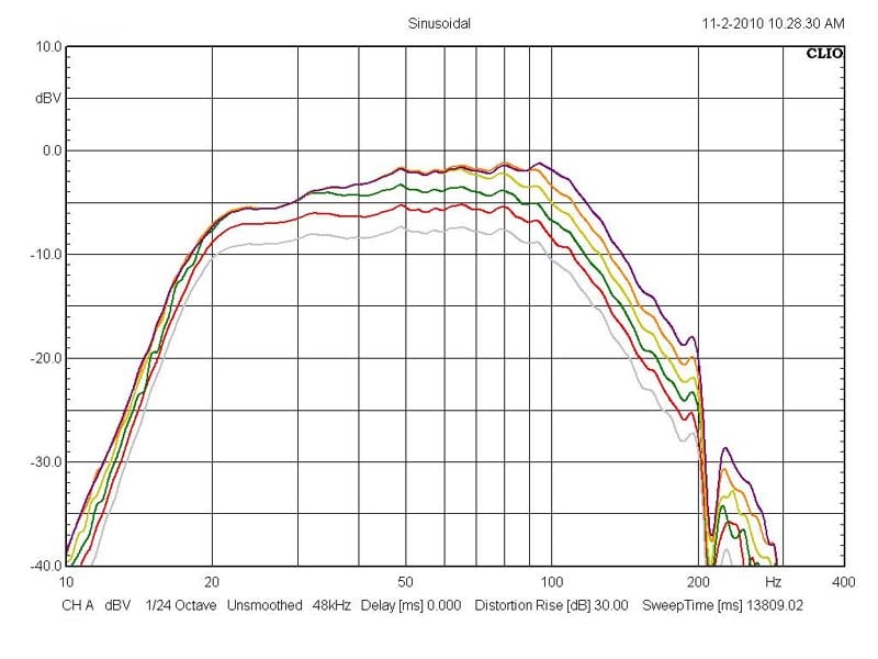

The first part of testing was to measure the frequency response from a modest output, all the way to the point where the system was clearly compressing and had hit the output wall, so to speak.
SVS PB12-Plus DSP Frequency Response at Various Output Levels
While there are a great many options to choose in the DSP controlled “Sledge” amp, I picked only one setting to use for the CEA testing. It is possible with the PB-12 Plus, to use the box in a sealed or "step down" mode of 16 Hz by inserting the supplied foam plugs into the ports. I chose not to do this, as the CEA testing standard has its lowest center frequency at 20 Hz, and because all ports open is the standard way in which the product is shipped. With all ports open for testing the box is tuned to 20 Hz. (Fb = 20 Hz). The high pass filter was set at 20 Hz and the low-pass set to 120 Hz, at 12 and 24dB/octave rolloffs respectively. I used these settings for both CEA testing as well as my listening. While 120 Hz is higher than 95% of you will use the product in practice, it creates additional stresses on the amp and can reveal some issues at the top end of the subwoofer or with the amplifier's compressor which may otherwise go unnoticed using a lower cutoff frequency. As you can see from the rapid roll-off below 20 Hz, the filter in combination with the natural port roll-off of 24dB/octave below cabinet tuning is close to the predicted 36dB/octave slope. It is not quite exactly this, as there is some equalization around the port tuning frequency so that maximum extension can be achieved without losing large amounts of driver sensitivity higher in the subwoofer's passband (50 - 100 Hz). At just above 200 Hz, we see a notch I believe is an anti-phase output from the port. Fortunately this is high enough that it should not prove audible with music. (I didn't hear anything objectionable while listening, even with the ports pointed in my direction).
If you look carefully at the curve above, you can see how the compressor unit deals with excessive power at low frequencies. Let's be clear, excessive power at what are for a subwoofer relatively high frequencies will simply burn out the VC. At low frequencies this is not the case. There, they will simply cause the driver to mechanically beat itself to death (excursion overload!). What is clear from the curves above, is that from 32 Hz and down, 4 different drive levels, 8dB apart, produced the exact same SPL between 20 and 32 Hz, but different SPL's at 100 Hz. So, the compressor is not acting on voltage limitations only, but is by utilizing the computational power of DSP, looking at the frequencies simultaneously so that it not only protects the unit from burning up, but what is a much more enduring and common problem for subwoofers that are overdriven, and that is, beating themselves to death at the lowest frequencies they handle. While this solution does not require DSP to implement, (not that it hurts) there are not too many engineers walking around with a clear idea about how this is to be done well. SV Sound circuitry reacts to overdriving by expertly compressing the signal in a way which is not clumsy, slow or leaves anything to chance. No driver complaints, and no nasty sounding amplifier compression artifacts. The only thing you could ask for is more output. To get that at this price, you'd likely better have family in the cabinet making business and friends who sell raw drivers and Kilowatt amps cheap.

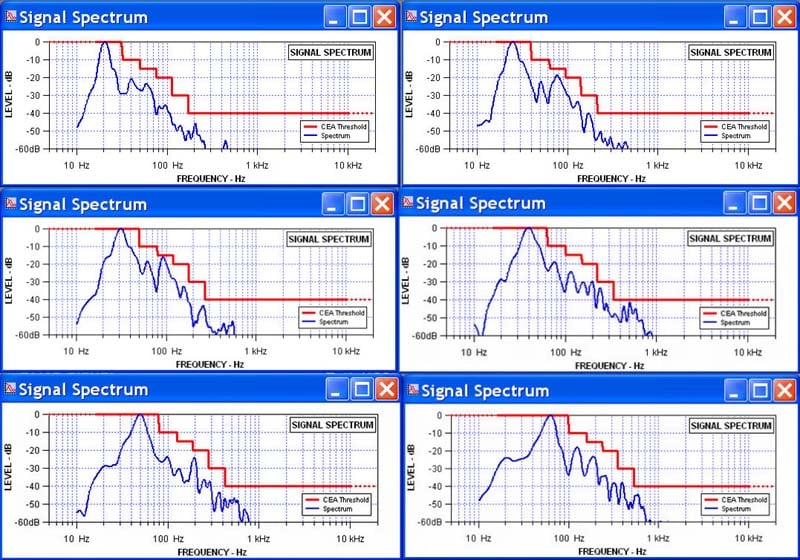

CEA-2010 Test Results

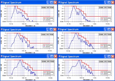

On to the CEA 2010 testing. To understand the meaning behind the graphics below and testing methods used, please refer to the prior article (Subwoofer Shootout Measurements Overview) on this method. The process is a simple one. Drive the input to the system to the point where either the amp, its compressor, or its speaker simply refuses to give you more output, or the distortion created at that output level exceeds the CEA “redline”. In EVERY system tested, the result (if not the peak SPL) was similar in one regard. At the highest frequencies in the sub's bandwidth, we ran out of amplifier power, or the compressor refused to put out more power than the amp could cleanly deliver. At the lowest frequencies, the subwoofer runs out of excursion. This is completely normal and what is to be expected. It may also explain why the CEA standard does not bother testing higher than the center frequency of 63 Hz. Below is a spectrum capture of the SV Sound PB12-Plus DSP system at maximum usable output.
SVS PB12-Plus DSP CEA-2010 Distortion Test Results
SV Sound PB12-Plus | CEA Test Performance | |
Frequency | Maximum Peak SPL @ 1 Meter | RMS @ 2 meter with DSP Correction |
20 Hz | 114.4 dB | 107 dB |
25 Hz | 117.0 dB | 109.5 dB |
32 Hz | 119.0 dB | 111.5 dB |
40 Hz | 121.4 dB | 114.3 dB |
50 Hz | 122.8 dB | 115.3 dB |
63 Hz | 122.8 dB | 115.3 dB |
Max SPL Output Data of the SVS PB12-Plus DSP Subwoofer (1 meter groundplane)
Why not test this speaker up to 80 Hz? Surely it is important, no? Yes of course. Two primary reasons I believe that the CEA standard excludes an 80 Hz measurement. Any large sub will be amplification limited by the time it is going as high as 63 Hz. Looking at 80 Hz will add little to the value of the testing. The reason the SV Sound sub limits at 122.8 Hz for both 50 and 63 Hz is not simple coincidence. This is the point at which the amplifier “runs out of gas”, in this case the compressor itself puts on the brakes to continue the analogy. Going higher in frequency should not yield a different result with any real serious subwoofer. Let's also bear in mind the CEA pulse signal centered at 63 Hz is only 3dB down at 80 Hz, so if the sub was falling off that low it would affect the 63 Hz measurement as well.

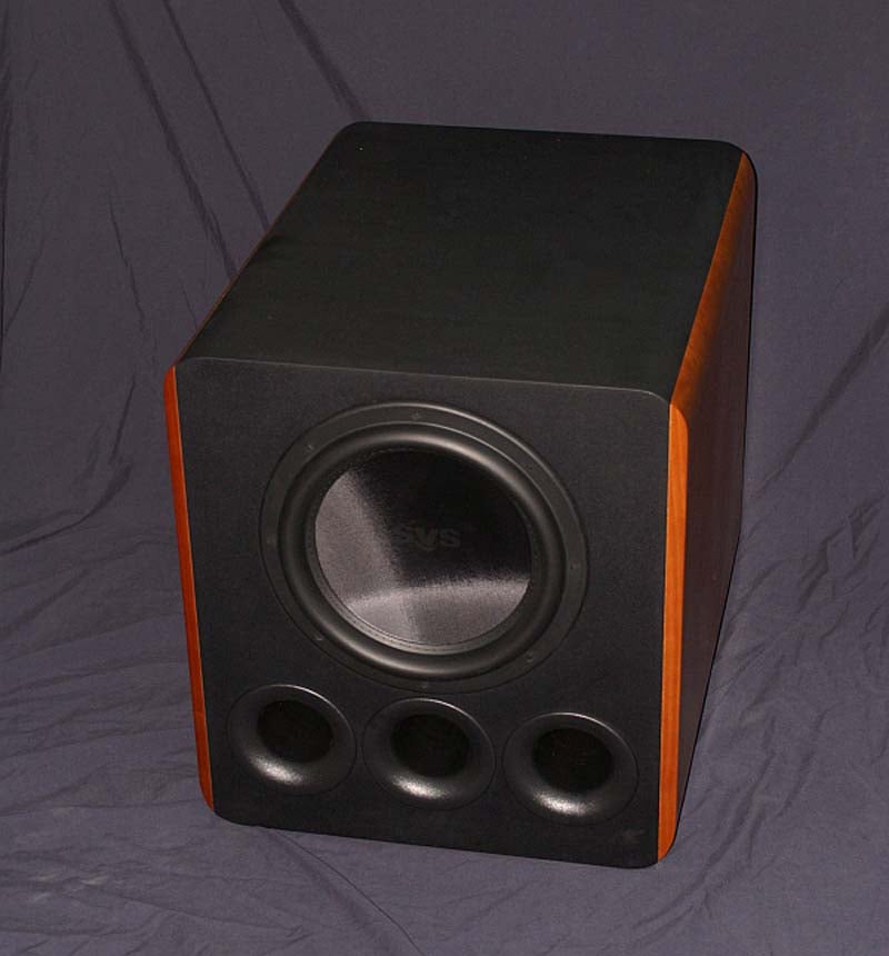

The SVS PB12-Plus DSP subwoofer has a solid sound, and overall
excellent performance. My testing was mainly concerned about usable
low distortion output, so I paired the sub with a pair of the high
efficiency (about 97.5dB/watt) prototype B52 Matrix 1000 Version 4
satellites driven with a 725 watt per channel amp. The SV Sound sub
seemed to run out of steam at about 80 watts RMS level into my
satellites, which is about 115dB in my lab. That's LOUD; REALLY LOUD.
I was able to play this sub about as loud as any other in the shootout
or more so. The system was pushed very hard, and with the low pass
filter set to 80 Hz, no matter how hard I pushed it, is sounded under
control and played without perceptible distortion. However, with the
crossover set up as high as 120Hz (necessary to allow some overlap
between the satellite speakers which only went down to 100 Hz),
Listening to the sub alone playing material, I thought I could hear
some distortion products from pushing the compressor hard. I am
doubtful that with the tops also playing, this would have been anything
other than a slight annoyance, if it was even audible at all. We
encourage anyone considering purchasing this subwoofer for home theater
usage to pair it with a multi channel speaker system that plays flat
down to 80Hz anyways. The SVS handled everything I threw at it, and
performed essentially without flaw. This is something we could not say
about some of the other subs in our comparative shootout.

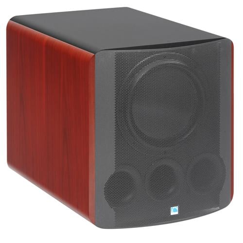

Visual Impressions

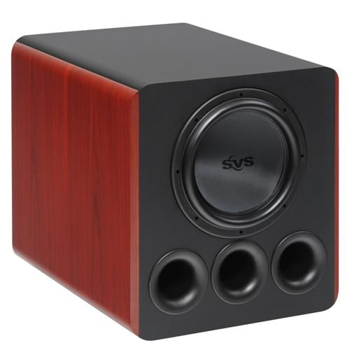

Of
the several B52 employees who saw the cabinet, no one really liked the
appearance of the American Cherry veneered cabinet. SV Sound offers
this cabinet in 4 finishes (1 more being closed out). When I first took
it out, I spent about 5 minutes looking at it, trying to decide whether
or not the finish was real veneer, or just vinyl. (If I was smarter, I
would have just checked the outside of the cardBoard box...) If vinyl,
I suppose that would be good. If veneer, not so much. The color was a
strange cast of red. Now Cherry is one of my favorite woods, and it is
supposed to be reddish. I prefer the darker reds to the lighter ones.
When our chief carpenter looked at it, his first impression was the
wood was pine. Then he said, no, maybe maple. It seems pointless to
argue taste, but no one who saw it really liked the veneer or the color
all that much. Everyone who saw it, had to look at it for a while, and
no one seemed really sure what they heck they were looking at! I was
surprised at how uniform the visual response to the cabinet finish was,
but felt better knowing it was NOT just me.... Having said all that,
after seeing it for a week, I have grown accustomed to its shade, and
am sure someone somewhere with a room full of Cherry furniture thinks
this reviewer simply has no taste. Since a picture is worth a thousand
complaints, you can judge for yourself by looking online and see if you
like the finish or not. http://www.svsound.com/products-sub-box-pb12plus.cfm#
