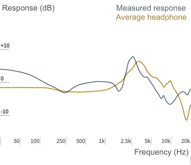

One interesting aspect that Breebaart uncovered was how closely the average response of all the headphones followed that of an accurate loudspeaker’s in-room response, the ‘neutral’ response. According to the research of Sean Olive, Todd Welti, and Elisabeth McMullin, the response of an accurate loudspeaker in-room was found to be very close to the preferred response by listeners. However, when the average of all measured headphones in Breebaart’s survey was compared to the target response curve devised by Olive, Welti, and McMullin, the average did have more energy in the 50 Hz to 2 kHz region than the target curve. The average curve also had substantially less deep bass below 30 Hz than the target curve. It should be stressed here that the averaged curve deals with a lot of different headphones, and their response varied greatly. You can’t pick a set of headphones at random and expect its response to resemble the averaged response curve from this measurement set.
Another feature that emerged from Breebaart’s study is that the average response of circumaural and in-ear headphones more closely matched the ‘accurate loudspeaker in-room’ target curve than the average response of the supra-aural headphones.

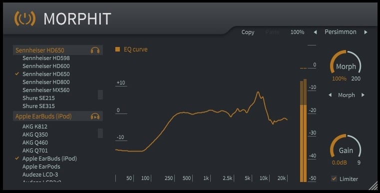

Furthermore, a capable enough headphone can reasonably simulate the qualitative sound of any other headphone with equalization. Olive, Welti, and McMullin did just this in their study “A Virtual Headphone Listening Test Methodology” where they used a plethora of filters to make their Sennheiser HD 518 headphones sound like other headphone models. In light of this, it looks to be possible to have a inexpensive headphone mimic the sound quality of an expensive headphone, so long as the frequency band range and dynamic range are available. In fact, this is the goal of the TB Morphit, a VST plug-in that can shape the sound character of a wide variety of headphones to imitate that of another model, or aim for another response such as more neutral responses. One of the reasons for Breebaart’s study is to determine if there was a case for TB Morphit, ie. software that could use one pair of headphones to emulate others, or, as Jeroen told me, “One of the main reasons for looking into headphone frequency responses was actually to see if there would be a case for headphone correction tools, and whether there is a specific price category for which that would be useful.”
Morphit
Reportedly TB Morphit works very well in recreating the sound of one headphone in another headphone. There might be some small differences, however, such as manufacturing differences in the measured model or user’s headphones. Also, if the headphone was seated differently on the test dummy’s head than the user’s head, that could cause a slight difference. Aside from these differences, which are not likely to be severe, TB Morphit should recreate the sound character of any headset on any other headset in its list of headphone profiles. From a sound quality perspective, with TB Morphit, once you have purchased any headphone of their list, you can then listen to any other headphone on that list of profiles. Buying one headset with TB Morphit allows you to experience the sound of all 143 other headphones profiled, along with a handful of generic profiles including the ‘neutral’ curve. More headphone profiles are expected to be added in the future.
