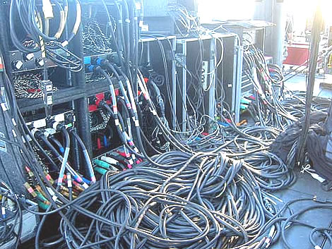

picture quality. Going HDMI also simplifies your connections so the back of your A/V rack doesn't wind up looking like mine pictured to the right :)

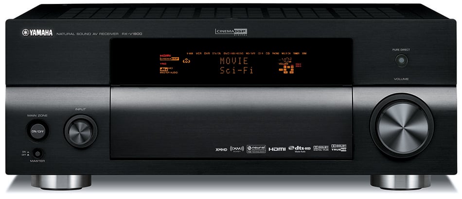

Examples: Yamaha RX-V1800, Marantz SR 7002

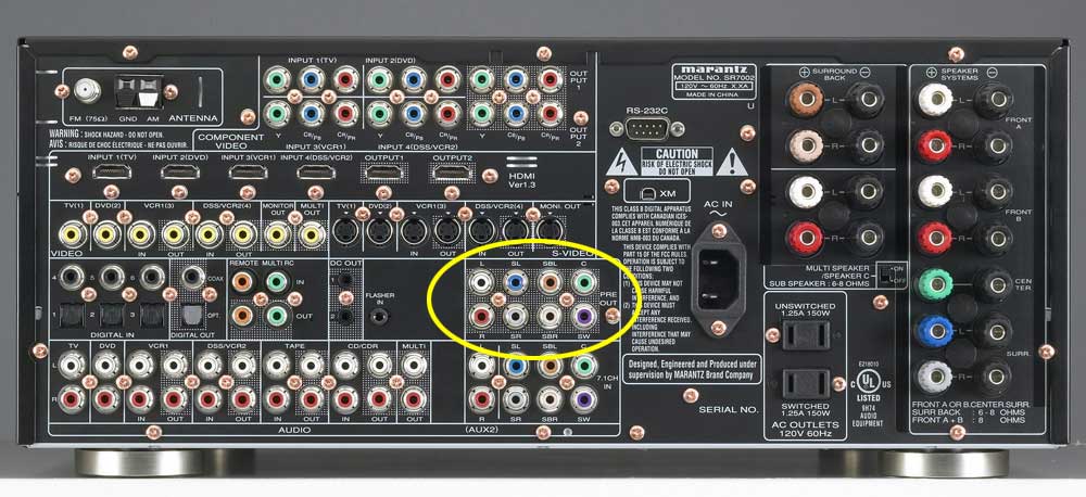

While most $300 and up receivers today have 7.1 multi-channel inputs, many of them do NOT have preamp outputs. Preamp outputs are a necessity if you plan on pairing your new receiver with a more powerful external amplifier. This is usually a good idea when mating a receiver with low impedance, low efficiency speaker systems. If somewhere down the road you plan on eventually purchasing an external amp for this purpose and you are choosing between two receivers both of which have preamp outputs and inputs and the basic features you need, buy the cheaper receiver. Separate multi-channel amps usually have more power than even the best receivers on the market. Don't assume even a reasonably costly receiver will have preamp outputs. Always check the back panel. We were quite surprised that Denon didn't include this feature on their excellent AVR-2308CI A/V Receiver which retails for $850.

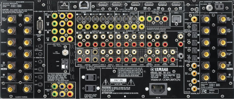

Examples: Marantz SR8002, Yamaha RX-Z11, Denon AVR-5308CI

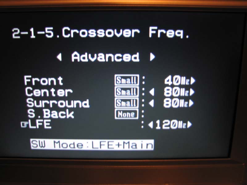

Step 6: Do you need advanced bass management features?
In most
cases the typical 80Hz global crossover setting and one subwoofer output will
satisfy more users. However, more advanced users will prefer variable crossover
settings per channel group and multiple independent subwoofer outputs. For the more advanced user, we suggest digging
deeper to ensure that your receiver of choice truly does provide you the
flexibility of connecting more than one subwoofer that has independent level
and distance trims and will also give you the option of routing LFE and/or bass
from all speakers set to 'Small'. There
are several processors on the market that simply parallel out the main subwoofer
output which limits your setup options. We
have found Denon to be the leader in bass management flexibility but lately
Yamaha, Onkyo and Marantz are catching up and offering multiple crossover
selection per speaker groups, sub out with main speakers set to 'Large', and
multiple subwoofer outputs, etc.
