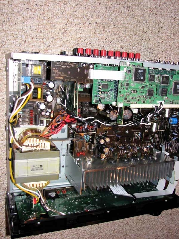

Denon AVR-2308CI Build Quality
The Denon AVR-2308CI’s build quality is what I’d expect from Denon at this price point. Sturdy construction, with a brushed aluminum faceplate, detachable power cord and binding posts for all speaker connectors come standard on this unit. The chassis is certainly well secured as I had to remove 11 screws just to get the top cover off to take this picture. The power supply is about average from what I’ve seen in this price class, sporting a decent sized power transformer and two 85 deg C rated 12,000uF 71V power supply capacitors. Denon didn’t skimp on putting a nice solid aluminum finned heat sink in this receiver as so many other companies tend to do at this price class. It’s an indication to me that this baby’s got more juice than the spec sheet shows as we will soon find out on my test bench.
Editorial Note
In order to hit the rated 100wpc Denon is claiming, they would require a rail voltage of sqrt(2)*[(100*8)^1/2 ] = 40V + 5V(margin) = 45V. As you can see their capacitor bank has plenty of overhead to meet this requirement.

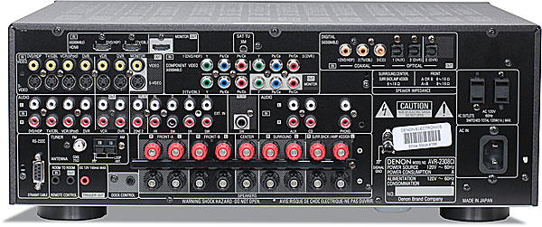

Back Panel View of the Denon AVR-2308CI
The AVR-2308CI certainly has an impressive backside but it is lacking one feature I am mildly disappointed in – preamp outputs to connect external amplification. I understand however at this price, Denon is banking on most people not pairing this receiver with other amplifiers, but as I found when reviewing this receiver, it’s got a heck of a good processor section that would serve quite well as an inexpensive pre/pro for someone to pair with their more powerful stack of amplifiers. Well, it would have if Denon included preamp outputs. Since they didn't on this model, you will have to settle with using its internal amplifiers to power all of your speakers.
The AVR-2308CI has two HDMI 1.3a inputs and 1 monitor output, 3 coax and two toslink digital inputs, and one toslink digital output. The detachable power cord and 150mA high current 12V trigger was a nice touch at this price point. I can think of many products at 4 times this price that still utilize wimpy 10 or 15mA triggered outputs which wont work with most motorized screen systems and power conditioners. Kudo’s for Denon on using an extra current amplifier stage to make this port more useful to the integrator and end user.

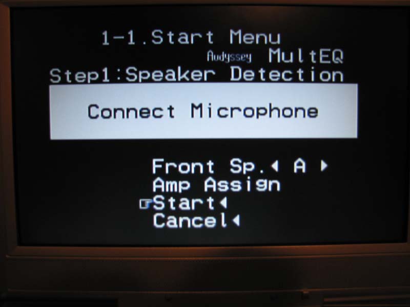

Auto Setup Via Audyssey
The AVR-2308CI is armed with Audyssey’s MULTEQ automatic room correction system which checks and configures:
- Wiring
- Distance
- Speaker Size
- Equalization
- Level
Although this version only does 6 point calibration compared to 8 point on some of Denon’s higher end receivers, I found it worked just as well, and perhaps a bit better than the system on my older AVR-5805. I went through the setup process only once and Audyssey did quite a bang up job configuring the system despite all of the speakers were in-wall type which can cause auto correction systems to overcompensate for speaker correction due to boundary gain.
I was pleasantly surprised to find Audyssey pretty much nailed the distance, channel trims, speaker size and crossovers correctly. I did however make a few tweaks in level and distance (.5dB, 1/2ft, respectively) and also had to adjust the rear channel crossover from 60Hz to 80Hz which I found to be a better crossover point with the system. I was happy to see such promising results and was looking forward to the listening tests to see if Audyssey could help tame my parent's rather lively room which has high vaulted ceilings and wood floors.
There are a few quirks that trouble me with the implementation of Audyssey on the AVR-2308CI. One of them is the fact that it takes around 20 seconds for Audyssey to advance to the next speaker after it takes a measurement. Without counting the actual time taking the measurements, re-positioning the mic or accepting the final results, you are forced to wait nearly 15 minutes if you calibrating a 7.1 system. I am not sure why there was such a long delay here as I haven’t experienced that on my AVR-5805 but it can be a rather painful process if you're inpatient like I tend to be. You better be sure to have a quiet room for at least ½ hour to complete the auto setup as you don’t want to be repeating measurements caused by noise interruptions. Once you go though this long calibration process, one would think they’d be done and ready to enjoy the sonic delight of room equalization, but they would be wrong. Instead, you now have to engage Audyssey which is harder than it sounds. Instead of having a hot key on the remote or front panel of the receiver, you must go through 3 layers of the OSD to get to it (Menu > Parameter > Room EQ > Audyssey). To make matters worse, there isn’t even an LED on the front of the receiver to let you know it’s engaged. Instead you have to look for a little “MultEQ’ text message on the front panel of the receiver to be assured it’s on or verify via the OSD that you selected either “Audyssey, or Audyssey Flat”. I would really have liked to see a hot key implemented on the remote so you could easily test the benefits of Audyssey, but in the end, I was able to manage via the OSD.

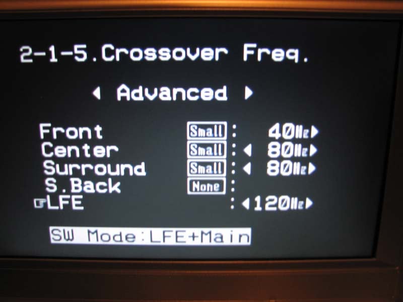

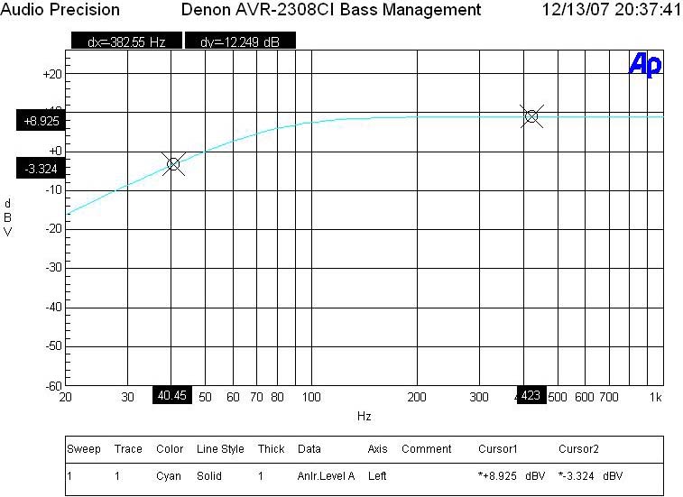

Bass Management
I’ve come to find one of Denon’s hallmarks is their excellent bass management and speaker setup options found on their flagship receivers. It’s nice to see some of these great features are carried down to even their sub $1k receivers like the AVR-2308CI.
Such stand out features include:
- .5dB channel trims
- .1ft delay adjustability
- independent channel trims per mode and input
- independent crossover settings per speaker pair and 2CH vs multi channel mode
- ability to combine bass from large main speakers to the subwoofer channel
I was quite surprised to find such a level of
sophistication here. Custom installers
and audiophiles rejoice as you can pretty much configure any type of speaker
system or scenario via this receiver until your heart is content. Best of all,
the filter slopes are per THX of 12dB/octave for the high pass filters to the
speakers and 24dB/octave for the lowpass filter to the sub. I also verified the
sub out has plenty of distortion free gain as I was able to achieve about 4Vrms
into a 100 ohm load at less than 0.1% THD + N which is more than enough drive
to gang multiple subs to this output.

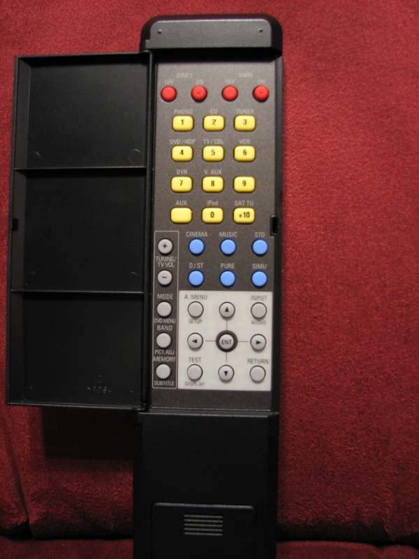

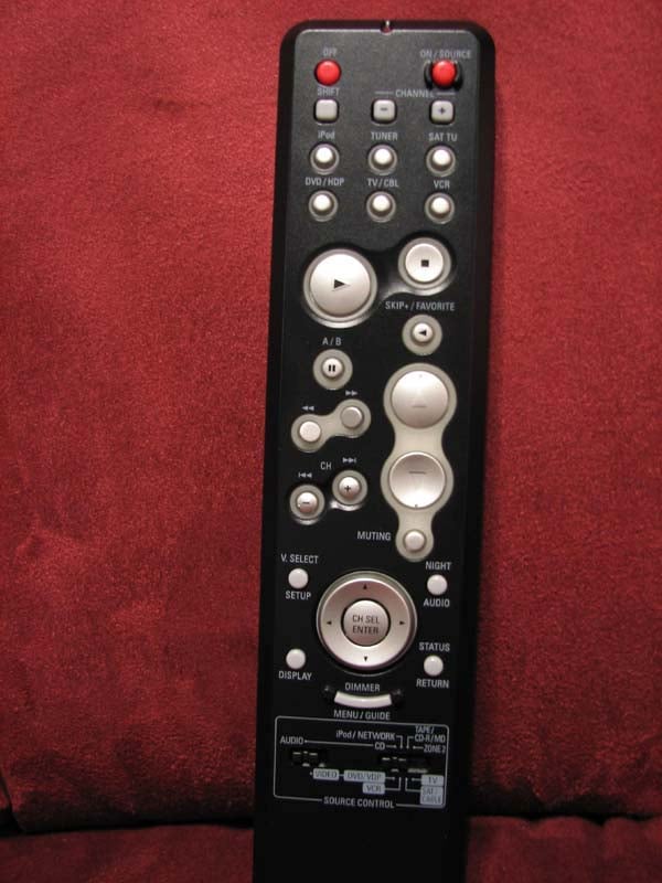

Remote Control(s)
Perhaps the weakest link in this receiver is the supplied remote controls it comes with. This is to be expected at this price point as most decent remote systems typically cost half the retail of this product alone. There isn’t much to say here other than the remote is rather archaic looking, is all push button, has no backlighting and quite annoyingly has many of its useful functions via the star trek style flip panel on the back of the remote. It took me a good 2-3 minutes to figure out how to engage the OSD of this receiver before I realized the menu button was on the hidden backside of the remote. In order to operate other Denon equipment such as a DVD player, you must flip a tiny switch at the bottom left corner of the remote which toggles it between “Audio” and “Video” modes of operation. I found this little button to be annoying and wished for an easy slider button on the side of the remote to do the same function. The Zone 2 remote is even more basic but it does allow you input selection, volume control and limited control of an iPod system. All in all, I would suggest investing in a good universal remote system and save these for reference when you need to do specific setup and configuration in the receiver that you cannot program into a universal type remote control.

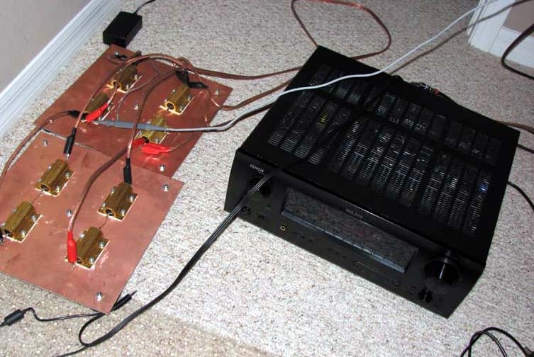

Amplifier Efficiency & Power Output
Amplifier
Efficiency Measurements for linear a/b amps such as the ones employed in this
receiver typically range from 40-50% depending on the load the power supply of
the amplifier sees. The closer you get to full load, the higher the efficiency
usually becomes (assuming you aren’t overtaxing the power supply and power
devices of the amp causing excessive thermal losses). The AVR-2308CI achieved above
50% efficiency when driven at near full power into low impedance loads which
was quite impressive for a receiver employing a conventional linear amp design.
This receiver runs relatively cool dissipating around 54 watts in idle but be
sure to give it plenty of ventilation for situations of heavy usage.
# Ch |
Power Consumption |
Continuous Power Output |
Load |
Efficiency |
1 |
270 watts |
150 watts |
8 ohms |
55 % |
2 |
441 watts |
130 watts |
8 ohms |
59 % |
1 |
405 watts |
211 watts |
4 ohms |
52 % |
2 |
690 watts |
190 watts |
4 ohms |
55 % |
Idle Power |
54 watts |
Note: All power output figures in this table are continuous and referenced to 1kHz but were also checked at full bandwidth to ensure the power figures reported were within 10% reported and at or below 0.1% THD + N.
The AVR-2308CI delivered a whopping 150wpc into 8-ohms and 211 watts into 4-ohms at 0.1% THD + N using my APC S-15 and SBATT to ensure the line stayed at 120V +- 2V. With 2 channels driven, it measured around 130wpc into 8 ohms and 190wpc into 5 ohms. Keep in mind most review publications test at clipping and don’t do continuous power measurements so our power numbers are usually a lot more conservative than what you typically find from other reviewers yet this receiver was delivering FAR more power than its rated specification of 100wpc.
For more info, see: The All Channels Driven (ACD) Test

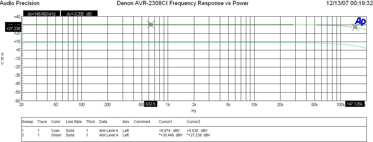

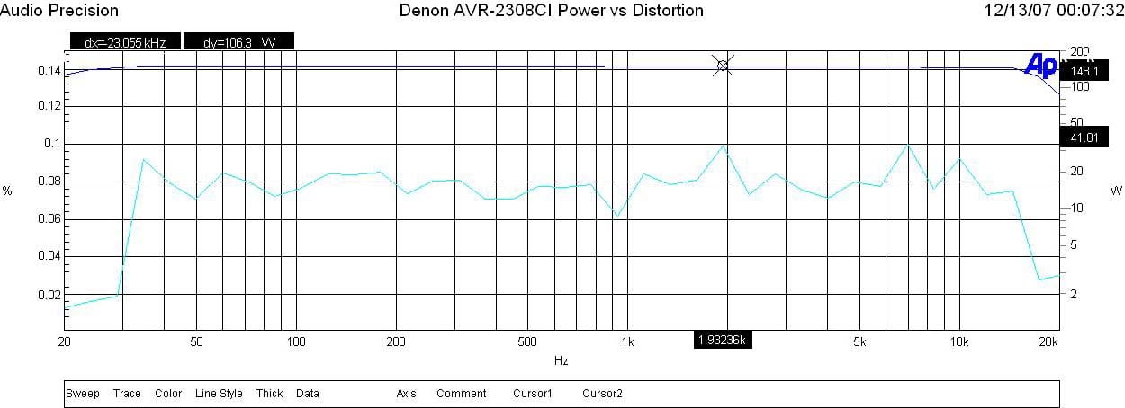

Power Bandwidth
Figure 1. Denon AVR-2308CI Frequency Response vs Regulated Power
Using input regulation where I set the Audio Precision SYS 2722 to regulate the output distortion to less than 0.1% THD + N, the AVR-2308CI belted out around 150wpc across the entire audio spectrum (20Hz to 20kHz).

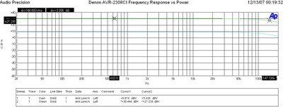

Frequency Response Uniformity
Figure 2. Denon AVR-2308CI Frequency Response vs Power
Whether I was driving the AVR-2308CI at 1 watt or full power, the amplifier section exhibited excellent frequency response uniformity with a -3dB point of around 147kHz.

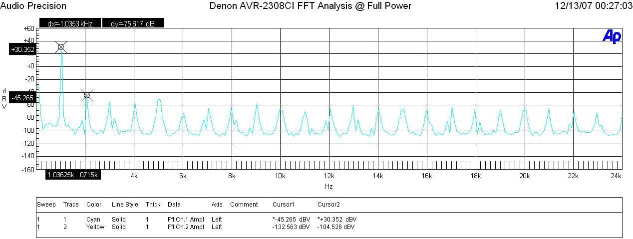

FFT Distortion Analysis
Figure 3. Denon AVR-2308CI FFT Analysis @ Full Power
At full measured power AVR-2308CI again exhibited excellent distortion measurements (30.352 + 45.265)dBv =75.6dBv or 100*alog^-1(-75.6/20) = .0166 THD + N which is a respectable measurement.

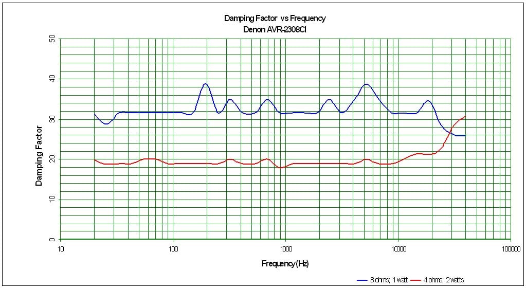

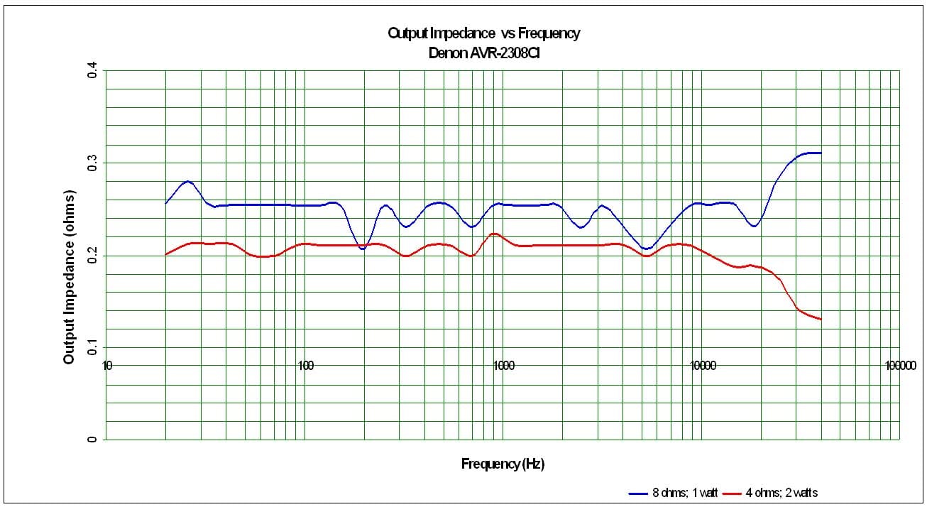

Amplifier Output Impedance & Damping Factor
Figure 4. Denon AVR-2308CI Amplifier Output Impedance vs Frequency
The amplifier output impedance was a good margin higher than our 100 mohm or less mark I’d like to see on uncompromising designs, but it was still very linear and under a few hundred milliohms which would make it quite capable of driving a wide diversity of loudspeakers with consistently good performance.
Figure 5. Denon AVR-2308CI Damping Factor vs Frequency
The amplifier damping factor is about what I expected based on the measured output impedance. It is uniformly good across the entire audio frequency range but does fall shy of our 100 mark for uncompromised designs. The good news however is the amplifier doesn’t fall apart when driving low impedance loads like I’ve seen on some models in this price range in the past.
