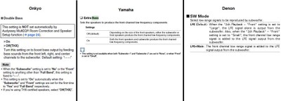

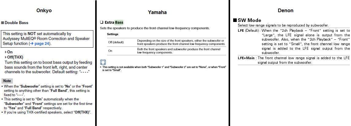

Extra Bass Settings
"Extra Bass" goes by a variety of names. This view of a selection of manuals from Denon, Onkyo, and Yamaha should give you an idea of what to look for.
The idea behind “Extra Bass” is fairly straightforward: if you happen to have main speakers capable of delivering respectable amounts of low end output without buckling, you can run them full range AND send a copy of their bass content to your subwoofer, effectively increasing bass output. To reiterate, this should only be used if you’re confident that your speakers can be fed strong low frequency transients without buckling or bottoming out.

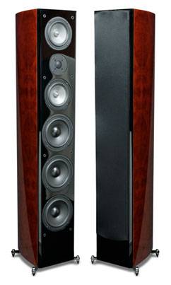

EMPTek E55Ti in Red Burl
EMP E55ti Tower Speaker
Regarding Tower Speakers and Bass:
With a trio of 6.5" woofers per side, the EMPTek E55Ti should have no problems adding extra punch to your system with "Extra Bass" enabled. They're also mechanically limited to prevent bottoming of the drivers, so you don't have to fret about damaging these towers by running them full range either.
