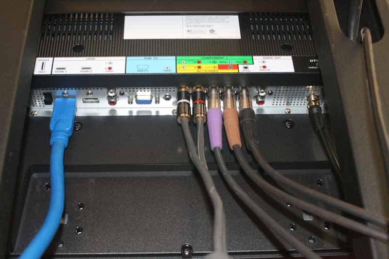

The back of the Vizio SV470XVT has two HDMI inputs, a component video input, HD15 (PC) input, Composite/S-video (shared), and an F connection point for NTSC/ATSC/QAM. There are also analogue and TOSLink digital audio outputs which allow the TV to be used as a source device for your AV receiver. This is extremely helpful for those who do not have a dedicated cableTV set-top receiver. Both rear HDMI inputs can handle audio, and a single analogue stereo pair of audio can be used between both inputs when needed. The HD15/PC input has an 1/8-inch input for stereo audio and the component video and AV inputs have their own analogue stereo audio inputs as well.

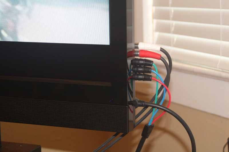

Where it gets a bit dicey is the fact that there are two more HDMI inputs, another component video input and a composite video input on the side of the Vizio. And when I say "side" I mean it. Right on the edge of the bevel of the right-hand side of the display. The fact that Vizio didn't place one of these extra HDMI inputs on the back of the display is perplexing. In my opinion, side inputs are for temporary connections - so having more than one of any type is a waste. Their presence on the very edge of the screen also means that you'll have all manner of unsightly cables splayed all over a very visible area of the display. The stereo analogue audio present on the side connectors is shared between the component and composite video inputs. The HDMI side inputs need to carry the audio as well since there is no analogue option provided.

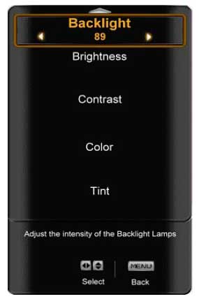

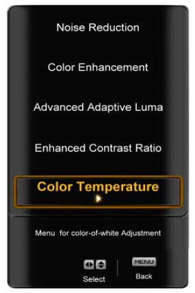

This allows you to adjust the florescent Backlight level, Brightness, Contrast, Color, Tint, Sharpness, and more. We'll get to the "More" later. The first thing I did was configure the Brightness and Contrast. The Vizio passes below black (blacker-than-black) and above white (whiter-than-white) information so it was easy to get the correct levels. I also found, as will be described later, that adjusting the Backlight didn't affect the black or white levels in the least, but merely varied the overall output of the television. This is good, and means that you might as well use a level of 0 for nighttime viewing, and 100 for daytime.
I found no reason to adjust either the Tint or Color controls. They are often unpredictable when combined with custom RGB controls (which were available - at least in part - on the SV470XVT). Continuing through the Picture menu I landed on Sharpness. From my testing I found that the default value of 4 causes excessive edge enhancement that could be noticed by a clinically blind housekeeper vacuuming the carpet in an adjacent room. Turn it down to around 1 for best results. This finally brought me to the Advanced Video settings.
The Vizio SV470XVT allows for adjustment of Noise Reduction which I found to be adequate but not stellar. It certainly reduced the amount of noise when maxed out, but the panel speed also showed a lot of blurring, which the NR circuitry didn't exactly help (though it didn't seem to accentuate it too much either). I ended up giving the Vizio half credit in this area. You'll want to leave the Color Enhancement circuit Off - it will only artificially adjust the color in a way that is not at all accurate. Advanced Adaptive Luma is almost the polar opposite of Enhanced Contrast Ratio (DCR). The first, adjusts gamma to compensate for darker scenes where detail is hard to discern. This may be good for video games (go ahead and try it out), but is sure to cause excessive visibility of macroblocking artifacts in feature films. The DCR circuit actually adjusts the backlight - dimming it during dark scenes, and raising it during bright scenes. The problem is that it takes, on average, about 4 seconds to make a smooth transition from one extreme to the next. This is both good and bad, but mostly good. Since the transition is slow, and most movies don't go back and forth from light to dark rapidly, the effect is that you'll probably enjoy a better overall contrast experience. This is one of those functions best left to the user to decide if and when they choose to implement it.

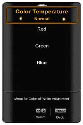

The Advanced Video menu is also where you'll find the Color Temperature system, which allows you to choose between Cool, Normal, Warm, or Custom. Here's how it broke down for us when measuring the system:
- Cool - 8700K
- Normal - 6200K
- Warm - 5300K

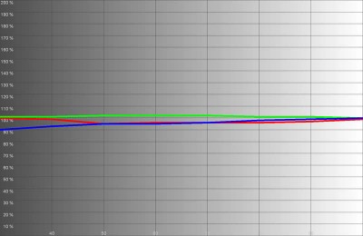

With the Custom setting, we adjusted Blue to 86 and left Red and Green at their default settings of 128. The result was a pretty respectable RGB color response from 7.5 IRE through 100 IRE. This was a pleasant surprise since we couldn't adjust gain and cut separately for each color. While HDMI and component video retained their own custom color settings, we found an odd quirk where if we changed the Color mode for one input, all inputs were equally affected.

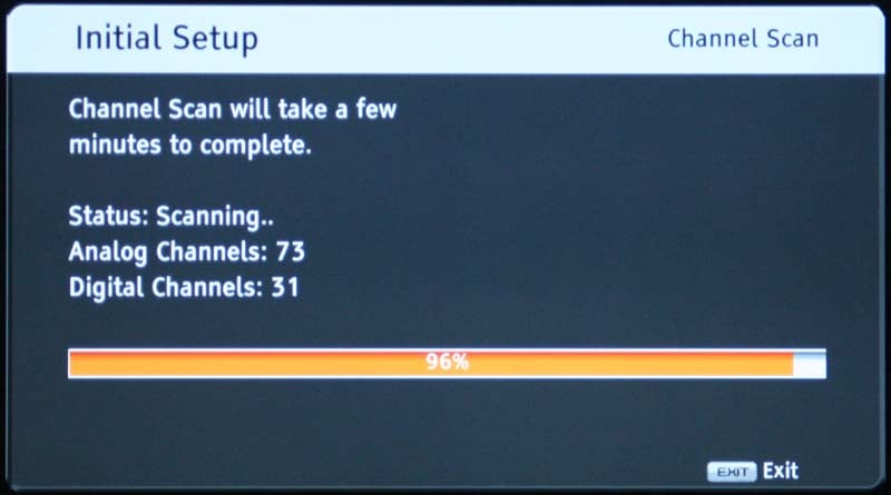

The TV menu is really the "tuner" menu and is the place to select antenna or CableTV and also program (or remove) channels into the system. Here you can set the MTS mode (great for those who want to listen in Spanish) and also set the Time Zone and Daylight Saving time for the program guide. I was actually never able to successfully get the Program Guide to show me anything beyond the currently-playing show - despite the user manual claiming it will go up to 2.5 hours out. This could be a function of my local cable provider, but if so then it's important to note potential difficulties in certain markets.

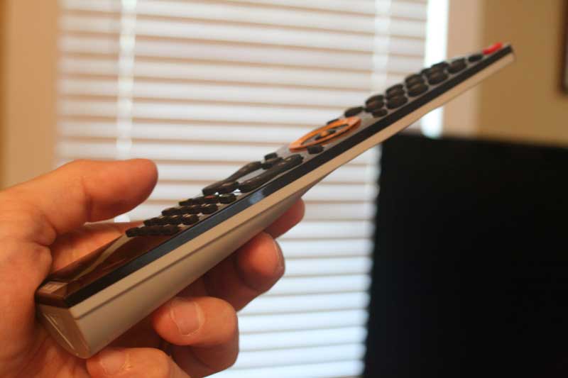

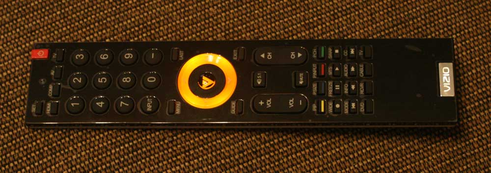

I love the look and feel of the Vizio SV470XVT remote. It is beautifully thin at top and tapers out just enough at the bottom to house the two AAA batteries. Even the way the batteries insert is cool - they drop in from the bottom rather than popping in from behind. The remote is not backlit, except for the center ring, which is really a directional arrow pad with a centered select button in the middle. It's technically capable of controlling a few other AV devices, but ultimately you'll want to get a good universal remote control to handle those duties. I didn't like the positioning of the input selection buttons at the top of the remote as they are a bit out of the way. Additionally, there are no direct inputs for each input, merely each input type. This means that you'll need to hit the HDMI button 4 times to get to HDMI 4. Taking up prime real estate is the 5.1 audio button, which is useless unless you have the optional 5.1 Surround Sound Upgrade (which I've not seen anywhere, including the Vizio website).
Below the Volume and Channel controls you'll find a whole transport section which is also a dual-use area for functions such as Wide (scaling), Info, Audio, MTS and PIP controls. Below that, at the very bottom, are the controls for selecting and using other programmed AV devices. It's an acceptable remote, but it could be a lot cooler.

We calibrated the display using Datacolor’s Colorfacts Professional 6.0 software and found that while the set was a tad "blue" to begin with, we were able to quickly dial it in to very reasonable levels. The SV470XVT has Red, Green and Blue controls but they are not separated into Gain and Cut controls. The biggest items we wanted to test were the new 120Hz modes and the display's ability to process (correctly) 480i DVD content. Let's face it, there are a lot of consumers who will purchase this TV who many not necessarily be interested in updating their DVD players just yet. For those using Blu-ray or higher end upconverting players, I wanted to make sure the new 120Hz processing didn't compromise the already pristine image.

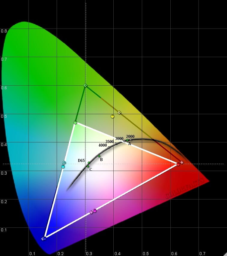

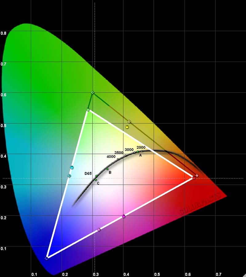

CIE Chart – Color Reproduction & Saturation Potential
After measuring the primaries of the SV470XVT, we noted that it really nailed both Red (almost) and Blue (completely) with Green coming in a tad more towards Cyan (which I prefer to drifting towards Yellow). What this means is that the Vizio has excellent color reproduction - better than several more expensive displays we've tested this year.
In comparing the CIE charts of the Vizio vs the recent Mitsubishi LT-46148 LCD review, you can see that the SV470XVT stacks up pretty well in terms of color reproduction:

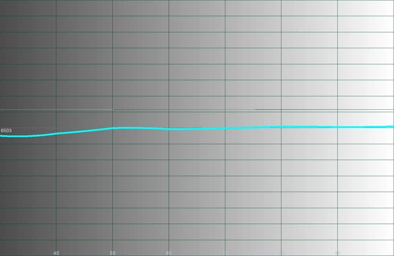

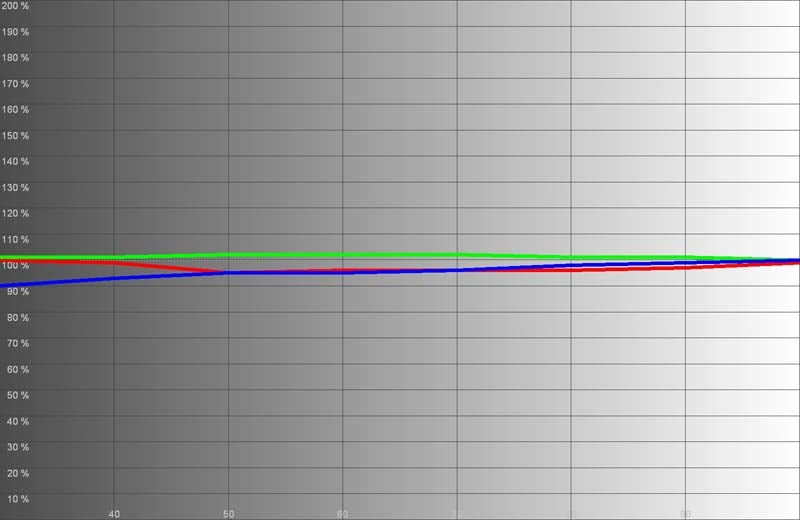

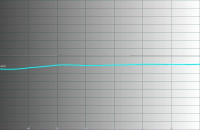

We ended up setting Brightness to 35 and Contrast to 52 and set Color Temp to Normal. At this setting, measured color temperature was 6200K. In Warm mode it dropped to 5300K (perfect for Black & White movies). Setting it to Cool yielded 8700K color temperature (which is lower than many other sets' Normal settings). With our colorimeter in place, we calibrated a custom color temperature by setting Blue to 86 (Red and Green stayed at the default 128) and got the following measurements:
Not bad considering there are no Gain/Cut controls
Color temperature maintained a steady ~6500K from 30 IRE to 80 IRE.
Calibration overall is only possible in a limited way. The HDMI and component inputs are shared, so even settings like Brightness, Contrast, Color, Tint and Sharpness cannot be changed on a per-input basis as we'd prefer. One saving grace is that Color Temperatures do differ from HDMI to component, so you can have custom configurations for each.

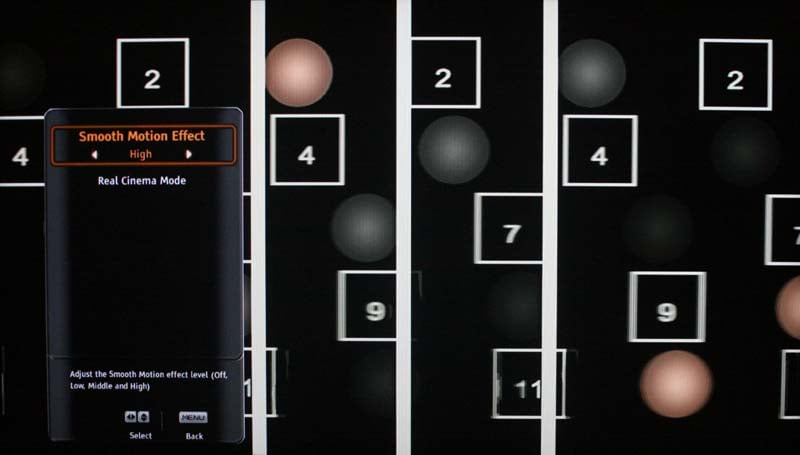

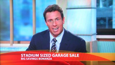

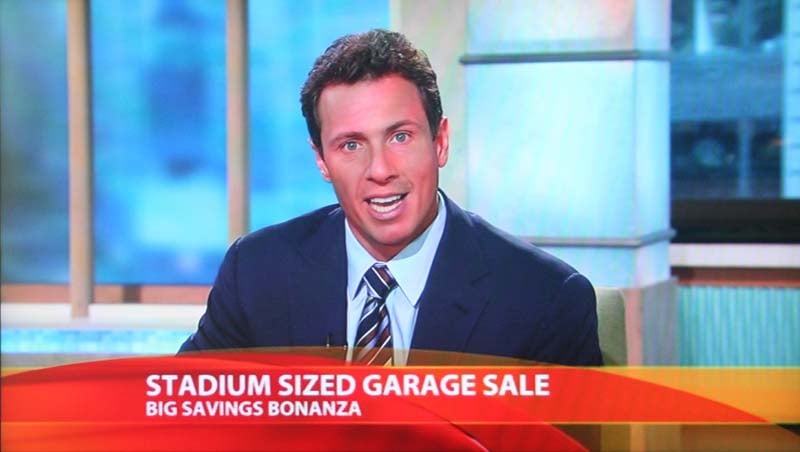

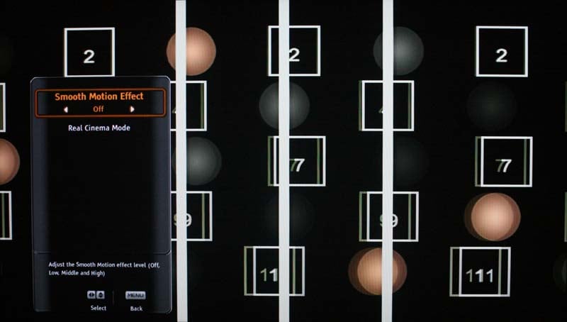

Smooth motion is a tough nut to crack. After trying tons of combinations on both standard definition and HD content (it affects both) my final determination is that it should probably be left off. Even at its lowest settings it results in unpredictable artifacts on high contrast edges in motion. You may luck out depending on what type of content you are watching, but since I have some excellent sources I'd probably bypass the feature until it is perfected. 120Hz Smooth Motion is something I wanted to use. It certainly did stabilize some moving images across the screen, just not without introducing artifacts - such as with race cars going around the track (I'm a closet NASCAR fan). Once I deactivated the feature, motion blur returned, but the tearing stopped. If you are going to use the system, be sure to place Real Cinema Mode on Precision as it produces slightly less tearing. Note that without Real Cinema Mode engaged, the Smooth Mode Effect feature really doesn't reduce motion blur.
Smooth Motion set to High (it's a cool feature, but notice the artifacts on the
bottom #11 square)
When playing 480i sources via the component video input we noticed a lot of cropping. The SV470XVT took off 25 pixels from the left, 22 from the right, 10 from the top and 15 from the bottom. None of the Wide modes fixed this and I triple checked to make sure the obscure scanning settings were optimized (they were). There was absolutely no cropping via HDMI.

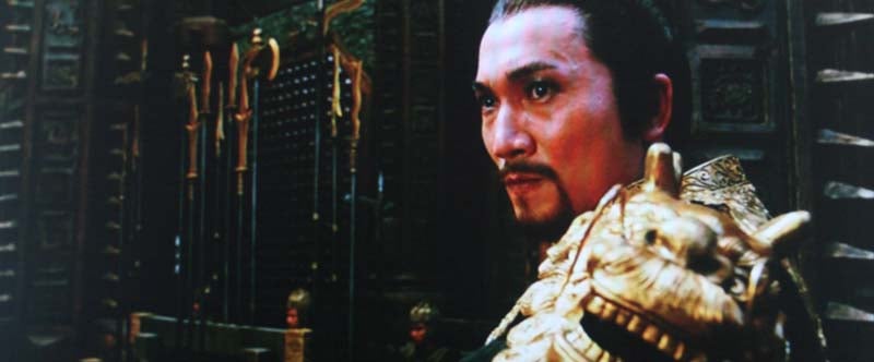

Vizio SV470XVT Viewing Evaluation and Conclusion
I'm going to be less verbose here than normal and let the pictures speak for themselves. Suffice it to say, the Vizio produced excellent color and I was pleased overall with the black levels for an inexpensive florescent-lit LCD panel. I've definitely seen worse, and of course there is better. This model is priced well, but it does face some competition. Looking at the images below, however, it would be hard to imagine anyone not enjoying the picture it produces.

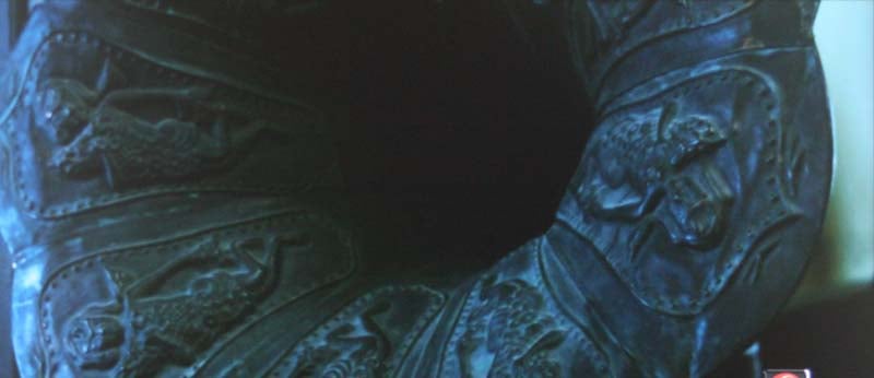

DVD: Forbidden
Kingdom

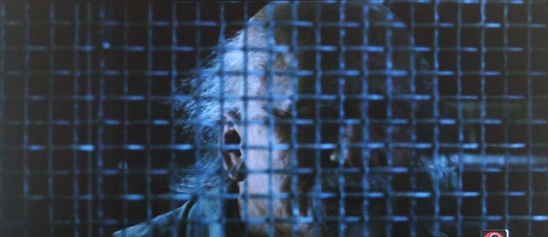

This film is rather
dark, and it also has lots of detail and beautiful moments where you could
really peer into dark crevices and areas that on lesser displays would
absolutely be crushed to bits. I noted the many opportunities Forbidden Kingdom
afforded us to notice shadow detail and really take in the Vizio's performance.

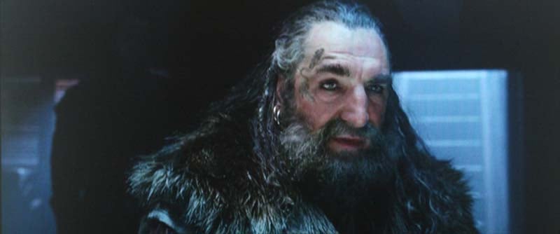

DVD: Golden
Compass
Golden
Compass had as
mystical a color palette as it did a mystical tale. We really enjoyed seeing
this movie glorified by the color reproduction ability of the Vizio.

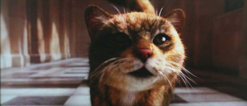

Not too colorful, but note the hair and clothing detail. This spirit cat also did a great job showing off the SV470XVT for our readers.

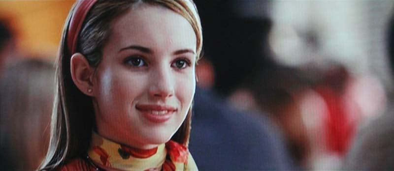

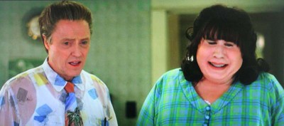

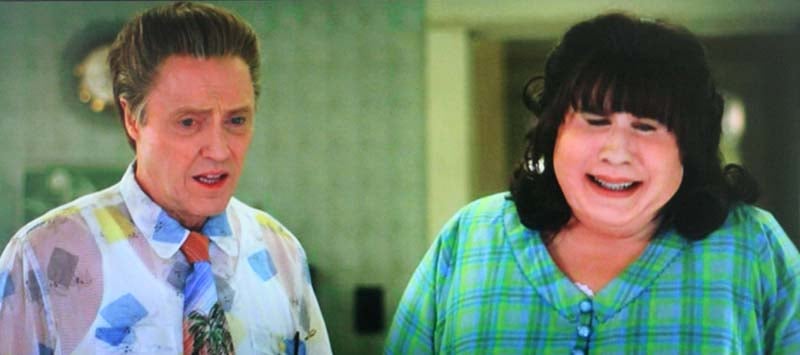

DVD: Hairspray
I really liked this movie and it was certainly giving the Vizio's pastellarometer a good workout!
I watched a ton more programming on this TV - all of it impressive. From HD news shows to shoot 'em up movies, the Vizio performed very well and presented a clean, clear, and consistent picture.
