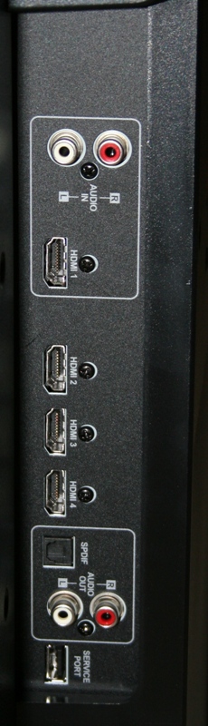

The stand comes attached (I prefer this though it really isn't a mark for or against the unit) and it is a bit heavy at nearly 10 pounds. As Westinghouse displays are wont, the inputs are up the sides of the center post with the HDMI inputs on one side and just about everything else on the other. The TX-42F430S has a whopping four HDMI inputs which is phenomenal at this price point. There is absolutely no reason why you would need more. Also included are a pair of component inputs, a shared S-video/composite input, and a VGA (HD15) input for you computer lovers. Noticeably absent is the (quickly becoming standard) USB port for displaying pictures and home movies though again, not really a strike against it.

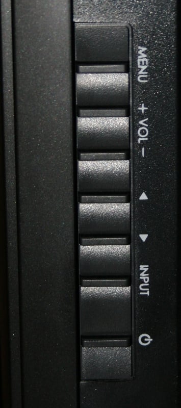

There are controls for the unit on the side including Power, Volume, Channel, Source, and a Menu button. There is an odd panel on the front just below the LED that looks like it should pop open for controls or inputs - it doesn't. The side controls are very responsive and easy to locate and use even in a dark room. The power cable is detachable and on the side with the HDMI inputs. I've read that others have had problems with this display in that it sometimes "crashes" and won't come back on unless you unplug it and plug it back in. I've had that problem with the older Westinghouse but not this unit. A detachable power cord makes this a very easy proposition. Honestly, there is something about this display that makes it look larger than the claimed 42".

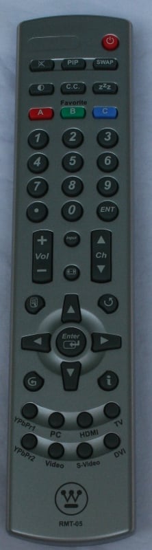

Westinghouse once again decided to go with a completely NON-backlit remote. The light gray remote feels comfortable in your hand and is fairly easy to navigate in the dark (good thing too). It is large enough that it won't immediately be sucked into the couch (unlike its predecessor). There are unique buttons for each input type at the bottom (though you still have to scroll through the HDMIs - and without any on-screen help might I add) and there is a global input scrolling button. Westinghouse has a history of denying users direct access controls for more easily programming universal remote controls and it looks like the TX-42F430S is no different. The aspect ratio button is near the center control buttons which is very convenient. The Menu and Back buttons (along with the information button which is useless in normal viewing because the Back button does the same thing) are also easily accessible. For some reason there is a Backlight scroll button near the top which seems to be an odd choice for a remote. Why would you want to make it easy for kids/guests to mess up your backlight settings? While overall this is an improvement from the original remote (which spent more time lost in the couch than anything else), it still has a long way to go before I consider it "acceptable."

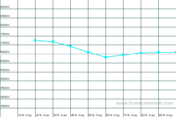

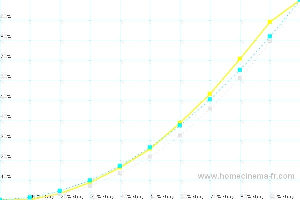

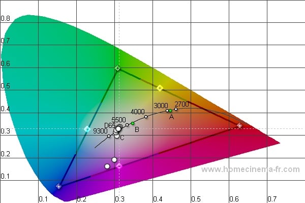

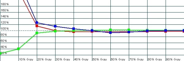

For calibration I'm using both the Sencore ColorPro5000 and Colormetre HCFR software. Basically, Sencore is great for calibrating your set but doesn't give you the pretty graphs that we like to show in our reviews. That's where Colormetre comes in. From the default settings, I measured:
Enhanced - 7500k (542:1 ANSI contrast ratio)
Game - 8700k (494:1 ANSI contrast ratio)
Sports - 7500k (620:1 ANSI contrast ratio)
Movie - 6700k (472:1 ANSI contrast ratio)
As you can see, color temperature in Movie mode without any calibration isn't too bad. It was a little too blue and red for my taste however, so I tweaked the settings a little. Calibration on the TX-42F430S is a mixed bag. It is easy to access the settings via the menu with the remote, though you'll find it resetting your settings from time to time (I couldn't identify exactly when or why). Just make sure you write your settings down when you are done just in case. A few oddities - settings for HD and SD content need to be set separately, settings are global for all inputs of the same type (all four HDMI inputs get the same calibration), and when you adjust the Red, Green, and Blue from the calibration menu, those settings stick even if you do a Video Reset. The only way to reset those setting is with a Factory Reset. I started off setting the Mode to Movie, Brightness down to 46, Backlight at 40, and in the calibration menu I switched the Warm Red to123, Green to 133, and Blue to 119. I ended up with a color temp of 6600k and a 588:1 Contrast Ratio.
One of the most disappointing results of my measurements was the discovery that the display clipped whites and added a lot of artifacts to blacks (I tried to get a picture of the test screen but I couldn't get it to come out). Using the DVE Pro disc, I found that 95 and 100 IRE were indistinguishable from each other and that 5 IRE had a lot of visual artifacting. This means that any very light or dark scene is going to have no definition (light scenes) or lots of artifacting (dark scenes). Unfortunately, this wasn't one of those "only shows up in the measurements but doesn't affect real world performance" things. It was immediately noticeable with casual viewing. Lowering the backlighting (which was set inexplicably high for default Movie mode) helped with the artifacting but not much. I found the most obvious example of white clipping during a scene in The Empire Strikes Back. When Han goes out on a Tauntaun looking for Luke, it looks like the Tauntaun is standing in an amorphous field of white. Sure, handing your teacher a blank sheet of paper and calling it a white horse in a snowstorm might be funny, but I expect that ILM did a little more work than that. Based on previous viewings of this movie on different displays, I know they did.
Color Temp (left); CIE (right)
Luminance/Gamma (left); RGB (right)
As you can see, the RGB graph lines up nicely but without gain and cut scores, I couldn't get the Color Temp to get in line. Basically, I could push it up and down but the shape stayed the same. You can also notice on the Luminance graph where the clipping starts somewhere above 90 IRE. With a finer resolution, I'd bet we'd see exactly the point where it clips.

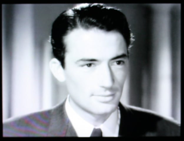

You'll notice that I did all the tests through the Component input. This is because the HDMI input failed the 6.5MHz resolution test (oddly) when using 480i mode. Overall, the HQV results speak for themselves. Jaggie and Noise reduction are nonexistent. Only the most basic of deinterlacing features are available. Using a good source with this set is imperative though, as you'll see later, even that isn't going to deliver a great picture.
TX-42F430S Viewing Evaluation and Conclusion

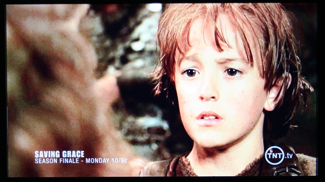

I've already mentioned the artifacting and white clipping during the measurement section. During the viewing evaluation, I noted tons of jaggies, noise, and white clipping. Motion blur was rampant and the overall viewing experience was very poor. I tried using the set with a Denon DVD-3910 (a reference level DVD player) set to progressive and even that didn't help.

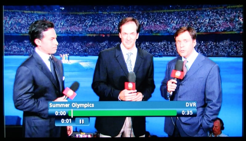

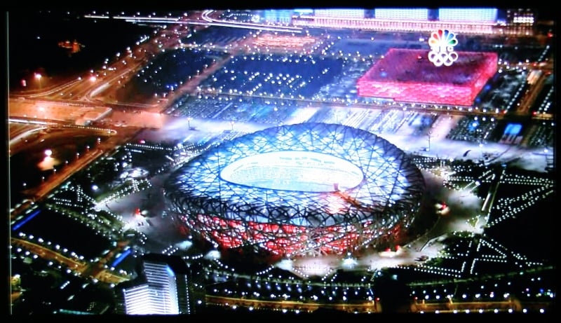

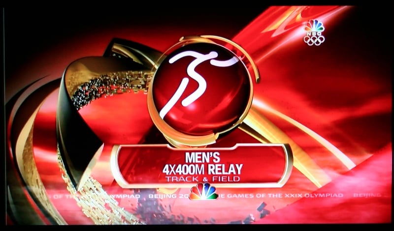

HDTV - 2008 Beijing Summer Olympic Games
It's hard not to spend some time watching the Olympics when they are on, since just about everyone else rolls over and plays reruns for two weeks afterwards. By the time it was over, I was well ready for it to be. I spent a lot of time with the Olympics noticing motion blur. Diving and Soccer in particular were rife with it. Westinghouse has this display listed with an 8ms response time. According to Westinghouse's own definition:

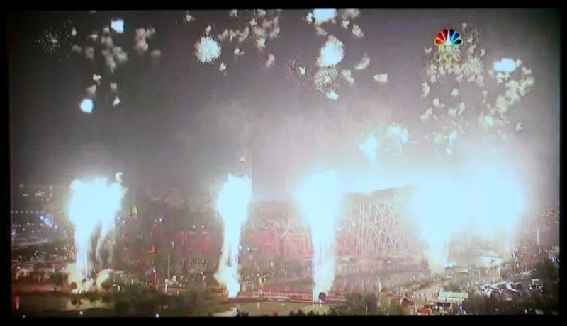

Response time is a measure of how long a display takes to change the image. A typical LCD television is 2 to 3 times faster than the average LCD computer monitor. TVs with fast response times are superior for playing computer games and viewing action movies and sports.
We'd have to wonder if Westinghouse borrowed too much from its PC monitor division in making these displays. The colors were well saturated and static pictures looked OK, but any motion was a mess of blurs. The closing ceremony was held at night and the amount of artifacting was legion and banding was evident near every light source. Notice the artifacting in the Olympics graphic in the last pic.

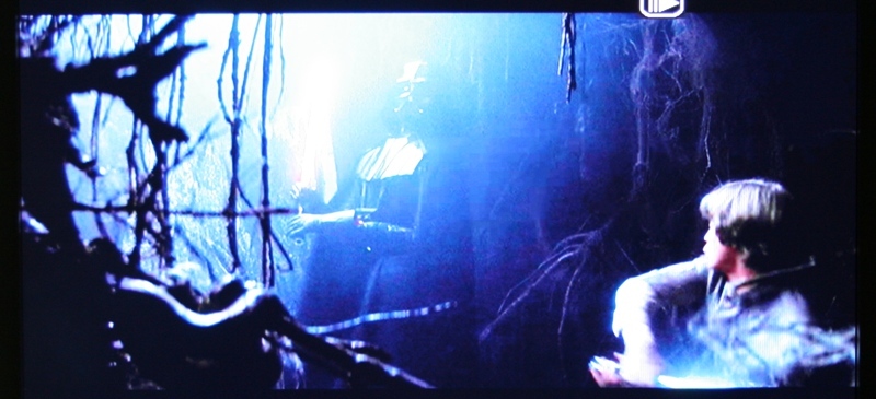

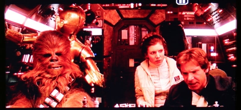

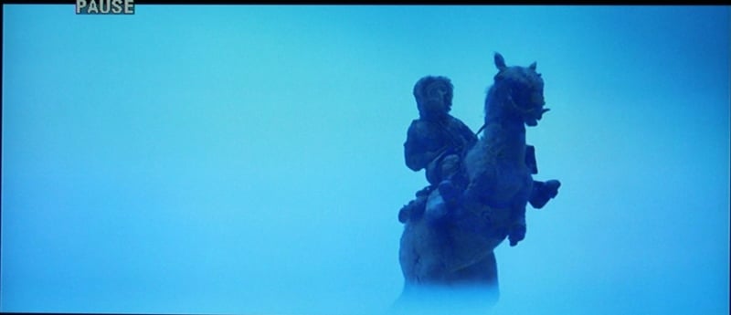

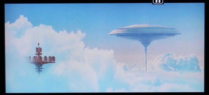

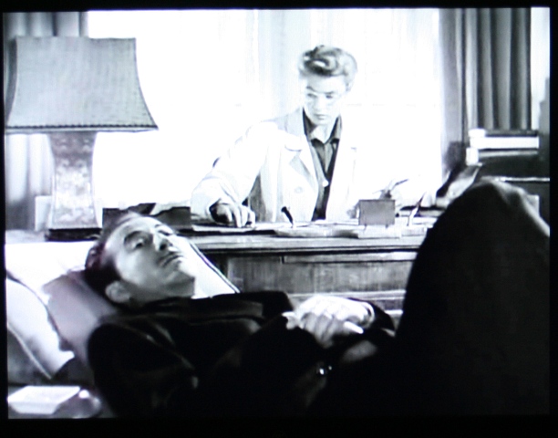

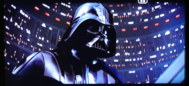

DVD - Star Wars: The Empire Strikes Back
Much of this DVD looked just fine, though again fast motion and dark/light scenes were problems.

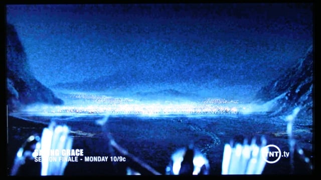

Various
Here are a few more pics I snapped thinking that I would use them in the review. At this point, it seems like it is just going to be more bashing so I'll just throw up a few. The dark, grainy blob is the arrows coming in at the end of LOTR: The Two Towers. The second is from the same movie and the kid's face looks fine but the figure in the foreground has a lot of noise. This is pretty typical of the performance with the characters looking OK but the backgrounds looking hazy and full of artifacts. The last two pictures are from Alfred Hitchcock's Spellbound. While many of the scenes are shot sort of soft, notice the moiré on Gregory Peck's jacket and how undefined Ingrid Bergman's white coat is compared to the white window behind her. Overall, SD performance lacked the crispness I've seen with other displays.
