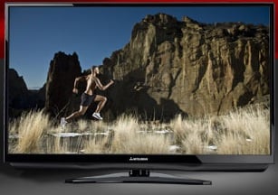

The display arrived in a well-protected box that opened by sliding the box up over the display and off the separate bottom part of the box. This eliminates any awkwardness in trying to get a large display out of the typical box. With a nice assist from my wife we quickly had the display out of the carton and set up on the AV rack. The display is referred to by Mitsubishi as a SuperSlim LCD HDTV, and has the following measurements: 46" diagonal screen size, height with base was 28" (w/o the base, just the display measured about 26-1/2"); width on the base is about 11" (w/o the base, just 5"); and the width is 42". SuperSlim describes the area around the display more than it does the thinness/depth of the total display. The total weight of the display is almost 62 pounds.
The cabinet features the platinum black Ultra-Thin Frame (bevel), which around the top and sides of the picture is only about 3/4" thick. This feature leaves little to distract you from the sharp 1080p picture. The swivel base (+/- 30 degrees) gives you a little advantage when connecting cables to the back or side of the unit during setup. If you utilize the display in a multipurpose area, it could also improve the view from several different viewing spots. Not the case in my viewing room, but this feature could also be very useful for applications where you might have more than one viewing area - sofa, kitchen, etc. Also, the left side of the cabinet includes a component and composite video input, analog stereo input, and USB input. These well-placed inputs makes it very convenient to hook up a camcorder or video game console for occasional use. The USB input is utilized for viewing photos (JPEG images) from a thumb drive or even, apparently, a USB card reader.

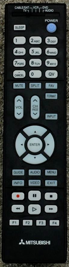

Remote Control
The remote control for this display is a pretty basic, vanilla remote. There was nothing to complain about, but it also had nothing that really blew me away either. It was nice to see that it was at least partially backlit, so you weren't stuck fumbling in the dark to do basic tweaking, or channel surfing. The basic video menus were all accessible either by the Menu button, bringing up the main menu, or you could scroll through all the available options by pressing the Video button. During my calibration process I typically found myself scrolling through Video menu options until I got to the one I needed using the Video button. The remote also features NetCommand with IR learning capabilities. This allows the Mitsubishi's remote to control other components in your system by way of external IR emitters (supplied).

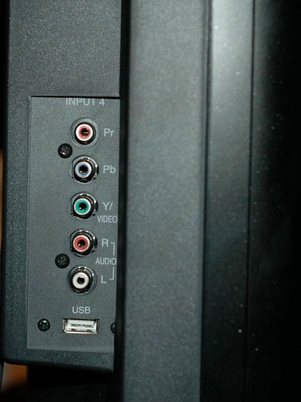

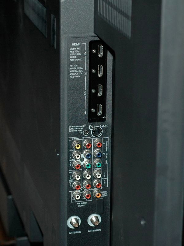

One of the big positives of this display is its options for connecting all your favorite sources. The back panel contains 4 SimplayHD certified HDMI 1.3a inputs (with Consumer Device Control); 2 component video (YPbPr) inputs (one input doubles the Y input for 1 of the 2 composite video inputs); 2 antenna inputs which can receive digital and analog OTA channels or non-scrambled digital/analog cable signals (QAM); and a third component input on the side of the display. The back panel also offers an IR NetCommand Output/External Controller Input to assist with control of other IR remote controlled devices.

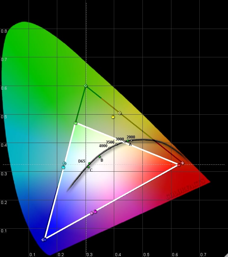

The CIE color chart measurements for the Toshiba 46LX177 were not up to what we had been expecting, especially with its claim of xvColor support. Red and blue are pretty much dead on, but green falls far short. During my calibration I attempted to see if I could expand this performance utilizing the 6 color processor settings in the video menu. Regardless of what changes I made, I could only shrink the triangle - never increase it to include more colors.

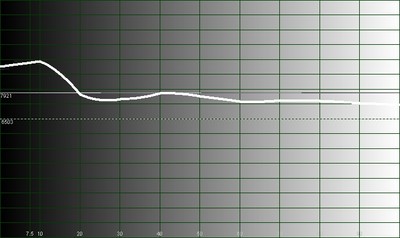

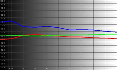

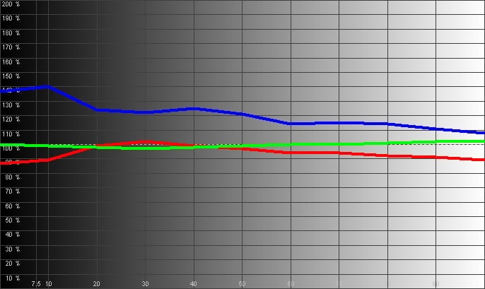

Other measurements were also a little disappointing during the bench tests. The gray scale measurements shows RGB levels set heavy on the blue throughout the IRE range. Green stays pretty steady throughout the range, and red dip slightly from about 30 IRE throughout the rest of the range.

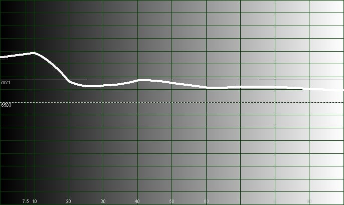

The temperature history shows it starting high (almost 7900K at 40 IRE) and gradually going down as you increase through the IRE scale - though it is always above the 6500K target throughout the range.

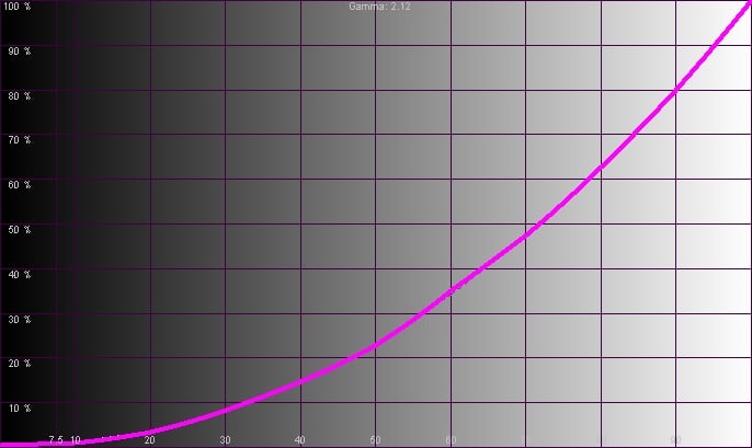

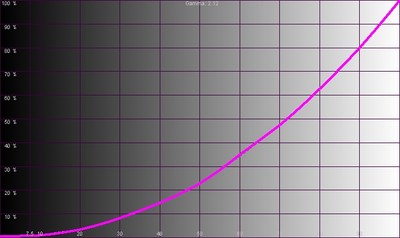

The gamma reading (2.12) came in on the low end of the target range (of 2.2 to 2.5) but still at a pleasing level - very similar, in fact to how a CRT display performs (thought by some to be the model example for gamma). This smooth gamma curve produces a very even transition from bright to dark and makes for a very watchable picture that is carried out by real-world testing and viewing sessions.

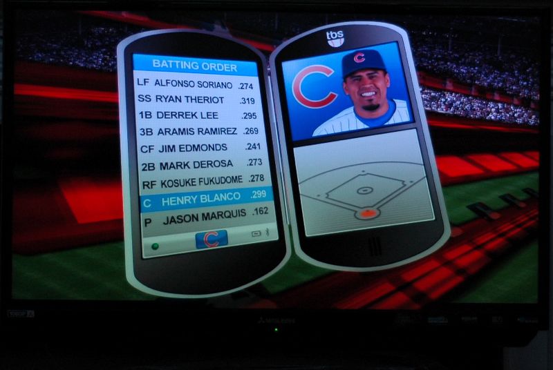

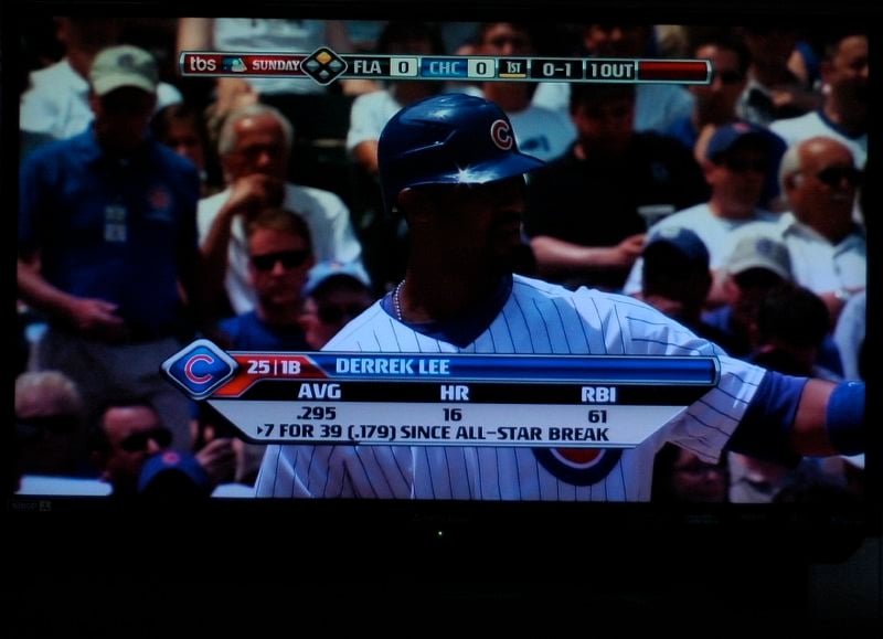

Despite the short comings noted previously in this review, this display produced some amazing 1080i images. So much so that I feel I need to start my viewing evaluation by posting this warning: Images in this display are so clear and crisp they may cause your dog to become a couch potato and never want to leave the front of the television. Just like in people, a good HD picture will make even a dog watch something they have no interest in.
Various HDTV Shows (via Comcast Cable)
No review is complete without a little HD Discovery Channel. I think the guy in the closeup is from Mongolia - can't remember what the program was about, but I do remember the vivid pictures of the people and the landscape. You can notice a little contrast issue in the shadow of his face where you just lose all detail. This was a recurring problem with dark scenes or portions of a frame. Office, besides being one of the funniest shows I watch all week, also has some amazing HD pictures. They've got that almost 3D quality that once you've seen it, you wonder why anyone ever settles for less. And then why even get a 1080p display with 120Hz refresh rate if you're not going to watch some sports! We did notice that setting the Smooth 120Hz film motion setting to high did help reduce the blur of things like baseball pitches and volley ball spikes (thanks to the Olympics for providing the opportunity to view fast moving objects).
