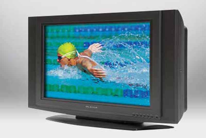

The Olevia 232V comes in a pretty standard rectangular cardboard box. While a removable lid would have made getting the display out a bit easier, I was able to get it out easy enough with a little help from my wife. Because this display was purchased and would be staying in my house permanently, we installed it in the recessed area over our fireplace.
Olevia 232T angledThe outer frame of the 232V is made of black plastic with a recessed black plastic frame around the 32” diagonal thin film transistor (TFT) liquid crystal display (LCD). On power up, a bright blue LED light comes on indicating that the display is receiving power. For those who find these lights to be irritating, the user menu will allow you to disable this light. The front of the display includes buttons along the bottom right that include: Power, Menu, Channel up and down, Volume up and down, and Source. The Olevia emblem is in raised silver on the bottom middle of the black plastic frame. The stand is also made of black plastic. Each of the two speakers are approximately 3 inches wide and run vertically along the left and right side of the display. Over all the build quality of the 232V seems very solid with a pleasant enough aesthetic.

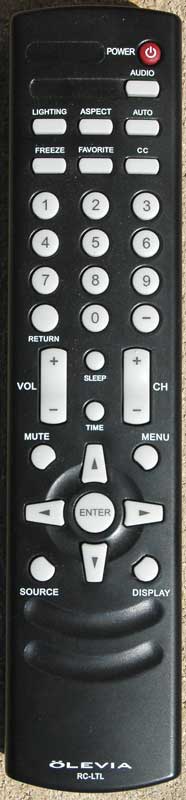

Remote Control
Olevia 232T RemoteThe remote control is of the standard, unimpressive variety and was easy enough to use during calibration and day-to-day use of the display. The remote control has individual buttons for some functions (lighting, aspect ratio, freeze frame, and favorite television channels. However, it only has a single button for the source so you have to toggle through all the potential inputs (VGA, VGA-component, Tuner, Composite, S-video, component, and HDMI) to switch sources. Fortunately there are not that many sources to select from, so it isn’t the headache it could be, but can still be irritating over time and makes for more difficult universal remote control programming. Other quirks involve scenarios where there are separate buttons, for example Display and Time, which appear to give you exactly the same information in default use. With space being such a precious commodity on a remote control, the Time button (presumably tied to the Sleep function) seemed superfluous.

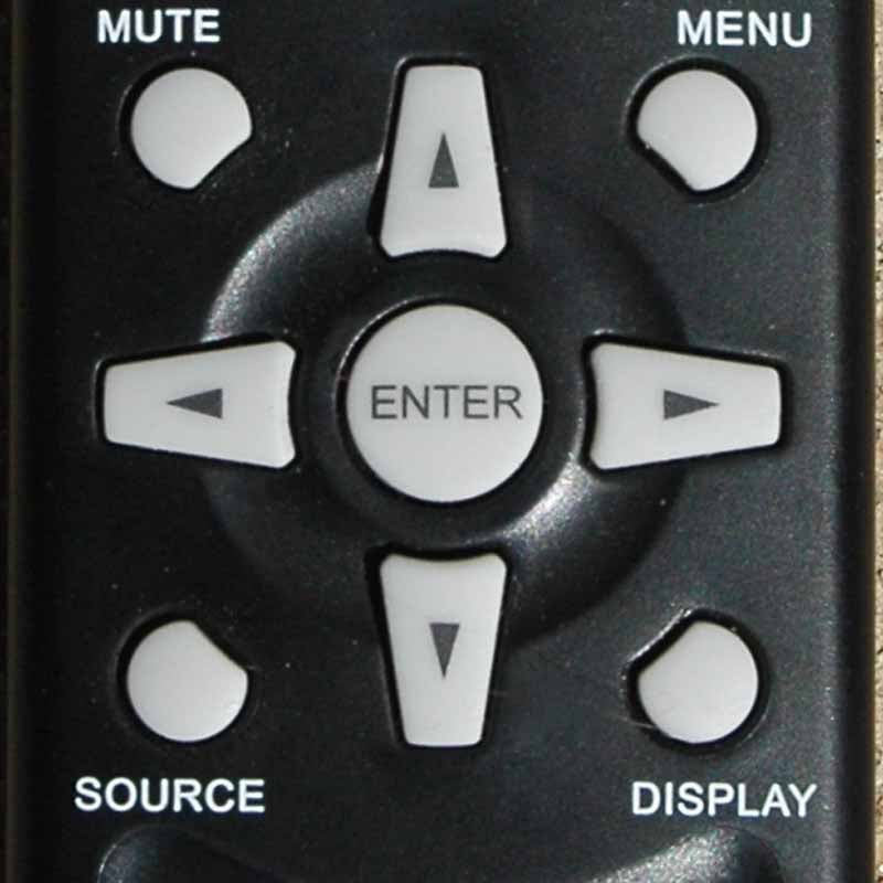

Operating menu systemThe menu was not the most intuitive system I have ever seen on a display; however, once you get the hang of how it works, it is fairly easy to manipulate.  All the controls you need to manipulate the wheel-based menu system for setup and calibration are centrally located on the lower part of the remote.  During set up and calibration, the controls I used most often were easy enough to get to.  However, its lack of memory (having to start the whole wheel cycle over every time) became a nuisance if you happened to let the menu display timeout.  On the positive side you can increase the delay in the timeout for the menu display in the Set up menu.

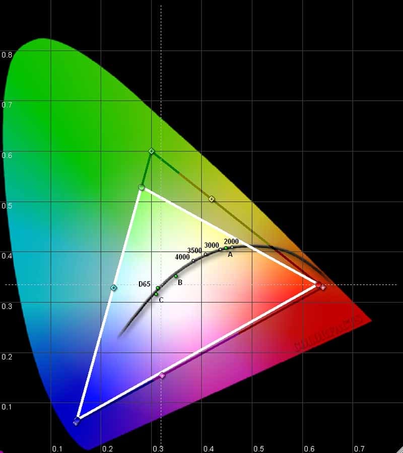

CIE Color ChartWe used Datacolor’s Colorfacts Professional 6.0 software to measure the 232V's performance in various modes and Color temperature settings. The CIE Color chart shows the 232V is pretty close to right on with both red and blue, but is a little deficient in green. We should point out however that two very important factory presets in the Picture menu that need to be changed to set the display for home use. Under Picture/Mode there are two options (Home and Power Up). The factory default is Power Up (so it looks as bright as possible when powered up in show room settings); but as usual, the preferred setting for use in our home was, oddly enough, Home. The other factory default we recommend changing is also in the Picture menu under the submenu Color Temperature. The two options are Native (the factory default) and 6500K. Prior to changing this default, we got a color temperature of around 9200 (again heavy blue in an attempt to make it stand out in the showroom). Making this simple change gave us a measurement of 6255K, much closer to the goal of 6500K.

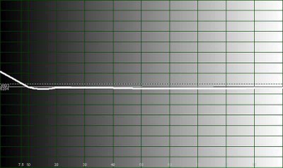

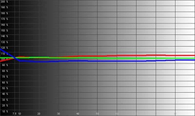

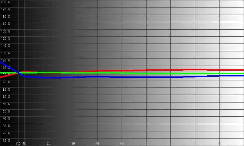

When we first tested the RGB performance out of the box prior to making these changes the display showed a heavy bias toward blue. Simply changing the mode setting to Home, and the Color Temp to 6500K brought the blue back down and we got a very acceptable grayscale performance with this setting. You can see the RGB levels look pretty stable across the entire spectrum from about 10 IRE through 90 IRE. Unfortunately, there are no User calibration controls for RGB Cut and Gain so other than making a few basic changes there is little you can do to alter the out of the box RGB performance.
Olevia 232 RGB levels
With the color temperature set to 6500K (rather than native) the color temperature of the display also stayed pretty stable in the range of 6300K. Not bad, actually, though some prefer a picture that is a bit less red.

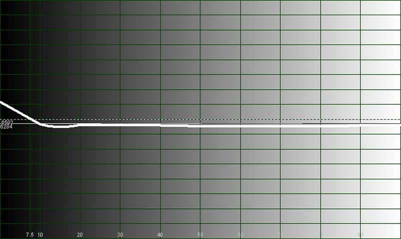

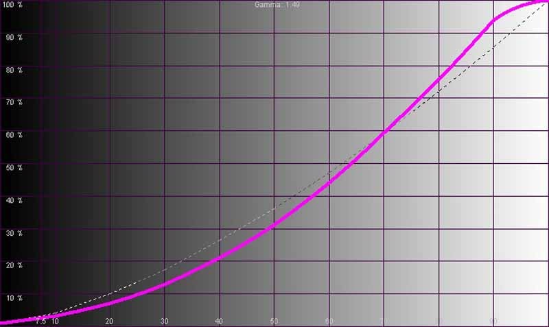

The Gamma reading (1.49) was a bit off the target of 2.2 to 2.5 and it suffers slightly from S-curve issues. As a result the blacks do not get black quickly enough and then the whites take off a little to quickly. I could quickly see why my Contrast and Brightness settings resulted in quick clipping of the top and bottom end.
Olevia 232 Gamma levels

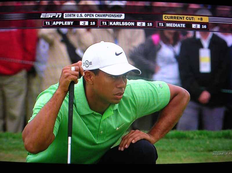

HDTV: Sports
If you spend any amount of time in my house you're going to wind up watching sports. If it's summertime, there's a good chance the sport of choice will be baseball. I love the game. I also love to watch the game in high definition! Great color saturation. Although I did notice some blur and/or ghosting when trying to track the ball. On the other hand, I do not particularly care for golf. But hey if it's in HD, of course I'll make an exception. If for no other purpose than to make sure the display passes the golf ball test, and yes I could make out the dimples of the golf ball lying on the green.

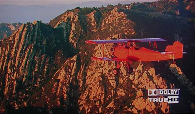

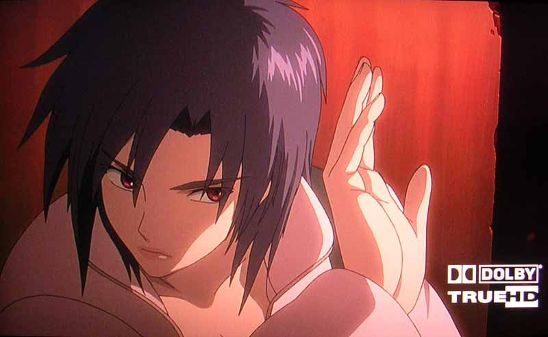

HD DVD: Dolby The Sound of High Definition
This is a great demo disk for audio and video I picked up for free at last year's Audioholics State of the CE Union. There are some great options on this disc to challenge just about any display. Since I'm a big aviation fan, I particularly enjoyed the rich colors and contrast in One Six Right. The animation in Ghost in the Shell exposed the display's tendency to be a little bit soft.

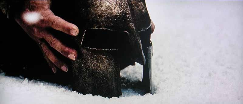

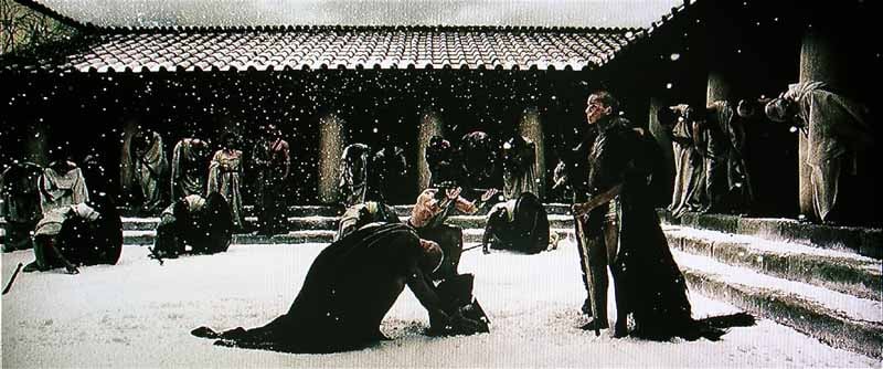

HD DVD: 300
Recently my wife and children went on a trip and I found myself with the opportunity to watch whatever I wanted. So of course I loaded up the Netflix list with plenty of blood & guts! Yep some good old carnage. 300 delivers plenty of that and it also gave me the opportunity to grab some screen shots with good contrast. As we saw in the bench testing, the display struggles with bright whites, but it still did a good job of reproducing the bright and dark scenes in this movie.
