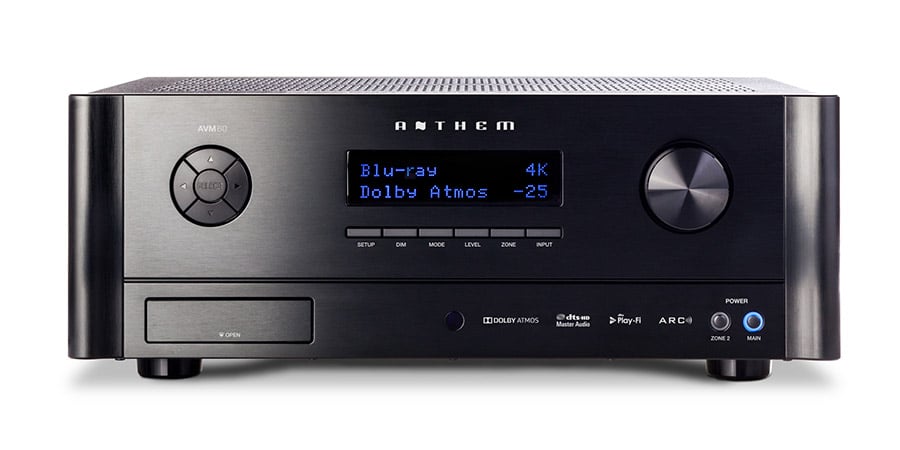

AVM60
Anthem AVM60 11.1CH Atmos/DTS:X Processor

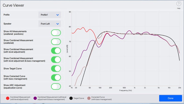

Anthem ARC Genesis Curve Viewer

IMPROVED—Curve Viewer: The interactive Curve Viewer tool displays what ARC Genesis is doing every step of the way, generating graphs that display measurements for each speaker and allows users to overlay measurements with bass management settings applied, target curves, and correction curves.

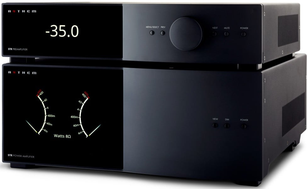

Anthem STRAnthem ARC has been a pretty solid room correction system from our past experiences. We love the fact the EQ could be bandwidth limited so you can just apply correction at and below the room transition frequency or whatever your preference may be. In our own testing using the STR Preamp in the Audioholics Showcase system, we achieved the best results limiting correction to 500Hz. You're speaker to room interaction may be different and thus you may choose a different stopping point. Something slick we love about Anthem ARC is you don't have to make a physical connection to your AVR meaning you could set up the electronics in a different room other than the speakers and display are in and run the correction via ethernet from your laptop. This is something you can't do on many of the competing room correction systems.
