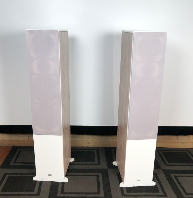

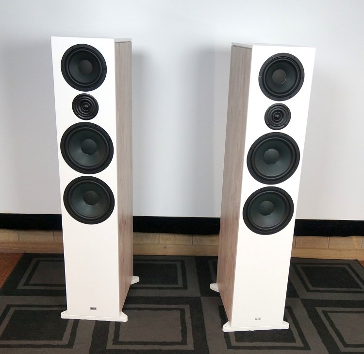

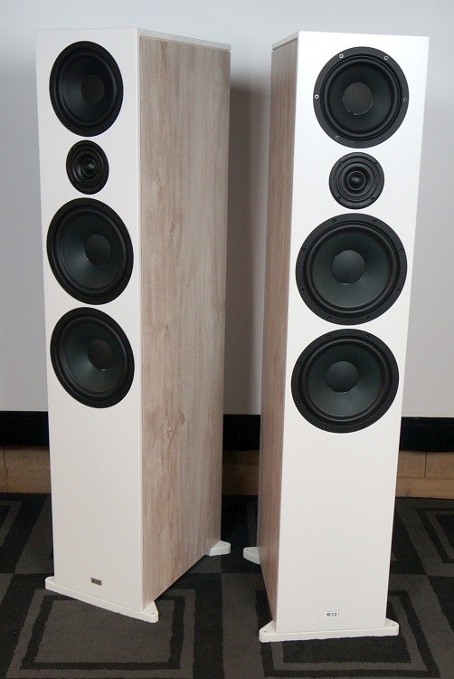

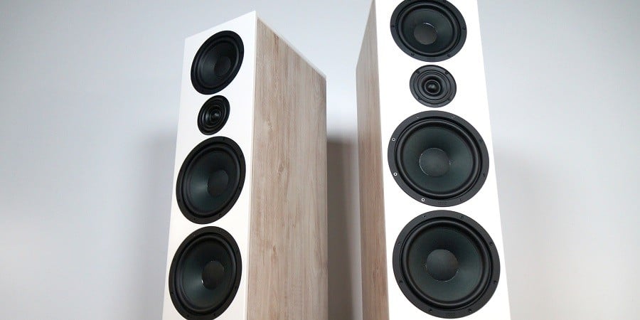

The Aurora 1000 speakers arrived in sturdy cardboard boxes. Internal packing was some Styrofoam blocks that capped the ends and a packing piece to shore up the midsection. The speaker was covered in a cotton sleeve to protect against moisture and scuffs. This level of packing should give it adequate protection for typical shipping, but the Styrofoam pieces will get busted up if the transit gets rough. Were these heavier speakers, I would say this packing provides insufficient protection, but they don’t weigh a whole lot considering their size, so this packing should be ok.
Once
unpacked, the Aurora 1000s turn out to be nice looking given the pricing but
not luxuriant. Many towers at this price point just turn in a black box with a
textured black vinyl veneer, but the Aurora 1000s have a white finish option
available that looks considerably less dour than most loudspeakers. The front
baffle and top use a white finish that HECO calls satin white. It isn’t quite a
real satin finish, but it is not bad-looking. The side panels use an ‘ivory’
woodgrain laminate that isn’t bad looking at a distance, but up close it is
easy to see that it is not a real wood finish- not that anyone should expect
such large speakers to use a real wood finish at this price. The black driver
cones stand in contrast to the light finish, but an included grille with white

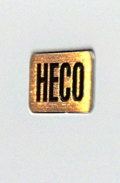

fabric can be used to hide the driver cones. The outriggers are some thick
plastic pieces, and there is a HECO badge in the lower part of the front
baffle. The binding post plate and the ports look like brushed aluminum, but a
closer inspection reveals them to be a disguised plastic. Overall, the Aurora
1000s like nice and should not clash with a typical interior decor, but they
aren’t going to be mistaken for a true luxury product, especially with a close
inspection. But again, they do not have the pricing of a true luxury product.

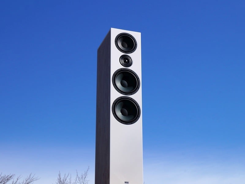

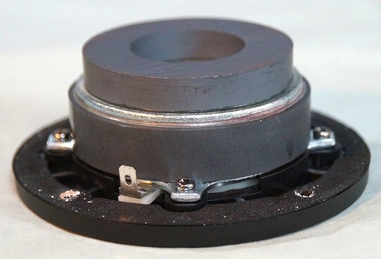

To state the obvious, the HECO Aurora 1000s are large three-way ported floor-standing speakers. Getting deeper into their design, let’s first talk about the drivers, and we will start with the tweeter. The Aurora 1000 uses a 1.1” fabric dome tweeter surrounded by a corrugated flange in a system that HECO calls the “Fluktus” tweeter. The faceplate of the tweeter has computer-modeled waves shaped into it that are supposed to assist with the dispersion, so they act as a waveguide somehow. I don’t understand how they could do that with ripples in the faceplate, except perhaps by modulating baffle diffraction in some manner. The tweeter uses a ferrite motor with a bucking magnet attached. In the ‘old days,’ bucking magnets were used to contain stray magnetic fields from interfering with CRT televisions. They can also have the added benefit of slightly raising driver sensitivity which is why I would imagine HECO is using them here.

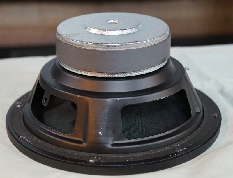

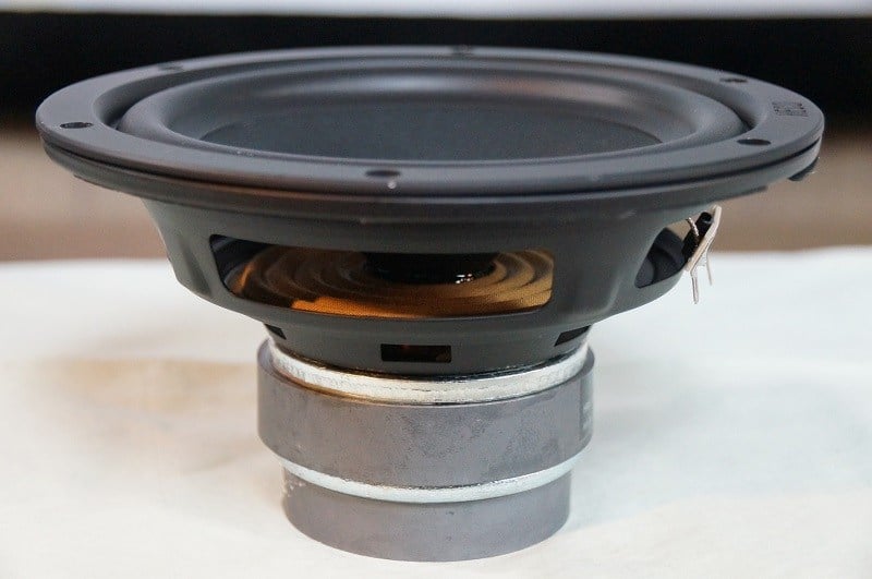

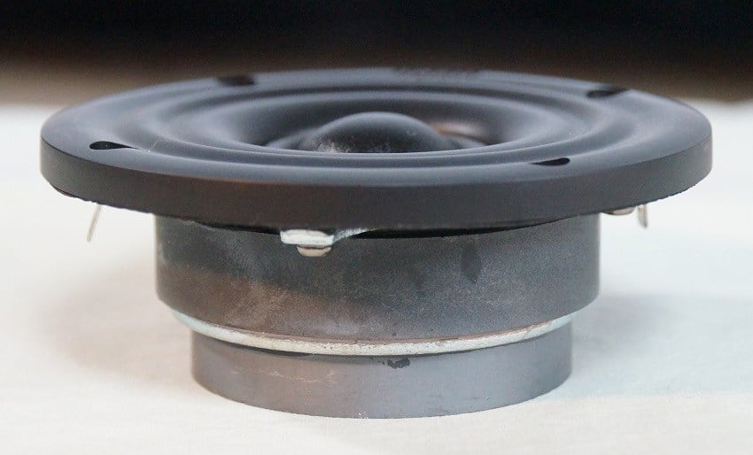

Moving on to the midrange, we have a 6.7” treated paper cone attached to a stamped steel frame with a relatively large half-roll surround and Nomex spider. The motor uses a 3” diameter x ¾” thick magnet and is vented under the spider. It also has a bucking magnet attached, presumably to raise sensitivity. In the product brochure, HECO boasts that the paper pulp used in the cones comes from renewable forests in Canada and Europe, but whatever environmental points that get them are negated by using Chinese MDF for the cabinets. A good idea in the design here is the mounting of the midrange above the tweeter; other manufacturers might have placed the tweeter above the midrange but that would have lifted the optimal listening angle a bit too high for regular seating. The way HECO has arranged the tweeter and midrange driver, the tweeter is much more likely to be level with the ears of listeners which is the ideal height.

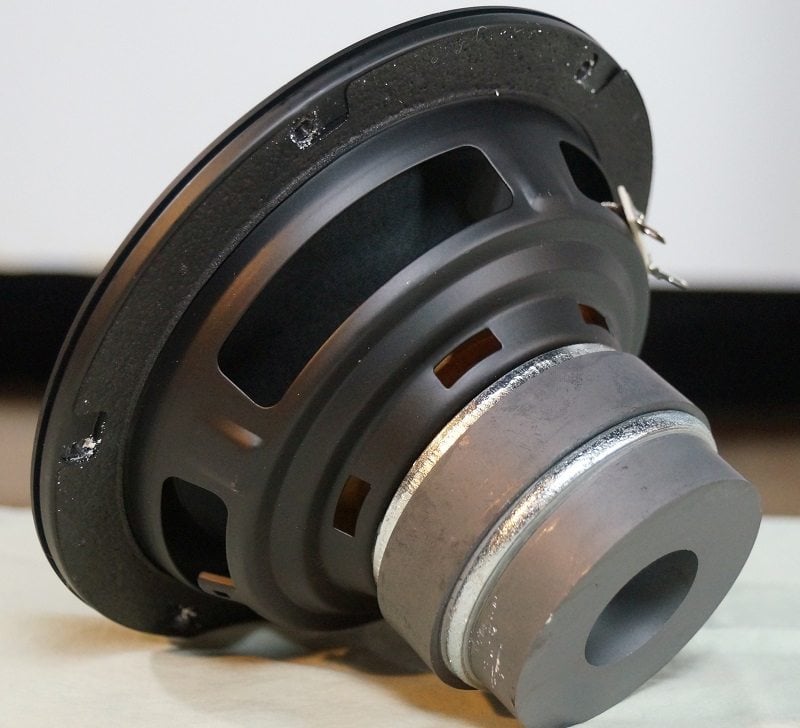

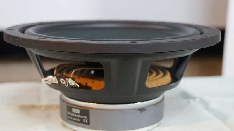

There are two 7.9” bass drivers that use the same paper cone material as the midrange attached to a stamped steel frame. The motor uses a 4 ¼” diameter magnet with a ¾” thickness (although what really counts is the actual magnetic field strength in the voice coil gap rather than the magnet size and HECO doesn’t tell us that). The backplate is bumped out a bit, and venting is done through the pole piece. There are no bucking magnets for the bass drivers.
The
bass drivers cross over to the midrange at 260Hz, and the midrange driver
crosses over to the tweeter at 3.3kHz, and that gives the midrange a fairly
wide range of operation. This will be a welcome attribute to those who do not
want any phase rotation from crossover frequencies in the midrange frequencies

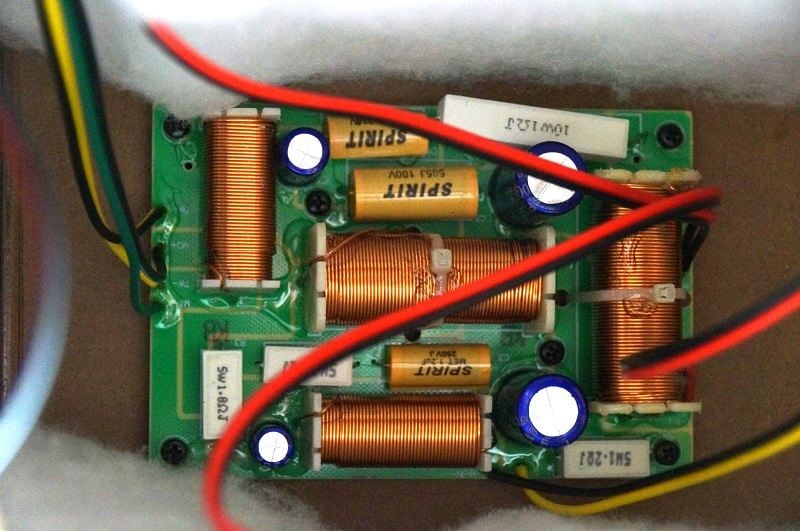

where human voices are most prominent. The crossover circuit itself looks
adequate for the job and uses a host of steel laminate inductors, polypropylene and
electrolytic capacitors, and resistors. I would guess, from the number of
components, that this crossover circuit is largely using 2nd-order filters.

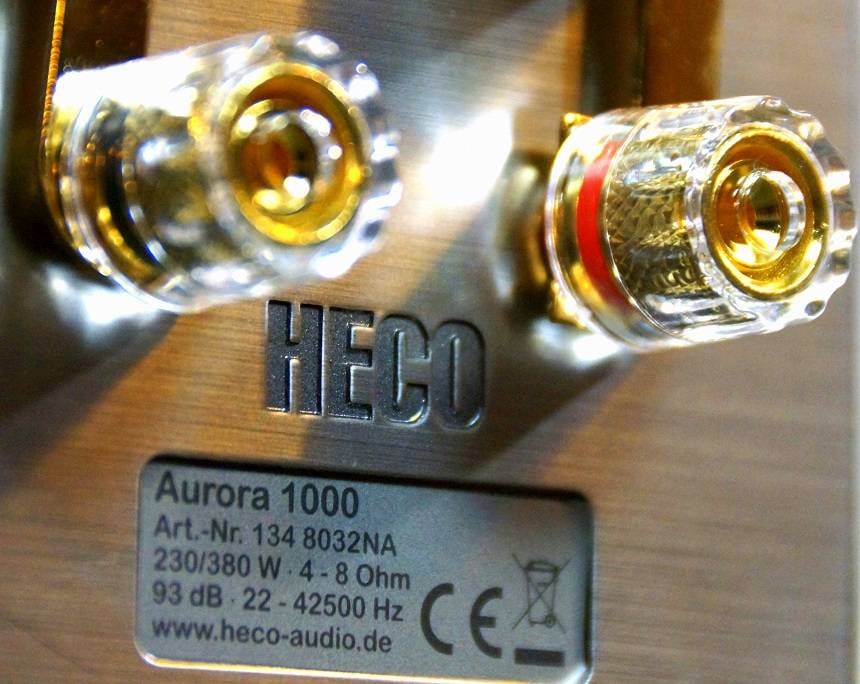

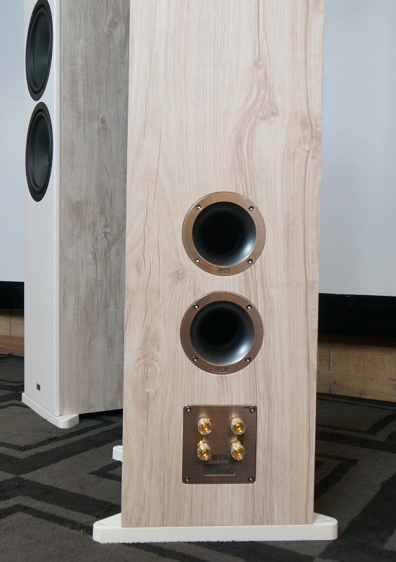

Dual five-way binding posts enable the Aurora 1000 to be bi-amped or bi-wired,
but those shopping for speakers in this price range are not likely going to buy
extra amplifiers in order to do any of that. That being said, the 230-watt RMS
power handling spec of these speakers suggests that they could handle a beefier
amp than what normally comes in a typical mid-level AVR.
One thing HECO could have done with the bass drivers that might have been a bit better in placement is to mount them on the bottom of the front baffle instead of in the middle; that way the speaker would have greatly reduced ground bounce cancellation where the woofer’s acoustic reflections off the floor interfere with the direct sound from the woofers at the listening position. By mounting the woofers near the bottom, the sound waves coming from the woofers cannot bounce off the floor since they originate near that point. The wavelength of the crossover frequency from midrange to bass driver should allow for such a layout without much penalty. However, this speaker does have one unusually good attribute that such an arrangement might have compromised, as we will see when we get to the measurements section…
The Aurora 1000 cabinet is made from MDF. The front baffle is 1” thick, and the side panels are ½” thick, as are the three window-pane braces that divide the interior of the enclosure. Corner bracing lines the inside of the enclosure edges to give the cabinet some reinforcement at the edges. There is some polyfill-type stuffing lining the interior as well for some acoustic damping. The enclosure uses some thick plastic outriggers to hold it upright, and they do their job; this would not be an easy tower speaker to knock over. There are two ports: each port is about 5” in length with a 1 ⅞” diameter. The ports are flared on both ends to minimize audible turbulence. The Aurora 1000 cabinet isn’t overbuilt, but it does intelligently allocate its budget to the places where a significant difference would be made, i.e., the front baffle and internal bracing.
The overall design implies a fairly sensitive tower speaker with significant bass ability: a large enclosure with relatively large diameter cones combined with their very light material. The speaker is spec’d at 93dB for 2.83v at 1 meter, which is certainly above average for a floor-standing speaker in this price range (although that spec differs from our measured value somewhat, which we will discuss in the ‘Measurements’ section). Let’s now see how this design comes together in some actual use…

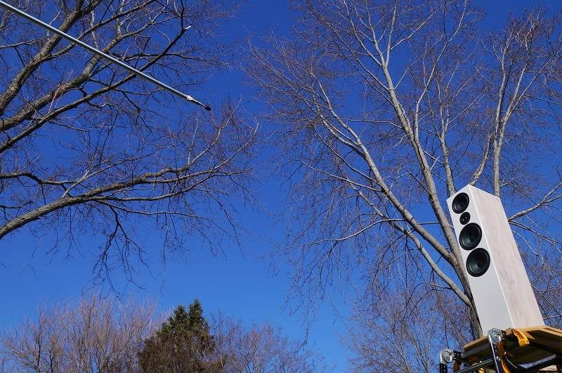

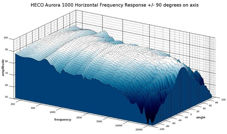

The HECO Aurora 1000 towers were measured in free-air at a height of 4 feet at a 2-meter distance from the microphone, with the microphone raised to a 7.5’ elevation that was level with and aimed at the tweeter center. The measurements were gated at 8-milliseconds. In this time window, some resolution is lost below 400 Hz and accuracy is completely lost below 200 Hz. Measurements have been smoothed at a 1/12 octave resolution.

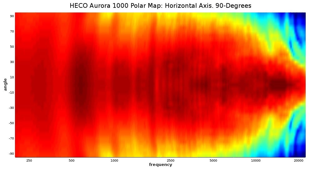

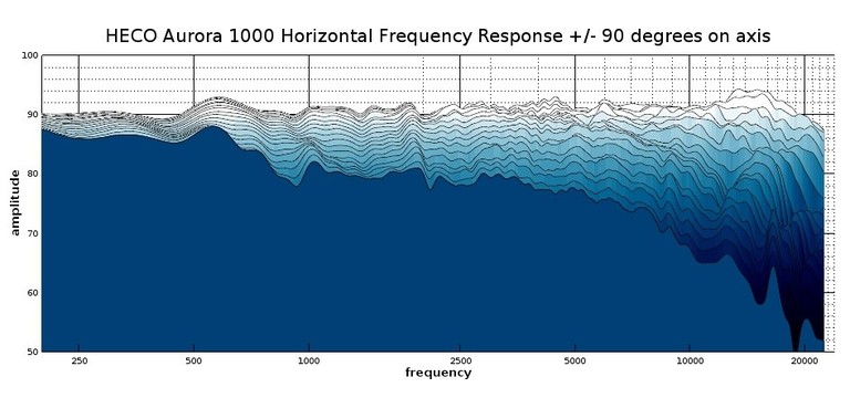

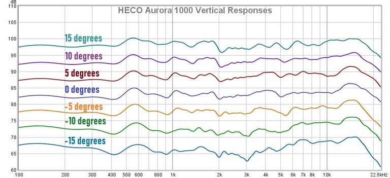

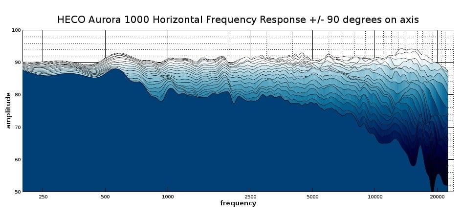

The above graphs depict the Aurora 1000 tower’s direct-axis and horizontal dispersion out to a 90-degree angle in five-degree increments. Information on how to interpret these graphs can be read in our loudspeaker measurement article. This is an astonishingly good response and pretty much holds a +/-2dB window near the on-axis angle. It’s a neutral speaker with no serious problems on or off-axis. In fact, the off-axis responses are remarkably good, and there are no evident crossover problems or driver directivity mismatches. The tweeter does beam a bit at very high frequencies, but that happens too far off-axis and too high in frequency to be audible for the vast majority of listeners. There is a slight 2dB bump at around 600Hz, but that is a very mild artifact that also isn’t going to color the sound very much. All in all, this is a fantastic showing for a loudspeaker of this price point. I’ve tested a good number of much more expensive speakers that would be very hard-pressed indeed to match this performance.

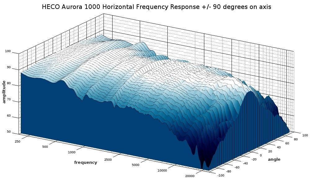

The above polar map shows the same information in the preceding graphs but depicts it in a way that can offer new insight regarding these speakers’ behavior. Instead of using individual raised lines to illustrate amplitude, polar maps use color to portray amplitude, and this allows the use of a purely angle/frequency axis perspective. The advantage of these graphs is they can let us see broader trends of the speaker’s dispersion behavior more easily. More information about interpreting this graph can be read in our loudspeaker measurement article.
Here we see the Aurora 1000 maintains a pretty even dispersion out to nearly 10kHz which, again, is an extremely impressive showing for a large tower of its modest pricing. We get very good coverage out to a 70-degree angle off-axis, so these speakers cover a very wide area with a neutral, balanced sound. As mentioned above, we do see the tweeter start to beam a bit above that point, but that is characteristic of dome tweeters when not loaded in waveguides. Even despite the beaming, we still see a strong even response out to 15kHz at a 30-degree angle, so the beaming behavior of this tweeter is relatively mild compared to other dome tweeters. Maybe there is something to that “Fluktus” tweeter faceplate after all? There is some slight waist-banding (where dispersion tightens across a narrow frequency range) just above 1kHz, but it is almost too mild to be worth mentioning; in fact, I only bring it up just to have something else to comment about, since this is such a good overall measurement set.

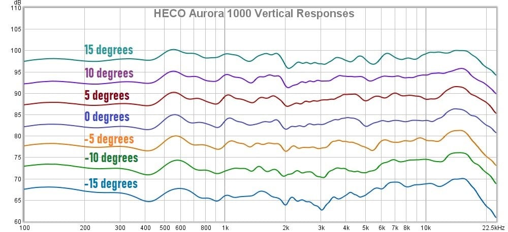

The above graph is a sampling of some of the vertical angle responses at and around the on-axis angle. Negative degrees indicate angles below the tweeter, positive angles indicate angles above the tweeter, and zero degrees is level with the tweeter. The flattest overall response occurs on-axis, but the rest of the vertical angles shown here hold a very good response. What this graph tells us is that this speaker is relatively forgiving of listening heights that are not exactly level with the tweeter. This is unusual for a loudspeaker with such large drivers. In our previous discussion of the bass driver placement, I mentioned that the bass drivers could have been placed on the bottom of the front baffle instead of the middle, and that would have negated ground bounce cancellation. However, such a change in the driver placement might possibly have made the Aurora 1000s much less forgiving for different listening heights on the vertical axis. This is another very good showing, and we can see that you do not need to have your head fixed in a vice for the exact same altitude as the tweeter in order to get hit with a good sound. This speaker should sound good for higher or lower seating positions.

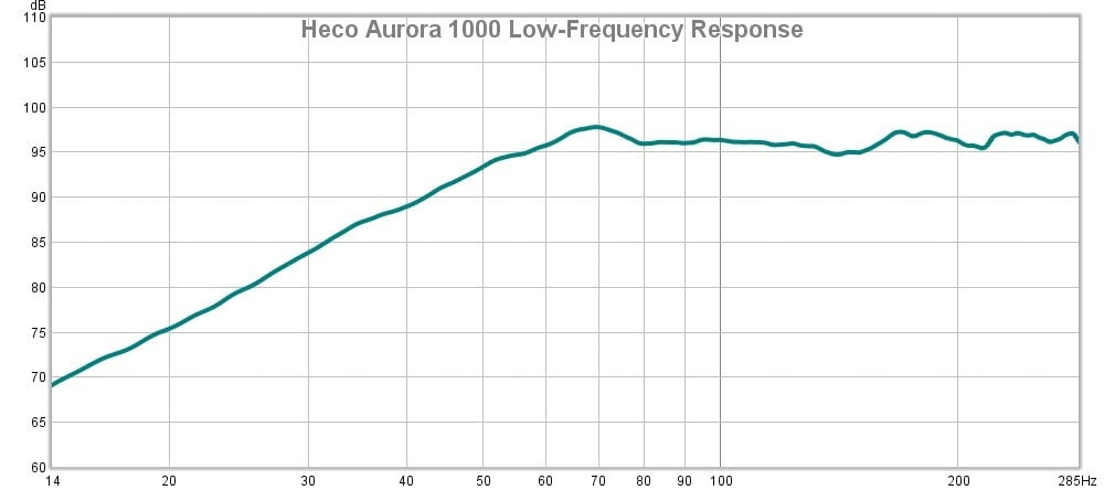

The above graph shows the Aurora 1000’s low-frequency response captured using groundplane measurements (where the speaker and microphone are on the ground at a 2-meter distance in a wide-open area). This is an interesting response. What we see here is an overdamped port response that holds an approximate 12dB/octave slope down to the port tuning frequency. Some manufacturers do this not to use ports to increase bass output but rather to reduce distortion generated by large excursions of the bass driver. At around port-generated frequency output, back pressure produced by the port restricts travel of the woofer so that it is hardly even moving at the resonant frequency of the port. An advantage of this is that the voice coil is in a very comfortable and controlled position within the magnetic field of the motor at such a deep frequency, so any non-linear output is extremely low. I wouldn’t guess that these bass drivers have tremendous excursion ability, so this is probably an intelligent strategy. The Aurora 1000s could produce a nice, punchy, controlled bass but I wouldn’t exactly describe it as thunderous. I think many people would be quite happy with the bass that they deliver. However, home theater aficionados and electronic bass music fiends will probably want to complement these speakers with some subs.

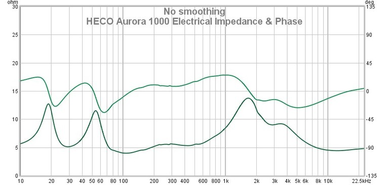

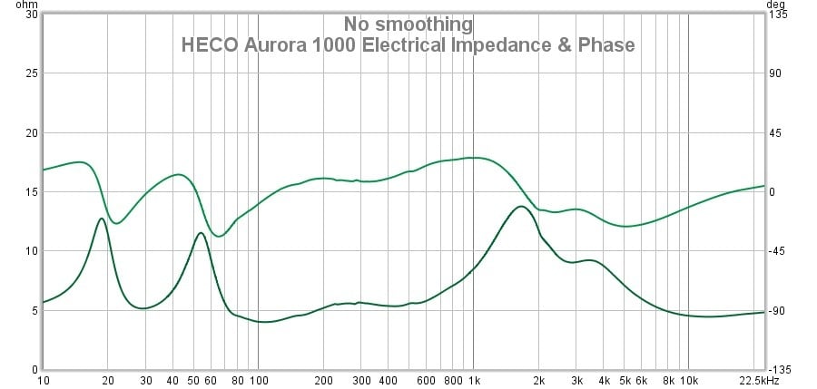

The above graphs show the electrical behavior of the Aurora 1000. HECO’s spec is pretty ambiguous and not very meaningful: “Impedance: 4 - 8 ohms.” I think that spec is there to reassure less-informed consumers who are looking for a matching impedance spec with whatever receiver or amplifier they own. In that sense, it is useful since although these are four-ohm speakers, they are not a tough electrical load otherwise. The impedance minima occur at 4 ohms around 100Hz but not with a very steep phase angle. Most AVRs should be able to drive these just fine, although I wouldn’t rock really hard for an extended time on an entry-level AVR with an electrical load like this.
We do see some small ripples in the
response here, and these are cabinet resonances. It’s a large speaker, and
while there are three window-pane braces, the side panels are not tremendously
thick which is a necessary sacrifice in order to make the speaker affordable.
The audibility of panel resonances has always been questionable, and in my view
manufacturers have often taken to extreme measures in order to strengthen the
cabinet. The good news is that it is very easy and inexpensive as a DIY project
for anyone who would want to add further rigidity and stiffness to the
enclosure. Gluing in additional braces or adding mass to the panels would help
here, as well as adding serious stuffing in the enclosure such as shredded
denim insulation on top of an adhesive bitumen layer to damp internal pressure
waves.
We can tell from the dip in the low-frequency impedance curve saddle that the port tuning frequency looks to be about 30Hz or perhaps just a tad below. The peaks of the saddle have nearly the same height, and that informs us that the resonant frequency of the bass drivers is not that different from that of the enclosure, so it is a relatively balanced system.
I measured the sensitivity to be 90.9dB for 2.83v at 1 meter, which is a bit below HECO’s 93dB sensitivity spec. Even so, 90.9 (let's call it 91 dB) makes the Aurora 1000s a bit above average in sensitivity, and you don’t need a monster amp to get these things loud. A hundred watts should be capable of pushing it to pretty darn loud levels, 110dB at one meter anechoically, and that is quite a bit louder than most people would ever listen to.
