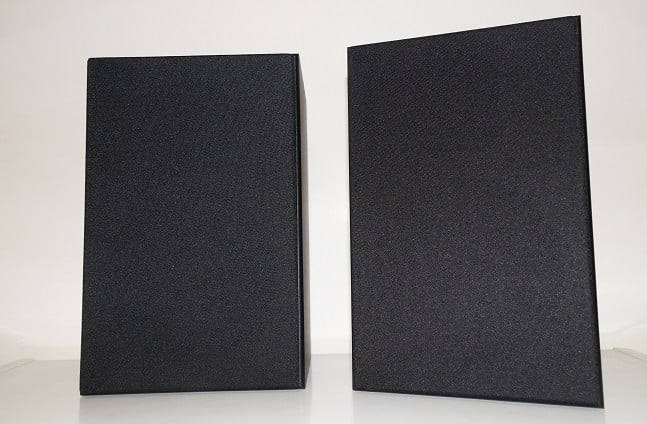

Unpacking and Appearance

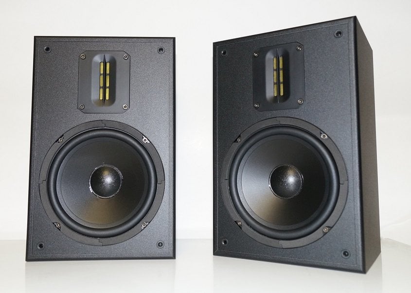

The MP-65RT pair arrived well-packed with cardboard corner pieces lining the box along with thick foam inserts. The speakers were wrapped in plastic bags to protect them from moisture and scuffing. These speakers are relatively light, so this packing should be more than adequate. Out of the box, the MP-65RT look plain: not bad, but not exactly eye-catching either. With the grilles on, they are pretty much just flat, black boxes. They look more interesting without the grilles, where the ribbon tweeter adds a dash of distinction and color. The fact that a $50/pair speaker set does not look flashy does not bother me in the slightest, they are a handsome pair of speakers, all things considered.

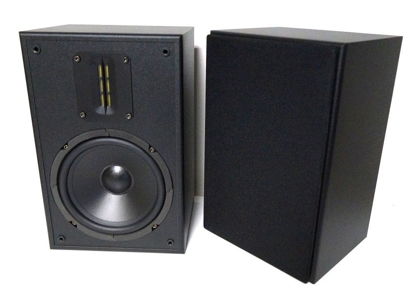

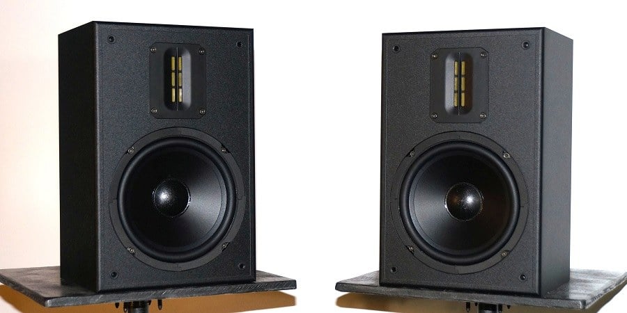

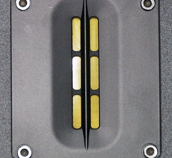

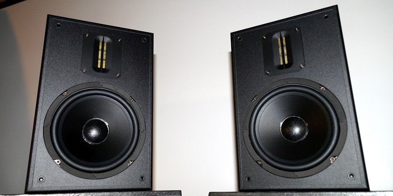

The chief point of distinction on the MP-65RT bookshelf speakers is the ribbon tweeter. One does not normally see ribbon tweeters on speakers of this price class. They have mostly been a feature on far more expensive speakers - until now. What makes a ribbon tweeter so special? The answer is the low mass of the diaphragm. Ribbon tweeters work by placing very thin, conductive ribbon that is usually either conductive tracings on a material like Kapton or simply a very thin aluminum strip in a tightly controlled magnetic field between two permanent magnets. When alternating current is run through the ribbon, it vibrates as its magnetic charge rapidly oscillates between positive and negative (here is a short YouTube video that explains the basics with a simple model). The strip, or ribbon (hence its name), is folded in a zig-zag pattern like an accordion, so that the points where it bends are confined to a small area, and the ribbon moves as a whole in unison.
Proponents of ribbons claim they are better as high-frequency reproducers than domes because their moving mass is much lighter than domes and therefore can accelerate and decelerate much more quickly, and this quicker movement makes for a more realistic sound. However, ribbons have historically had a few disadvantages: they are more expensive to manufacture, they typically have had lower impedance loads and were thus a harder load on amplifiers, and they were fragile so they were not as capable in midrange frequencies as in treble. Monoprice seems to have found a tweeter that gets around these traditional shortcomings (we will look at how they managed to do this in the Measurements and Analysis section). A ribbon design like the one implemented in the MP-65RT that has a small width-to-height ratio suggests it should have wide horizontal dispersion and narrower vertical dispersion, and the waveguide that the MP-65RT tweeter uses should help control that dispersion pattern.

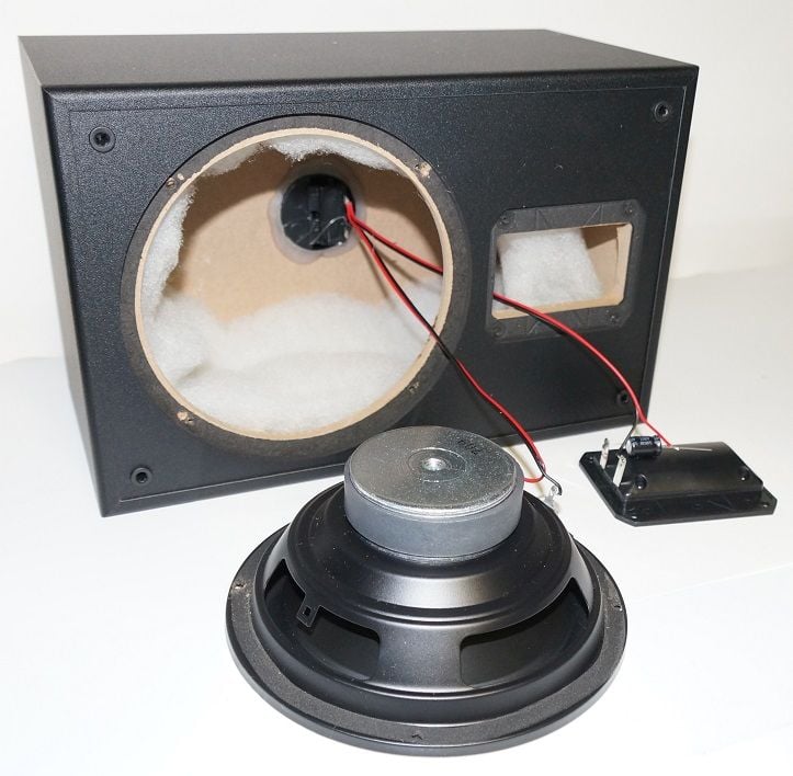

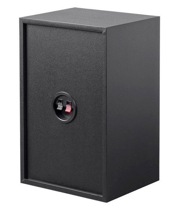

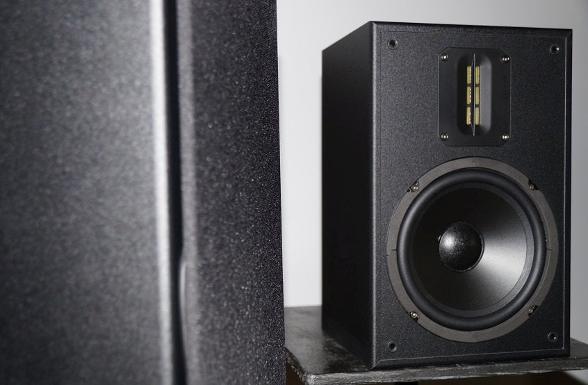

The cabinet of the MP-65RT is pretty basic, as one would expect at this price point. It is made from ½” thick MDF all around and there is no bracing. There is some stuffing lining the cabinet. The removable grille is held in by plastic pegs and is constructed out of a ¼” thick sheet of MDF with shaped cutouts for the drivers and is overlayed by a black acoustically-transparent fabric. The raised edges of the grille cutout around the tweeter is likely to cause some diffraction, so for the best sound, leave the grille off. The terminal cup uses spring-loaded clips to connect to the speaker wire. Some people have complaints that spring-loaded clips feel flimsy, but I don’t mind them; they provide a quick way to get a firm grip on the speaker wire. The disadvantages of spring-loaded clips is they will not fit large diameter banana plugs or large gauge wire, but other than that, they are convenient and do provide a tight connection. The woofer is pretty standard for low-cost speakers, but that is not to say it is bad.
The woofer uses a stamped frame and a reasonably large, but not huge, motor for the task of bass and mids. The permanent magnet is a 7 cm diameter, 1.5 cm thick slug. There doesn’t look to be any venting for the voice-coil, but this isn’t a high power-handling driver, so that might not be a significant omission. The cabinet is sealed, so this woofer doesn’t get any port assistance in reproducing bass. That should make for a higher rolloff frequency but a more gradual roll-off slope, so this is a speaker that might benefit more from being placed near room surfaces for more natural-sounding boundary gain than is had with ported bookshelf speakers.

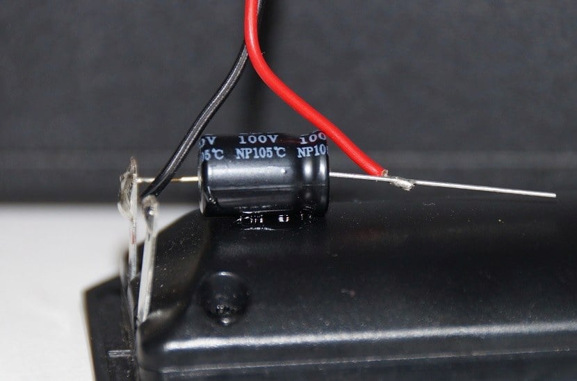

There isn’t much in the way of a crossover circuit, merely a capacitor that is soldered onto the tweeter, so the woofer is running full-range. While it is always preferable to filter out high-frequencies to the woofer to some extent, woofers can be made to handle high-frequency playback gracefully so that their contributions will be less offensive when tasked to play that high. That is very likely the case with this woofer.

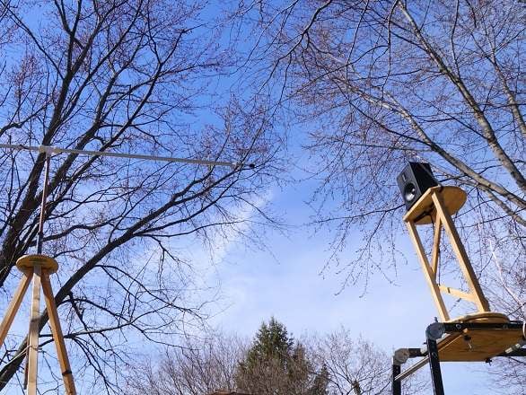

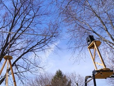

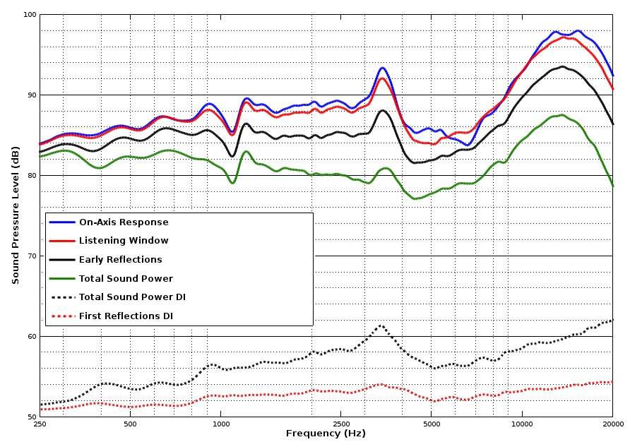

The Monoprice MP-65RT speakers were measured in free-air at a height of 7.5 feet at a 1-meter distance from the microphone, and the measurements were gated at a 8.5 millisecond delay. In this time window, some resolution is lost below 250 Hz and accuracy is completely lost below 110 Hz. Measurements have been smoothed at a 1/24 octave resolution.

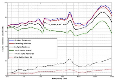

Monoprice MP-65RT response curves
The above graph shows the direct-axis frequency response and other curves that describe the speaker’s amplitude response in a number of ways. For more information about the meaning of these curves, please refer to our article Objective Loudspeaker Measurements to Predict Subjective Preferences. The feature that leaps out the most in the MP-65RT’s response is the eruption of treble that occurs above 8 kHz. That certainly explains the speaker’s brightness. We see this elevated treble in in all of the power responses but the directivity indexes are smooth in that region, and that tells us that this large treble bump happens over a wide angle around the speaker. The good news is that this rise in high-frequency response doesn’t really get significantly hot with respect to the rest of the bandwidth until 9 kHz. That means that elevated treble largely escapes most of the harmonics of human voice and musical instruments, but it will have an audible effect. The narrower spike at 3.5 kHz may have a more significant impact, since it lies in a region that is far more heavily used in recorded content, but that spike is somewhat narrow and so may look more offensive in this graph than it would be heard. What is more, we see it as a feature on the directivity index curves unlike the 8 kHz+ treble eruption, so it doesn’t occur at nearly as wide of an angle over the space around the speaker. Below that 3.5 kHz spike, the response is relatively smooth. The bottom line here, as was heard in the listening sessions, is that ribbon tweeter is working overtime!

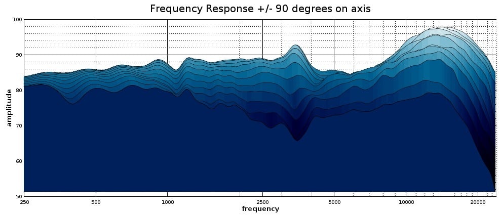

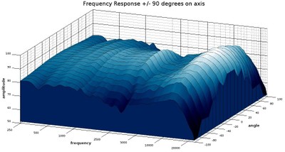

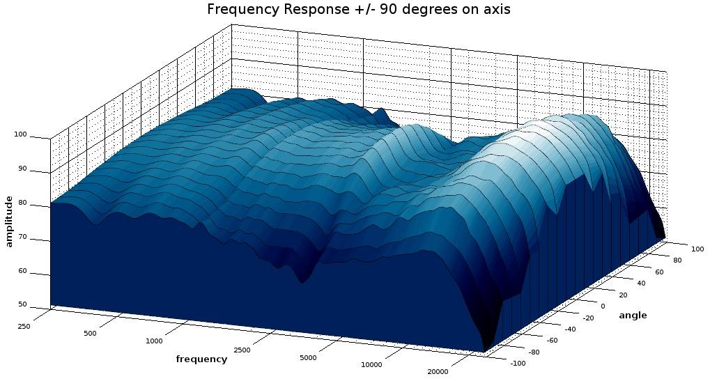

Monoprice MP-65RT Horizontal Response +/- 100 degrees: 3D view
Monoprice MP-65RT Horizontal Response +/- 100 degrees: 2D view
The above graphs depict the MP-65RT’s horizontal dispersion out to a 100-degree angle in ten-degree increments. In these graphs we get a look at how that upper-treble swell behaves at off-axis angles. While it does calm down as we move off of direct axis, it is still considerably hotter than the lower frequency band, so listening to the MP-65RT at an off-axis angle will still make for a bright sound, especially in a more reflective, reverberant environment. To truly take that treble, it would need to be equalized. In these graphs we can see how and why the 3.5 kHz peak crops up so prevalently on the directivity index; by the time it reaches a 90-degree angle off-axis, it has pretty much inverted into a dip. Ordinarily I would assume that kind of behavior to be the result of phase summation and cancellation between the woofer and tweeter, but in this case, it may be the result of breakup behavior of the woofer. The most neutral overall response happens at the 50-degree angle; here is a graph the 50 degree angle versus the direct axis angle for a more distinct look at those two responses:

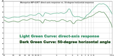

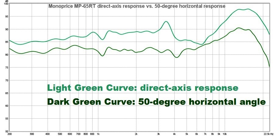

Monoprice MP-65RT Horizontal Response: direct-axis versus 50 degrees off-axis
At 50 degrees off-axis, the response remains very steady until 6 kHz, and the treble eruption isn’t as severe as on direct-axis.

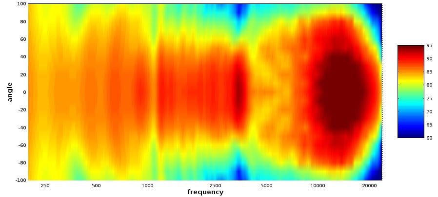

Monoprice MP-65RT Polar Map of Horizontal Response
The above graph shows the same information that the preceding horizontal dispersion graphs do but depict it in a way that offers new insight regarding this speakers behavior. Instead of using individual raised lines to illustrate amplitude, polar maps use color to portray amplitude, and this allows the use of a purely angle/frequency axis perspective. The advantage of these graphs is they can let us see broader trends of the speaker’s behavior more easily. In the polar map of the MP-65RT that excess of treble energy really looms over the rest of the response. We do see that the midrange frequency has a very nicely controlled dispersion up to 4 kHz. Something that is interesting to see is slight lobing patterns from 4 kHz to 7 kHz, as the woofer and tweeter enter into different degrees of phase at various angles and distances. These lobing patterns are inevitable when the woofer is allowed to run full-range, but they are not severe on this model.

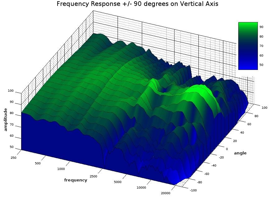

Monoprice MP-65RT Vertical Response +/- 100 degrees: 3D view
The above graph depicts the MP-65RT’s frequency response behavior on its vertical axis, where zero degrees is directly in front of the tweeter, negative degree values are below the tweeter, and positive degree values are above the tweeter. The valleys that occur above and below the zero-degree axis are very common in conventional loudspeaker design. They are the result of the tweeter and woofer playing the same frequencies but out of phase, so they are not synchronous. They are usually only fully synchronous directly ahead of the speaker. The lateral response matters far more than the vertical response, since most listeners will be on roughly the same height and also since the ear is much more sensitive to side-wall reflections than floor or ceiling reflections, so the ragged response off the direct axis shouldn’t be a cause for too much concern. The tweeter itself seems to exhibit some odd lobing patterns as the angle moves off direct-axis. It also swiftly loses amplitude off direct-axis, very much unlike its horizontal response. This is all predicted by its narrow width relative to its height. The story here, as with most two-way bookshelf speakers, is that the MP-65RTs should be listened to with your ears at speaker height, not above or below the speaker.

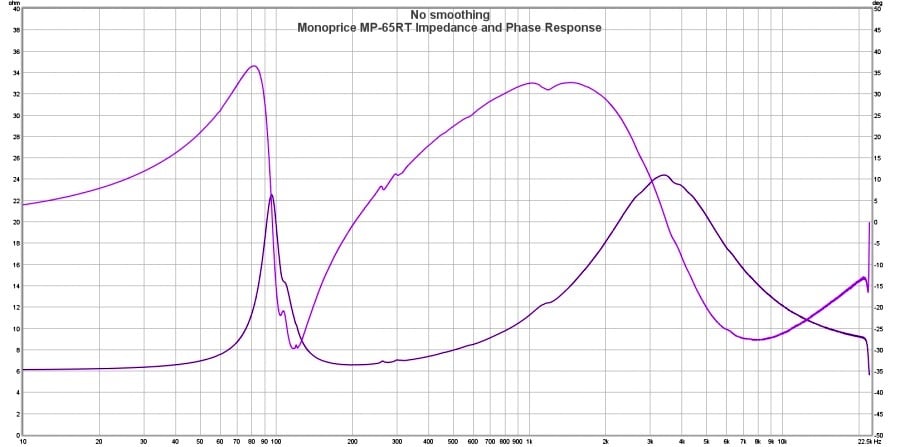

Monoprice MP-65RT Impedance and Phase Response
The above graphs show the electrical behavior of the MP-65RT speaker. This should be a relatively easy load for any amplifier to drive, with a minima at 6 ohms and soft phase angles at those points. All steep phase angles occur at high impedances. It can be seen that the resonant frequency of the woofer happens just under 100 Hz due to the impedance spike and sharp phase change. There are ripples in the impedance and phase curves that are evidence of cabinet resonances, and this is not surprising given the minimal cabinet construction. Monoprice specifies the MP-65RT as a 6 ohm speaker, and this is a conservative rating. I measured the sensitivity at 86.1 dB at 1 meter for 2.83v which is respectable for a sealed bookshelf speaker of this cost. That closely matches Monoprice’s spec of 87 dB for 1 watt at 1 meter. This speaker does not need a lot of power to get loud, which is good because it wouldn’t be able to handle a lot of power anyway. A 15 to 30-watt amplifier would make this speaker sing nicely.

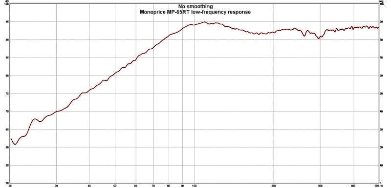

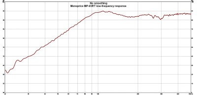

Monoprice MP-65RT Low-frequency Response
The above graph shows the MP-65RT’s amplitude response in bass frequencies. It was captured by using groundplane measurement techniques. The bass response here is overall quite good, considering the cost of the speaker. The response above the resonant frequency near 100 Hz is relatively flat and even. The bass is slightly bumped up around resonance, but it is a mild enough rise that it should not register as ‘boomy.’ It does start to roll-off at a relatively high frequency, but it does so at a more gradual 12 dB/octave slope than what would be seen were this speaker ported. The good news about this kind of gentle slope is that it will get more reinforcement below the resonant frequency than a steep slope and so is likely to get more assistance from room gain and boundary gain. However, for content with heavy bass or deep bass, a subwoofer should be used, since that budget 6.5” woofer isn’t likely to have a lot of excursion.
