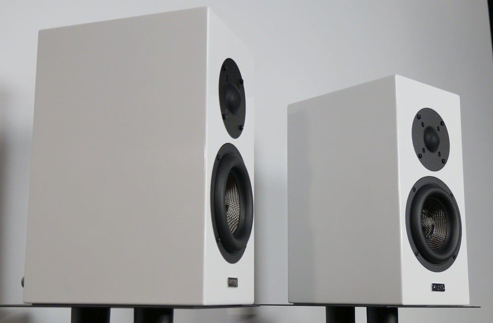

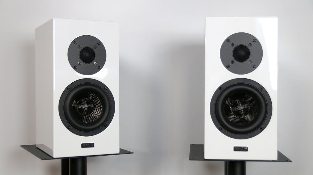

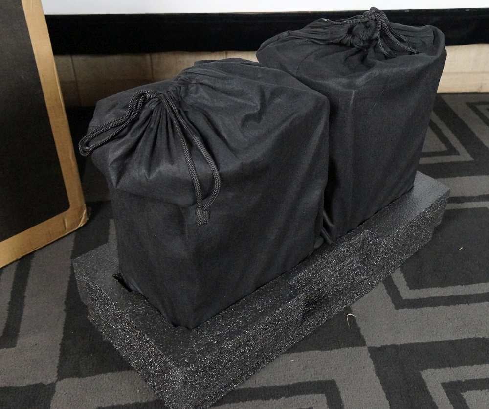

The OPAL1s arrived at my doorstep in an uncharacteristically heavy package for Dayton Audio speakers. Both speakers came in a single box, so they do not ship individually. They were double-boxed with an additional layer of cardboard to help remove the speakers from the inside box, so the lengthwise panels were protected by three layers of cardboard. Inside the cardboard, the speakers were sandwiched between thick polyethylene blocks to protect them from shocks. The speakers themselves were wrapped in some drawstring cotton sacks to protect against moisture and scuffs. Overall, the packing was quite good and protected these speakers from the usual abuses of parcel shipping services.

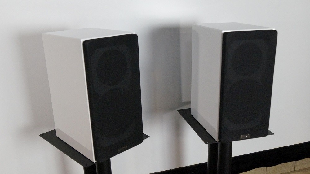

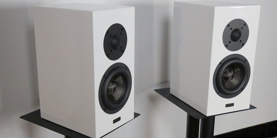

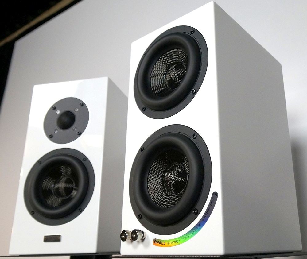

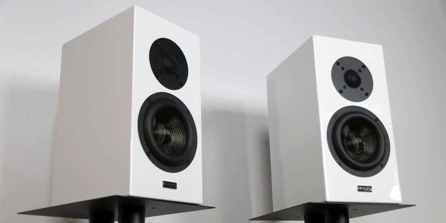

Once unpacked, the OPAL1s revealed themselves to be gleaming white boxes with some beefy-looking drivers installed. The pair I received came in a gloss white finish, but they can also be had in gloss black. The edges have a very slight rounding, and that does help to soften the appearance a bit, but the enclosures are still just oblong boxes without any larger shaping. Aside from the tweeter and woofer, the only other visual feature on the OPAL1’s front baffle is a Dayton Audio badge near the lower edge. The woofer has a very beefy surround and a carbon fiber cone, so it looks like it means business. The tweeter dome is protected by a fine mesh cover, so the dome itself isn’t easy to see. For those who don’t want to see the drivers, the supplied grille hides the front baffle with an acoustically transparent black fabric. In my opinion, the grille dulls the OPAL1’s appearance, so I would leave the grille off if possible. The rear of the speaker deserves mention for its appearance as well. Two passive radiators that look just like the bass driver cone occupy nearly the whole of the rear panel. It doesn’t leave much room for the binding posts, but Dayton Audio has managed to sneak them in at the lower left corner of the rear panel. The product information label is handled cleverly, and it follows the curve of the lower passive radiator with a reflectively colorful top coating.
Overall, the OPAL1s look like pretty conventional high-end speakers. Dayton Audio has played it safe in not chasing any flamboyant styling cues, and I think that will pay off for them.

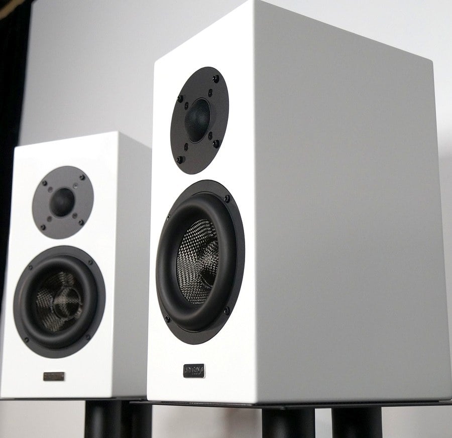

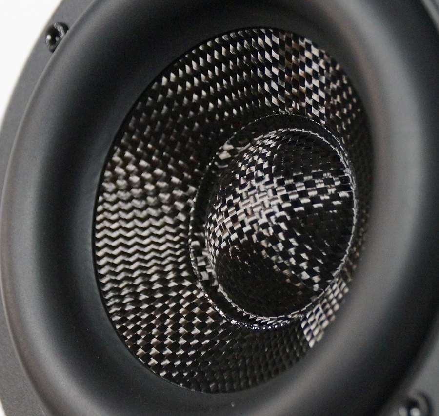

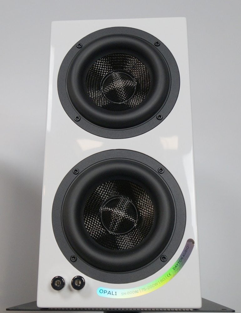

The OPAL1 bookshelf speaker looks as though they are designed to get as much low-frequency extension and dynamic range as possible out of its compact cabinet. The heart of this speaker is the bass driver, a member of Dayton’s Epique series, the E150HE 44. To squeeze a lot of bass out of a small container, the driver needs a lot of excursion, and this driver is positioned to do just that. It uses a 5 1/2” diameter carbon fiber cone attached to a very beefy surround and a spider that is as large as the cone itself.

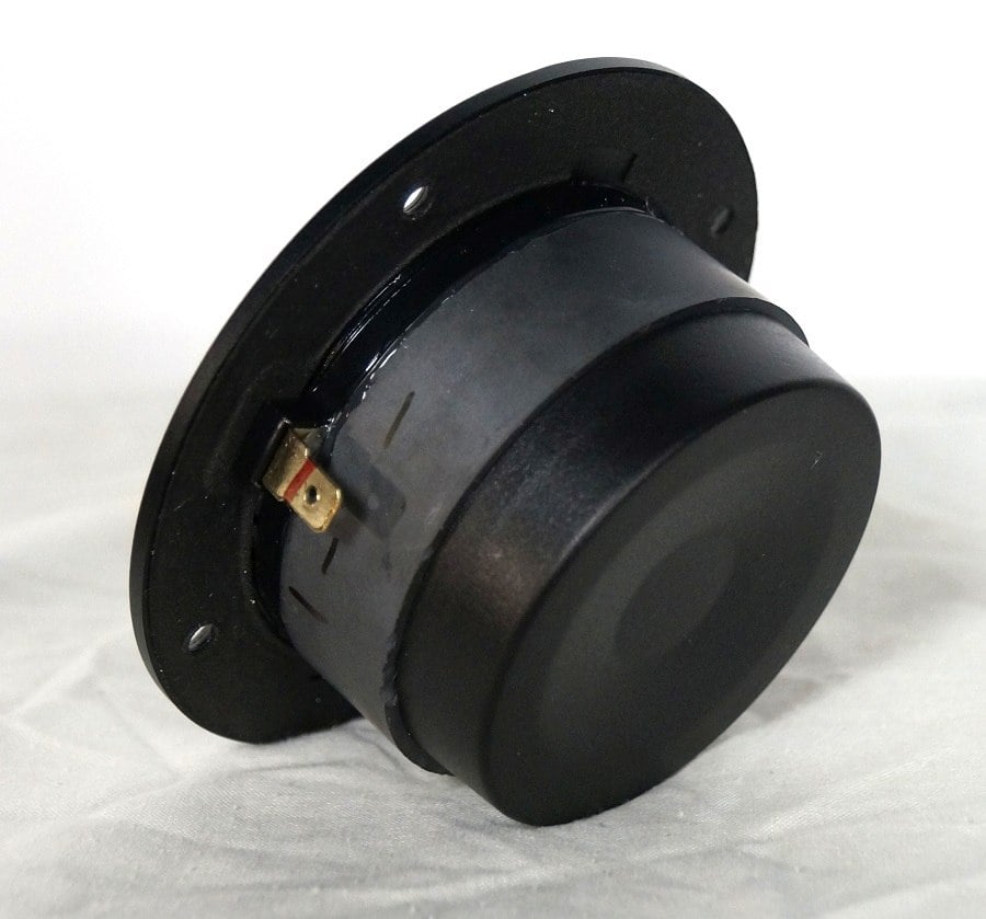

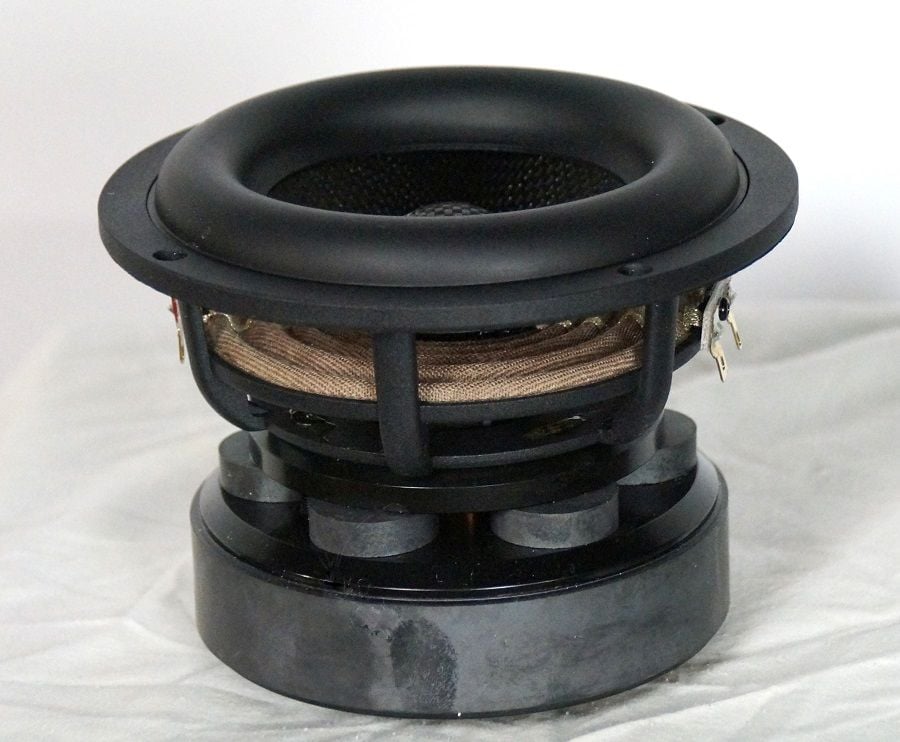

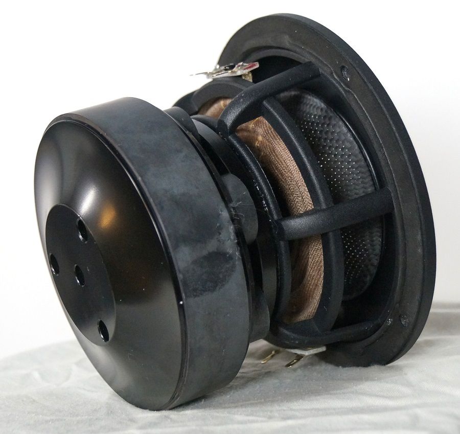

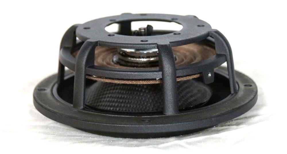

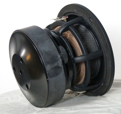

The bass driver uses a cast aluminum basket that leads down to a very curious motor structure that Dayton Audio calls the “Multiple Magnet Air Gap,” or MMAG. This motor has two magnetic assemblies: a large “main” magnet and a ring of 6 smaller “gap-balancing” magnets. These gap-balancing magnets are supposed to create a more stable magnetic field over a larger gap. Two top plates sandwich the gap-balancing magnets. The bass driver uses an underhung coil, and this type of design typically needs a lot of magnetic flux over a wide area to work well. Indeed, the magnet used in this driver is a big one, about as large as the cone itself, and with a 1” thickness. It weighs over 8 pounds alone − one of the heaviest I have seen in a 5 1/2” driver. Dayton claims this driver has zero loss of magnetic force out to 10mm of excursion, and an incredible 14mm of Xmax (at 70% Bl). That is pretty stunning for a 5 1/2” bass driver, especially one with as wide a bandwidth as the E150HE 44 (which is specified to have a smooth response up to 3kHz).
The OPAL1 is specified to handle 200 watts of power, most of which would go to the bass driver, and that means it will need a substantial amount of coil and cooling. Typically, small bass drivers with high excursion and lots of coil mass also have lots of induction, but the split gap topology and dual voice coil design seem to do a lot to mitigate that. The E150HE EE also uses a full-length copper sleeve on the pole piece to reduce induction effects. Induction can dramatically limit the bandwidth of a driver, as well as increase even-order distortion. With a claimed smooth response up to 3kHz, this driver seems to have addressed that problem nicely.

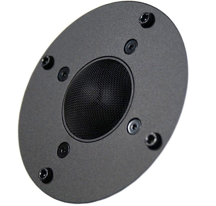

This unique bass driver is paired with Dayton Audio’s best soft dome tweeter, the RST28F-4. This 1 ⅛” silk dome uses a tuned rear chamber for better control of the low end of its response. It also has a copper shorting ring and a phase lens for a smoother response at the top of its bandwidth. A ferrofluid-cooled motor system, along with a big ferrite magnet, should greatly assist against thermal compression. With a 710Hz resonant frequency (Fs) and a usable response from 1.4kHz to 20kHz, it looks to be a good pairing with the Epique bass driver.

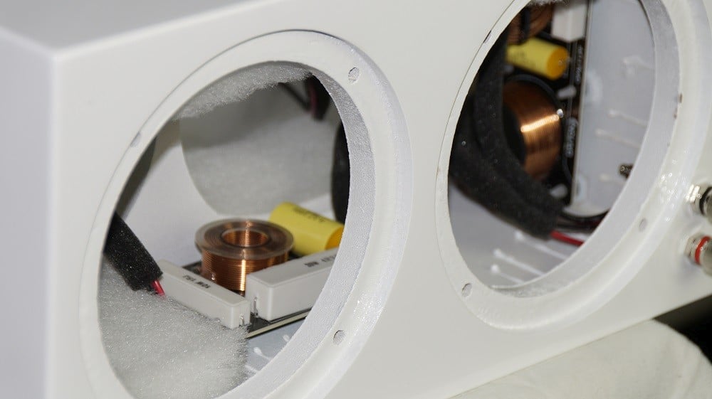

The woofer crosses over to the tweeter at 2.3kHz using a 12dB/octave high-pass filter on the tweeter and an 18dB/octave low-pass filter on the woofer. Inside the cabinet, we see a slew of heavy-duty poly-film capacitors, resistors, and air-core inductors. The crossover circuit is divided into two separate boards, one installed on a side panel and the other installed on the bottom panel. I would guess that mounting those components on a single circuit board would have made that board too large to fit inside the enclosure. Separating out the crossovers also has the benefit of improved signal isolation between the drivers too. The build of this crossover circuit certainly befits the high-end status that this speaker is vying for. Connectivity is a pair of five-way binding posts that jut out of the cabinet.
The OPAL1 uses two passive radiators to shore up the low end. As was mentioned before, these radiators look identical to the bass driver from the outside of the speaker. Given the Xmax of the Epique bass driver, two of these radiators are needed. (As a rule, passive radiators ought to have double the displacement of the bass driver.) These radiators are specified to have 19mm of Xmech each, so they more than meet the requirement for doubling the bass driver displacement. The enclosure is made from ¾” MDF panels all around, and there is a windowpane brace bisecting the cabinet in a lengthwise direction. Every surface that doesn’t have crossover components or drivers is covered with a layer of acoustic stuffing. The interior of the enclosure is painted, a nice touch since exposed MDF can swell if exposed to high-humidity conditions. There is also padding around the wiring, which is a good idea to prevent the audible buzzing of the wires vibrating against interior objects. There are no installed feet, but Dayton Audio has supplied the OPAL1s with some adhesive rubber feet that the user can install if they wish.

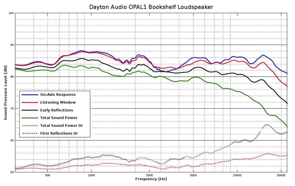

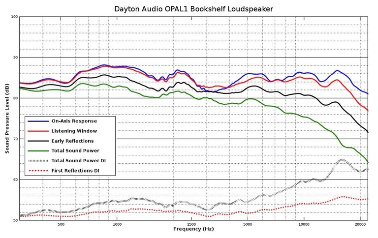

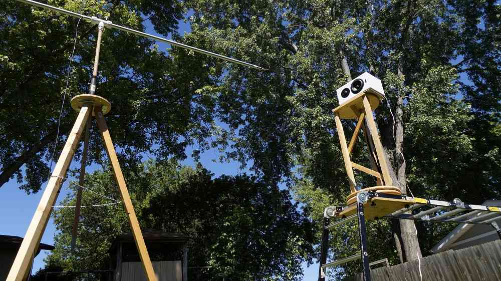

The Dayton OPAL1 speakers were measured in free air at a height of 7.5 feet at a 1-meter distance from the microphone, and the measurements were gated at an 11-millisecond delay. In this time window, some resolution is lost below 250 Hz and accuracy is completely lost below 110 Hz. Measurements have been smoothed at a 1/24 octave resolution.

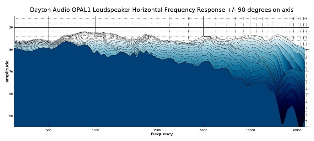

The above graph shows the direct-axis frequency response and other curves that describe the OPAL1’s amplitude response in a number of ways. For more information about the meaning of these curves, please refer to our article Understanding Loudspeaker Measurements Part 1. At a glance, these measurements would indicate a rather nonlinear loudspeaker. However, ground plane measurements do counteract some of the would-be irregularities depicted here, so the OPAL1s aren’t likely to yield an in-room response as peculiar as would be expected from this graph. The areas of interest are a wide Q elevation centered just above 1kHz and a dip centered around 3kHz. Typically, a sound system with an elevation around 1kHz would sound ‘shouty’ or ‘chesty,’ but I didn’t hear much of that in my own listening, and it was only when I A/B compared the OPAL1s against my extremely neutral 1802G reference speakers that I got a sense of any of that at all. In later listening on reference tracks, I thought I might have heard a slight dearth of upper bass, but it was mild at worst. In-room measurements seemed to pan out that perception. As for the dip around the crossover frequency, the sound didn’t seem to be missing anything in that range, even when comparing the OPAL1s to my neutral reference speakers. The in-room frequency response didn’t exhibit any comparably major dips in that region either, likely because it is more a phenomenon of the on-axis response than off-axis responses. A mere glance at the OPAL1 “spin-o-rama” curves would likely be misleading as to the tonal sense that these speakers impart in real-world listening. If I had judged it only from this graph, I would not have guessed that I would like the OPAL1 as much as I did.

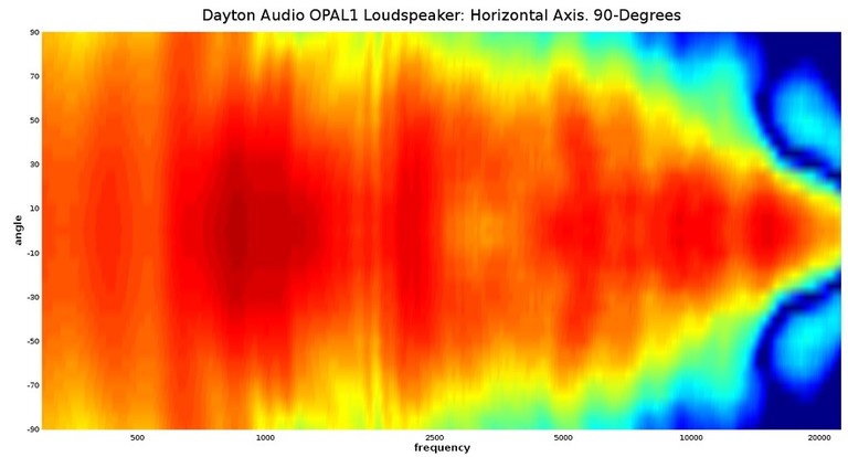

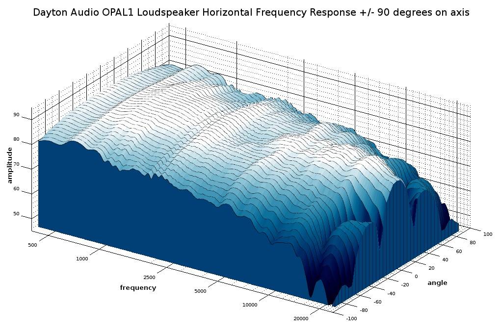

The above graphs depict the speaker’s lateral responses out to 90 degrees in five-degree increments. More information about how to interpret these graphs can be read in this article: Understanding Loudspeaker Review Measurements Part II. In these graphs, we get a better look at how the on-axis response and nearby angles compare to the off-axis responses. One interesting aspect that the above curves reveal about the OPAL1s is that the crossover dip is more of an artifact of the on-axis response than off-axis. The directivity matching between the tweeter and woofer looks very good overall, and it may be that incurring an on-axis notch was the penalty for that. I would say that is a wise decision because my in-room measurements showed there was little evidence of a dent at the crossover frequency. This family of curves has good correspondence to each other in general, so those who want to use equalization to adjust these speakers to taste should be able to do that fairly easily.

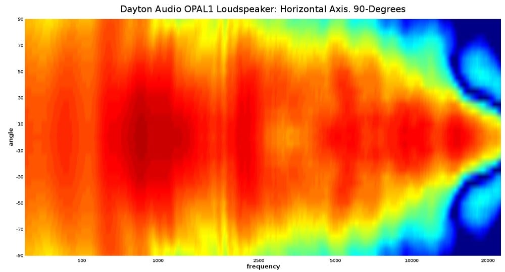

The above polar map graphs show the same information that the preceding graphs do, but they depict it in a way that can offer new insight regarding these speakers’ behavior. Instead of using individual raised lines to illustrate amplitude, these polar maps use color to portray amplitude, and this allows the use of a purely angle/frequency axis perspective. The advantage of these graphs is that they can let us see broader trends in the speaker’s behavior more easily. For more information about the meaning of these graphs, we again refer the reader to Understanding Loudspeaker Review Measurements Part II.
Given the design of the OPAL1, we would expect a wider dispersion loudspeaker, and that is what we see here. Smaller diameter woofers and domes unconstricted by waveguides will put out acoustic energy at a wider angle, and we get a fair amount of output out to 70 degrees before the tweeter begins narrowing its directivity. The upper-treble contraction of energy from the tweeter is also something very characteristic of domes mounted on flat baffles with no waveguides. Those who want to be hit with upper treble should aim the speakers directly at the listening position. Those who want a softer sound can simply toe the speakers inward less. Very high treble notwithstanding, these speakers aren’t that fussy with angling and should have a similar sound over a wide area.

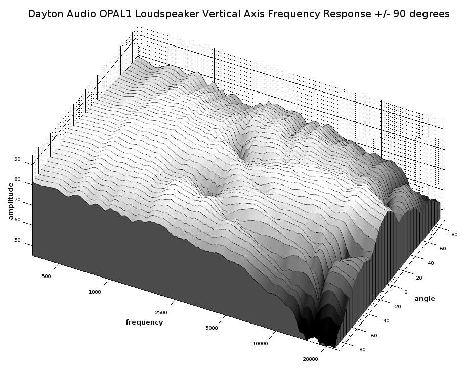

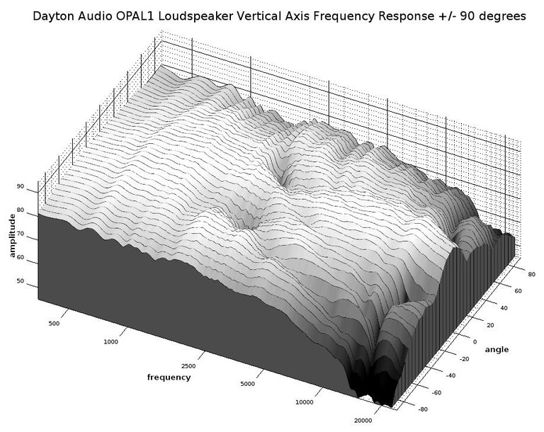

The above graph shows the OPAL1’s response behavior along its vertical axis where zero degrees is directly in front of the tweeter, negative degree values are below the tweeter, and positive degree values are above the tweeter. As with most loudspeakers, the OPAL1 is best listened to on-axis, so try to get it placed with the ear about level with the tweeter. The user does have a bit of vertical room before crossover nulls start to take a bite out of the lower treble, about +/- 10 degrees. Above or below a 10-degree angle, the response becomes a bit rougher as the tweeter and woofer start fighting over their shared bandwidths since their distance difference begins creating phase conflicts.

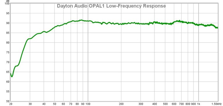

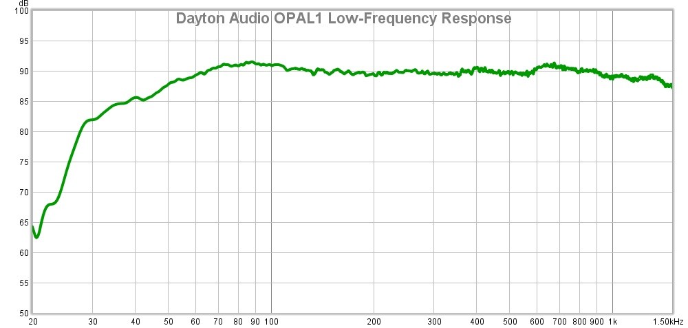

The above graphs show the OPAL1’s low-frequency responses that I captured using groundplane measurements (where the speaker and microphone are on the ground in a wide-open area). We have done something a bit different from the usual in increasing the shown bandwidth out to 1.5kHz in order to show the difference between this groundplane measurement and the free-air measurements shown in previous graphs. The reader might ask which is correct since they are showing significant differences, and the answer is both are correct. The acoustic circumstances are creating a difference where upper bass is transitioning to midrange; in the free-air graphs, the midrange becomes elevated, but in our groundplane graphs, we see a pretty steady flat response from 60Hz all the way up to nearly 1.5kHz. Both measurement techniques are anechoic in the sense that there are no acoustic reflections being picked up by the microphone, but the groundplane measurement looks to be getting some boundary reinforcement that is filling in the upper bass gap seen in the free-air measurements.
So then the question becomes, which of these measurements will be more reflective of the speaker’s tonality in real world listening? The answer depends on the user’s acoustic environment, but the vast majority of typical listening situations will have a good deal of boundary reinforcement, especially as the speaker gets placed closer to backwalls or sidewalls. A small speaker like this is really meant for smaller room listening and so is much more likely to be placed near a surface than placed out in the middle of a room. My own in-room measurements resembled the groundplane measurement rather than the free-air measurements as far as the bass to midrange frequency band went. For this reason, I believe that the groundplane measurement is more indicative of the OPAL1’s tonality than the free-air measurement.

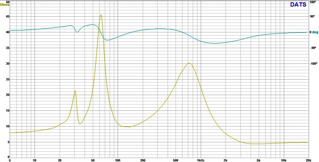

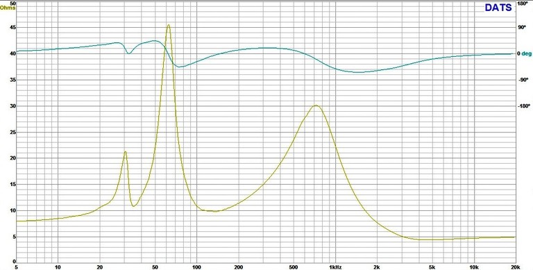

The above graph shows the electrical behavior of the OPAL1 speakers. One notable attribute we can see from the height disparity of the second peak in the lower frequencies is that the resonance of the bass driver is significantly lower than that of the enclosure. We can also see from the dip between the two peaks that the passive radiator tuning lies between 30 to 40Hz. Dayton Audio specifies this to be an 8-ohm nominal speaker, and I would say that while technically that is a stretch, in practice it is acceptable. The reason why it is a stretch is that most of the tweeter’s bandwidth is spent under 5 ohms, nearly bottoming out at 4 ohms at 5kHz. However, the tweeter doesn’t command a lot of power, so this shouldn’t be hard for any amp to run, especially since the electrical phase isn’t doing anything dramatic in that range. The bass driver, which can use a lot of power, has a fairly benign impedance load, staying at 8 ohms or above.
The impedance isn’t what makes the OPAL1 a difficult speaker to drive, but the sensitivity might, depending on the user’s SPL demands. I measured the OPAL1’s sensitivity to be 76dB for 1 meter at 2.83Vrms. That is very low, even lower than Dayton Audio’s specification of 78.5db for 2.83v at 1 meter, and by far the lowest I have encountered in a loudspeaker. So how bad is such a low sensitivity? It depends on your use case. If you intend to drive these speakers with a low-wattage amp, they will be very limited in output, but with a 200-watt power-handling spec, they can rock if you feed them adequate power. They will never be extreme SPL beasts, but they definitely have enough headroom for a bedroom or small to medium-sized living room for any reasonable output level. They can get loud, but they do need a real amplifier to achieve that loudness.
