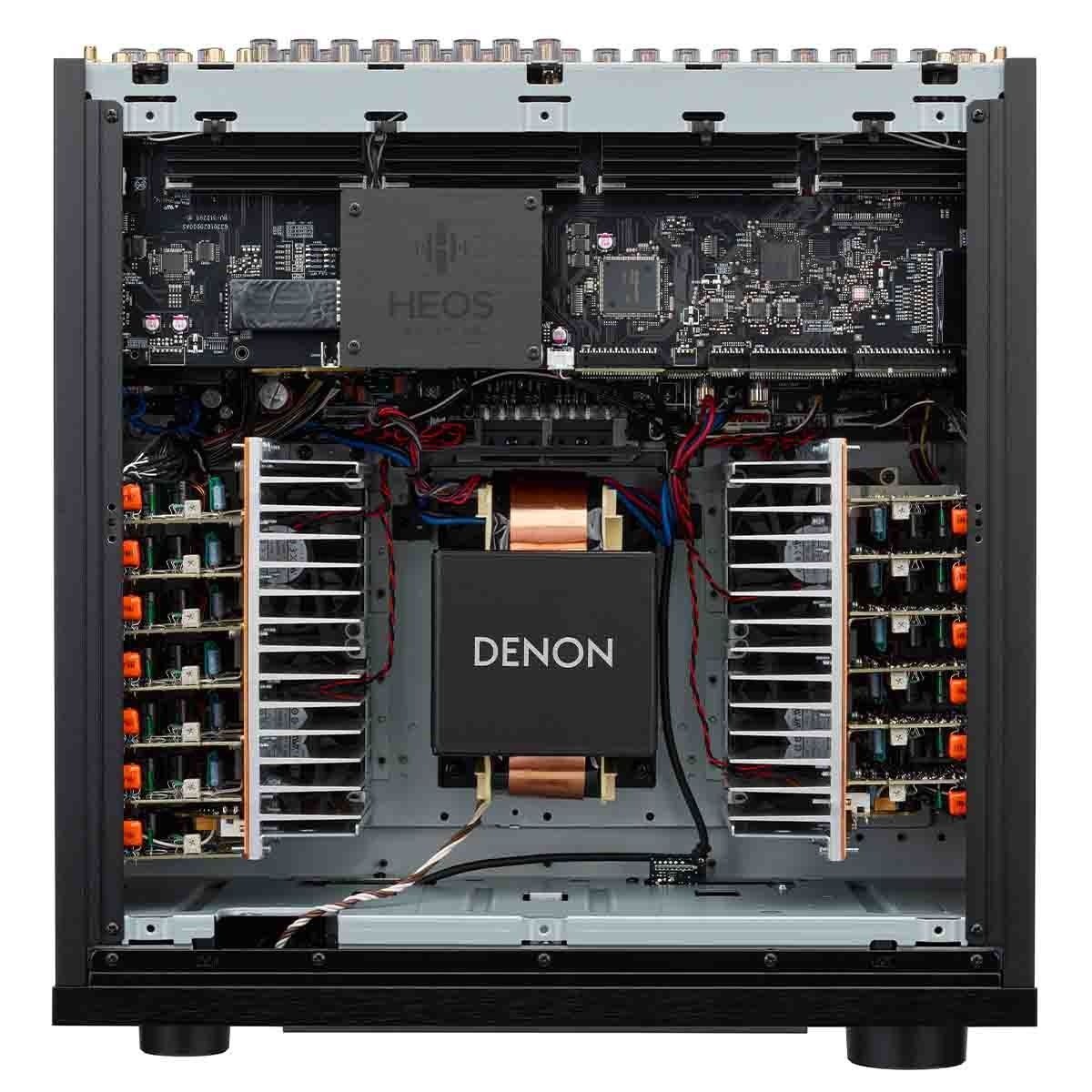

Top View of Denon AVR-A10H - uses similar sized power transformer & capacitor bank from the X8500H
Like the flagship AVR-A1H, the new AVR-A10H is rated at 150 watts per channel (with two channels driven). The AVR-A10H’s 13-channel monolithic amplifier sees each channel built on its own PCB to minimize crosstalk and distortion. That’s what we’d expect in a high-end amplifier design, but not something you can take for granted in an AVR with a high channel count. Thanks to Denon’s 70% power guarantee, users might expect to see 105 watts per channel of real-world power with 5 channels driven. But in recent years, flagship Denon products have proven themselves to be overachievers, easily hitting 70% of rated power with seven channels driven, rather than just five. For the A1H, Denon’s engineers were able to maintain 70% of rated power with up to 9 channels driven thanks to the massive power reserves and lots of heatsink area! That’s pretty badass, and we’re eager to see whether the new AVR-A10H has sufficient power-supply chutzpah to come close to matching such an impressive achievement.

As a member of the revered A-Series, the AVR-A10H boasts high-grade components, including a new ESS DAC array comprising nine “audiophile-grade” 2-channel DAC chips to maximize resolution for all 13.4 channels. Denon does not specify which ESS chips are used, but the AVR-A10H supports hi-res audio up to 24-bit/192kHz, so users of Tidal, Qobuz, Apple Music, and other high-res audio sources can stream to their hearts’ content without sacrificing audio quality. While the A10H’s 13 channels of amplification are rated at the same 150 watts as its predecessor (AVR-X8500H), the new receiver benefits from an upgraded OFC (oxygen-free copper) wound transformer engineered to provide exceptional sound quality, resulting in what Denon describes as “a significant performance upgrade.” The A10H also features premium gold-plated speaker terminals and a rigid, three-layer chassis designed to protect against vibration and interference, “significantly reducing noise,” according to the company.
