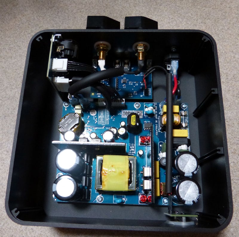

Design Overview

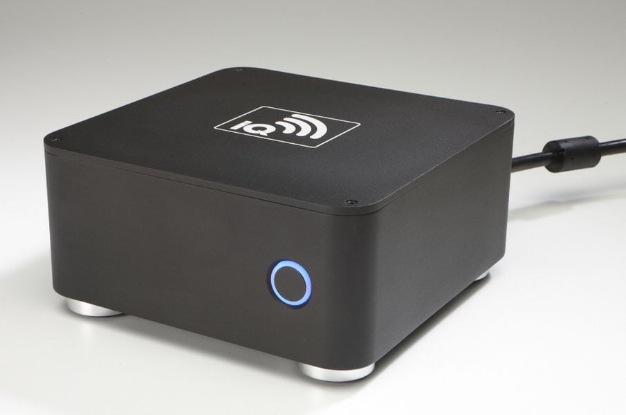

The IQ M300 was designed to be a compact, impeccably-built, audiophile-grade amplifier able to deliver real FTC rated power, all at a reasonably affordable price point. IQ Audio claimed they also wanted a very quiet amplifier with a real black background. The M300 is said to achieve 40uV to 50uV micro-volts total noise which we will validate in the measurements portion of this review.
In speaking with company CEO Bruce Weisberg, he told me they used as design references, two of their favorite solid-state amplifiers from Spectral and Pass Labs. Their goal was to try to achieve maximum resolution while maintaining musicality. The reference speakers they tested the M300 on were Quad electrostatics, Bruce’s personal long-time favorite.
Input Stage
The M300 utilizes a micro controlled input buffer stage. This section controls the start up of the amplifier, and allows for control over the amplifier and feature set. This buffer section is said to achieve high common mode rejection for excellent noise immunity to increase dynamic range. The balanced and un-balanced inputs have 100K input impedances making the M300 very compatible with both tube and solid-state preamps.
The microprocessor allows 12V remote start up and shut down, without the use of energy wasting secondary transformers. In fact, the power supply meets all Energy Star requirements.
Power Supply
To supply the rated 300 watts of FTC-rated power would require a hefty 10-12-pound transformer. Rather than using a conventional linear power supply which can inject hum or buzz on sensitive equipment, IQ Audio instead opted for a power supply based upon the efficient zero-voltage, zero-current switching technology, which IQ Audio claims yields ultra-fast response while greatly reducing radiated and conductive electromagnetic interference and high frequency noise on the DC power supply.
In the IQ design, the transistors turn on and off at zero-voltage and zero-current, reducing power supply stress, reducing the amount of filtering and shielding required, reducing heat, and lowering RF interference. Keeping RF noise and EMI interference low in a power supply was a fundamental goal. IQ Audio believes this contributes significantly to the transparent reproduction and increased dynamic range from the M300 amplifier.
In other conventional switching power supplies, the power transistor turns on and off with a lot of voltage present. This stresses the power supply and creates the need for greater filtering, shielding, etc. By integrating the power supply with the Class-D section IQ Audio engineering was able to shorten the electrical paths.
The Class-D Output Section
The IQ M300 Class D section is a self-oscillating design. Special attention was paid to the feedback control loops, which includes the Class D output filter. The goal was to maximize loop gain with utter stability.
The Class-D circuit runs at approximately 500Khz, and IQ Audio uses the fastest switching devices to achieve optimal results. As you will see in our detailed measurements, the M300’s frequency response is independent of the impedance load, and the amplifier is stable with reactive loads and loads down to 2 ohms.
IQ Audio M300 Top View with cover removed

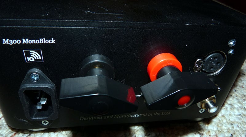

IQ Audio M300 Backview

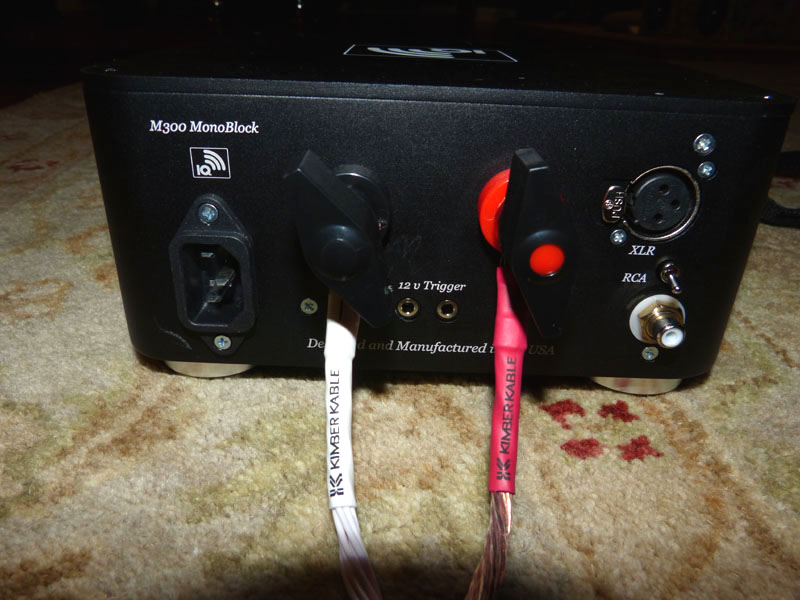

The M300 comes
with heavy duty 14AWG detachable power cord with ferrite beads attached to both
ends, presumably a necessity to pass CE radiated emissions due to the high
switching frequency of the Class D operation.
It sports a hospital grade 3-prong plug with a sticker claiming
“grounding reliability can only be achieved when this equipment is connected to
a receptacle marked hospital grade”.
Sounds serious, but I had no grounding issues plugged into my ordinary
15 amp household outlets.
Torque binding posts are used for the speaker connection terminals (same ones on the Pass Labs X350.5 amplifier we’ve recently reviewed). I’m not a big fan of this connection type since I typically prefer banana terminations, but luckily I had some Kimber 8TC cables on hand with spade terminations that made a very firm connection to the M300 terminals once I tightened them down. The M300 has both balanced and unbalanced input connections and 12v triggers. The chassis is not your run-of-the-mill thin sheet metal found on AV receivers. It’s significantly thicker giving the unit a very rugged build quality. Potential owners should be particularly proud of the fact that this amplifier is fully designed and manufactured in the USA as you can see stamped on the back panel. The CE mark is on the bottom of the unit and its rated power consumption (I assume a max rating) is 500 watts.

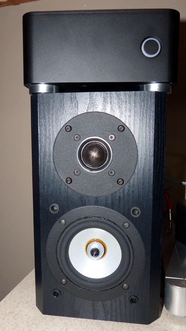

I honestly wasn’t expecting much of a sonic difference driving the little EMP E-41-SE/B speakers with the M300’s despite their much higher power rating than the EMP VT-40.2 20wpc tube amp in such a small room in a near-field listening environment, but the difference was significant.. The M300’s really brought new life to my little EMP speakers. These EMP speakers are very revealing but a bit lacking in bass response due to their size. However, driven with the M300’s, the bass they were producing was much snappier and had more weight. The noise floor also seemed lower allowing me to extract details I previously wasn’t able to do with the EMP tube amp. I did feel the VT40.2 had a bit more warmth in the top end but that didn’t mean the M300 was fatiguing by any means. So far I was just using my paid subscription to Pandora.com for initial sound evaluations but it was time to move on to higher fidelity pastures.

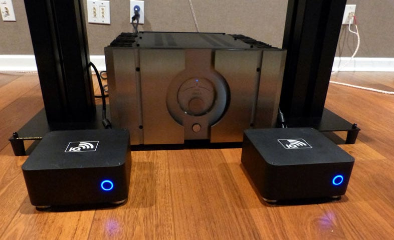

IQ Audio M300's dwarfed in size by the Pass Labs X350.5

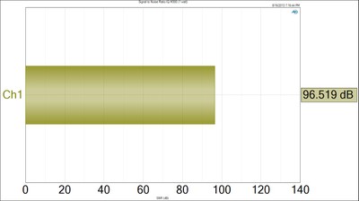

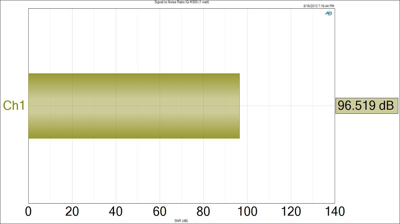

Signal to Noise Ratio
IQ Audio M300 SNR (A-wt) @ 1 watt
I was expecting poor noise measurements on the M300 since it’s a Class D amp and I didn’t have a pre-condition filter to prevent slew-induced input distortion and noise for my Audio Precision test gear. I was pleasantly surprised to get excellent SNR results nonetheless. With 115mV input, I measured 96.5dB at 1 watt A-wt and 85db with no filter. At 150 watts, the SNR was 118dB A-wt. That’s impressively quiet and seemed to validate the manufacturer rating of 40-50uV.

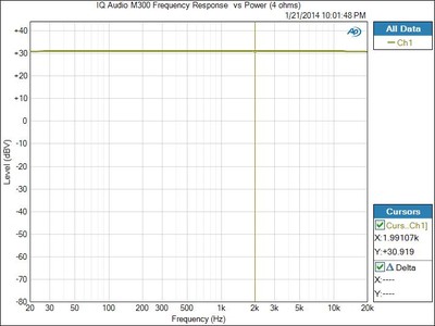

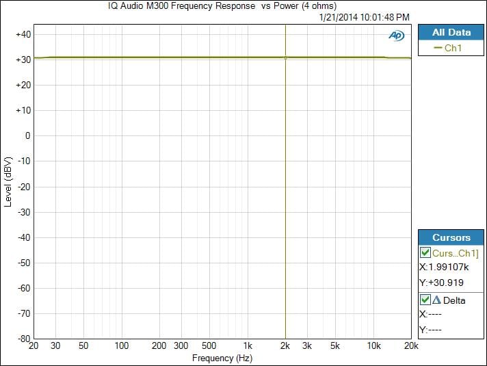

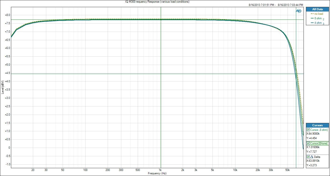

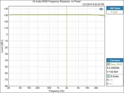

Frequency Response
IQ Audio M300 Frequency Response under various load conditions
The ruler flat frequency response (-3dB at 60kHz and -1dB at 10Hz) of the M300 was yet another surprise to me. We’ve measured a few Class D amplifiers in the past and they’ve almost always been optimized for a particular load impedance. The Axiom Audio A1400-8 Class D amp for example would oscillate unloaded and vary its high frequency response dramatically based on the load it was driving. This wasn’t the case with the M300. The frequency response did NOT change whether the amp was measured open circuit, or via an 8 ohm and even 4 ohm load. In fact the deviation was measured to be a mere +-0.094dB from no load to load. Also the response didn’t brickwall above 20kHz either. This was a clear indication that the engineers who designed this amplifier executed the post filter feedback circuit with sheer brilliance.

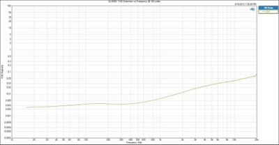

IQ Audio M300 Full Power Bandwidth Continuous Sweep (100 watts, 8 ohms)

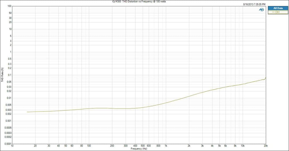

IQ Audio M300 Full Power Bandwidth Distortion Sweep (100 watts, 8 ohms)
The IQ Audio M300 exhibited excellent bandwidth linearity even at high output levels; in this case 100 watts continuous. Distortion did rise with frequency but it was still below 0.1% at 20kHz.
IQ Audio M300 Full Power Bandwidth Continuous Sweep (307 watts, 4 ohms)
The M300 delivered a whopping 307 watts continuously from 20Hz to 20kHz. Now that is big power from a Mighty Mouse sized amplifier.

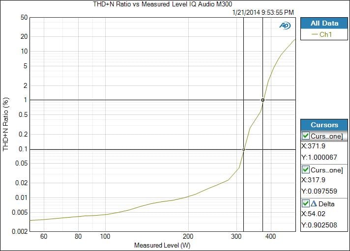

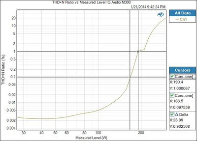

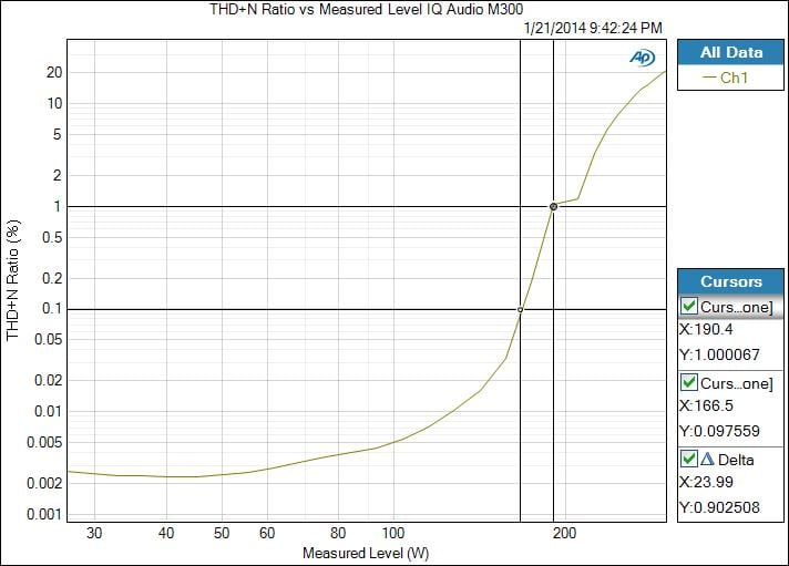

Audio M300 1kHz Power Test
Top Pic: 8
ohm load; Bottom Pic: 4 ohm load

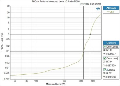

The M300 produced great results with our 1kHz power sweep test. Into 8 ohms, I measured 190 watts (1% THD + N) and 166 watts (0.1% THD + N), respectively. At 4 ohms, I measured a whopping 371 watts (1% THD+N) and 317 watts (0.1% THD+N).

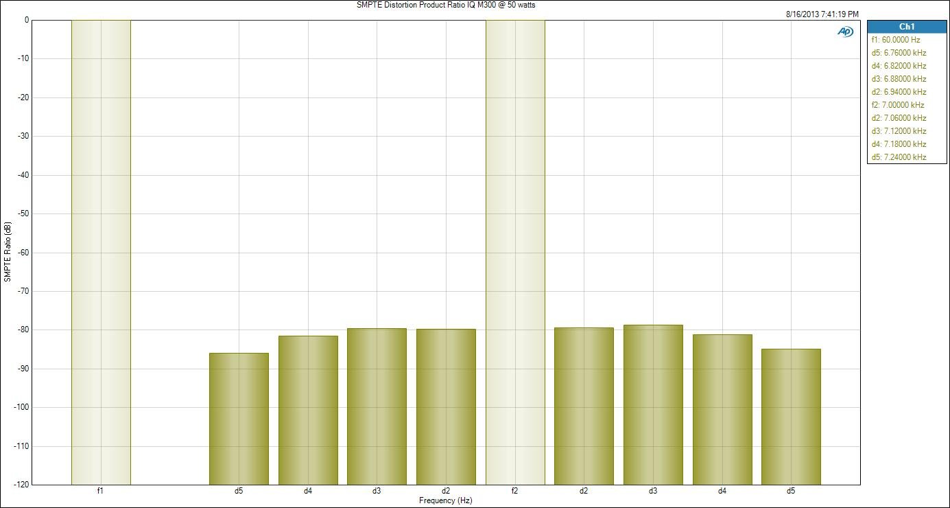

We used the SMPTE IMD multi-tone distortion tests to see how the M300 amplifier reacts to non-harmonically related signals. This is important since these artifacts can make music sound harsh or fatiguing. The test signal consists of a 60Hz and 7kHz test signal summed together at a 4:1 amplitude ratio. 60Hz is an important frequency to show how well the power supply can reject residual noise coming from the AC line. 7kHz represents about the midband point of the human audio range and it's also a region where a lot of harmonic content is present in music.
IQ Audio M300 SMPTE IMD Distortion Test; 8 ohms
The harmonic residuals were well below the fundamental indicating good power supply noise immunity.

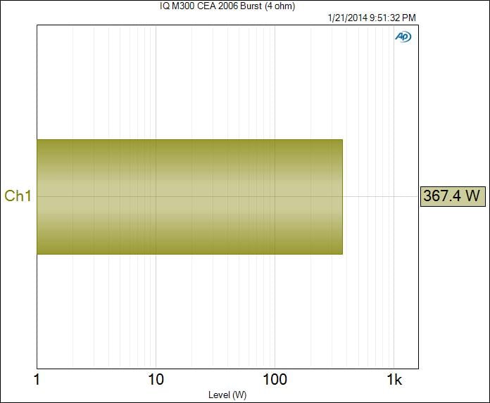

IQ Audio M300 Dynamic Power Test (1kHz); 4 ohm load
The CEA-2006 burst tests simulate musical program material. The M300 produced some fine results for such a diminutive-sized amplifier. At 8 ohms, it was able to deliver 195 watts at 1% THD + N. Into 4 ohms, it belted out 367 watts at 1% THD + N.

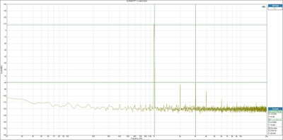

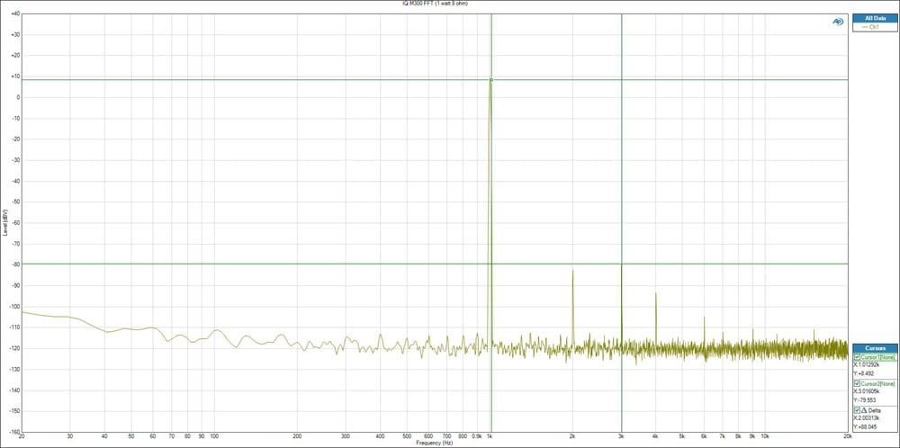

FFT Distortion Analysis
IQ Audio M300 FFT Distortion Analysis; 1 watt, 8 ohms
I ran FFT distortion plot at 1 watt which overall looked fairly clean. The 3rd order component was dominant, but still almost 90dB below the fundamental. The M300 didn’t look so clean once the power level was driven up but that is to be expected of a Class D design, especially one using an SMPS power supply. A precondition filter on the test gear is necessary for more accurate measurements in this case.

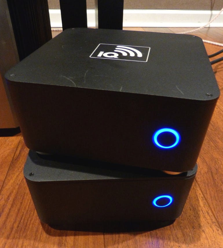

There is little not to like about a 300 watt amplifier I can literally hold in my palm of my hand. However at $1500/pair, this gets you into a dangerously competitive price class of some seriously good two-channel amplifiers from the likes of Emotiva and Outlaw Audio. If you need more power, and have the space for a much larger box, then the alternatives may better suit your needs. However, if you want truly impressive performance from the smallest and most efficient package I’ve ever seen, the IQ Audio M300 has no equal.
IQ Audio M300 Stacked
I came into this review wanting to pick apart this little amp as nothing more than a gimmick. Instead I was pleasantly surprised. The IQ Audio M300 amplifier is the first Class D amplifier that I’d seriously consider for my own use. It offers better measurable performance than I’ve seen from the Axiom Audio Class D amp and the very popular ICE amplifier modules integrated into some AV receivers and standalone products. It generates little to no heat making it ideal for stacking multiple units or cramming into tight spaces.
Most importantly, the M300 sounds fabulous, never misbehaving or losing composure. It is a deceptively great little amplifier. I’d recommend this amplifier for small to medium sized speakers with reasonable sensitivity (>87 dB 2.83V/meter); not goliaths like my 2 ohm dipping $50k reference towers. The M300 should be able to fill a medium sized room with clean SPL without a hitch. I foresee the M300 fulfilling many applications splendidly like an office system, personal DJ system or to power speakers from an electric drum kit or digital piano. This is the only amplifier offering IQ Audio currently produces but I sincerely hope that changes. I’d love to see a multi-channel amp based on this design as well as a more powerful MonoBlock for power mongers like me.
