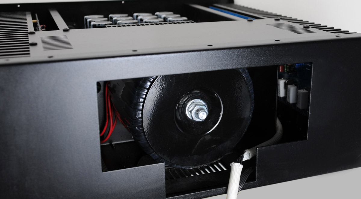

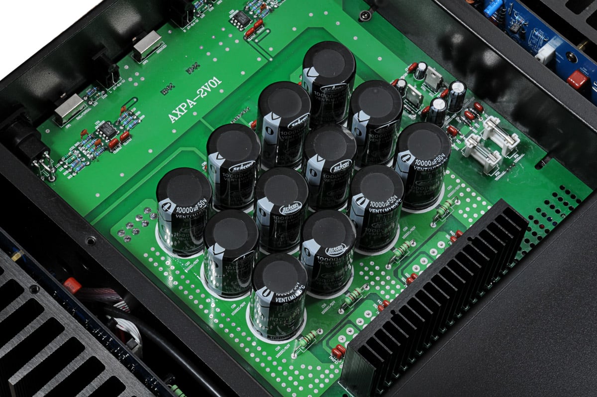

Enter the new XPA-2. This baby is armed to the teeth with electronic goodies, weighing in at around 75lbs and boasting a 1600VA transformer and over 60,000 uF of power supply capacitance. The prototype pics show 10,000uF 50V caps from their prior designs but these are just place holders. Since this amp has +-85V rails the production units will have 100V 105 deg C rated capacitors. According to Emotiva, the XPA-2 will deliver 250wpc into 8 ohms / 500wpc into 4 ohms with both channels driven and power hungry folks even have the ability to bridge the outputs to achieve a whopping 1000 watts. With such a large power supply, I suspect this amp is grossly underrated and can’t wait to test my suspicions soon.
The XPA-2 continues the Emotiva tradition of quality construction throughout with glass epoxy pc boards, 1% resistors, Metal film capacitors, soft start circuitry (does not have a current spike on start up), dual stage rectifiers and secondary capacitance. The XPA-2 is a compartmentalized design for greater isolation from noise. The transformer is mounted in its own super structure, and the XPA-2 sports auto rail detection relays and amplifiers are all fully shielded. The unit has switches for turning the metering and or the status LEDs on or off. This is a no holds barred design and according to Emotiva, every aspect of the amp was designed for superior performance.
