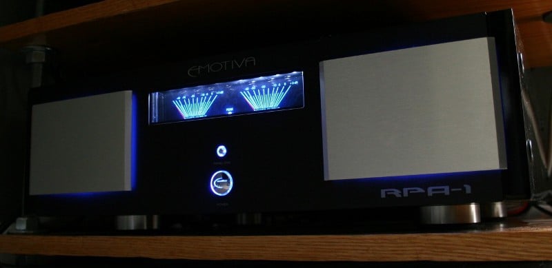

Build Quality
Topping 50 pounds, the RPA-1 is no lightweight in the amplifier world.
Emotiva suggests (and I concur) that you set the amp on the lowest shelf of
your rack. My homemade flexy
rack needed a little stability and the RPA-1 was the perfect fit. The piano
finished lacquered wood panel sides of the amp are simply gorgeous and contrast
nicely with the industrial front panel. Those of you in love with blue lights
and analogue voltage meters will have a lot to like about the front of the
RPA-1. Little blue needles jump as the amp pumps power to your speakers. They
are a little small to see from a distance but just the fact that they are there
is enough for some of us. If simplicity in design is a hallmark of an
audiophile product, the faceplate is a model for others to follow. Two buttons,
power and dimmer, run the centerline flanked on either side by two raised
milled aluminum plates with blue light seeping from underneath when powered up.
The light will turn red under a fault of clipping condition. Industrial
looking? Yes. But it looks mean. And I like that in an amp.

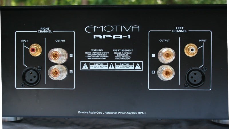

the supplied hardware. The back of the unit sports an RCA in, a XLR in, and
high quality five way binding posts for output to speakers. There is a 12 volt
trigger input, a master power switch, access to the fuse, and a voltage
selection switch. The unit can be configured ala the Turn On Selector switch
for manual power on/off, 12 volt trigger on/off, and signal on/off. When in the

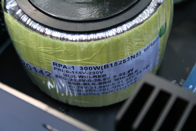

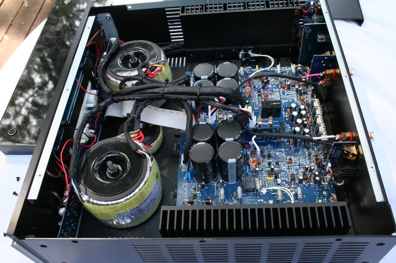

With a dual-mono design, each channel has its own massive toroidal power supply and electronics. In fact, if you could slice the amp down the center, you'd basically have to mono amplifiers. This design has its advantages in that each channel is fully isolated from each other yielding the absolute best channel to channel isolation for stereo separation. Stereo separation is an important aspect often overlooked in amplifier design. An amplifier with poor stereo separation will lend itself audibly as one that just doesn’t seem to make your speakers disappear into the room while instead sounding more like a wall of sound.
Just like all of the previous Emotiva amplifiers, the RPA-1 utilizes a Class H design which is similar to Class G and modulates the power supply rail voltage a bit higher than the output signal. It keeps the voltage across the transistors small and the output transistors cool. Overall, this provides for a cool running amp which explains how Emotiva Audio could cover up the side vents with the lacquered wood panels. The Class H is a fairly efficient design in comparison to an A/B design. The main difference of this amplifier compared to their flagship 7CH MPS-1 amplifier, is the former has about double the power supply for each channel of the latter. The transformer is much juicier allowing the amp to really belt out power into low impedance loads as you will see from our measurements later in this review.

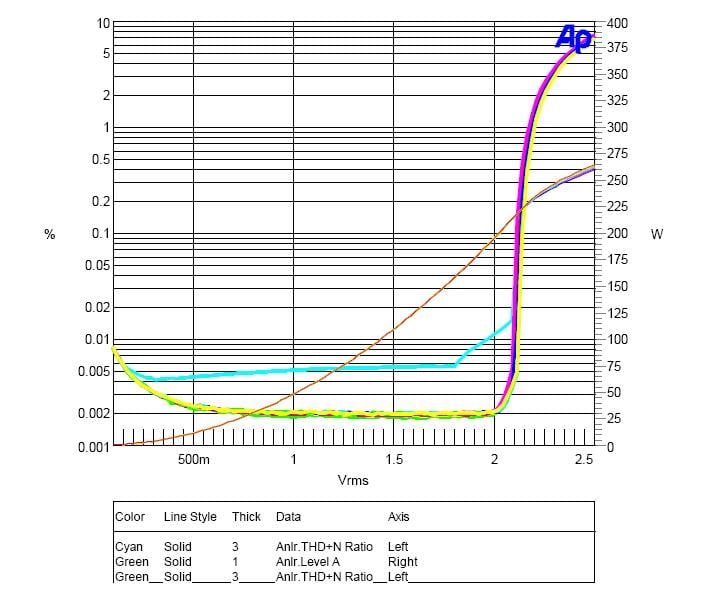

I asked Emotiva to furnish their power measurements vs. distortion to see if their ratings jived with my findings and they did.
Emotiva Power Measurements
Figure 1. RPA Power vs. Distortion
As you can see, the true continuous power rating of this amplifier (Audioholics style at least) is in excess of 200 wpc into 8-ohms.

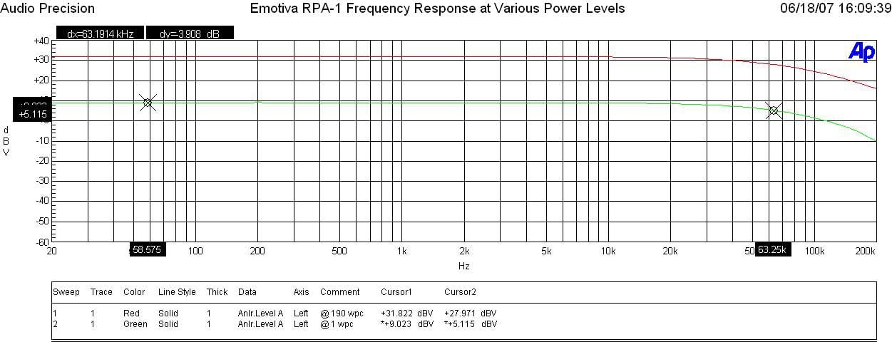

Frequency Response
Figure 2. RPA-1 Frequency Response
The frequency response was smooth and extended to a -3dB point of 65KHz which is more than enough bandwidth, but a bit puzzling since all of the other Emotiva amps we reviewed had about double the bandwidth. In any event, bandwidth uniformity was excellent at low or high power indicating that this roll off was intentional to ensure the best SNR performance.

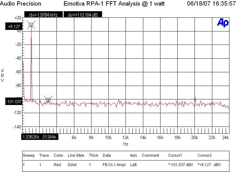

FFT Distortion Analysis
Figure 3. FFT Distortion Analysis
at One Watt
At 1 watt, the RPA-1 FFT distortion test resulted in nearly immeasurable harmonics, a scenario I rarely run into. This amp is super clean at low power which in my book is one of the most important virtues of quality amplification for a controlled listening space concerned with high fidelity playback.

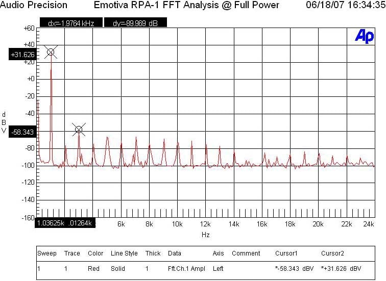

Figure 4. FFT Distortion Analysis at Full Power
At near full rated power (200wpc) into 8-ohms, the RPA-1 exhibited impressively low distortion (31.6+58.3)dBv = 89.9dBv or 100*alog^-1(-89.9/20) = 0.003%. This figure is even lower than what I measured on the MPS-1 (.008%) under similar load conditions. I suspect the removal of the soft clipping circuit has paid dividends in this regard (lower noise floor, lower distortion).
As many amps approach their full power rating, their power supplies tend to run out of gas and show large harmonic nasties of the fundamental test tone. The RPA-1 maintained its composure commendably demonstrating perhaps why it also sounded so good.

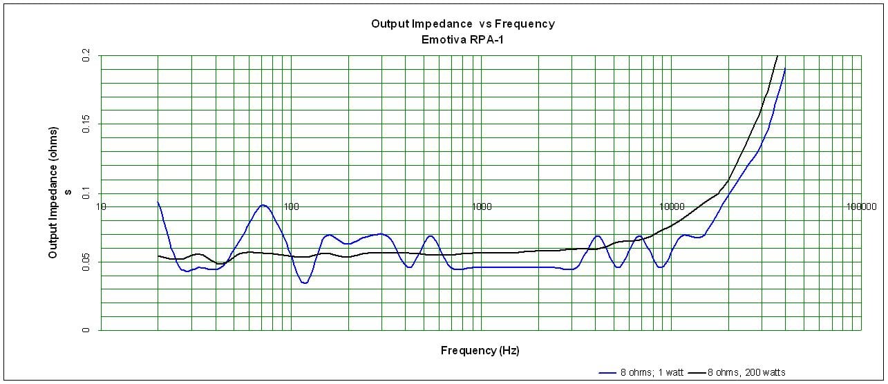

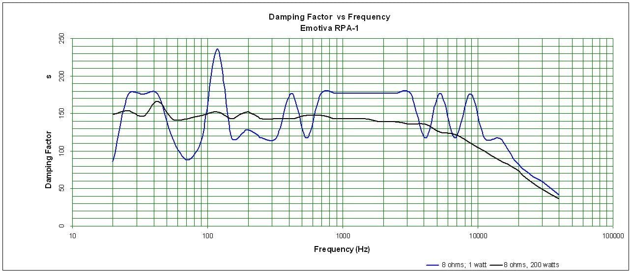

Output Impedance and Damping Factor
Figure 5. Amplifier Output Impedance
vs Frequency
Amplifier output impedance when the RPA-1 was driving an 8-ohm load at 1 watt and full rated power 200wpc was well below 100 mohm for the entire audio bandwidth with a gradual rise above 20kHz. We like to see amplifier maintain 150 mohm output impedance or less so that it will sound consistently good for a larger variety of speaker and cable loads with rather complex impedance profiles. This is a very good measurement and one of the primary design attributes that will ensure this amplifier will sound consistently good on a wide variety of speakers.
Figure 6. Amplifier Damping Factor vs Frequency
Again the RPA-1 did NOT disappoint. An amplifier with a low output impedance will also maintain excellent damping characteristics since these are related metrics. The RPA-1 maintained a damping factor of around > 150 for 8 ohm loads. This exceeded our benchmark criteria with flying colors.
