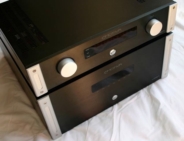

The look of this combo can only be described as clean, powerful - and yes, simple. Both pieces feature a black solid milled aluminum faceplate with brushed silver trim panels. The LMC-1 has two large brushed silver knobs, a blue vacuum fluorescent display, and a single round on/off soft touch power switch centered under the display.
The LPA-1 has a front panel array of LED's that indicate the
condition of the amp, and also a single round on/off soft touch power switch
centered under the display. This simple array of displays and lighting is
wicked-cool. The power buttons on both units glow a soft orange when turned off
(standby), then turn blue (matching the display) when turned on. There are seven
LED's in the array that represent each amplifier. When you power on, each lamp
lights up red in sequence until all seven have blinked, then all seven shift to
a solid blue. While this is undeniably cool, it also serves a practical
purpose, letting you know that everything is working as it should. If any of
the lights should flash red, you have a fault condition. (This happened to me
the first time I powered up, but a restart fixed the problem, and it has not
happened since.)

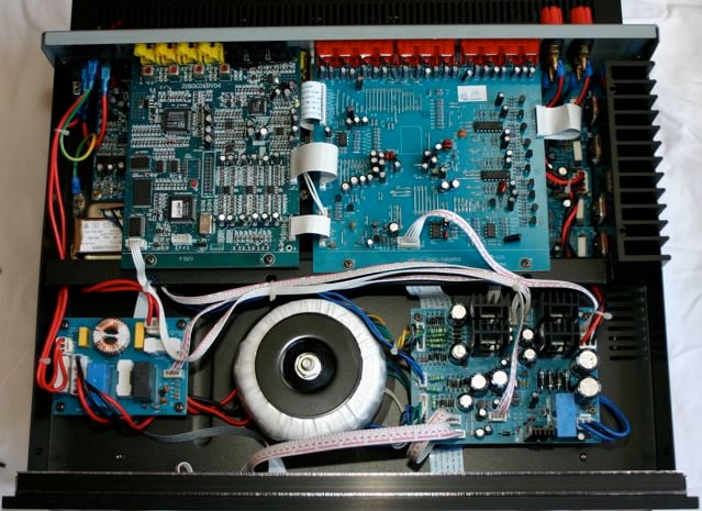

The LMC-1 has many audiophile-grade features, including four
(Toshiba) output devices per channel (two up and two down), a Toroid mains
transformer rated for 800VA, 0.5dB resolution on volume and all channel level
adjustments, multiple frequency bass management (60-150Hz selectable) for all
full range channels, 24-bit/192kHz digital processing, gold plated input and
output connectors, automatic video format transcoder that up-converts composite
and s-video source to 480i component, and an 8 channel analog input for
DVD-Audio and SACD formats.

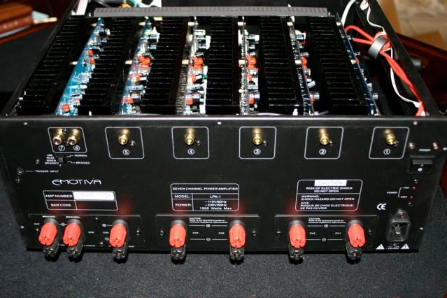

The LPA-1 has discrete, dual differential class AB topology with active current sources. The power supply's capacitors have a total rating of 73,600uf. There are six 125 watt channels - one of the channels can be configured for two channel operation. The power output can be configured as 125 watts/8 ohms x 6 channels, or 125 watts/8 ohms x 5 channels plus 2 x 50 watts/8 ohms x 2 channels. (These ratings are all channels driven @ 1Khz, 120VAC/60HZ supply.)

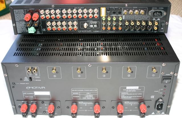

The LPA-1's rear panel has 7 RCA audio inputs. Channels 6 and 7 can be used as a bridged output. There are also 7 pairs of very high quality 5 way binding posts for speaker connections. There is a standard IEC 3 prong power receptacle, and a 3.5mm remote turn on jack for use with the LMC-1's triggered output. There is also a large rocker-style main power switch.
The LMC-1's rear panel boasts 3 optical and 4 coaxial digital
source inputs, 3 component video inputs, 5 S-Video and composite video inputs,
and 7 analog audio source inputs. There is also a 7.1 channel analog input for
SACD or DVD-A sources, as well as the 7.1 channel analog outputs for your
external amplifiers and subwoofer. There are 2 composite video out jacks for
recording to VCR or other device. Like the LPA-1, there is a standard IEC 3
prong power receptacle and rocker-style master power switch. A remote amplifier
(3.5mm) trigger out jack and remote keypad control connection round out the
array of standard jacks.

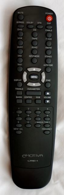

Remote Control
Let me start out by saying that I am a big fan of
universal remote controls. I strongly suggest to anyone who is asking me for
help choosing and purchasing a system that they budget for a solid universal
remote to control their entire system. With that being said, I don't expect
much from supplied remotes, because I end up not using them anyway. (But when
reviewing a product I actually use ONLY the supplied remote so I can tell you
what to expect.)
The supplied remote for the LMC-1 is a decent remote, and much like the system itself, it has no frills. It is not a learning remote, and can only control the LMC-1. There is nothing sexy or fancy here, only a clean, simple layout that includes everything you need. I love the dedicated buttons for "on the fly" trim adjustments to the sub and center channel levels. The left/right/up/down/center array of buttons was a bit frustrating to me at first - the center button is for "menu," and I kept hitting it when I wanted to "select." The right button is the "okay" button which was usually what I was looking for. The left button is "exit." Once I paid attention to this, it was not that big of a deal. My main complaint with the remote is the lack of backlighting, which is always a problem for me in my theater, which is very dark. But to be fair, with such aggressive low pricing on this combo, I can do without the added expense that backlighting the remote - or even a learning remote - would add.
