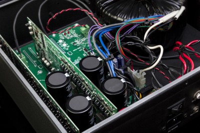

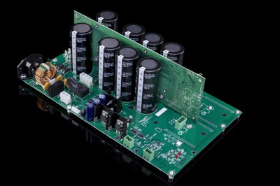

While that is an impressive list of features, I do have some critiques about the design. Firstly, in my opinion, the linear power supply is a mistake. There are real advantages to be sure, such as being capable of a more gradual clipping of their own output which prevents the amplifier from hitting a hard limit, but they are heavy and noisy. A large high-output regulated and low-ripple SMPS supply would, in my opinion, improve performance. It also would reduce weight, which I like! The MEGAschino’s WBT connectors are very high quality, but I would have liked to see Speakon, which are cheaper and more reliable connectors. The RCA to XLR adapter means that the single-ended preamp will need to be able to cleanly produce at least 4 volts for the amplifier to reach maximum output, but most AV receiver preamp outputs struggle to cleanly produce more than 2 volts. A single-ended to balanced conversion board in the amplifier would be better for those using single-ended sources.
The MEGAschino is a true fully balanced differential amplifier from input to output. It is essentially two amps for each channel, and one amp per phase. This means it really should be used in a fully balanced system.The manufacturer supplies an XLR to RCA adapter, but these should not be used. If a balanced connection cannot be used, note that the amp cannot be driven to full power from a 2-volt single-ended output, the limit of most receivers. You leave half the power on the table. Further, this particular method also has an increased chance of noise. It would have been better to use a single-ended to XLR cable that ties the ground and negative phase together at the RCA end.

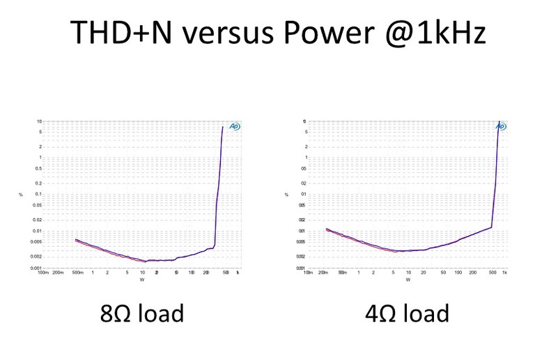

Measuring the Cherry MEGAschino amplifier turned out to be a tough proposition. In theory, the amplifier is capable of close to 1000 watts per channel into 4 ohms RMS and sustained output well past 600 watts. Yet it also produces distortion levels, at more reasonable power levels, that test the limit of my equipment. The combined need for low noise and distortion with very high power handling made testing difficult, as the gear I have just isn’t good for that. Add that it is a Class D amp and without the Class D measurement filter, distortion and noise rise as a result of the effects of ultrasonics feeding back into the audio band and potentially slewing the input opamps. I’ve included a factory measurement of the exact amplifier under review showing a sweep into both 4 and 8 ohms of THD+N. Since the max power that this produced exceeded my measurement limits at the time of this review, the factory measurements were confirmed at lower levels and included here for reference.
The main test rig consists of a Quantum Asylum QA401 & QA451 with external resistive load build using ARCOS LPR100 resistors. The test rig is really designed to test no more than around 175 watts into 8 ohms and 300 watts into 4 ohms, but with additional attenuation, can measure any power level necessary, with the negative side effect of increasing noise floor with added attenuation. As such, a decision was made to focus on the frequency response and noise distortion at set power levels within the linear limits of the testing apparatus. In addition, the manufacturer supplied and repeated tests of the same amplifier using their own Audio Precision based test system, which both validated my own measurements and allowed for more accurate measurements beyond the limits of my measurements.

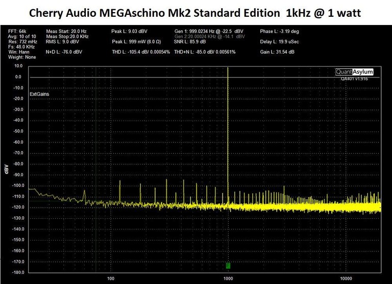

Cherry Audio MEGAschino Amplifier FFT @ 1 watt
First, looking at the 1 watt 1Khz FFT (64K with 10 averages), we see a few interesting properties. First, the basic noise floor is around -110 to -120dB with an overall noise plus distortion noise floor of -76 dBV. THD+N came in at .0056% (-86dBV) and THD came in at a much lower .0005% (-105.5 dBv). Why such a difference? Where is the noise coming from? Well, that became more obvious throughout all testing and shows that one of the upgrades for the Cherry amplifier is probably worth buying. Power supply noise was significant relative to the noise floor, with the highest being the harmonics between 120hz and 800hz, but actually extending well past 1khz. Still, at 1 watt the spurs all fell below -90dBV, so maybe I am being too critical. I didn’t hear any obvious hum in use, but I would have liked to see less power supply noise in the measurement. Moving onto the S/N at 1 watt into 8 ohms, we see it comes in at 85.9 dB. That is decent performance for such an amplifier, not the best in the business, but certainly better than you see with lots of lesser amplifiers. I believe this spec would improve substantially with the optional power supply upgrade which was not tested here.

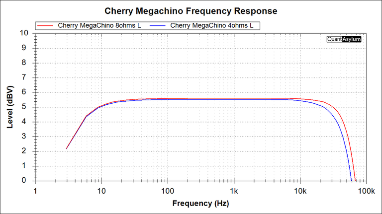

Cherry Audio MEGAschino Frequency Response - red (8 ohms); blue (4 ohms)
The frequency response of a Class-D amplifier varies with load, especially on lesser quality amps. This is a problem many of us thought we had long left in the past as we moved beyond Tube amplifiers, but with the advent of Class-D, their reactive nature brought back the problem, and in some cases, it can degrade the linearity of the amp so significantly that the change in response is very audible. As such, one of the most important measurements to perform on a Class D amplifier is a 4 and 8-ohm frequency response test. I did this and found the response did vary with the load but only slightly. With a reference level of 5.5 dBV at 1khz, the response is down -.5dBV at 10Hz for either 4 or 8 ohms, and this is very likely the LF response of my measurement system. Cherry claims a frequency response down to 0hz with no phase shift. On the other end of the spectrum, the 8-ohm load is down .5dBV at 30khz and 20Khz at 4 ohms. This was tested using an output filter, but the output filter has little effect on the response at these low frequencies. The measurement filter is 6th order with a corner frequency of -3dB at 65khz. In future reviews, I will be building test cables that will allow measurement of the frequency response without the filter, but that was not possible during this review. Since the response change is so substantial between 4 and 8 ohms, it suggests the difference is the amp, not the filter. Now, having called it substantial, let’s be clear, the substantial difference is at or above the limits of hearing, there is no meaningful attenuation measured between 20hz and 20khz, and as such, I will consider this amp to be well behaved.

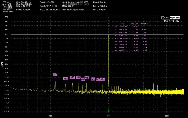

What about high power testing you ask? Well, as noted, I couldn’t test the amplifier at high power levels, so instead, I tested the amplifier at various power levels until I hit a point where I was certain I was overloading the input of the analyzer. Again, changes are being made to the test rig to allow higher margins, but for now, these are the best I can do. For high power testing, I switched to 4 ohms, as this gave greater margins. Distortion goes up into 4 ohms with this amp, as with most amplifiers, so consider that into 8 ohms, it will achieve at least half these power levels with measurably lower distortion (and Cherry’s own AP results confirm this). At 10 watts, THD+N is .0028% (-91dB) and THD is .0012% (-99dB). At 20 watts into 4 ohms, we see THD+N of .004% and THD of .002%. SNR at 10 watts was a good but not great 92.6 dB, again strongly impacted by power supply noise, with the 120hz power supply spur at -100dB. At 200 watts into 4 ohms, THD+N and THD both increased to around .007%. This means noise is no longer dominating the spec and THD starting to emerge as the dominant factor. At 270 watts distortion remains about the same, increasing to .008%. At the time of this test, the way the Q451 was setup also reflected the point at which the QA451’s own distortion rises to a similar level, and I lose confidence in any power results above this.
I did measure up to 350 watts where distortion remained below .05%, but this reflects more the rising non-linearity of the load than it does of the amplifier. Sadly, after putting together a high power test load with sufficient attenuation for full-power testing, I inadvertently unplugged and re-plugged a cable while live quickly destroying the amplifier. For those concerned that this is a sign that the Cherry protection is weak, keep in mind that what I did is something you should never do with any amplifier and would cause the failure of most amps. A very large 1khz test signal was going through the amplifier when the load was set up for a much lower power level than it would see. When replugging it, either the 1khz tone or, more likely, a huge 60hz signal suddenly burst through an amplifier capable of well over 1000 watts and instantly destroyed a sense resistor in the load. This led to a chain reaction that destroyed parts inside the QA451 which led to the destruction of the output transisters in the amplifier. All in a matter of milliseconds. I can’t fault the Cherry MEGAschino; this was all me. This is why I can’t have nice things.
I wasn’t able to take a lot more measurements but will note that rising power supply noise was noted as higher power measurements were taken. This increase is a clear sign of insufficient power supply capacitance, though at all times the power supply noise remained still modest. Many receivers would measure as bad or worse. My main concern is that this is not a receiver but a very expensive and high-end amplifier. I do wish this amplifier came standard with the capacitor upgrade.
Summary of Measurements
How do we sum up these measurements? Are they good? Great? State of the Art? Well, no I don’t think they are state-of-the-art with respect to the highest-performing amplifiers out there, but I do think they are very good. The amplifier frequency response changes far less than we see with most pro audio class D amplifiers, along with many past cheaper options. While I don’t have a graph to share here, I have measured ICEpower modules and found their highest power modules to have far greater changes in the response between 4 and 8 ohms. The noise floor of the amp was dominated by the power supply spurs and as such were not state of the art. I was concerned with this and asked Cherry to measure amplifiers they had to see if he could replicate the results. It became clear that better power supplies dramatically lowered the noise to the point that I think this could be a state of the art amplifier in terms of noise if the power supply were better. As an example, we saw the noise floor of the FFT to move from around -110dBV to -140dBV when moving from the basic power supply to a lab supply (Keep in mind, these lab supplies cost 10’s of thousands of dollars often). Distortion was very low out to very high power levels, and it seems clear this amplifier has more power than the new Purifi 1ET400A. So while its noise and distortion were not quite as good, it is also putting out a lot more power.
Further, can we really complain about distortion levels of .004% or less over most of the power range? Is this really audible? In fact, looking at the manufacturer’s own AP results at 1khz, we see that into 8 ohms the THD+N levels were mostly below .002% from 1 watt to over 100 watts with clipping becoming evident at 270 watts at .004% THD+N. Compared to the results of some of the best new amplifiers like the earlier mentioned Purifi module, I can’t call the Cherry amplifier state of the art. On the other hand, both power output and performance is still better than a lot of other amplifiers on the market. Further, the price of the MEGAschino is substantial enough that I can’t call it a bargain for such measured performance, but I think the price is justified for other reasons.

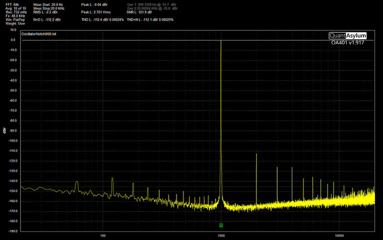

Cherry Audio Dac Dac FFT
One measurement I want to add is of the Dac Dac used in the review. This DAC was so clean that I had a hard time measuring it, so the only measurement I am including here is a 1khz FFT taken with my gear and a QA480 notch filter. This shows a device with a S/N ratio of in excess of 121dB (this is not A weighted, expect a few dB improvement if A weighted) and THD+N of -112dB. It is about as good as one can expect. I really found nothing to complain about with the Dac Dac from these measurements.
