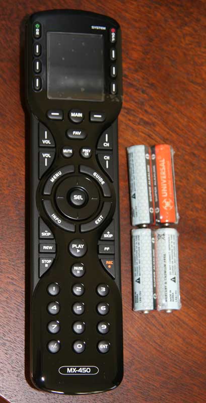

This Universal Remote comes in a plain, but sleek package. It could even be considered beautiful, especially when compared to most standard sized remotes. When you open this package you will find the remote, a small user's manual and the batteries needed to get the thing running. The build is no deviation from the norm, but nonetheless looks and feels better than most. The majority of the hard black plastic face of the remote is finished in a high gloss. This high gloss face forms a ridge down the center of the remote, as two curves on each side wave in, out, in and then out again. This forms an attractive double hour-glass look that adds to the look and the ease of familiarity with the remote. These four curve-ins are recessed a fraction of a millimeter and are further offset with a matte finish and reserve a special place for the volume, channel, and six other key buttons. All of the buttons pop just a little, as they are glossy, but a shade lighter than most of the face.
As I held the MX-450 the first thing I noticed was the weight. It is substantial – bordering on too heavy, but definitely better than some remotes that get knocked off of the arm of the recliner with the slightest breeze. Along with this substantial weight is a solid build. Nothing about it is loose or flimsy, everything is compacted together and there isn't much gap between face and body mount, button and face, or LCD screen and face.
The full color LCD is great, especially given its utility in the programming mode. Like most remotes with an LCD screen, the screen times out after 10 seconds of no use. This feature is adjustable from 5 seconds to 60 seconds, but we wouldn't recommend more than 20 to maintain a decent battery life. This brings us to one downside of the MX-450, the lack of a recharging/docking feature. While with the short time-out of 10 seconds we observed great battery life, that 10 second time-out was just too short to get us through the reading of the info menu on any given show. Maybe we're slow readers. Of course you just hit any button to bring it back up, but which one? Mute and unmute? It just was bothersome.

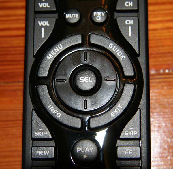

The buttons used most are within a thumb's reach of the standard holding position: Select, Up, Down, L, R, Play, Pause, Volume + and -. This can only be expected. But as with most traditional layout remotes, we still found ourselves stretching to span that great distance between the standard holding position and the A button on at the top left of the LCD screen to cofirm the deletion of last week's episode of The Office after we'd watched it five times. Your setup will vary of course, but a small bit of agravation awaits the user of those top buttons, no mattter what they are assigned to. Which brings up the point that we could have assigned the A button of our DVR to a button closer to our lazy thumb. That is the beauty of this remote, you could do that reassigning on the go, no laptop – but we'll get to that in a second.

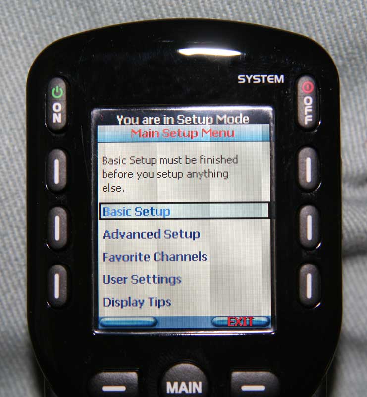

Remember when you got your first TI-82 calculator, and you programmed it to do your math homework for you? Well, programming the MX-450 is a little easier, in full color, and of course the result is better than getting your homework done. By holding down the Main button for 5 seconds, you enter into the remote's on board programming mode. Not only do you enter into the programming mode, but the programming mode for dummies. An instructive tip screen appears, telling you to use the cursor up or down buttons to move through a list. Hit the next button and you get another tip, this time cautioning you that the buttons at the bottom of the screen change meaning from screen to screen. OK, now that we're past those two screens (which we can and will turn off via the main menu) we get to the good stuff. The third screen in to our programming mode, our main menu looks like this:
- Basic Setup
- Advanced Setup
- Favorite Channels
- User Settings
- Display Tips
Basic Setup

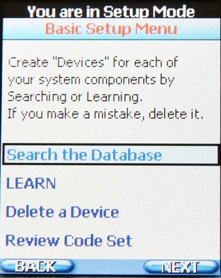

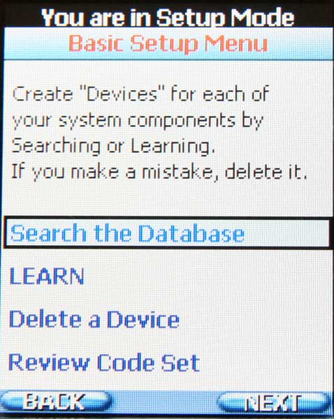

Begin with the end in mind, right? This is where we can execute the following options: Search the Database, LEARN, Delete a Device, and Review Code Set.
Advanced Setup

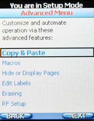

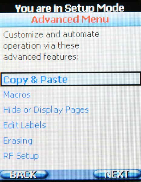

Once all of your devices have been selected from the database or learned, this is where we find the Copy & Paste, Macros, Hide or Display Pages, Edit Labels, Erasing and RF Setup features.
Favorite Channels
Here you can add up to 48 favorite channels, with about 50 high quality stock channel logos and 8 make-your-own templates to choose from.
User Settings
Here you can adjust the brightness of the LCD screen, adjust the Auto Turn Off from 5 to 60 seconds, do the same for the button lighting, check out the battery life and system memory usage and perform a factory reset.
Tech Note: Display Tips
A favorite, discovered way too late. This turns off all of the helpful, and after a while annoying, tip screens.

move on to the PC-free programming. Upon
selecting "Search the Database" from the Basic Setup Menu, you are
asked to choose the icon position on Page 1 of your main menu. You can either choose new position or an
existing icon (if reprogramming an old icon to a new device). Once you choose the position, you then choose
the type of device you are adding (TV, CABLE, SAT DVD, AUDIO, AUX, etc.). Each device type has a stock icon already
attached, with a few having slight variations to choose from, i.e. a flat panel
TV or what looks like an old school rear projection model. Once you decide from the limited 30 icons,
you lock in the name of the device. If
you're used to texting with a traditional cell phone, you'll fly through
this. If not, type slowly. HINT:
Pushing the cursor button (Circular button around the SEL button) to the
right will create a "space". I
spent 10 minutes trying to figure out where the spacebar was.
Once you've got a name you like and hit Next, there is a "most popular" listing of the most common brand/device manufacturers in that category. The TV set up had a top ten and then about 200 other manufacturers in alphabetic order. Upon choosing a brand, you are presented with a test screen where you are instructed to manually power on the device that you are programming. You then hit test, if you get no results then use the cursor button to scroll through the options within that brand and the remote sends the test signal with each new screen. As soon as the device powers off, you've hit a potential winner and you select the TEST button. This moves you to a screen where you are instructed to test the power, volume up, channel up and number one buttons. This did well for 3 out of 5 devices, but for the Sony Receiver and Scientific Atlanta HD-DVR in our test group, a couple of codes passed that test but were not correct for those units. This entailed taking just a little more testing and time to find the correct code.

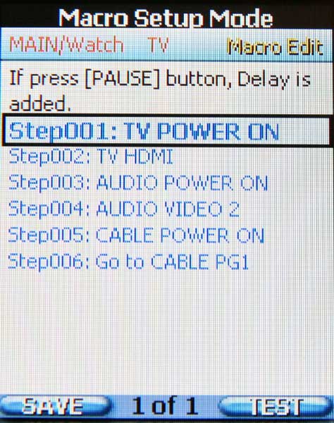

The Macro Setup Mode is easily reached via the Advanced Setup Menu. Once here you'll find an intuitive process, minus the bells and whistles your PC might bring to the setup process. After you have entered the Macro Setup Mode, actions are recorded as you take them, so you go to the Main menu, scroll to the page containing the desired device, select it, and choose the command you want recorded, i.e. once in the TV device menu, press the power ON button to record this command. Editing options include moving a command, adding a command, and adding a delay of .5 to 60 seconds.
RF setup is also super easy, starting at the Advanced Setup, RF Setup is selected and the next screen gives a choice of either All Devices Set Same or Each Device Differs. For our purposes, equipment was all located in a closet and an MRF-260 RF base station was used to receive RF from the MX-450 and transmit IR signals to all of the necessary devices.

Strike two may be an anomaly to this particular remote. In this review we've talked of the "cursor button", the circular button that surrounds the SEL (Select) button at the center of the remote. Go left, go right, or go down and your fine. Going up is the problem. The first month of the review, when I would push up on the cursor and more than half of the time I would get this incredibly annoying SQUEAK! Scrolling through any given evening's offerings, going up through the menu, sounded like this: squeak, squeak, sque, sque, sque, sque, sque, squeak... you get the idea. I thought maybe it needed breaking in. The sound has intermittently persisted, sometimes on and sometimes off. I know, I know – I must have a fat thumb.
