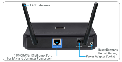

Wireless Bridge With Optional Switch
If you already have a wireless router and strong wireless signal in the area your equipment is located, then all you need to do is add a bridge. You might find people refer to these as wireless access points (WAP), but a WAP does the opposite of a bridge. A WAP allows wireless devices to connect to a wired network. An example of this is a wireless router. A bridge allows a hardwired device to connect to a wireless network.
A bridge is a device somewhere between the size of a flashdrive and a router. Typically, they only have two jacks, power and Ethernet. Setting up a bridge is fairly straight forward, but I highly recommend reading the instruction manual because each device can vary. Set up usually consists of two basic steps:
Wireless Bridge Rear View
Rear View of Wireless Bridge
Step 1) Connect bridge to wireless network - If your bridge and router are compatible with what's called WPS, then you can just press the WPS button on both devices and the bridge will connect to your wireless network automatically (hopefully, anyways). If not, then you will want to connect the bridge to a computer (preferably one that is currently on the wireless network) using a CAT5 or CAT6 cable. The ends of these cables look like wide phone cords. At this point, you will need to refer to the instruction manual. Most of the time you will open up and web browser and type in the IP address of the bridge (found in the manual). However, some modern bridges automatically take you to the setup page when you open your browser.
Step 2) Connect bridge to AV equipment -   Once the bridge is connected to the wireless network, you simply need to connect a CAT5 or CAT6 cable from the Ethernet jack on the bridge to the Ethernet jack on your AV equipment. There is no special setup to perform on most AV equipment. If you want to connect more than one piece of gear to the internet, using the bridge, then you will need a switch. In its simplest form, you can think of a switch as a splitter (please, no hate mail for calling it a simple splitter) that takes one Ethernet cable and splits it out to more connections, usually 4 or more. Below is an image of Belkin 5-port switch. One of the ports is used to connect the switch to the bridge, leaving 4 open ports for connecting other devices. A switch is only needed if you want to connect more than one device using the bridge. If your bridge has multiple Ethernet jacks, that means a switch is already built-in.

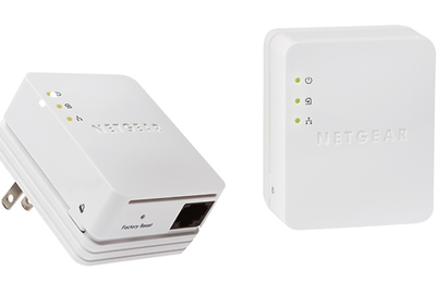

2) Ethernet Over Powerline Kit
Okay, this isn't technically wireless, but sometimes it's difficult to get a strong wireless signal into certain areas of a home, in such cases, an Ethernet over powerline kit can be used. These kits utilize the existing electrical wire in your homes to extend the network. They usually come with two wall-wort style adapters, and unlike wireless bridges, there is virtually zero setup involved. One of the adapters is located where your router is at. It plugs into the wall for power and connects to the router via a CAT5 or CAT6 cable. The other adapter is located by your AV equipment. Again, it connects to power and then to your equipment using a CAT5 or CAT6 cable. If you want to hook up more than one device, you can either purchase a powerline kit with a built-in switch, or add one yourself.
Netgear Powerline kit 1
Ethernet Over Power Line Kit With Switch
There you have, two quick and easy methods to get your equipment connected to the internet. A wireless bridge works well if you have a strong wireless network. Otherwise, powerline kits are also very fast and reliable, but can have troubles working in larger homes. Both devices come in a variety of form factors from numerous companies, and can be purchased at most big box retailers or online. Expect to spend between $50 and $100 dollars.
