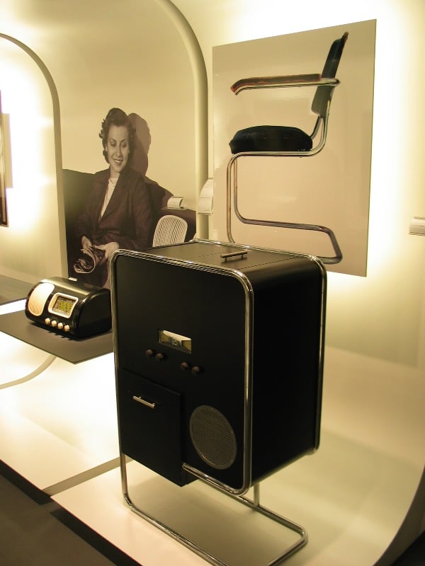

The Hyperbo 5RG Steel was based on a simple chrome frame chair with black leather stretched across it (they even had a picture of the chair above the display unit). The Hyperbo 5RG Steel is truly the precursor to the modern "all in one" unit incorporating a radio, loudspeaker, and record player. It even had a storage shelf for your records. As I was soon to learn, Bang & Olufsen is even now striving along the same lines.

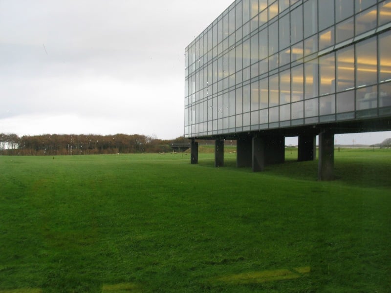

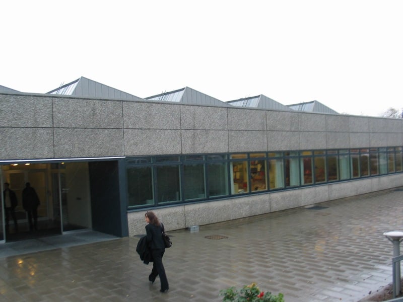

[DevelopmentBuilding] Day 2
This is what I personally was waiting for. I had many preconceived notions of Bang & Olufsen (not all of them very flattering) and I wanted to get at the heart of the matter. At the end of day one, we were taken to dinner with a number of the acoustics employees and I had the good fortune (though I didn't realize it at the time) to sit near Geoff Martin. Geoff, I later found out, has the interesting title - Tonmeister (I'm not sure how Ton Loc feels about this). Apparently, at B&O, he is one of THE acoustic guys. He recently moved over from designing the sound system in the Audi A8 to the Acoustics Department where he is involved with developing DSPs and running listening tests. The latter is where I found myself at the beginning of Day 2

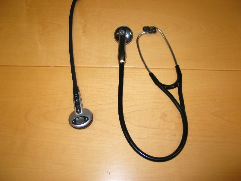

3M Littmann Electronic Stethoscope
[Scope] Imagine my surprise when I saw a stethoscope on display. For the first time, I saw a product that wasn't branded by the iconic B&O logo. The 3M Littmann Electronic Stethoscope has the ability to reduce background noise, uses a DSP to focus solely on lung or heart noise (to the exclusion of the others), and can even take your heart rate. Apparently the stethoscope is sold pretty widely in the United States though I can't say I've ever noticed a doctor using one. Of course, I can't say I've looked all that closely either. The next time I visit the pediatrician, I'll ask about them.

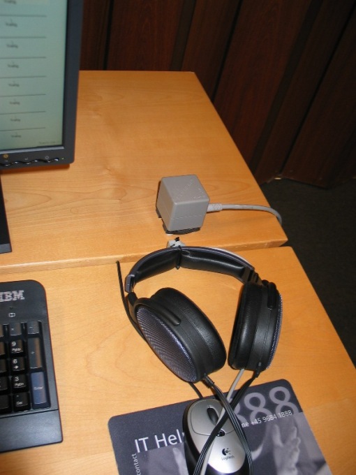

3D Headset
[Headphones] Back at CEDIA, Yamaha was demoing the YSV-1 Multi Channel Headphone Preamp
that simulated the surround sound of your home theater. Bang & Olufsen demoed a similar technology except it was designed to simulate automotive listening environments. The idea is to use this technology to ensure that the sound system in the Audi A8 can be replicated in other vehicles. While it shares the same basic idea with the Yamaha YSV-1, it utilizes a magnetic sensing system rather than IR. In the Yamaha demo, you had to be standing in a specific spot. With this, you could move the headphones anywhere and it would work. On the computer screen, you could see the model head moving in 3 dimensions though the sound would only change on the horizontal plane. They can also use the system to record actual road noise (not simulated) using a dummy head (not pictured) to make the recording. Basically, they can use this system to do blind listening tests for automotive systems (much like the curtain would be used in the listening rooms)
