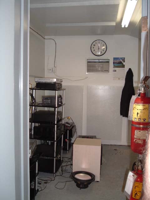

- Air Leak Test: test at resonance of cabinet, at high SPL to ensure no air gaps confirmed audibly, max volume before meltdown.
- Buzz test done at high frequency (checking for nonlinearities of drivers) for product as whole.
- Endurance test done to every model once per month on each product (not shipped to customer) Max SPL tests for 100 hours. It has been rumored that Black Sabbath's Ironman could be heard from across the US-Canadian border while these tests are running.

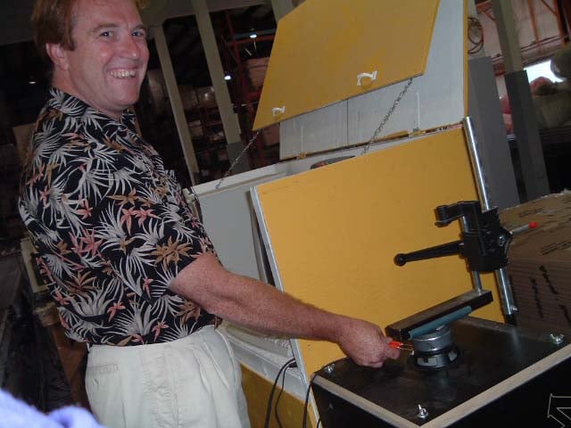

Ian conducting a driver test using a small acoustically inert sound chamber and LMS measuring system.

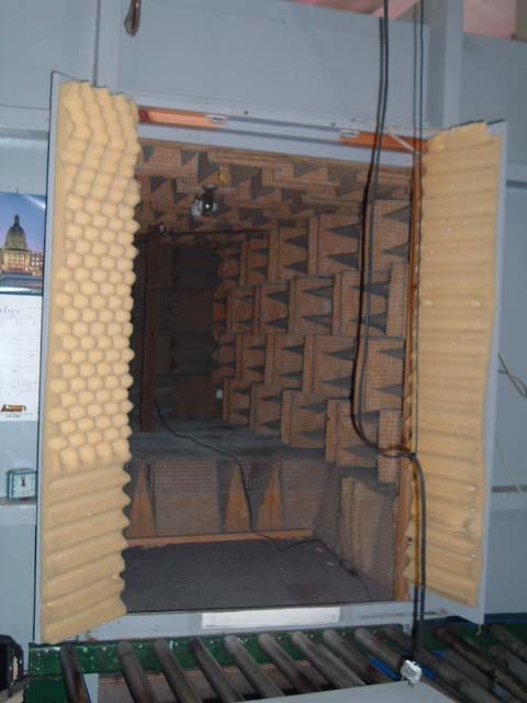

Axiom's mini Anechoic chamber for measuring final product.

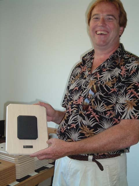

Axiom cabinets start off as a single sheet of MDF and are precisely machined with all the driver cutouts and linear and cross grooves to miterfold it into a self contained cabinet. All of the cabinets and crossovers are built in-house and the crossover circuit boards are done in Toronto . |
Some M22ti's waiting to be stuffed with insulation and drivers. |

manufacturing. In addition to their mini anechoic environment for testing
production speakers, they are working on building a full sized version and
