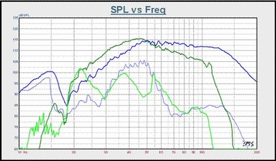

Anechoic chambers are also a superb resource where it comes to measuring various forms of distortion. The effects of a room's acoustical character coupled with an often less-than-desirable noise floor can all too easily conspire to produce inaccurate distortion measurements. Those same measurements, done in a reflection-free environment, using properly calibrated mics against the comparatively low noise floor typically exhibited by an anechoic chamber expectedly produce superior results.
Pictured above is an example of an ordinary Max dB spl & THD+N measurement comparing two manufacturer's products, selected at random for the occasion. The dark blue & green curves are, of course, the max dB spl amplitude response plots. The light blue & green curves are the THD+N curves.
The THD+N test was used as an example as it was easy to set up. However, its usefulness in practice is limited. Can you tell which sub sounded more distorted? One sub had a cabinet leak that was quite easy to hear when the sub was run in an anechoic chamber, but under ordinary listening conditions was inaudible. Can you tell which had the leak? Here's a hint, it's NOT the product with the higher measured distortion profile. There exist other better focused approaches to distortion measurements than are traditionally used in the industry and an Audioholics technical article focused on this topic is now a work in progress. Stay Tuned!
