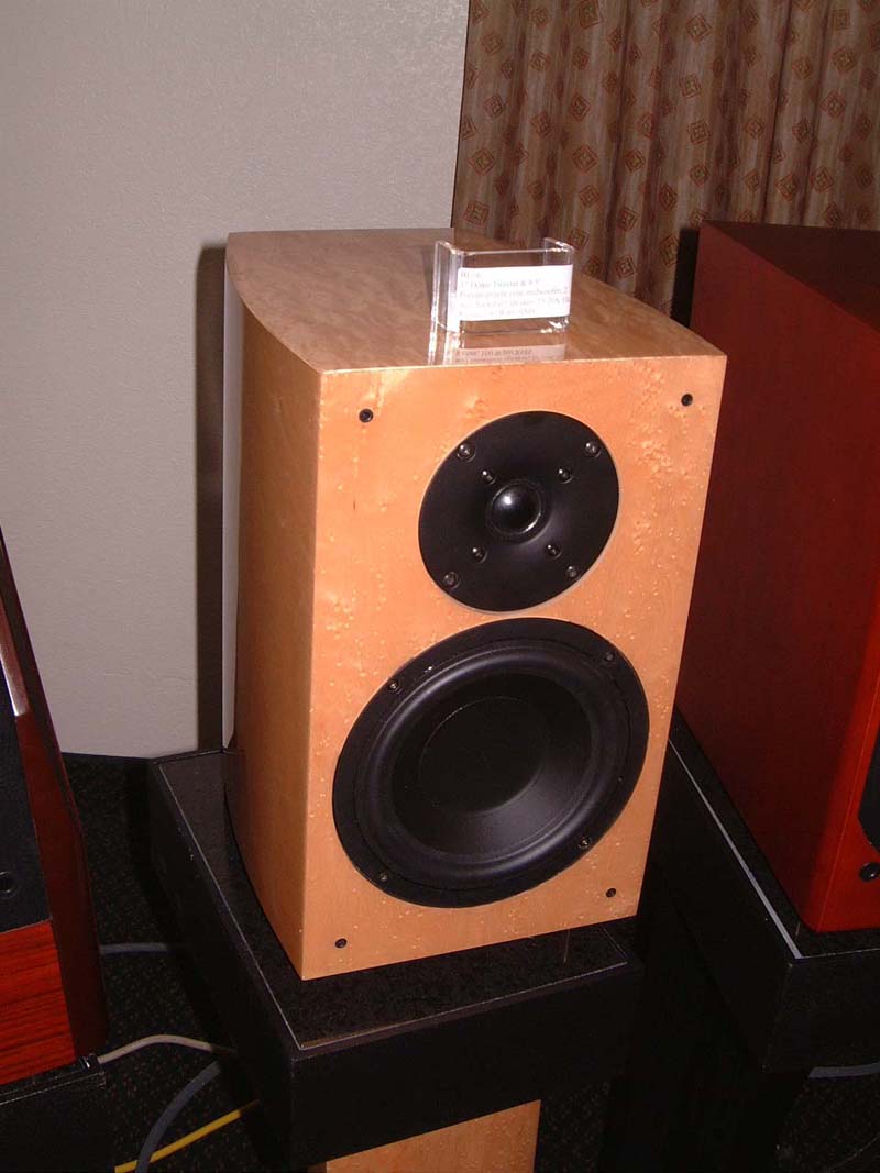

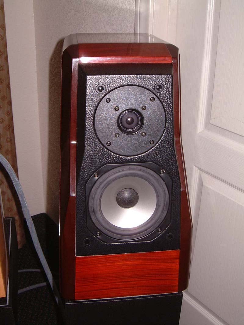

Fast forward now to January 8th, day 3 of CES a t the St. Tropez. This site of "The Show" is a spin-off event which piggy-backs on CES at much lower cost to the exhibitors. Hey, nothing wrong with that. Especially if you can keep your product costs down. Unisound is in a room a cross the rainy courtyard of the St.Tropez and its late afternoon. Almost no showgoers means I've got the Unisound suite to myself.
I sit down to listen to the rev a mped SP18Be (or whatever Michael decides he wants to call it) and the completely new BE16 6.5" two-way. A revelation. Both of these speakers, with their redesigned crossovers, sound terrific on first listen. Smooth, refined and with very good octave-to-octave spectral balance. The Unisounds are ready for a formal Audioholics review. Pricing of the two models is remarkable for the quality of drivers used, their finish and construction. The SP18Be 5.25" two-ways are $1000/pair and the BE16 6.5" two-ways are $1500/pair. Note that viewed up close the veneer finishes on these speakers is even more stunning than the photographs.
