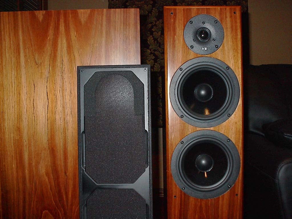

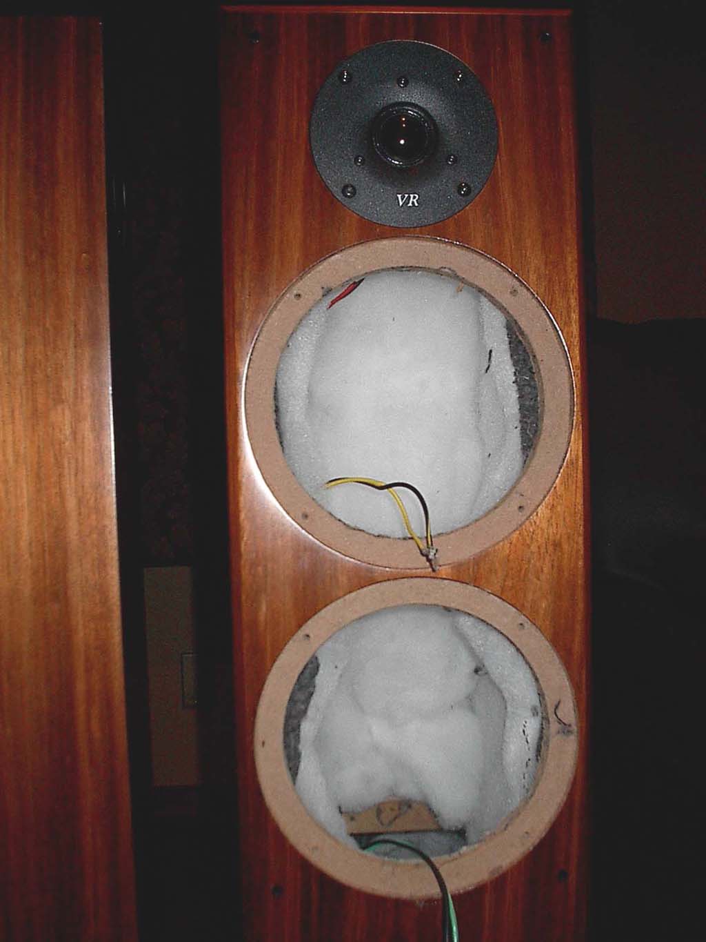

VR2insidecompressedAt first look the VR-2's appear to be put together quite well. The front baffle was narrow which minimized diffraction. The tweeter was near the top of the cabinet at ear height and the midrange and bass drivers outer flange was right near the edge of the cabinet. This design should allow for excellent sound stage and imaging. Also note that the woofer was above the mid-point of the cabinet which helped avoid resonance's of the cabinet itself. After removing the midrange and bass driver I found several more good design practices implemented by Von Schweikert Audio for example, the interior walls all had damping material. There was also ample shelf type bracing in two different directions which stiffened the cabinet. I felt around inside and found that the crossover was placed on the bottom to minimize magnetic flux from the drivers interfering with the crossover circuitry.
Acoustic Paneling
One thing to notice from the picture is the white acoustical stuffing around all the drivers which was used to slow down the speed of sound. This technique made the cabinet appear larger to the driver effectively giving a better bass response. At first I thought that the designers at Von Schweikert Audio completely stuffed the box which would have been a bad design practice because the space between the woofer and the port should be left clear. Apparently some of the stuffing had fallen and blocked the port, so I pushed it back up and the space was then cleared. While I was feeling around inside the cabinet I found some surprising things. For example, there was no separate chamber for the midrange driver. Although from the outside of the cabinet it looked like two identical woofers they were not. In the picture notice the woofer on the left with a larger magnet and the midrange on the right with the vented pole piece, i.e. the hole in the magnet. VR2mid-woofcompressedcompressed-small
I have never seen a design quite like this before. This type of design allowed low frequencies of the woofer to impinge on the midrange cone and the midrange frequencies to impinge on the woofer cone. This inteference is typically controlled by having separate chambers for each driver. Dome tweeters are typically sealed so they are not affected by this effect, as was the case with the VR-2's. But the woofer and midrange in this design were not the same driver or frequencies. Mr. Von Schweikert offered reasoning being their unique approach to minimizing performance issues which could result from interference and it can be read in its entirety in the addendum of this review.

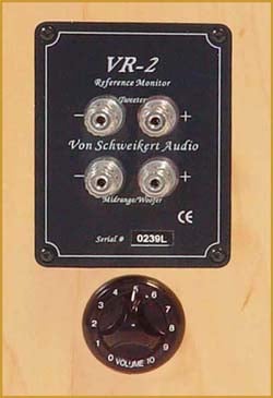

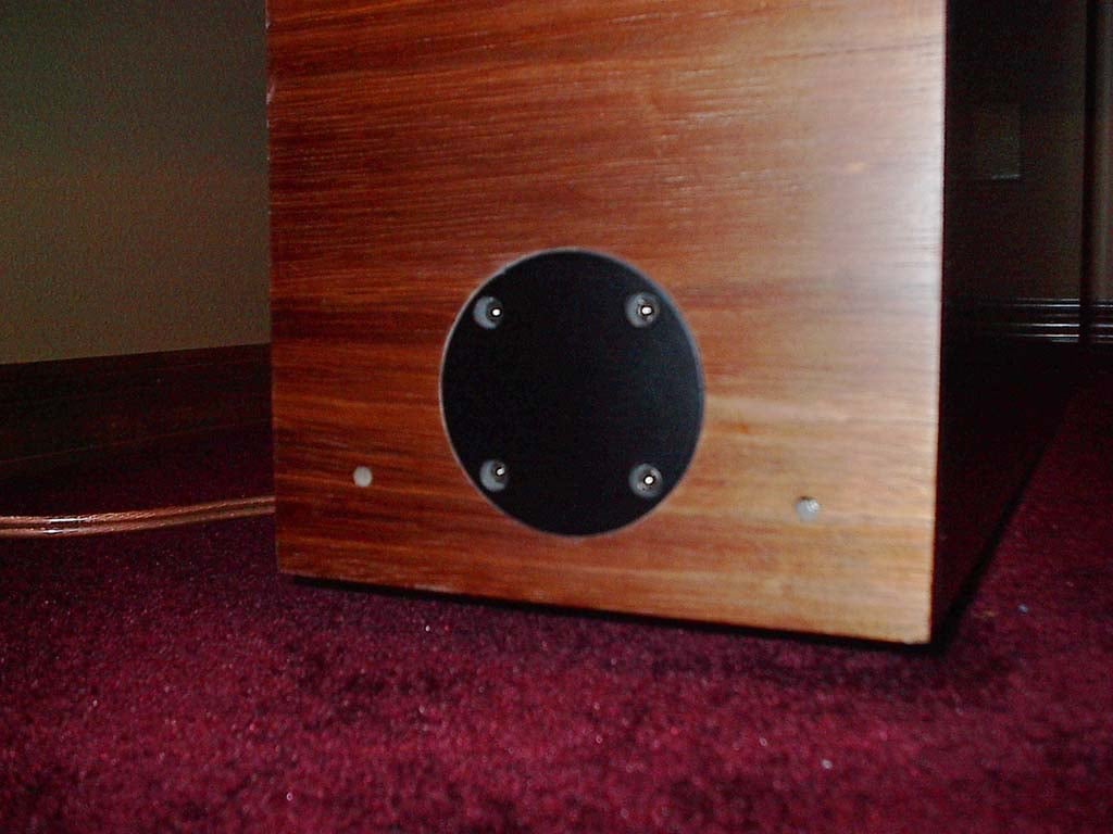

The VR-2 design provided sufficient bracing and a separate chamber on rearposts.jpgthe bottom where the shot could be installed, however it did not follow the standard labyrinth type Transmission Line we were most familiar with. Instead, Mr. Von Schweikert informed us that the VR-2's were more of a hybrid design based on the Pipe Transmission Line concept which was covered at length on their website. For more information on the VR-2 Transmission Line design please feel free to check out their website with the following link: Von Schweikert Audio Transmission Line Design .
Internal Wiring
The internal wiring consisted of hookup wire about 16 gauge in size. Although the wire seemed small, given the short lengths, I doubt they would make an audible difference.
The drivers them self appeared to be chamberwell made. The woofer and mid-range had an aluminum cast frame and as mentioned before the midrange had a vented pole piece which allowed for cooling the voice coil. The tweeter was a soft dome with ferrofluid which also helped cool its voice coil. We were pleased to see that all four drivers had magnetic shielding for placement near a television.

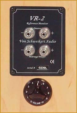

The terminals on the VR-2's were five-way copper binding posts plated with Rhodium. There were two pairs to make the speaker bi-amp ready by removing the bar that connected them. On the bottom of the cabinet was a removable panel for adding the suggested lead shot to the cabinet.

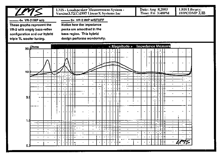

  • Flattened impedance peaks, i.e. linear impedance transfer from the amp to driver.
  • No ringing in the transient response.

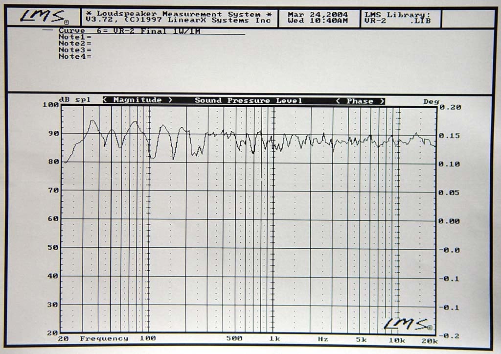

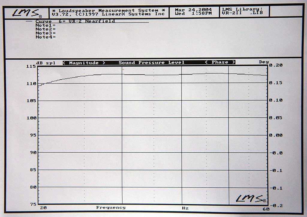

c. Kevin sent you a response measurement taken in our highly damped measurement/design room. That graph shows the entire response with an MLS measurement taken at one meter; this graph shows the typical dips and peaks caused by reflections from the boundaries. We include this graph to show the overall room response, which is quite flat!
The second graph is a nearfield response taken without the room reflections, i.e. it is anechoic. Note that this clearly shows the VR-2 going down to the 25 Hz response

VR-2FrequencyPlotcompressed
VR 2 Near Field Measurements in Design Room
(Click Picture to Enlarge)
VR-2-Woofer-Nearfield-compr
VR 2 Near Field Measurements without room reflections
VR 2 Impedance Plots

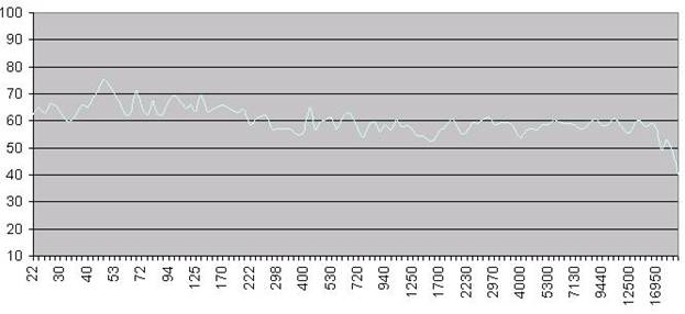

Real Time Analysis (RTA) from the Sencore SP295C Audio Analyzer ( updated 4/12/04 )

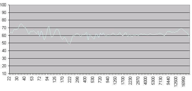

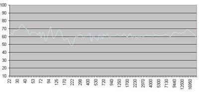

Figure 1. Quasi Nearfield (1 meter) 1/12 th Octave FFT Frequency Response
The overall frequency response of the VR-2 is uniformly flat and smooth with perhaps a slight emphasis in the highs. However, some of the bumps and dips in this response graph may be partially attributed to room acoustics especially since the room treatment is most effective in the mid bass to upper midrange area where the response is extremely smooth and flat, but de-emphasized slightly due to absorption.

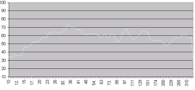

Figure 2. Quasi Nearfield (1 meter) 1/12 th Octave Low FFT Frequency Response
The VR-2's exhibited impressive bass response. However, since they seemed to be a bit energenic in the lower bass region (27Hz - 40Hz), I recommend placing them a few feet away from side and back walls to avoid excessive boundary gain. It appears the VR-2's had no problem reaching down to 25Hz and then some.

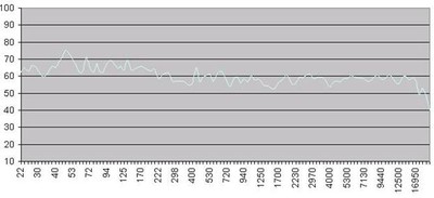

Figure 3. Listening Position 1/12 th Octave FFT Frequency Response
The VR-2's appeared to integrate well within our sound room with impressive low frequency bass response, smooth midrange and upper frequencies. I initially positioned the speakers with no toe-in (as in this measurement), thinking the slightly elevated high frequencies would best be minimized. However, it was apparent that they rolled off very smoothly off axis. If a little more energy at the high frequencies is desired, I recommend slight toe-in.

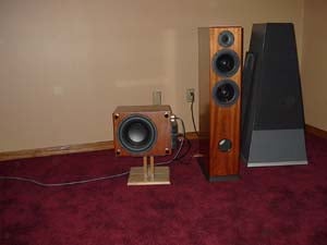

VR-2 Audition with the VR-S/1 Subwoofer
VR2subOnStandsmall At this point I decided to hook up the VR-S/1 subwoofers to see what they could do. The VR-S/1 sub includes a 10-inch down firing driver placed in a very small box which would be great for an apartment with limited space. Keeping in mind that I have a fairly large sized theater room with several strategically placed DIY sound panels and very dense pile carpet these subs were not really able to provide a wave big enough to fill the room. They just aren't made for this kind of set up as they are more tailored for small rooms or apartments. So for a quick test I turned them on their side so that the drivers were firing out into the room.
We learned later that Von Schweikert Audio actually designed the VR-S/1 subwoofer to be front-firing as well. It was actually provided with stick-on rubber feet which was placed on the front baffle. When placed on the front baffle the amplifier was positioned on the top. This position ensured that the heat sinks could still ventilate upwards, allowing for proper heat transfer. This was an option for those individuals who were looking to install the VR-S/1 subwoofers within entertainment center cabinets. But if one wants this type of performance outside of such cabinets and does not mind the cosmetics of this type of placement, it was possible.
For our setup, which was in a very large room with thick carpet, aiming the woofer driver toward the listening area provided more bass response although it wasn't quite as predominate as needed for such a large room. I then put them on small speaker stands to decouple the subwoofers from the carpet. This position proved to clean up the bass tremendously while the two (one for each channel) then became better bass contributors in this setup.
