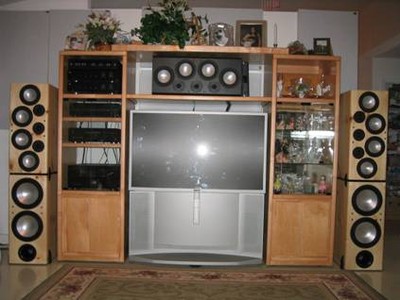

The RBH Sound T System is by far the largest speaker system I have ever reviewed and integrated into a home theater set-up. I was a bit overwhelmed by the amount of boxes that the delivery person brought to my front door when the system arrived. I quickly unpacked the system, broke down the boxes and stowed them away in my attic before the wife came home to avoid her seeing our home in disarray.
RBH Sound T-2 Knotty Pine Finish (Main Channels) and T-1 Black Vinyl Finish (Center Channel) |
My room is a bit more challenging to get a system's bass response just right then this picture would lead you to believe. I have two strikes against me, vaulted ceilings, and a partly open front wall behind the main speakers to the kitchen/dining room area. The left speaker is coupled nicely a few feet away between two adjacent walls. However the right speaker side/back wall opens to another room creating asymmetrical bass loading that if the system is not set-up properly, can lead to bass anomalies usually in the form of suck outs or bumps at particular frequencies. This is why I am so adamant about variable phase/group delay control and/or inclusion of a PEQ for subwoofer amplifiers and processors.
Properly setting up the T-2 System, given my room dynamics and the speaker systems complexity and size proved to be a learning experience. I was fortunate to have Shane Rich on hand to assist in the set-up of this system and have tabulated my set up notes for the benefit of any potential future owners.

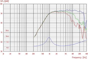

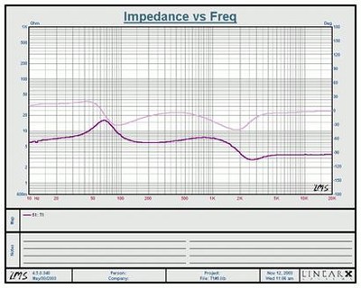

Figure 1. Impedance & Phase Plots of T-1 satellite module
Light Purple: Phase |
This is a very impressive impedance/phase profile for such a complex multi driver speaker array.
The impedance looks almost resistive in nature from 100Hz out to 2kHz with a modest dip down to 4 ohms throughout the remaining audio band. Phase is extremely uniform maintaining a +- 30 degree window throughout the entire audio band, quite an achievement!
In my experience, I haven't measured a more benign loudspeaker load. Based on these measurements, and the high sensitivity of the design, any decent amplifier (even a rigid receiver) should be able to drive these speakers quite well.
Based on the low impedance profile of the T-1 at high frequencies, I recommend using low resistance cables (10AWG or less) to minimize potential frequency variations.

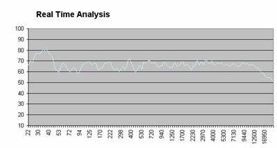

Real Time Analysis (RTA) from the Sencore SP295C Audio Analyzer
Figure 3. T-2 FFT In Room Frequency Response at Listening
Position Acoustic midpoint between T-2 System 5 meters away (20Hz to 21kHz). |

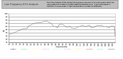

Figure 4. FFT In Room Frequency Response of the T-2 System at Listening Position
Low Frequency (10Hz to 330Hz) 1/12 th Octave FFT at listening position (6 sec average) |

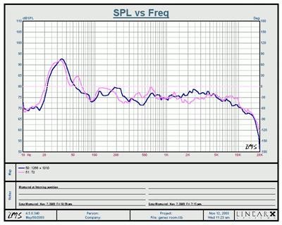

Figure 5. LMS Full Bandwidth Frequency Response Comparison of T-2 and
(1266-LSE + 1010-SEP)
Pink: T-2 System
Blue: 1266-LSE + 1010-SEP Subwoofer
Note the apparent 3dB suckout from 1.5kHz to 3kHz seen in the T-2 response was mostly nullified by simply repositioning the speaker system with respect to my entertainment center as seen in FFT plot in Figure 3 .
While this plot doesn't look pretty, it is a realistic representation of how loudspeakers interact in a room when measured at the listening position using a high resolution measuring system ( > 1/18th octave resolution) such as LMS. Since my original reference system was more calibrated towards Home Theater (bass levels elevated), I attempted to closely match levels with the T-2 System to show a direct comparison. In reality, I usually cut subwoofer levels down a few dB when listening to music, particularly two-channel audio. Figure 4 gives a much better representation of how the bass levels were ultimately set for the T-2 System during my music evaluation.
I would consider the T-2 measurement to be more linear in the treble range. The reason being that the frequency response of the T-2 System fits within a tighter overall window of + or - 2.77 dB from 800Hz to 10KHz, where the 1266-LSE + 1010-SEP system measures + or - 3.85 dB within the same range.
Another important factor to consider is the overall trend of the curve. A general rising or falling trend to the curve is much more audible to the ear than an occasional narrow band peek or dip in frequency response. Now that being said, we are comparing apples and oranges to some degree. Both systems "play" into the room differently. The measurements taken do not distinguish the differences between direct and reflected sound. However, they do show the non-linearity that results from the interaction between direct and reflected sound. This is especially evident in the midrange and mid bass frequencies. Take note that the T-2 System has 4dB more output at 20 Hz when compared to the 1266-LSE + 1010-SEP system which may partly explain why the bass in with the T-2 System was both felt and heard more so than with the 1266-LSE + 1010-SEP reference system.

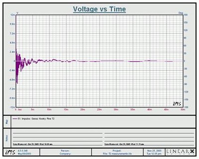

Figure 7. Impulse Response of T-2 System
A quick check of impulse response using LMS demonstrated that no nasty resonance anomalies due to poor driver/crossover integration, ringing, or cabinet vibration was present in this system as indicated by the short settling time and lack of bumps thereafter.

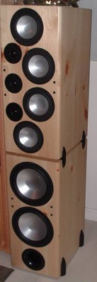

RBH T-2P in knotty Pine
The 1266-LSE's are more limited in dynamic range due to less radiating cone area. In the same breath, the wide array of the T-2 System allows for much higher driver radiation and energy into the room, and to some degree making it more reactive to overly active rooms. What I originally mistook as "bright", was less compressed and had a more open, unforced soundstage which was second to none in my experience.
