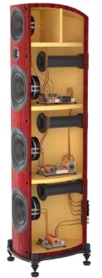

There are three crossover networks in the T3. The bottom is dedicated to the bottom woofer. The second crossover drives the bottom and top woofers and the third crossover handles the midrange and tweeter. While the 1” titanium dome tweeter is the same as in previous models, the midbass drivers in the T3 are all new.

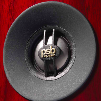

Detail of the Imagine T3 Tweeter

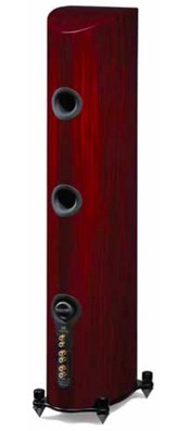

![PSB Rear Ports](PSBrearports.jpg/image_preview)

The T3 features three 7” woofers in a transitional array. In the T3’s transitional array design, all three bottom woofers produce the lowest frequencies together as a piston and each woofer has its own port. However the roll-off of each driver is different depending on its physical placement on the speaker. The lowest woofer, (the one closest to the ground) goes up to about 100Hz then rolls off. The next driver goes up to about 250Hz and then rolls off. The next driver goes to about 500Hz before rolling off and is the only driver that crosses to the midrange. The midrange then crosses to the tweeter.
As can be seen in this design, at the very lowest frequencies, the source of the sound is very large and then as the frequencies get higher, the radiating source area gets smaller and smaller until it finally crosses over to the tweeter. PSB says this eliminates any interference between drivers producing common frequencies for what they call “a perfect transition with uniform off-axis response.”

If you’ve followed PSB over the years, you’ll note that their speaker designs tend to have a tall and slender cabinet design. While great from an aesthetic point of view, when slender cabinets are used as bass chambers, such enclosures tend to have a ‘pipe resonance’ that can ruin bass transients and overall performance. PSB says they address this issue by using individually tuned chambers for each woofer. Each isolated chamber also has its own rear firing tuning port. Using the supplied port plugs, you can fine-tune the T3’s in-room response in case you place the T3s in a small room or close to a wall. But the tweaks don’t stop there.

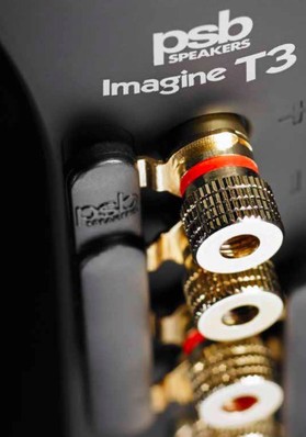

The T3s has three sets of binding posts. In addition to allowing you to tri-amp the speakers, the lower binding post for the bottom woofer can also be disconnected and shorted using the provided woofer shorting bar. Disconnecting the bottom woofer creates a ‘bass trap’ or damper to further suppress room resonances. In other words, the lower woofer becomes an active absorber.
The purpose of all these options is to provide audiophiles and home theater enthusiasts with different options to tweak the Imagine T3 to different rooms and to different musical tastes.
The Imagine T3 has three pairs of binding posts. The lower pair binding posts can be shorted to help fine tune the speaker to the room
