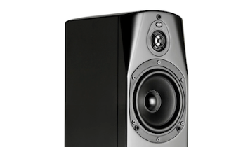

NHT Absolute Tower Looking UpLooking at measurements alone, NHT engineers nailed the design of the $1100 per pair Absolute Tower loudspeaker.  This is among the best measuring loudspeakers I’ve come across in almost every measurement.  In the case of the NHT Absolute Tower, the measurements translate to a very good sounding speaker at a very reasonable price.  Interestingly, NHT chose the word “Absolute” when naming this speaker.  Absolute is defined as something that is not qualified or diminished in any way.  In the context of a reasonably priced small footprint tower crossed to a subwoofer in a typical living room, I would say the use of the word “Absolute” is justified.
If you have been around audio for any time at all, there is a good chance that you are at least casually familiar with the NHT brand.  The company launched its first product in 1987 and has since built a strong reputation of offering high quality products at bargain prices.  NHT seems to prefer designing a really good loudspeaker every once in a while as opposed to pumping out speaker after speaker in an ever-changing market.  Staying relevant, this design has definitely adapted to the times with a very small footprint and cabinet for a 3-way tower loudspeaker.  Getting deep bass out of a small tower means the designer has to compromise something else such as efficiency and power handling.  NHT has designed a loudspeaker that trades deep bass for articulation, linear response and low distortion across the board.  The measurements are good because this speaker was designed to do everything that a subwoofer doesn’t do.

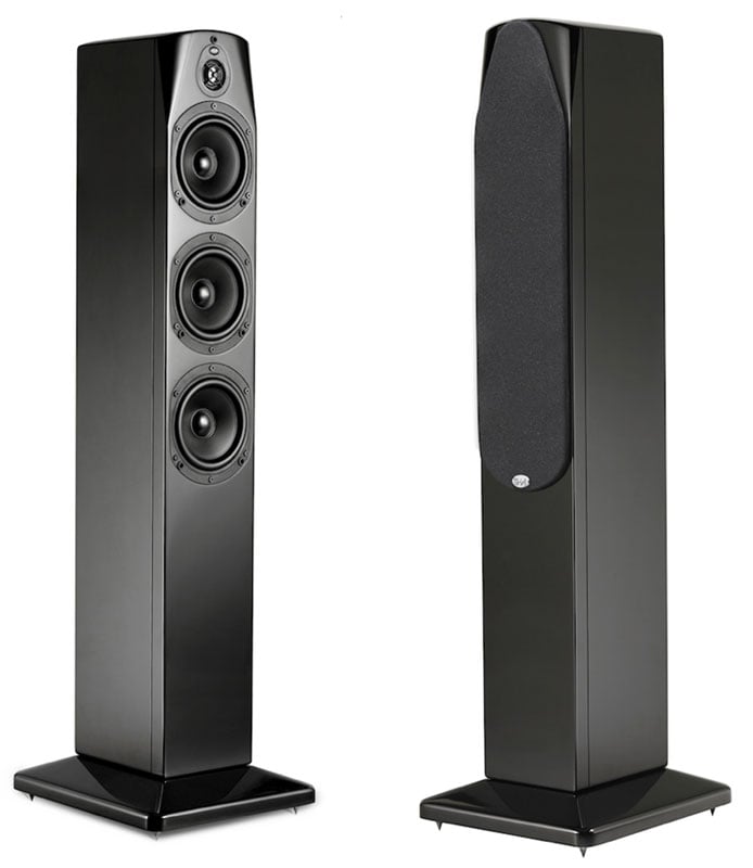

NHT Absolute Tower Design Overview

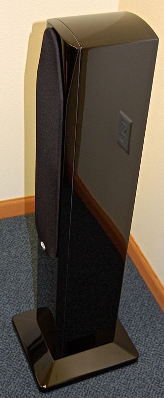

NHT Absolute Tower Cabinet Loudspeaker Cabinet
As is the case with much of NHT’s lineup, the build quality is truly first rate.  The cabinet is made of MDF and has substantial bracing.  Due to the small enclosure size, bracing and thick MDF, the cabinet should not contribute much extraneous sound due to resonance.  This MDF is methodically finished with several layers of primer, paint and clear coat yielding a reasonably durable and beautiful piano black finish.
The top of the cabinet is slightly curved adding to the aesthetics.  The left and right sections of the baffle around the tweeter are substantially chamfered.  NHT claims this is done to randomize diffraction effects.  While this will divert reflected tweeter energy off-axis, it doesn’t look so random in the polar response as this energy is not destroyed and causes off-axis response anomalies discussed in the measurement section.
The speaker is a 3-way acoustic-suspension system with a separate internal enclosure volume for the woofers.  Separating the midrange from the woofers is essential as it prevents the woofer’s backwave from re-radiating through the midrange cone.  A separate enclosure also allows the designer to optimize the enclosure volume of the midrange.  Without this, I would suspect that the measurements would not have been nearly as good.
The cabinet base is solid and attaches with hearty machined Phillips head screws. Since the cabinets are relatively short at 37.9” and are not very top heavy, they feel relatively stable on carpet or hard surfaces.  They are not toddler proof, but should work well in the majority of homes.  The NHT Absolute Tower ships with floor spikes for carpet and cups to place the spikes in for hard floors.

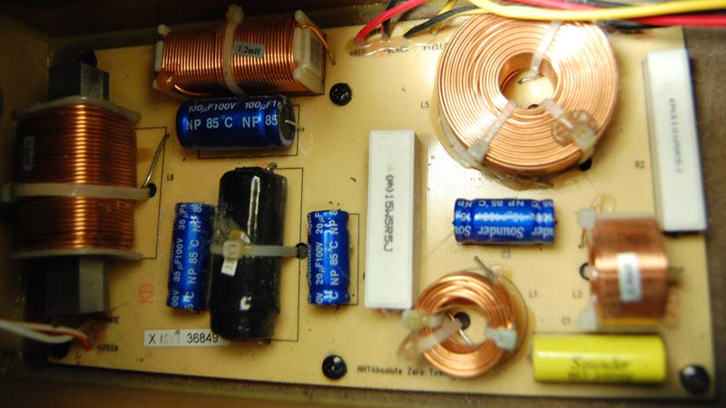

The loudspeaker crossover component count and quality is on par with what is found in this price classification.  There is a mixture of iron core and air core inductors.  The majority of the capacitors are electrolytic but there is a single polypropylene capacitor likely placed in series with the tweeter.  The component count is relatively low because the crossover is listed as 3rd order low pass and 2nd order high pass.  A shallow slope 2nd order crossover at 2.2kHz to a 1” aluminum dome tweeter is not something that typically works well unless the volume is kept low or the tweeter is beefy and fluid-cooled.
 Crossover
Absolute Tower Crossover
A 2nd order crossover reduces phase error, but as all things in engineering, there are tradeoffs.  Specifically, a 2nd order crossover has a shallower roll-off of low frequencies for a tweeter than higher order crossovers.  This means that a 2nd order crossover at the same crossover frequency as a higher order crossover will subject a tweeter to more output at frequencies below the crossover frequency.  If the crossover point is too low then this can significantly reduce power handling and increase distortion.  Every inductor and resistor in the crossover adds 90 degrees of delay to the signal heading for the speaker.  This means that for a signal going through two crossover components, the signal is 180 degrees out of phase compared to the original signal.  If the sound from two drivers radiates from the same plane and one goes through two crossover components and the other is directly connected then one driver will go in and the other will go out when the signal starts.  This will of course cause cancellations.  Luckily with a simple second order crossover, the driver polarity can be reversed and the phase response is corrected.  In the case of a crossover between a midrange and a tweeter, the acoustic center of the driver is not in the same range because the midrange radiates from the center of the cone which is typically an inch or more deeper than the acoustic center of the tweeter.  In an effort to create a linear phase speaker, the designer can either physically align the acoustic center of the drivers or use a ladder delay network to align the phase difference electrically.
In the case of the Absolute Tower, the crossover between the midrange and tweeter is 2nd order electrically, but close to 4th order acoustically.  The difference is due to the fact that NHT specifically engineered the drivers to reduce output below the crossover frequency for the tweeter and above the crossover frequency for the midrange.  The woofer to midrange crossover is 3rd order electrically but also close to 4th order acoustically.  The 4th order acoustic crossover allows the NHT absolute towers to play at high power and still maintain relatively low distortion.

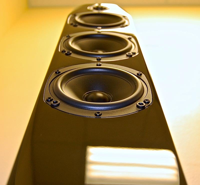

NHT Absolute Tower Speaker Drivers
This three way acoustic-suspension design uses two 5.25” woofers in a separate air volume, a 5.25” midrange and a 1” fluid-cooled aluminum dome tweeter.  All drivers are magnetically shielded with good-sized motors, materials and workmanship.  Since CRT TV’s and VHS tapes are not popular anymore, I’m not sure if the shielding provides much of a real world benefit.
The tweeter uses a neodymium magnet and appears to be well made as evidenced by the measurements.  Most metal dome tweeters have resonances in the 1-2kHz range and then again at higher frequencies.  The measurements for this tweeter do not reveal any resonance issues within the operating range up to 20kHz!

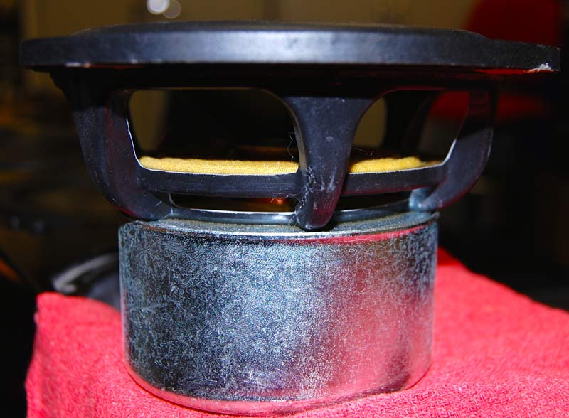

The woofers and midrange are all 5.25” drivers with matching polypropylene cones and full magnetic shielding for the rare application requiring magnetic shielding.  The motor structure looks pretty beefy and the spider and frame are also high quality.  Using two 5.25” woofers in a pretty small sealed enclosure does not provide a great deal of low frequency extension.  The response of the woofers is tuned pretty flat and rolls off at 12dB per octave.  This speaker can be used with a subwoofer with a 12dB per octave low pass at 80Hz without a high-pass filter on the loudspeakers.  For the two channel snobs, this means that the speaker will integrate with a subwoofer without any sound degrading high pass filter.
Absolute Tower Wofer
Absolute Tower Woofer

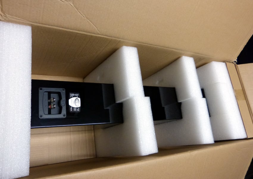

NHT Absolute Tower BoxThe cardboard box surrounding the NHT Absolute Towers makes you think a much larger loudspeaker is coming out.  The speakers are very adequately protected with several thick foam ribs and a foam base and top.  The base of the loudspeaker comes in a separate box and is attached with four Phillips head screws.  The pair of Absolute Towers arrived in perfect condition.

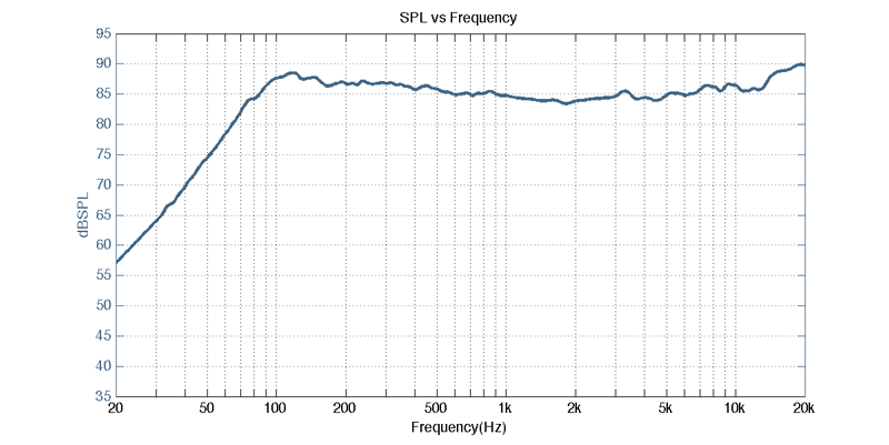

NHT Absolute Tower On-Axis Frequency Response
The on-axis frequency response of the NHT Absolute Tower was conducted with the measurement microphone at 2 meters with a 2.83V excitation signal. The results are scaled to 1 meter mathematically. The manufacturer rates this loudspeaker’s sensitivity as 86dB at 1 meter with a 2.83V input. Audioholics measures sensitivity as the average sound pressure level (SPL) from 300 to 3kHz. The Audioholics rated sensitivity for the Absolute Tower is reasonably close at 84.9dB. With respect to frequency response, the slight dip from 500Hz to 3kHz along with the rising response from 3kHz to 20kHz yields a slightly bright presentation. Note that this speaker has a very flat response but +/- 2dB over many octaves causes a certain perception of tonal balance. The steep rising response above 16kHz is at the edge of my hearing so I did not notice anything offensive. If you desire flat frequency response, this loudspeaker system is flatter than most studio monitors I have measured.

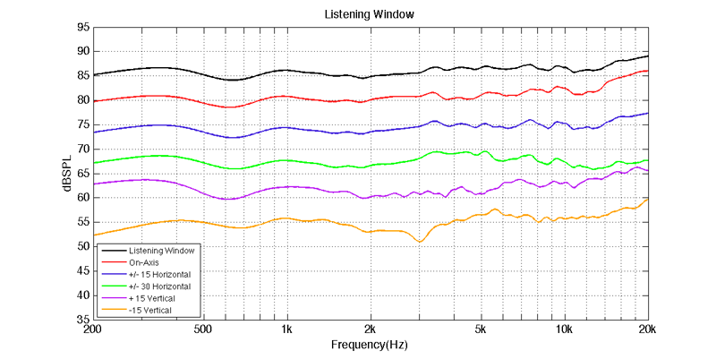

NHT Absolute Tower Listening Window
The listening window response for the NHT Absolute Tower is conducted with a 2.83V input signal at 2 meters from 7 locations. The measurement provides a picture of how the loudspeaker performs from seating locations that are not directly on axis with the speaker. The top curve is the average of the other positions and provides an average of how the speaker performs throughout the listening area. Subjectively, the off-axis response within the listening window is extremely uniform with no roll-off of high frequencies at angles up to 30 degrees. This means that the direct sound from the speaker will sound very similar for most of the listening area.

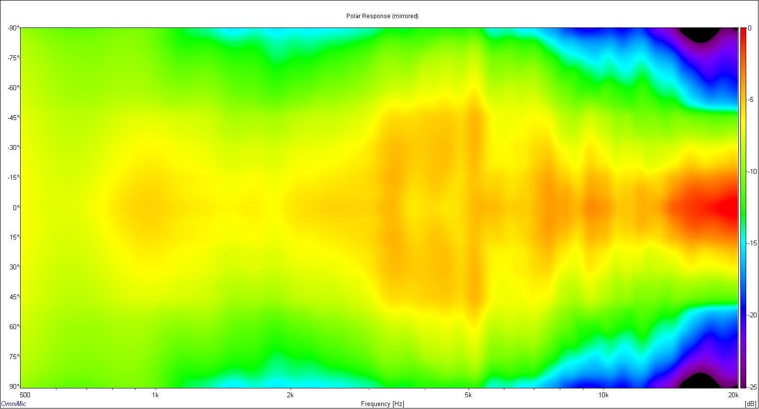

NHT Absolute Tower Polar Response
NHT Absolute Tower ChamferRemember that chamfering around the tweeter we discussed earlier? Its effects are clearly visible in the polar response graph. Specifically between 3kHz and 5kHz we see an odd flanging of the polar response. This effect is due to the angled baffle surrounding the tweeter. Above 5kHz, the tweeter output bounces off of the flat section of the baffle and the polar response narrows. Between the crossover point of 2.2kHz and 5kHz, the tweeter is transitioning across the angled chamfer, increasing the output off-axis. This seems like a good thing because the response is close to linear when sitting up to 30 degrees off axis. However, this has consequences in rooms without acoustic treatments. There is now extra acoustic energy in a limited band being launched into a room at higher angles than other bands. Human perception of sound includes reflections and direct sound. Therefore, the typical quasi-anechoic frequency response does not tell the entire story of how a loudspeaker will sound in a room. While I was able to get the Absolute Tower to sound very good in my listening environment, it did take some coercion and adjustment. Please consider your room before purchasing this speaker, this would not be my go-to speaker if my room was all hard surfaces without any treatment.
Loudspeaker imaging is something that is hard to quantify. However, there is a strong link between a loudspeaker’s polar response and imaging. This is because the human brain determines location based on two cues. Specifically, the brain can determine the location of the source of a sound by the difference in loudness between the ears or by the difference in signal arrival time. Room reflections cause delayed signals to reach the listener distorting the acoustic image. The NHT Absolute Towers created a respectable acoustic image, but it was not with the pinpoint accuracy found in some more expensive speakers. I believe it is due to the polar response due to the chamfered baffle. While this improves off-axis measurements within the typical listening area, it has tradeoffs in stereo imaging.

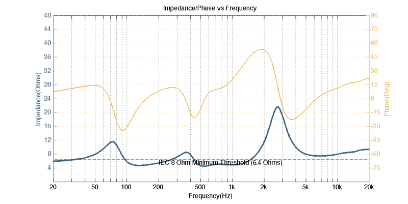

NHT Absolute Tower Impedance
The impedance of the NHT Absolute Tower is listed as 8-ohm average with a 4-ohm minimum. The minimum measured impedance was 4.2-ohms which places it below the 4.8-ohm minimum rating for a 6-ohm speaker. Therefore, Audioholics conservatively recommends that a 4-ohm stable amplifier to drive the Absolute Towers.

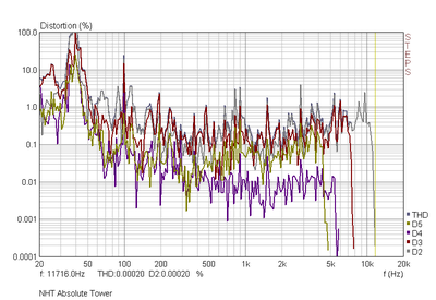

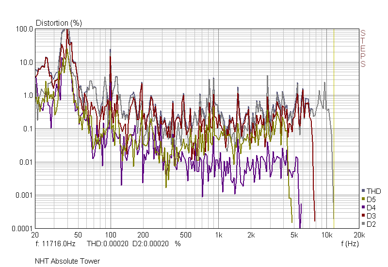

NHT Absolute Tower Harmonic Distortion
The harmonic distortion graph was generated using a 90dB stepped sinusoid sweep measured at 2 meters. The distortion measurements are very low across the operating range. Crossed over to a subwoofer, it is possible to create a low distortion system at a very reasonable cost.

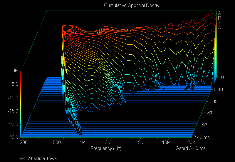

NHT Absolute Tower Cumulative Spectral Decay
The cumulative spectral decay measurement provides a picture of how quickly a loudspeaker stops playing after the signal stops. The NHT Absolute Tower has an extremely clean cumulative spectral decay meaning there are no offensive cabinet or system resonance issues. The left most edge that looks bad is simply a limitation of the measurement technique and should be ignored. I was unable to see any resonance in this metal dome tweeter.

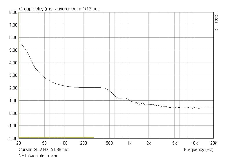

NHT Absolute Tower Group Delay
The group delay graph shows the rate of change of the slope of a loudspeaker’s phase. As a rule of thumb, values below 1.6ms in the mid to high frequencies will likely not affect perception of sound quality. Increasing group delay in the low frequencies is not as objectionable as it is in the mid to high frequency ranges. The group delay stays below 2.5ms for the woofers and decreases significantly for midrange and tweeter frequencies.
