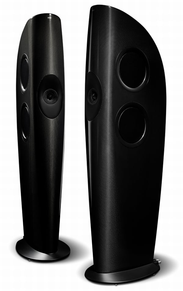

KEF_Blade_3DCabThe KEF Concept Blade speakers represent five years of research and testing. They are being released to celebrate the 50th anniversary of the company. The main claim to fame behind the speakers is the Single Apparent Source technology. The point is that all the drivers work together to ensure that the sound all appears to come from a single point. If you know anything about KEF, you know they love their coaxial drivers (this is a tweeter mounted in the center of a midrange woofer). The Single Apparent Source is a not-so-subtle nod to this focus.

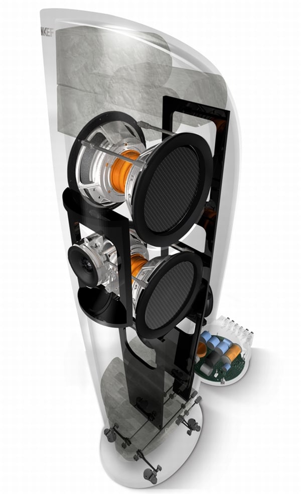

The KEF Concept Blade floorstanding speakers sport four 9" bass drivers each. The bass drivers fire to the side and are mounted directly behind each other in order to cancel out any internal waves and resonances. The drivers are arranged so closely that the magnets of each pair are bolted and bonded to each other. The side-firing configuration also allows the acoustical center to coincide with the front mounted Uni-Q coaxial midrange driver and tweeter. The fully pistonic KEF Uni-Q MF/HF array has a an injection molded LCP (Liquid Crystal Polymer) cone with a 3" voice coil. In the center is a 1" titanium dome tweeter which is tube loaded to give exceptionally low resonance and has a tangerine wave guide. Together, according to KEF, they can handle the entire frequency range.
The Concept Blade speakers are constructed out of glass-reinforced composite material (fiberglass - probably some sort of carbon fiber) over a balsa wood core. The enclosure is thinner at the top and bottom than at the middle (where the drivers are located) which, other than aesthetic reasons, also increases the enclosure's rigidity. The back of the speaker sports a single flared port and three pairs of binding posts for connecting the speaker to the off-board crossover. It is unclear if you can tri/bi-amp the speaker as the crossover has not been shown in detail yet. The KEF Concept Blade is available in a standard Gloss White and Gloss Black, but will also be available in an array of custom colors including Garnet, Sapphire, Grigio, Racing Red, Racing Blue, Pale Gold, Orange Sorbet, Graphite, Stardust, Lemon Sorbet, Lime Sorbet and Snow White. For $30k, we'd expect nothing less.
There are enough holes in the KEF Concept Blade speaker design for a true audiophile to use to justify other speakers' higher prices. KEF seems to be married to the coaxial driver to the point that they built an entire speaker around the Single Apparent Source concept. KEF hasn't seemed to buy into the sonic benefits of silver/platinum/unobtainium wire. There is no mention of burn-in, frozen, or anything at all chocolatey. In fact, they don't mention at all how the speakers will make you feel or how they will transform your music. All they say is that they won't distort and that it'll appear to come from a single point in space. This single source presentation will create a sonic picture that is "virtually indistinguishable from a live performance." Not better than. The same. Doesn't sound very esoteric to me.
