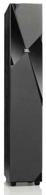

Occasionally, someone releases a new piece of AV gear that just takes our breath away. It might be a receiver with features we've never seen before or a product at a price point that makes what was once the purview of the uber-rich accessible to the masses. It might be something that is a great step forward in technology. All these, however, are few and far between. Much more likely is a speaker design that is so beautiful or functional or cool that their pictures end up plastered all over audio forums.
This is not one of those times.
The new JBL Studio design is radical to say the least. It's actually hard from the pictures to understand exactly what is going on with the grill. It looks like there are two different materials - one a soft grill fabric and one a hard plastic. We're guessing they are both a grill fabric but coloring differences and lighting tricks make them look that way. The look is definitely... unique. JBL describes it as a "Distinctive, one-of-a-kind look." That may be true (and in all honesty, they may look great in person) but most of the reactions we've heard have been more along the lines of "ugh."

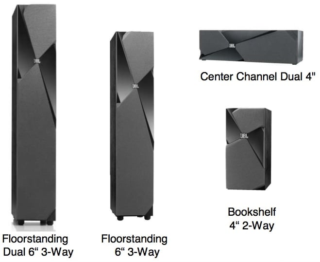

This isn't to say the new line doesn't have a lot going for it. All the speakers from the top of the line 190BK to the 120CBK center channel are constructed out of 3/4" MDF - definitely a higher-end material than in your typical enclosures. The line itself is fairly reasonably priced with the Studio 190BK towers commanding only $1040 a pair, the smaller 180BK towers asking $820 a pair, the 130BK bookshelves at $540 a pair, and the 120CBK center at $200 each. Not exactly a wallet-busting price point.
We have to hand it to JBL in that they are bringing out a speaker line at a price point that surely is going to turn heads, with a design that is sure to garner attention as well. The drivers in the speaker consist of PolyPlas cone woofers (dual 6.5" in the 190's with a 4" mid, a single 6.5" in the 180 with a 4" mid, and dual 4.5" woofers in the 120CBK center and single on in the 130BK bookshelves) paired with a 1" CMMD Lite dome, magnetically shielded, in a Bi-Radial constant directivity waveguide. All of the drivers are magnetically shielded in case of close placement to a CRT or a magnetic drive. While we usually eschew such features (or assume that the drivers happened to be magnetically shielded and not that it was integral to the design), at this price point it actually makes sense.
