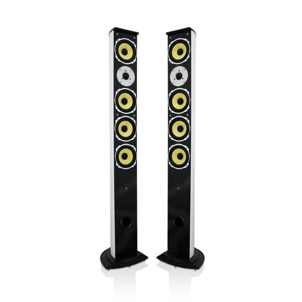

The Fluance ES1 is a sleek floorstanding speaker sporting a 1" silk dome tweeter and four 5" woven glass fiber drivers in a slim vented enclosure composed of forged aluminum, except for the front baffle which is MDF. A basic two-way design, the tweeter hands off to all four woofers at 3,500Hz. Claimed sensitivity of the ES1 is 90dB; nominal impedance is listed as 8 ohms; frequency response is specified to be 72Hz-20kHz, though no tolerance is provided.
So what does this information tell us? For starters, in spite of the aggressive appearance that four 5" woofers might give, the ES1 is without a doubt designed to be used with a subwoofer, and would likely work optimally if crossed over at the THX standard of 80Hz. Fortunately, with a significant amount of cone area to work with, we'd expect the ES1 should deliver a respectable amount of output for the dollar down to the 80Hz mark. Taking the sensitivity and nominal impedance ratings at face value, the ES1 shouldn't present a particularly difficult load for a partnering amplifier, though one should note nominal figures and reality do occasionally differ significantly.

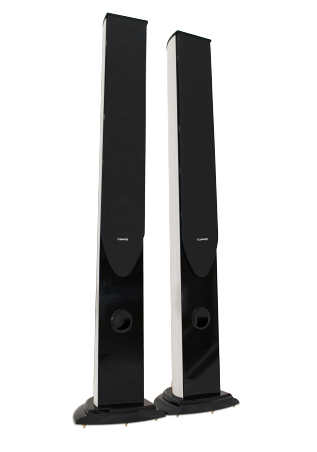

Fluance ES1 Grill On
The Fluance ES1 with the grills on.
