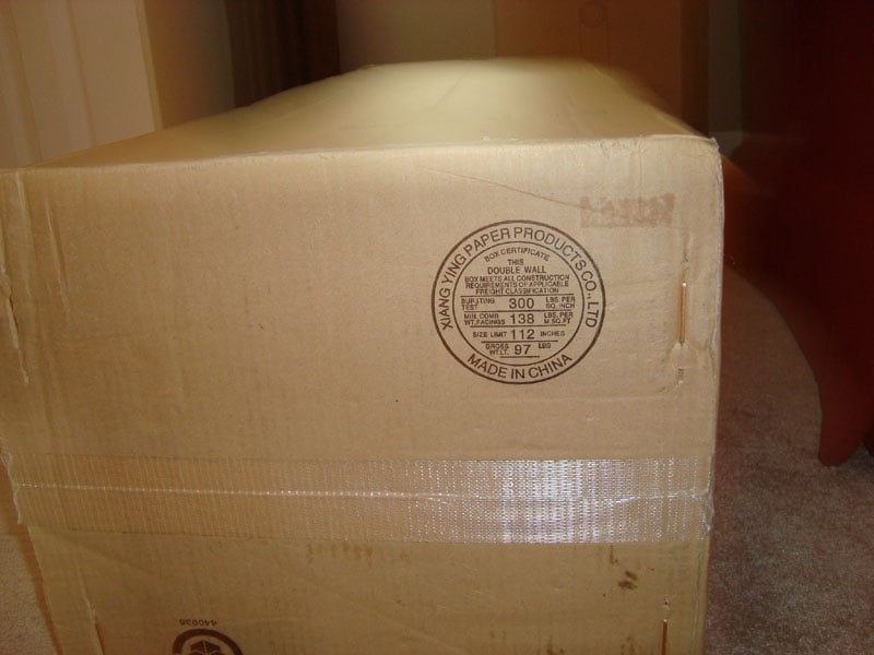

The B&W CM8s were single boxed in heavy-duty corrugated and had high-quality EPS foam caps holding the speaker at each end of the carton. Chinese packing material is interesting: Regardless of the so-called “burst rating” printed on the corrugated carton or what kind of internal foam packing material they claim it is, in order to get the “good stuff,” a manufacturer has to pay a Chinese vendor top dollar. These cartons were burst rated at 300 lbs. Generally, Chinese cartons rated below 200 lbs. burst are made out of what manufacturers derisively call “cheese paper,” flimsy, lightweight material that seems ready to disintegrate under the slightest stress.
B&W CM8 Box Burst Rating Marking
Likewise, the internal foam packaging falls into two broad categories: 1) the cheap kind, that breaks into pieces and crumbles into tiny foam sawdust balls that float annoyingly all around the room, rendering impossible any thought of repacking with the foam inserts, and 2) the good foam, which stays together and makes repacking easy and repeatable.
B&W uses very high quality packaging. Having been involved in the design, sourcing and manufacturing of consumer electronics products for decades, I know the cost difference between good and bad materials, and what that says about what a given manufacturer thinks of their products and the image and impression they wish to convey to their customers.
This was a good first step.

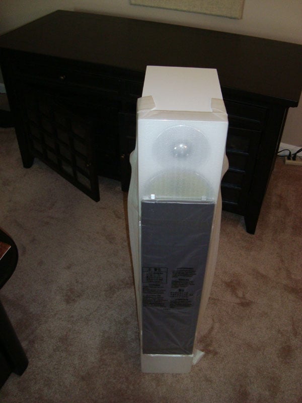

The grilles were shipped in their own bag and the speakers themselves have a protective clear plastic shield placed over the baffle board to protect the delicate drivers during shipping and removal from the carton/initial setup. This is incredibly thoughtful and sensible packaging design. I have seen many a tweeter dome ruined by wandering fingers as the speaker was grabbed and carelessly pulled out of its box.
B&W CM8 Protector & Bag Covering Speaker

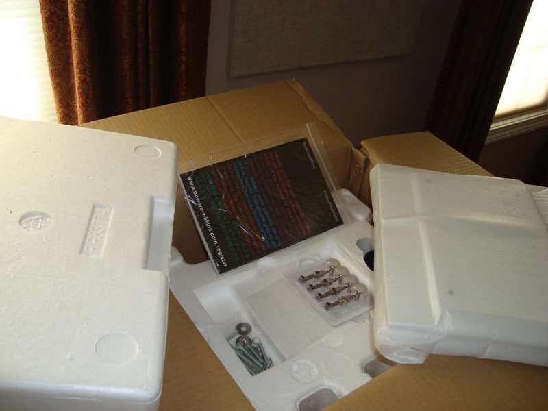

The speaker’s base (or “plinth,” as the Brits so amusingly call them) and the carpet spikes/rubber feet for hardwood floors sat in voids in one of the internal foam endcaps. The spikes/feet themselves were in a cardboard/plastic container, much like a small product you’d find at the store. Everything neat, everything nicely situated.
B&W CM8 Accessories
The plinth attached easily to the bottom of the speaker with the included machine bolts and hex wrench. Everything lined up correctly, and there was no paint of other obstruction to bind up the threads as the bolts were tightened.

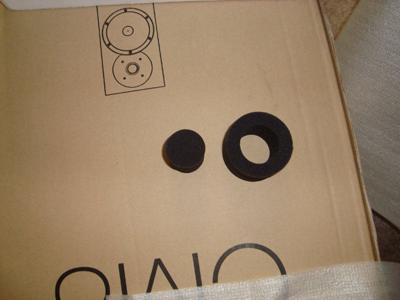

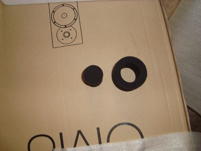

There was another accessory that was unexpected: This was a two-part cylindrical foam “plug” that fit into the rear bass Flowport™. You can effectively transform the CM8 into a sealed system by using the entire plug, or you can remove the center section of the plug and get a quasi-combination of sealed and ported performance. The owner’s manual shows all three response curves: unplugged, partial plug, and fully plugged. More on how these sounded later.
B&W CM8 Foam Port Plugs

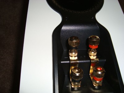

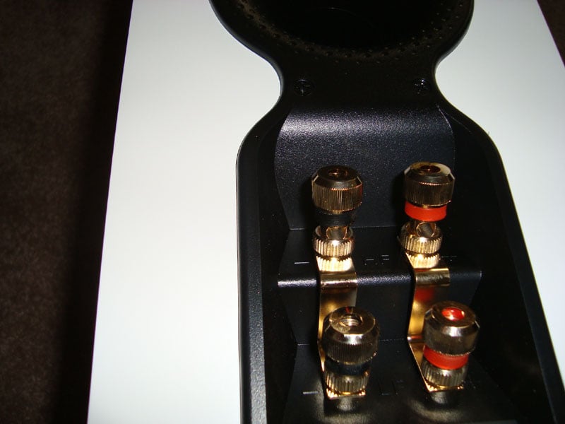

The CM8 might be compact at 38” tall x 6.5” wide, but it’s very heavy for its size and conveys a very solid impression to the user. There are two sets of binding posts—just below the dimpled port, as part of a common plastic assembly— connected by a brass strap. The ends of the posts have the required plastic plugs (a CE requirement), but these can be pried out if you want to use banana plugs instead of bare wire to connect the speaker wire to the posts. The posts themselves have a nice-sized hole to accept bare wire and that’s how I connected them with 14-ga wire. Nice, easy, and secure. I did not use the bi-amp feature, but it’s nice to know the option exists.
B&W CM8 Binding Posts

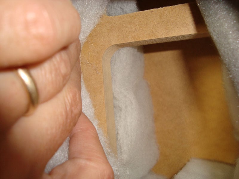

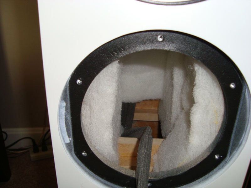

The cabinet itself was made of high-quality 7/8” MDF. (Again, not all Chinese MDF is created equal—there is “good,” solid Chinese MDF and there is flaky, cheap Chinese MDF. This was the “good” kind.) The driver areas on the baffle were routed out, so those sections are thinner than the rest of the cabinet walls, unfortunately. However, as can be seen in the photos, the inside of the cabinet has extensive windowpane bracing, which contributes to the cabinet’s overall solidity. The FST™ midrange driver is in its own isolated chamber within the cabinet. The cabinet is also stuffed pretty densely with a fiberglass-ish material throughout, no doubt with the intent of reducing internal cabinet resonances and standing waves to a minimum. One gets the overall impression that this is a very inert cabinet that does not negatively intrude on the speaker’s sound.
B&W CM8 Internal Views of Cabinet Bracing & Stuffing

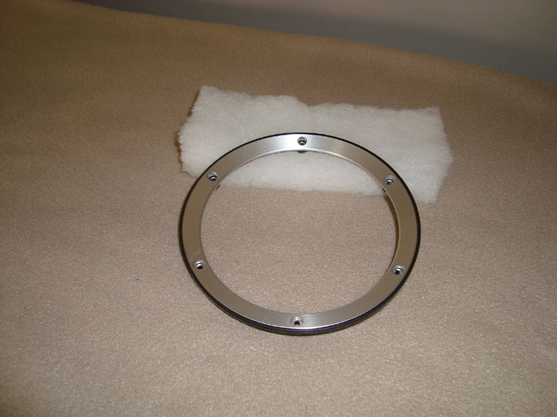

This is a very attractive speaker with the grilles off. The silver “aluminum” rings around the woofer and the “aluminum” faceplate on the tweeter are actually just a thin (perhaps 2 mm thick) brushed aluminum flashing, adhered to a molded plastic substrate. This is pretty common practice among speaker manufacturers, as it gives them the opportunity to present nice-looking drivers that appear to have very expensive aluminum frames or faceplates, while keeping costs dramatically lower.
B&W CM8 Driver MR Trim Ring

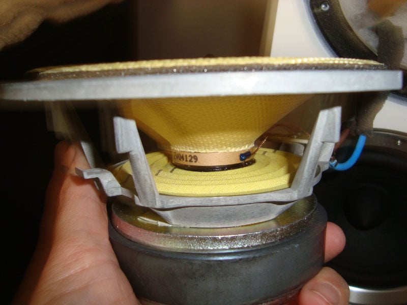

In B&W’s case, however, these are, in fact, aluminum-frame woofer and midrange drivers. Once the trim rings are removed, you can see the raw drivers themselves: they have heavy cast aluminum frames, far stronger and less prone to ringing than cheaper stamped-steel frames.
B&W CM8 Midrange Driver

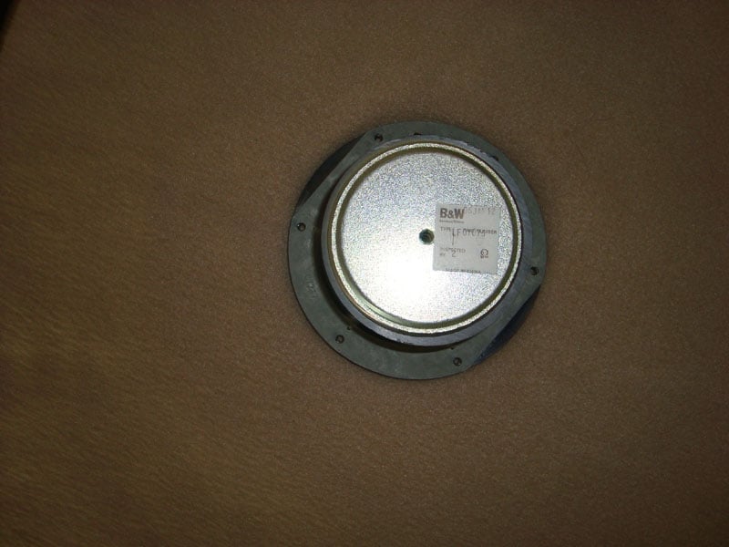

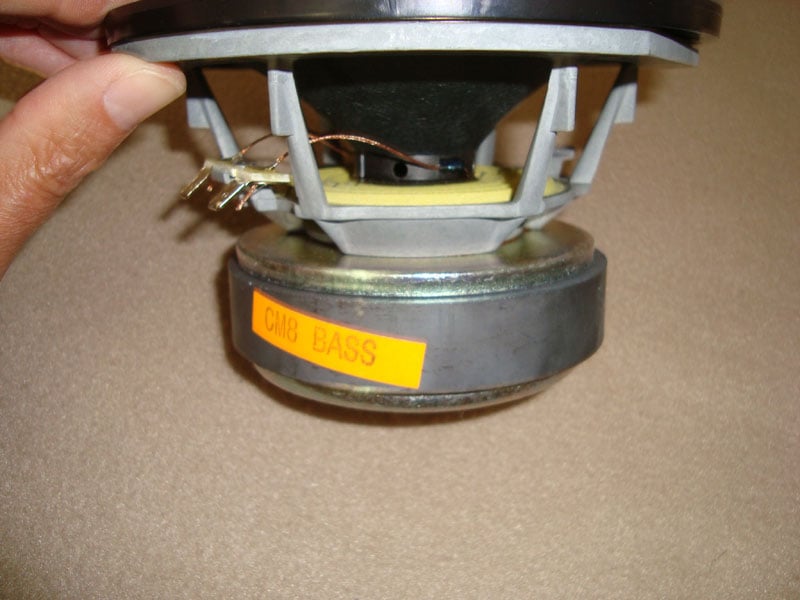

The woofers have vented voice coils, and measure 29 mm across, or 1 1/8”. This is a beefy voice coil for a small 5” woofer. A slightly larger voice coil like this will exert more control over the woofer’s cone for lower distortion and will handle a good deal more power than a conventional 1” coil, which is 27% smaller than a 1 1/8” coil. Nice design.
Also clearly visible is the unexpectedly large magnet structure, which no doubt contributes to a respectable overall system sensitivity of 88 dB.
B&W CM8 Bass Driver (notice the vents on the voice coil)

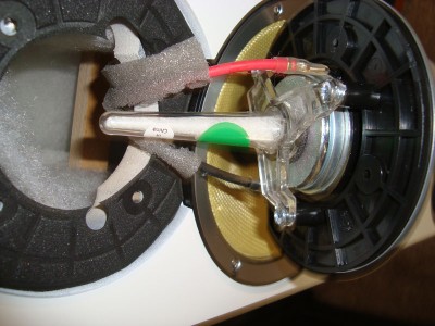

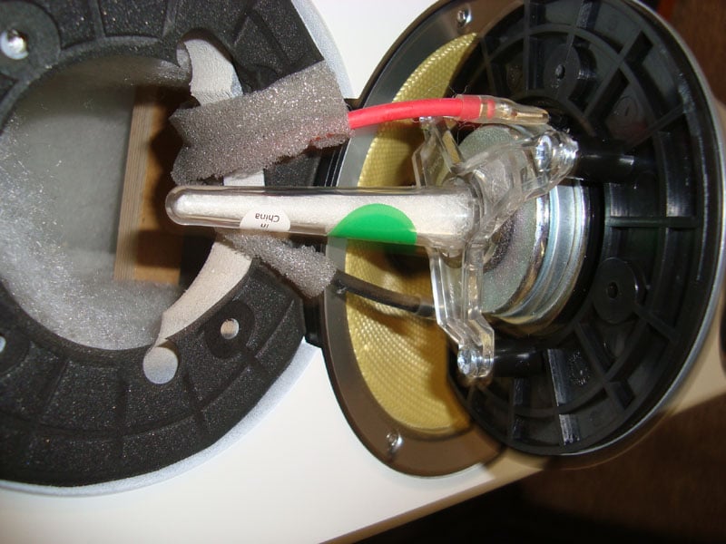

The distinctive yellow-woven B&W Kevlar 5” midrange driver features B&W’s proprietary FST™ design, which stands for Fixed Surround Transducer. According to the manufacturer, the FST design reduces the non-linearity in the driver’s travel by eliminating the overly soft and floppy conventional surround, thus keeping the driver’s motion more purely pistonic within its operational passband, for greater accuracy and lower distortion. The FST design is used in B&W’s speakers right up through their Diamond Series, which top out at over $20,000/pair!

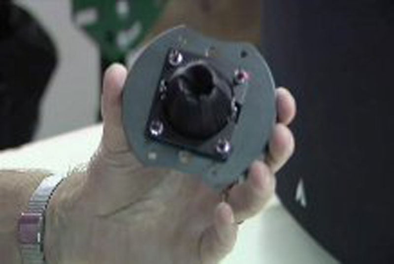

The tweeter is an interesting driver. It utilizes a scaled-down version of B&W’s Nautilus tweeter rear enclosure, where the rear radiation of the tweeter is disseminated in a tapered chamber of non-parallel walls, thereby eliminating the possibility of the high frequencies being re-reflected through the dome and interfering with the tweeter’s direct radiation. As can be seen in the accompanying photo, the clear plastic tapered chamber is filled with damping material. There is no reason not to treat the high-frequency enclosure and radiator as an interdependent system, the same way the woofer and main enclosure are treated. Kudos to B&W for doing so.
B&W CM8 Tweeter

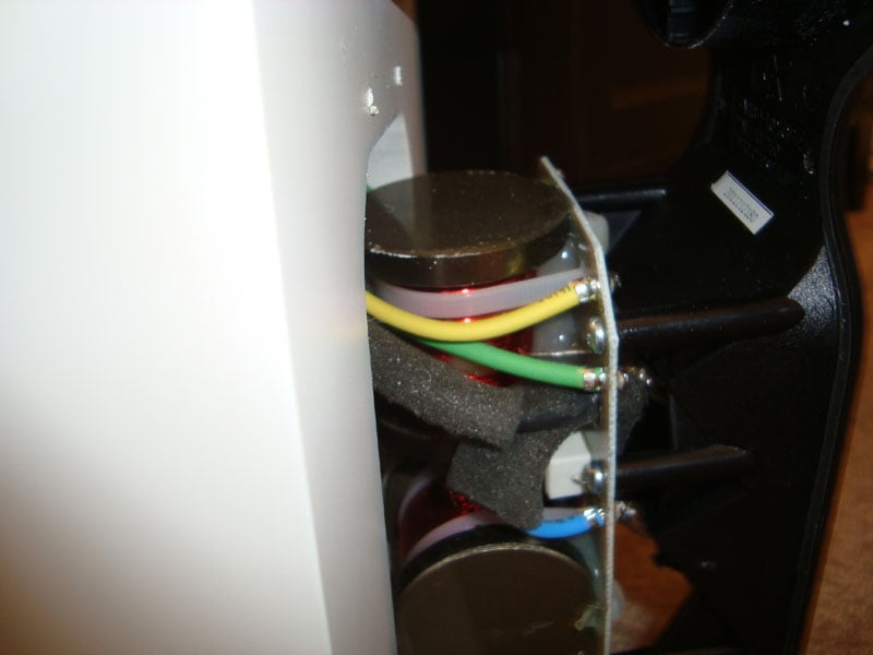

The crossover is a pretty conventional design, using standard parts. It is mounted on the inside of the bi-amp terminal assembly, which is part of the terminal cup/Flowport™ plastic molding. Two massive chokes are used and mounted at 90º to each other, to cancel out any magnetic interaction between the two. That’s smart design. They are also both strapped and hot glued down to the PCB, for a good mechanical connection and vibration prevention. The caps and resistors are regular-grade components, not audiophile-fringe grade. The Flowport has B&W’s trademark dimpling on the surface of the port tube, said to reduce port “chuffing.” The inside end of the port tube is also flared to reduce wind noise, which is where many manufacturers cut corners since it’s not visible from the outside of the cabinet. Again, this shows the careful attention to detail one expects in a premium-level product.
B&W CM8 Crossover

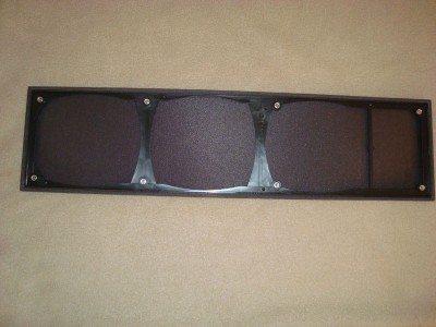

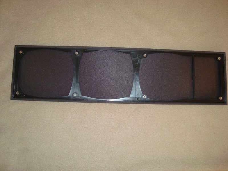

The grilles continued the theme of clever, thoughtful design. Imbedded into the grille’s frame were several small neodymium magnets. Just under the surface of the speaker’s front baffle—but not visible to the user—were either metal discs or corresponding neo magnets. When the grille was brought near the baffle, the neos “grabbed onto” their magnetic partners under the baffle’s surface, and the grille neatly and precisely snugged into place on its own. A firm but gentle tug was all that was required to remove the grille, and there was never any danger of the grille coming off on its own. No alignment by the user was necessary; once the magnets “grabbed,” the grille positioned itself exactly where it was supposed to, every time. Very, very nicely done, and the front baffle of the speaker was totally free of any visual obstructions like grille tree receptacles or grommets, etc.
B&W CM8 Grille Cover with Neo Magnets

Which brings us to the next subject: those foam bass plugs. As stated before, these are a two-part cylindrical foam “plug” that fit into the rear bass Flowport™. You can effectively transform the CM8 into a sealed system by using the entire plug, or you can remove the center section of the plug and get a quasi-combination of sealed and ported performance. As shown in the manual, using the plugs reduces the bass output (a higher 3 dB down point) and makes the LF rolloff more shallow. Using the full plug makes the CM8 behave like a sealed system, with a 12 dB/oct rolloff and a higher 3 dB down point than when the port is fully open.
Why would anyone want to do this? The low end of the speaker is so correctly engineered and clean-sounding as a bass reflex system that to arbitrarily change it into something non-optimal seems idiotic. About the only worthwhile use I can see is to change the CM8’s LF rolloff to 12 dB/oct to match up with THX-spec pre-amps when using a subwoofer. THX specifies that the “satellite” speakers have a 2nd-order rolloff (12 dB/oct) to combine properly with the 2nd-order LP on the subwoofer. But for full-range music use, as I was using them, the port plugs served no useful purpose whatsoever.
