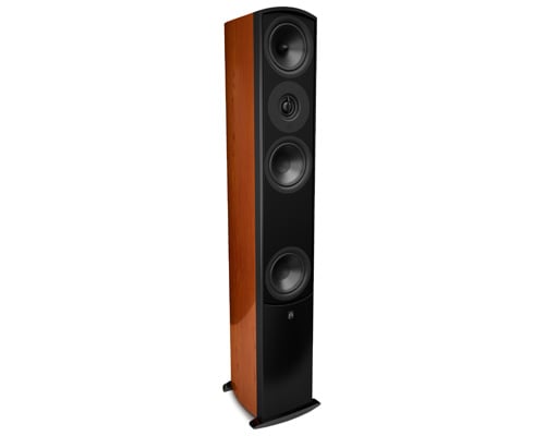

Verus Forte Towers
Frequency Response (+/- 3dB) 53-20,000 Hz -- (+/- 6dB) 47-22,000 Hz
Impedance 6 Ohms
Sensitivity 90 dB
Recommended Power 20 - 300 Watts
Amplifier Power N/A
Tweeter 1" Custom Aperion ASR Tweeter
Midrange 4.25" Woven Kevlar Mid-Range with Aluminum Phase Plug
Woofer Two 4.25" Woven Kevlar Woofers
Driver Configuration 3-Way
Enclosure Type HDF, Ported
Dimensions 35" H x 6" W x 8.25" D
Weight 30 lbs

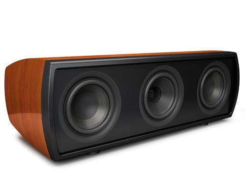

Verus Forte Center
Frequency Response (+/- 3dB) 72-20,000 Hz - (+/- 6dB) 70-22,000 Hz
Impedance 6 Ohms
Sensitivity 85 dB
Recommended Power 40 - 250 Watts
Tweeter Custom Aperion ASR Tweeter
Midrange Custom 4.25" Aperion PhaseSync Driver with Integrated ASR Tweeter
Woofer 4.25" Woven Kevlar Woofer
Driver Configuration 2-Way
Enclosure Type Sealed with One 4.25" Woven Kevlar Passive Radiator
Dimensions 6.2” H x 19” W x 8” D
Weight 15 lbs

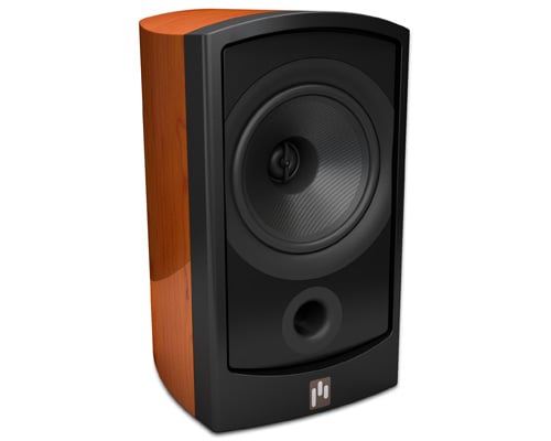

Verus Forte Bookshelf
Frequency Response (+/- 3dB) 80-20,000 Hz - (+/- 6dB) 72-22,000 Hz
Impedance 6 Ohms
Sensitivity 85 dB
Recommended Power 30-150 Watts
Enclosure Type Ported, MDF
Dimensions 9" H x 5" W x 5.7" D
Weight 6.5 lbs

First, with the Towers you may think, as we did at first blush, that they've utilized a D'Appolito MTM design. But look more closely at the picture at the top. this is a true 3-way design with their ASR tweeter, one of their 4.25" midrange drivers with an aluminum phase plug on top, and two 4.25" woofers below. For those that don't remember from the Verus Grand review, the ASR (Axially Stabilized Radiator) silk dome tweeter is one of the main elements that made the Verus Grand speakers such a success. From our Verus Grand review:
The tweeter is a new design from Aperion that is optimized for lower frequency performance. This allows them to cross the tweeter over at a lower frequency which relieves the midrange drivers from having to reproduce frequencies that are notoriously hard for them without the cone "breaking up" or beaming. Aperion does this though a number of innovations. The most obvious is the use of the stabilization bar. This goes across the front of the tweeter and pins the center of it down. On other dome tweeters, the dome is allowed to rock during playback which can cause distortion when playing low. By pinning the center down, this rocking is eliminated allowing the tweeter to play lower without distortion. In addition, most really good dome tweeters are vented in the back into a damped chamber to reduce the pressure on the dome. Aperion also added eight additional vents to relieve the pressure behind the surround. Together, these additions allow the ASR tweeter to play lower (it is crossed over in the tower at 1.8kHz) creating a smoother, more natural off-axis roll off.
Once again they've gone with High Deinsity Fiberboard rather than Medium, a step above the industry standard. The cabinets on all of their speakers are braced and the Bookshelf and Tower Verus Forte speakers are ported (the former in the front, the latter rear ported). The Tower speaker weighs in at a respectible 30 pounds each and they are quite a bit smaller than the Verus Grand at only 6" wide and 8.25" deep. They stand 33" tall. Aperion rates the Verus Forte Towers down to 53Hz at -3dB and 47Hz at -6dB. If our review of the Verus Grand speakers is any indication, their in house measurements will be very similar to your in room performance.
Forte_centerLike the Verus Grand counterpart, the Verus Forte Center is a sealed design for better integration into the vast number of locations center channel speakers end up. This makes placement quite a bit easier. Unlike the Tower speakers in the Verus Forte line, the Bookshelf and Center speaker feature a coaxial driver. This is essentially the marrying of the 4.25" Woven Kevlar mid with aluminum phase plug and their ASR tweeter. Essentially they have replaced the phase plug with the tweeter. This saves space while retaining the same sonic characteristics and off-axis response.
The Center flanks this driver (coined the Aperion PhaseSync Driver with Integrated ASR Tweeter) with a 4.25" Kevlar woofer on each side. But, again, Aperion was tricky. Only one of the drivers is powered, the other is a passive radiator. The Center is 19" wide but only 6.2" high and 8" deep. It tips the scales at half the weight of the Towers at 15 pounds. It has a 2-way design and is rated down to 72Hz at -3dB and 70Hz at -6dB. This essentially means the response drops off steeply after around 75Hz. This is more than enough extension to cross the speaker over at the THX recommended 80Hz.
The Bookshelf uses only the PhaseSync driver and is front ported. It, too, is a 2-way design but the enclosure is MDF instead of HDF like the Towers (the Center channel material wasn't specified but, based on the weight, it is probably HDF). The Verus Forte Bookshelf speaker is an absolutely tiny 9" tall, 5" wide and 5.7" deep and only weights 6.5 pounds. We've seen satellite speakers that are bigger. The Verus Forte Bookshelf is rated down to 80Hz at -3dB and 72hz at -6dB. This may mean you'll want to cross the speaker over a bit higher to make sure you aren't losing anything at that crossover point. While 80Hz is generally considered the threshold for localization, depending on your subwoofer placement, this may or may not be an issue. We encourage you to experiment.
