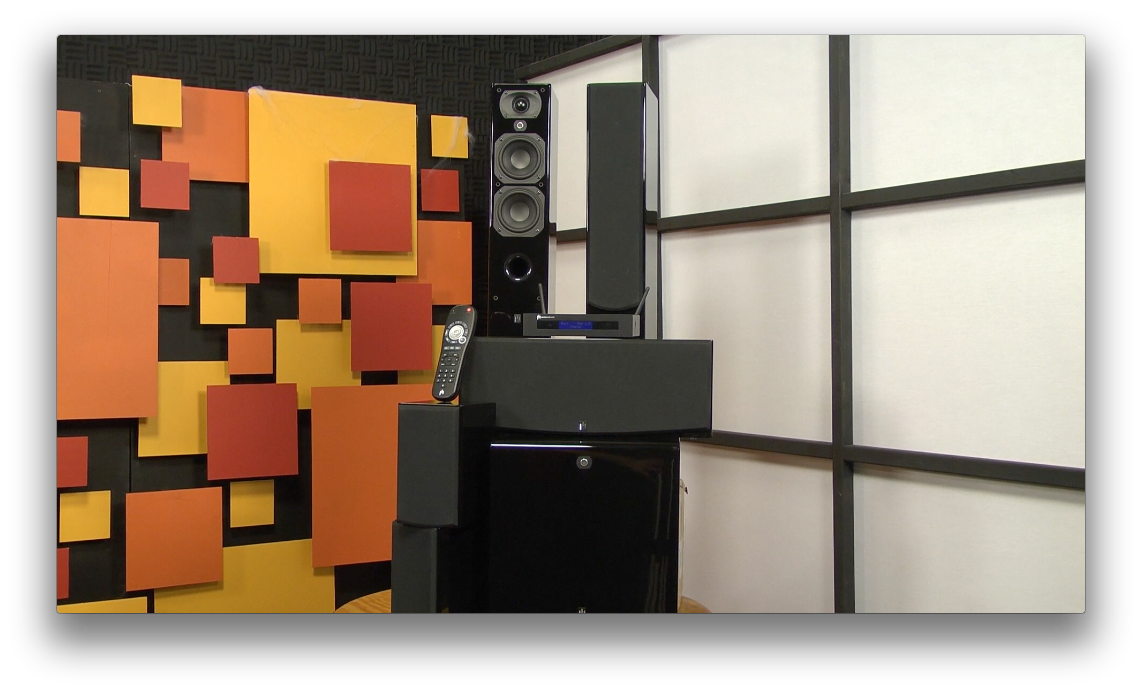

Let me boil this down by going back to what we did with this particular system. First, we plugged all 6 speakers into power outlets. Left, right, center, surrounds and sub. Then we plugged in the Home Theater One Wireless Transmitter and fed it HDMI from our Denon AVR-3312 receiver, passing the HDMI through and on to our Samsung LCD television.
And then we pressed Play. And you know what? Everything worked. We got 7.1 audio from our dts source. Well, almost. When we scanned levels the subwoofer was down at -64dB for some reason, but we raised that up to taste and everything was perfect (and it never dropped down after that). But how did it set itself up?

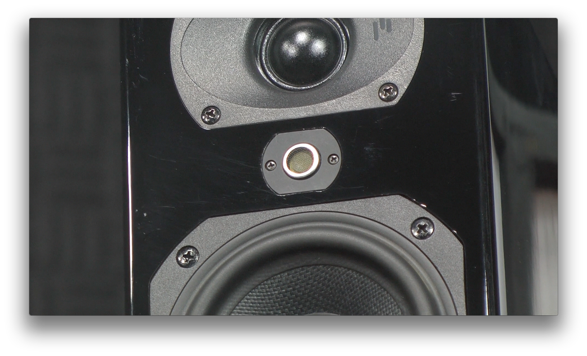

Turns out, Aperion uses a series of 40-kHz ultrasonic chirps that are emitted from tiny transducers built into the front of each speaker - you can see them right on the front if you remove the grilles. These map the location and relative distance of each speaker in the room within 2 inches - including the sub. It then reports this info back to the Home Theater One and maps the correct channel to the speaker as well as sets the level. The entire process takes just a couple of seconds and you're up and running.
Ok, so 5.1 audio and we didn't run a single speaker cable. Thats pretty cool. I mean, you still have to plug in the speakers, but believe me, finding a power outlet nearby always seems to be a lot easier than running speaker wire from the front of the room to the back.

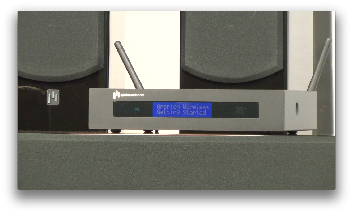

So let's go over the Home Theater One

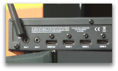

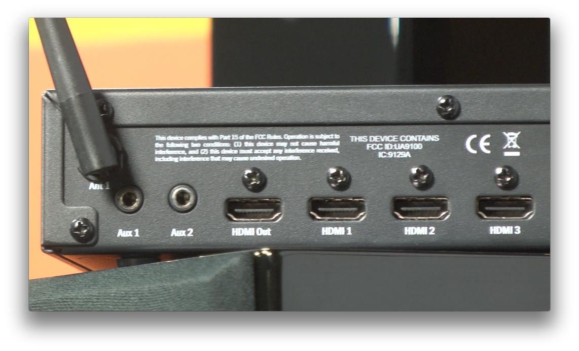

Wireless Transmitter, because it lets you do a few things. On the
back you have 3 HDMI inputs, 1 HDMI output, a coax and an optical
digital input, and even 2 analogue stereo 1/8" inputs. The HT
One is designed to collect all your audio and deliver it to the
speakers. It's basically acting like an AV receiver whose amplifiers
are located at the speakers instead of within the box. Of course if
you already have an AV receiver - that's fine - just send the HDMI
out of your receiver to the input of the HT One - and be sure to set
the HDMI audio on the receiver to "TV" so the HDMI cable
sends audio to the HT One Transmitter.

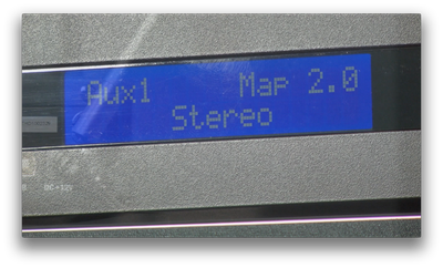

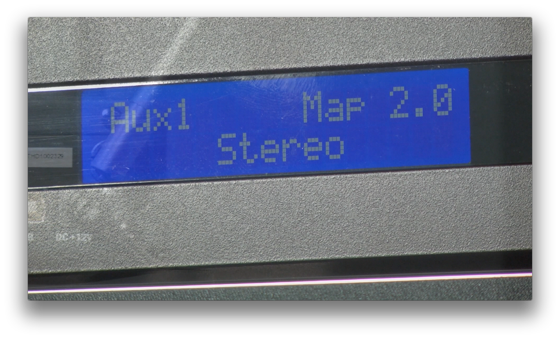

On the front of this box you have a backlit display that shows you the selected input source, the detected speaker map (in our case 5.1 but it will do up to 7.1), and the input signal or surround mode. When we first connected ours, for example, we got dts on the front to show that we were listening to the dts audio from the Eagles: Hell Freezes Over disc.
With the Transmitter and remote you can select the source, change the volume, set each speaker level individually if you want to tweak the system, and even send out test tones to verify the setup is as it should be. We ran tones on the system following its automatic setup and found that the speakers all fell within a couple dB of what we wanted. In either case I think it's a good idea to tweak the results with an SPL meter if you're a perfectionist.

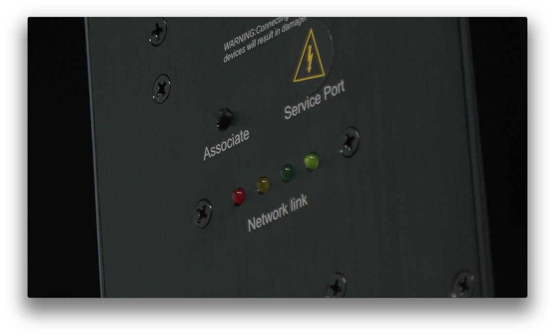

On the back of each speaker is an array of four LEDs. These are status LEDs and they let you know if the speaker is communicating correctly with the system. There's also an 'Associate' button that sets the speaker which will serve as the anchor speaker for the system through which the others connect. Aperion recommends you use the one closest to the subwoofer. Other than that - the speaker is devoid of any binding posts or other connections. I guess it's what's inside that counts.

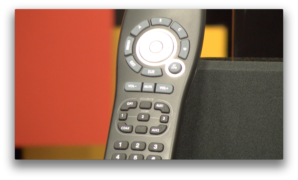

We did notice a few areas where the Aperion Intimus 4T Summit Wireless system could be improved. For one, there's no on-screen display and from across the room that little LCD display is near-impossible to read. Secondly, if you lose the remote you're kinda out of luck, because the HT One lacks any buttons on the front. That means no volume control. Oops! But these are relatively small growing pains for a brand new system like this.
