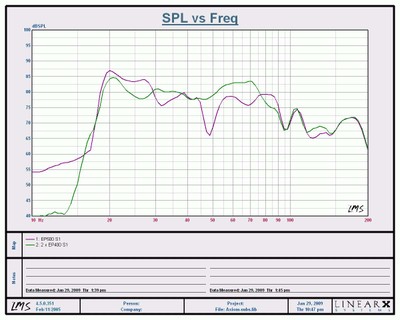

EP400vs500S1
EP500 vs 2 x EP400s at Primary Listening Seat
The purple trace represents the single EP500 while the green trace represents two EP400s. As you can see the dual EP400 response is much more linear across the entire frequency range. Gone is the 10dB suckout centered around 48Hz. This is a fairly narrow suckout with a Q roughly 4.8 so it’s possibly audible and really only fixable with multiple subs rather than EQ’ing. On the downside, some output was lost in the 25-30Hz region going from the EP500 to the 400s but the response was much flatter as well. Looking at the overall response of the EP400s you will notice an in-room bass response of 20Hz to 90Hz +-3dB. Not bad considering no electronic room correction was used to optimize the response.

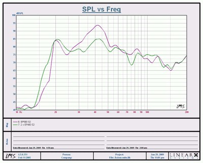

EP500 vs. 2 x EP400s at Secondary Listening Seat
This is the mother-in-law seat we discussed earlier. As you can see in the purple trace, the bass response of a single EP500 at this listening position suffers a huge 12dB low Q (1.7) peak centered around 42Hz. This is clearly audible at that seat and makes the bass sound very boomy and muddy. While this could be tamed a bit with EQ, I’d risk adversely affecting the other seats since it’s a rather drastic problem needing a lot of cutting to resolve. The best solution of course it adding a second subwoofer as can be seen in the green trace via the dual EP400 subs. This response is much better and certainly far easier to optimize via EQ than the purple trace is.

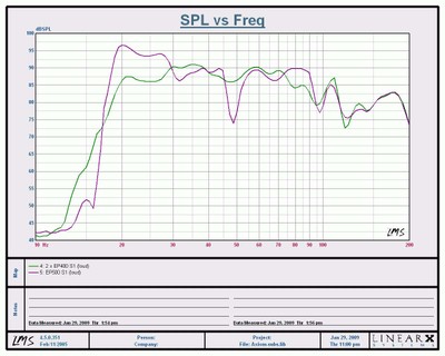

EP400vs500 Loud
EP500 vs. 2 x EP400s at Primary Listening Seat LOUD
I was curious to see how the response between these subs changed at high SPL levels so I turned it up to near house shaking levels in my room. It’s rare we ever listen to higher sustained levels except perhaps during big party events which most of our guests are usually a bit too buzzed to take notice of the bass response. You can see the limiting the EP400 is doing below 28Hz to keep things clean and distortion free. To look at it another way, the bass response is only shelved down 4dB below 28Hz at these high output levels to match the rest of the bass spectrum. This is a very smooth and linear response.
