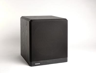

As I unpacked the Velodyne HGS-15X, the first thing I noticed was the Black Ash vinyl wood grain finish. This is a change in the HGS-X line of subwoofers. Velodyne has indicated that this was done to offer a high-end subwoofer at a reasonable cost. I call this "less show and more go". Whatever the reason, the Black Ash finish is tastefully done with no visible seams. The black wood grain vinyl looks like real wood until you examine it very closely. Placing this subwoofer next to my other subwoofer (one with a real wood veneer) you cannot distinguish between the two under normal lighting conditions. I would have no problem incorporating this subwoofer out in the open in a high-end well-furnished room.

The grill that covers the woofer is secured very tightly and takes quite a bit of effort to remove. This is done to prevent unwanted rattles at high SPL levels. On the bottom of the enclosure you will find 4 plastic feet about the size of a quarter. There is no provision for spiked or cone feet. I would have liked to see threaded inserts for aftermarket solutions.
Around the back of the Velodyne HGS-15X is the enormous subwoofer plate amplifier. The Velodyne HGS-15X subwoofer amp has nearly all the inputs, outputs, and control devices that anyone would ever need, including:

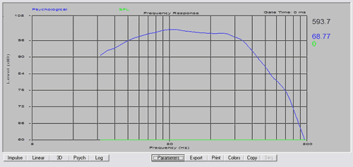

To measure the subwoofer's frequency response I placed the unit outside, set the gain to the THX setting (about 1-4 volume) and bypassed the variable crossover. Using the Rives Audio Pro Test Kit, and placing the microphone at ground level approximately one foot from the woofer cone, I conducted the frequency response and SPL test as shown in the accompanying graph.
As you can see from the frequency response, the Velodyne HGS-15X had very impressive low-end extension with useable high SPL starting at about 18Hz. The frequency response between 25Hz and 150Hz is fairly flat as shown in the below graph , confirming what I heard during the listening evaluation and explaining why the Velodyne HGS-15-X was able to integrate seamlessly and smoothly with my main speakers when crossed over at 80Hz.
The frequency response graph and charted SPL levels show that this subwoofer can play ridiculously low frequencies with high SPL 舗 s and have a very flat response between 25Hz and 150Hz +-3dB. Low, loud and smooth equate to an audiophile subwoofer with slam.
