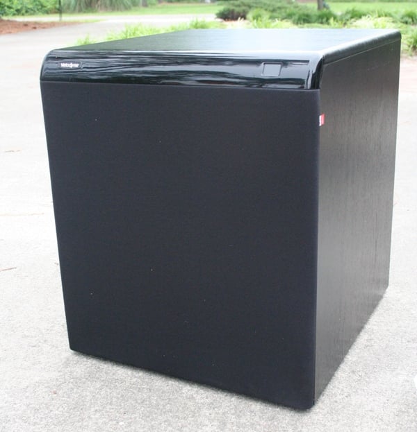

DEQ-R_grillon.JPGThis is one of those rare reviews that doesn't involve an official review unit from a manufacturer. In this case, my parents needed a subwoofer. If you remember, about a year ago I did a review of The Speaker Company NTIW25 and NTIW26 in-wall speakers. This was conducted at my parent's home and at the conclusion of the review, I had all of about 30 minutes to do listening tests before their sub died. Well, it's a year later and they still don't have a working sub. As I visit once a year, they decided to buy one so that I can help install/calibrate it during my visit. So off I went scouring the Internet for a deal on a sub that I could be proud of. In no small way, my parent's system is a reflection of me as I'm the one that picks/installs all their speakers. The tSc speakers have been performing well and my parents have been thrilled with them, now I just had to find a sub up to the task.
Of course, one of the first names I came up with was Velodyne. I went searching and found out that their DEQ-R series was on sale over at the Audioholics store so I did some research. While I loved the prices of the Chrysalis line (which is basically a lower cost Velodyne), I knew that my parent's room has problems. It has carpet and a fluffy couch but that is about it. The walls are at angles, there is an alcove that rings so bad that you sound like a Cylon when you talk in it, and room treatments have been vetoed. Any little bit of EQ my parents could get would help. The Chrysalis subs didn’t offer a model with an EQ so that was out.

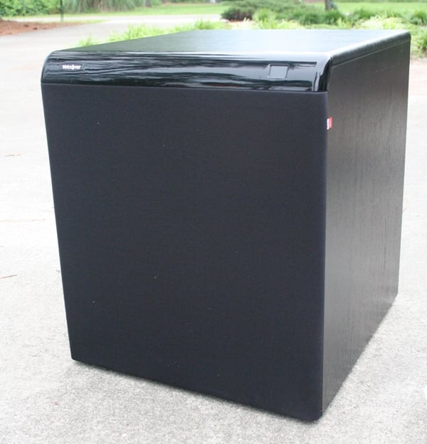

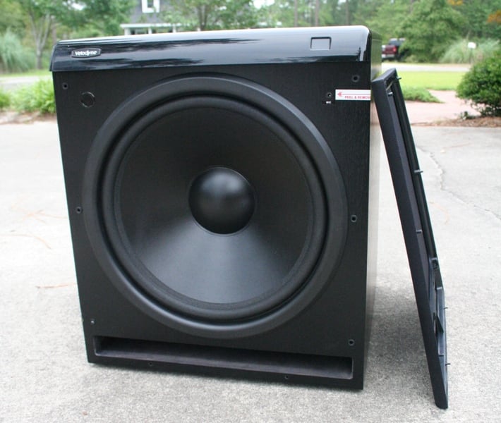

DEQ-R_grilloff.JPGWhat immediately drew my attention was the DEQ line. With it's automatic 5-band EQ, we have a product that has all the functionality of the similarly priced DLS-R line but without the gloss black finish. As I value an EQ over a finish any day of the week (especially in this application as you'll see), I was definitely interested in the DEQ. Generally speaking with subwoofers you either need a big enclosure or a big amp. Velodyne has a few offerings that have the latter with boxes that are barely bigger than the driver. These subs tend to have slightly less extension than their larger counterparts. I contacted my parents and asked if they wanted a smaller sub or one that went lower. I also asked how much they cared about the appearance of the sub. They had decided that the sub would go on the right side of the room and would be obscured by the couch (which is in an L shape) so they didn't care about the size or the looks as long as it fit in the space and wouldn't be visible (i.e. too tall). A few quick measurements later and we quickly determined that any of the DEQ line would work as long as their budget allowed.
The DEQ-R line of subs has 8, 10, 12, and 15 inch woofers. The boxes of course increase in size/weight with the driver size. After a bit of discussion, we decided that either the 12" or 15" would work. The price was right for the DEQ-15R (they were on sale for $750, at the time of this writing they were going for $850) which was only about $100 more than the 12. At this price point, my parents decided to go with the "big boy" and bought the DEQ-15R. I have to say, I felt an emotion akin to the pride you feel when your son rides his two-wheel bike for the first time at the news.

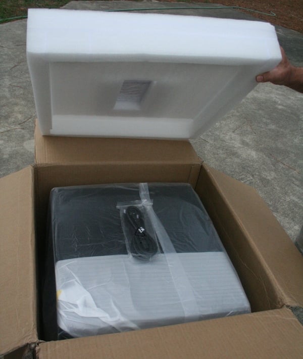

DEQ-R_inbox.JPGThe only problem we were up against was time. The sub wasn't going to arrive until the last day of my visit. So I had to do the measurements and listening tests in a very short period of time. As you might predict, UPS took their sweet time delivering the sub which arrived after 6pm. Not only that, but they had beat up the box pretty good. Velodyne packs their subs fairly well with foam endcaps and double boxing but UPS had managed to mishandle the boxes so badly that they had dinged up the edges and one of the corners and even broke off one of the grills posts. I've spoken to the managers of the Audioholics Store and they have decided (based on this experience) to reinforce the edges of all larger subwoofers like the DEQ-15R from now on to ensure that others don't have a similar experience. This should eliminate any such incidents in the future. While the sub would have been covered under the UPS insurance, anyone that has had dealings with submitting a claim knows how long it can take. For a little extra expense on the Audioholic's store's part they will save you that hassle.

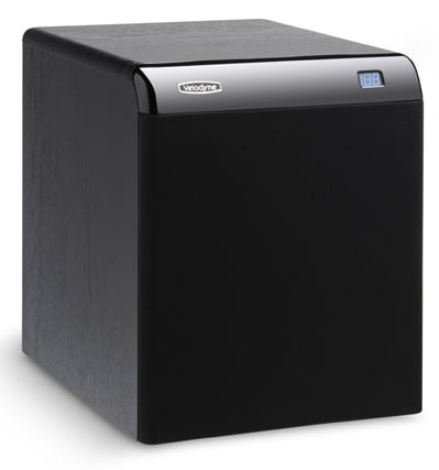

DEQ-R_post.JPGThe sub itself is substantial in size but not overly so. I actually expected something quite a bit bigger. After experiences with online subwoofer manufacturers, I guess I'm used to seeing subs that are the size of coffee tables or cribs. Anything smaller than that ordered online is sort of a welcome surprise. The DEQ-15R measures 21" x 18.375” x 20.75”. The sub fit perfectly in the space provided and my parents were very happy with the size. From the front of the sub, you see a gloss black plate at the top with the digital readout and grill. The grill posts were disappointingly small and, as I often find with grills of this size, it felt flimsy. The only real workaround for this is a grill constructed out of MDF instead of plastic but at this price point, you are really paying for the electronics and driver.

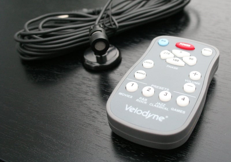

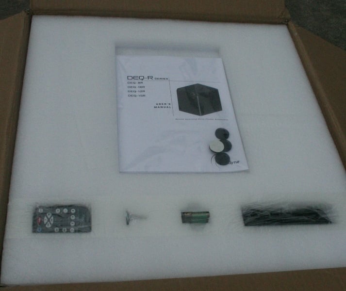

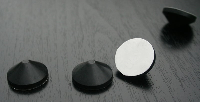

DEQ-R_feet.JPGThere are no threaded inserts for feet. The provided rubber feet are conical with a sticky bottom. The sub comes with a remote, a power cord, a mic and a mic stand, and directions. There is a slot-style port just below the huge 15" driver. Behind the grill on the top left of the front baffle is an IR receiver while the top left has a mic input. The amp sports most of the things you'd expect including low pass crossover dial (40-120Hz), RCA inputs and outputs, and line level inputs and outputs. Conspicuously absent is a volume dial which is replaced with volume up and down buttons. There is no phase control on the amp backplate as that is digitally controlled. One thing I think all subs should have is a ground lift. While I didn't have any problems with a ground loop, subwoofers are notorious for introducing such problems and I think that a ground lift should be standard equipment on all subs. The DEQ doesn't have one.

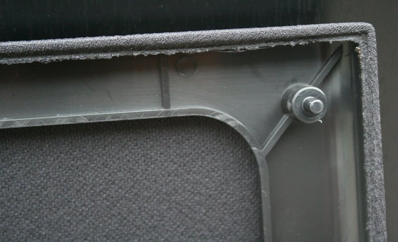

Usually, this is the portion of the review where I post all the internal pics and tell you how well the DEQ-15R was constructed. Unfortunately, I ran into two problems. The first was that there was a plastic cover over the screws securing the driver to the enclosure. It did not give under my gentle probing and frankly I wasn't going to push it as this was my parent's sub and I didn't want to break it. While I could have probably gotten around this (removing the amp for example), I ran into my second and more serious problem - time. The sub arrived after 6pm and my kids go to bed at 8pm. When we visit my parents I sleep in the home theater room (apropos don't you think?) so I literally had less than two hours to unpack, measure, setup, and calibrate the sub. That didn't leave much time for listening tests much less taking apart the sub. Something had to give. I did do a knock test and it was about what you'd expect at this price point from a company like Velodyne - somewhat more inert than you'd imagine for its size but there definitely could be more bracing in there.

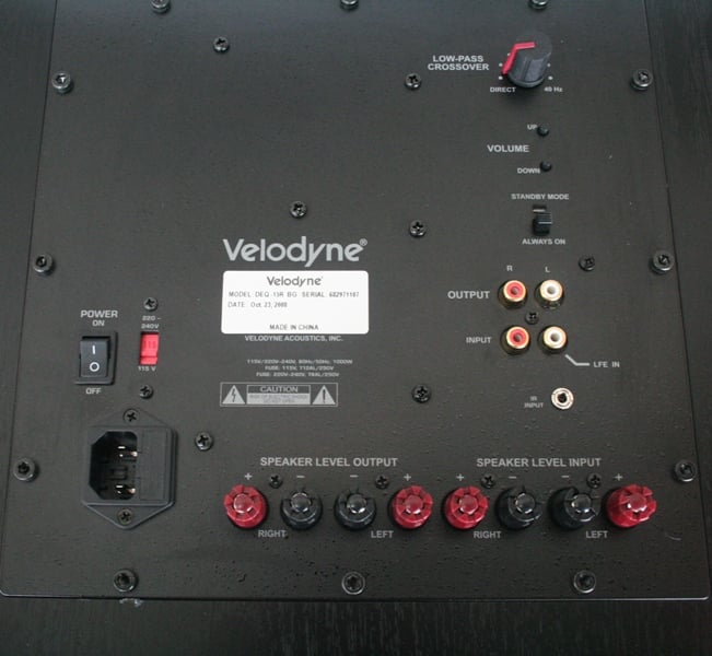

DEQ-R_back.JPGSetting up the sub really was a breeze. The DEQ-15R comes with a remote which is a nice feature that I wouldn't mind seeing with more subwoofers. There is a three character digital readout on the top right of the front of the sub that will tell you the volume or display other messages. You can turn off the display if you like. Unlike many subs with just a 0/180 degree phase switch, the DEQ sports a 0/90/180/270 degree digital phase adjustment. This can really help out with how well your sub integrates with your speakers and is something that all new users should play with. There are four DSP settings with the default being Jazz. These settings modify the frequency response of the sub as detailed below:

Of course, after level matching, the only thing left to do was to set up the Auto EQ. This really is as easy as pie (microwave pie even) as all you need to do is plug in the mic into the front port, set it up at your prime listening position, the hold down the EQ button for a few seconds. The sub does a dozen 20Hz to 150Hz sweeps while displaying "AU" on the screen. Afterwards, the EQ is always engaged. There is a way to reset the sub to flat through a combination of button pushes if you like. What was especially thoughtful was that if the mic is not plugged in, the sub will cancel the EQ function after two sweeps so you don't have to worry about someone accidentally resetting your sub calibration. After I EQ'ed the sub, I re-checked the level with my SPL meter but didn't find that it needed an adjustment. I'm not sure this wasn't just luck on my part so I'd re-check your levels after you EQ your sub.

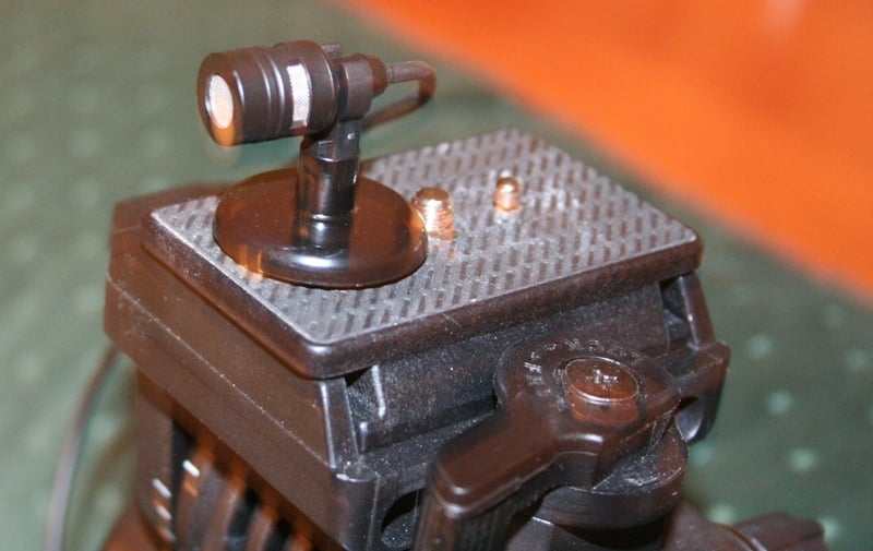

DEQ-R_micStand.JPGFrom an ease of use standpoint, the Auto EQ function is the tops. The little mic stand looks like it would fall over easily but it is very solid and quite heavy in comparison to the mic. I placed it on top of a camera tripod at the prime listening position and had no problems. The only downside is that you have no idea what the Auto EQ is doing. None. From an Audioholic standpoint, I find this unnerving. If nothing else, I'd like Velodyne to include in the manual some information about the limits of the 5-band parametric EQ and some limited control. In particular, I'd like to know or be able to limit how much boosting the sub is doing. The official Audioholics policy is NEVER to boost problemantic dips unless it reveals a measurably beneficial difference. Even then, boosting should be kept to a minimum to preserve dynamic range of the system. As the Auto EQ functions on the DEQ subs, you have no idea what it is doing. You just have to trust that it is doing something good using your ears as the deciding factor. Of course measuring the results with an audio analyzer is recommended if you have the means.

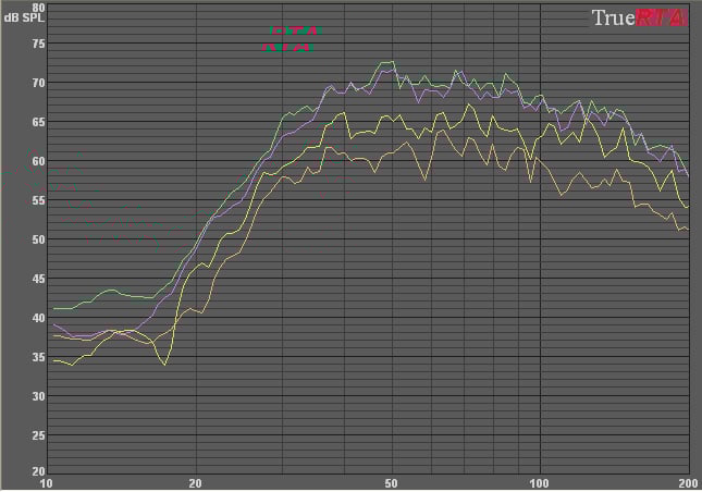

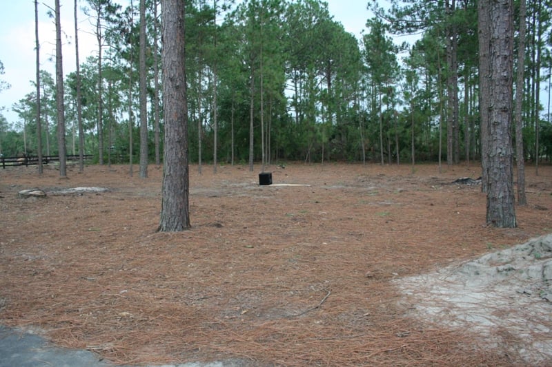

DEQ-R_outside.JPGFor laboratory measurements I used the Sencore SP395A FFT Audio Analyzer plugged directly into the internal amps Velodyne DEQ-15R subwoofer along with TrueRTA. I took the sub outside and did a groundplane measurement at one meter and 1/24th resolution. This was conducted in the middle of a field that had been recently devastated by a microburst. The sub was left to its default preset (Jazz) which offers the flattest frequency response. The other presets were not tested.
Velodyne DEQ-15R Subwoofer Groudplane Measurement 1 Meter (no smoothing)
Note: Not the actual output  levels - graph shows bandwidth linearity only
The green trace is the sub at maximum output (80), purple is at 70, yellow at 60, orange at 50. While it is obvious that the sub's volume is not increasing significantly between 70 and 80, the Distortion Limiting System is working as there seems to be no real distortion in the waveform and I could hear none during the tests. I actually kept trying to turn the sub up (in true Spinal Tap fashion) listening for distortion. While the sub is spec'ed down to 23Hz anechoic and 14Hz in room, I'm not seeing that here. The sub seems to be reaching down to about 27-30Hz fairly flatly and dropping off significantly after that. If my time wasn't limited, I might have run tests on the other presets or more importantly, taken the sub into the house, EQ'ed it, and brought it back out for more measurements. Unfortunately, that wasn't possible.
