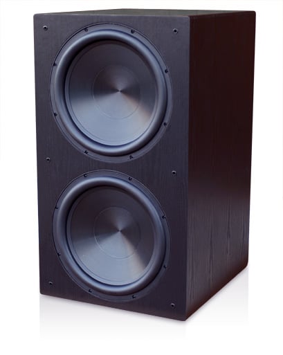

When looking at subwoofers, there is very much a "go big or go home" mentality. We like to harp on Internet direct brands for this but honestly, many high end subs suffer from the same syndrome. This is caused, mostly by physics. It is just not possible to hit those extremely low notes without a big box with big drivers. The question is how to build such a behemoth in such a way that it provides the impact and extension the customer wants without getting the customer divorced in the process.
One of the current trends we're seeing in subs, specifically Internet direct subs, is building up rather than out. In the past it wasn't uncommon to see a wide, thin, short sub that was designed to be placed along a wall or behind a couch. Since we know that it is usually much better to place them away from corners and walls, this design has, thankfully, fallen out of favor. Now, the small footprint is the new "in" thing and frankly, we like it. The wife might not know why you need another floorstanding speaker but she will more readily accept it than a coffee table sized sub you have to hide behind a piano.
Rythmik Audio has developed a new servo sub that attempts to fulfill the new trend for a small footprint will still giving you the bass you want. The F25 is a diminutive 140 pounds shipped (yikes, better get a few friends, some beer, and an extra large pizza when it's time to set that badboy up) but is only 19" wide and 21" deep. While the footprint is quite a bit larger than your standard floorstanding speaker, it isn't as large as many of the subs that claim the bass response of the F25. At 33" tall, there is quite a bit "up" to this sub which gives it plenty of room for the dual 15" drivers.
That's right, two of them.

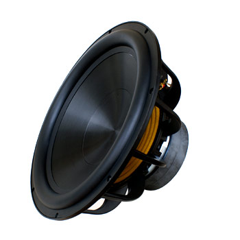

F25_driverThe Rythmik Audio F25 claims a frequency response down to 14Hz at just -2dB. That's pretty impressive (heck that's REALLY impressive). They do this through a combination of a big, heavy box, huge drivers and technology. The box is not ported, is internally braced, and has a front baffle that is twice as thick as the other walls (most likely because of the dual the drivers). The box comes in walnut or black ash vinyl veneers or you can opt for the high gloss piano black signature edition for a premium though the pricing on that has yet to be listed. As mentioned, the F25 utilizes two 15" black anodized aluminum coned woofers with rubber surrounds. The drivers are designed for high excursion, have cast aluminum baskets, and are forward firing. The class H amp behind the drivers is pumping out 600 watts and is servo controlled.
Here we get into the technology side. A servo sub uses a feedback mechanism by which the movement of the cone is compared to the original signal. If there are any differences, the signal fed to the driver is modified so that the cone is reproducing the sound intended. While other servo mechanisms rely on an accelerometer, the Rythmik system is direct feedback so that the measurements and adjustments are happening simultaneously with the cone movement. This, according to Rythmik, equates to zero latency between sound reproduction and correction.
