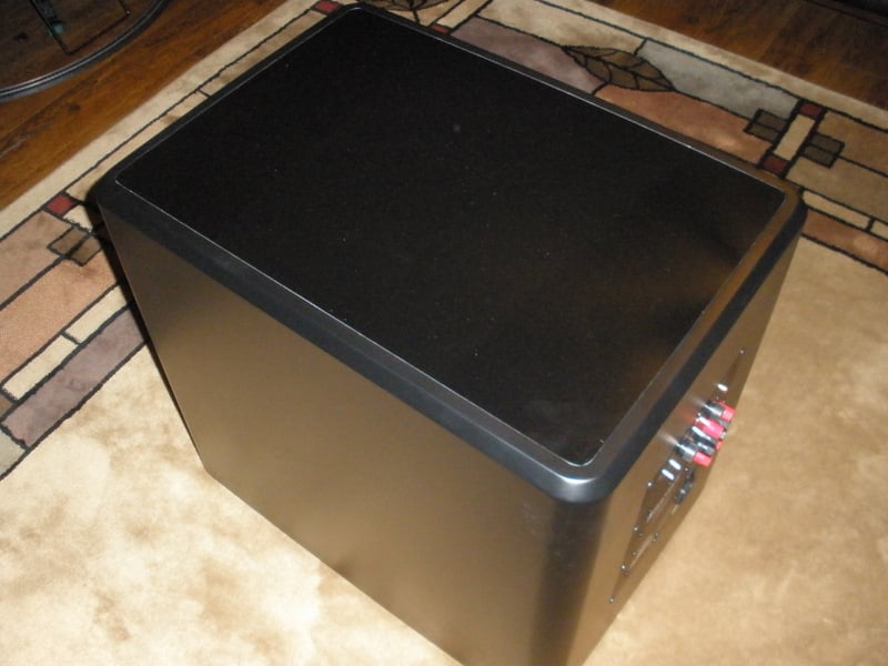

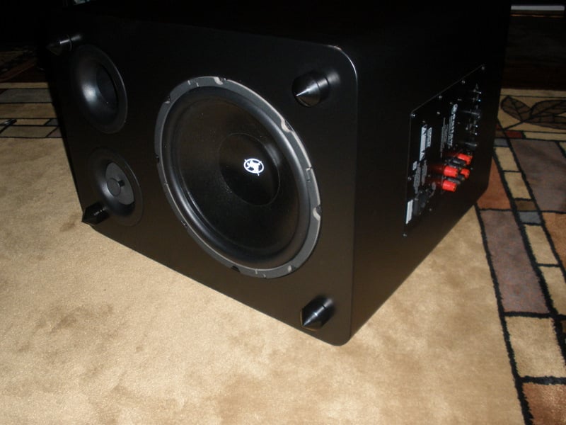

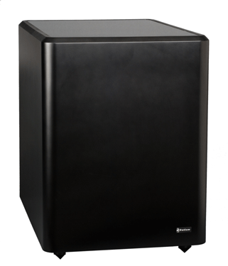

The LFM-1 EX is what I would consider to be an average to large size for a consumer level powered subwoofer. At 80lbs it is no lightweight but not what I would consider a back breaker either. The finish is a nice flat black which is not reflective. The glass top was covered with a peel off protective sticker which reveals a very nice looking, glossy and deep black color when removed. The cabinet corners are each rounded off with a large radius and the floor spikes are very large, heavy and high quality units. The unit has no grill since both ports and the driver are all down firing. The total package is a rather good looking affair in my estimation. I had no troubles moving the LFM-1-EX by myself but the floor spikes will mark any hard surface if you are not careful.
Design Overview
Outlaw’s LFM-1 EX is a
bass reflex design utilizing a single 12” driver and two 3” flared ports in a
down firing configuration. The system can be configured for a 25Hz tune with
both ports open, or an 18Hz tuning with one port blocked via the supplied port
plug. There is a switch on the amplifier which operates the necessary high pass
filter for each tuning.

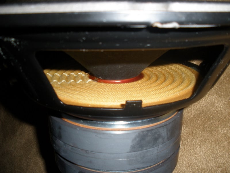

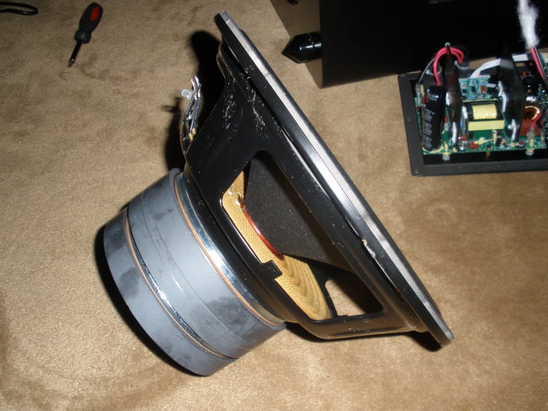

After pulling the driver out of the enclosure to examine it further it could be seen that it was a well built and substantial unit but of moderate cost. The 12” driver is built on a stamped steel frame and a good sized motor of roughly 6” in diameter with dual stacked ferrite magnets. The back plate is bumped and has a small pole vent with a screen to prevent debris from entering the gap. The cone appears to be pressed and coated paper attached to a 2” diameter voice coil and former. The suspension consists of what appears to be a 6” diameter single spider and a rubber half roll surround. Interestingly the motor also has a large bucking magnet attached to the back of it for magnetic shielding purposes. This is increasingly less of a concern since CRT televisions are becoming much less common. The driver is of a very humble pedigree and built of unassuming components but is not out of character for a subwoofer in this price range and appears to do the job well, which is what matters.
The BASH amplifier is rated for 350 watts. The literature also makes mention of the amplifier being capable of reaching peaks of 1300 watts but this seems to be a nebulous claim at best. In any event most other manufacturers do not list peak power of their amplifiers any more for comparison. As with most BASH designs this is a relatively simply constructed and very lightweight unit. There was no internal heat sinking other than the large aluminum faceplate of the amplifier. Two large reserve capacitors were in evidence.

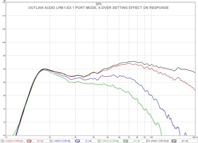

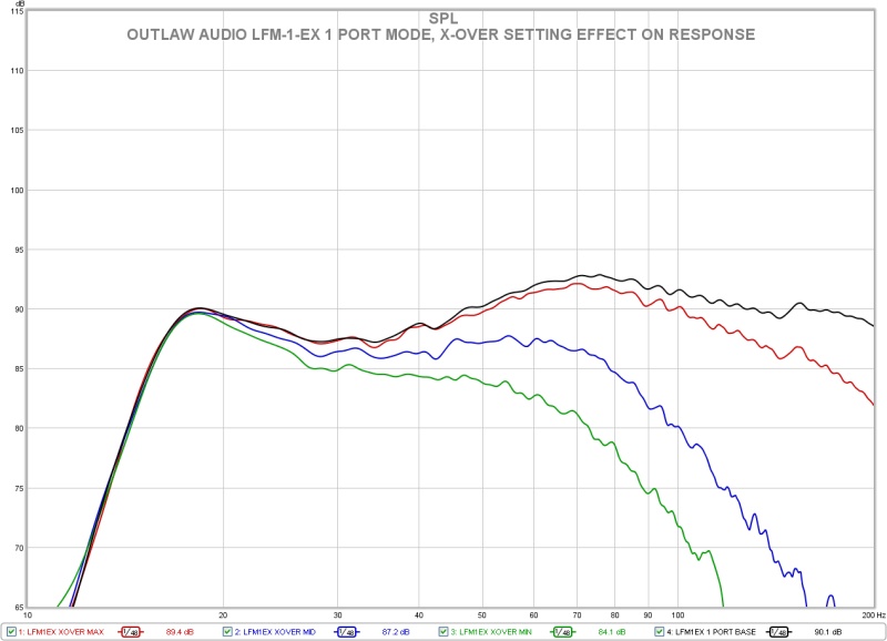

Outlaw LFM-1 EX: Effect of Low Pass Filter Settings
A measurement was taken of the LFM-1-EX with the low pass crossover bypassed using the LFE input and at its maximum, middle and minimum settings to observe its effect on the response shape. This is presented in the graph above.

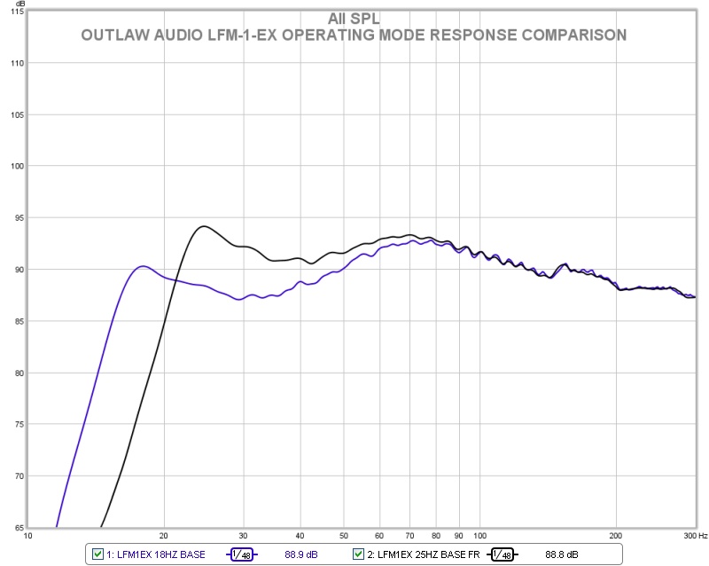

Outlaw LFM-1 EX: Basic Frequency Response as Tested
The responses above are of the LFM-1-EX with the low pass crossover bypassed and configured in both extension modes. In the 2 ports open configuration the response is within +/-3dB from 21-270Hz. In the 1 port open 18Hz configuration the LFM-1 EX was within a +/-3dB or 6dB total window from 16-300Hz. Outlaw specs their response within a +/-2dB window. Technically the measurements don’t quite meet Outlaw’s spec due to the tighter than normal window but there could easily be differences in the measurement methodology that caused the difference. Regardless the LFM-1 EX exhibits very wide bandwidth and uniform response regardless of the extension configuration. The extended upper range response above 100Hz mean that the LFM-1 EX could probably effectively be crossed over to small mains above 200Hz if necessary, but it would be best to use a transition point of 140Hz or lower. These response shapes are at the base starting drive level used for testing which is referenced to 90dB at 2 meters from the microphone at 50Hz. At higher levels the output will compress and the response shape deviates.
One thing to note here is that the LFM-1 EX appears to be slightly mistuned as evidenced by the slight amount of peaking at the port tuning. This indicates that the subwoofer could use either a little less enclosure volume for this tuning which would lower the efficiency at port tuning flattening out the peak. This would in turn require longer ports to achieve the same tuning range, or that the driver attributes could be tweaked a little to compensate. Conversely a small amount of EQ or perhaps moving the rumble filter up slightly higher in frequency could flatten this out.

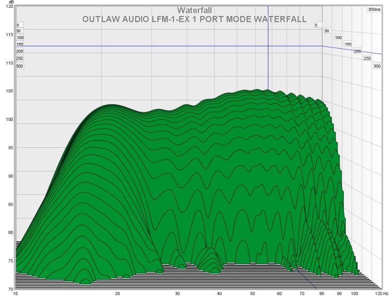

Outlaw LFM-1 EX 1 Port mode: Waterfall Decay

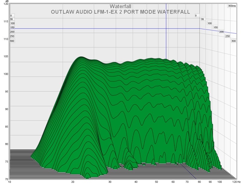

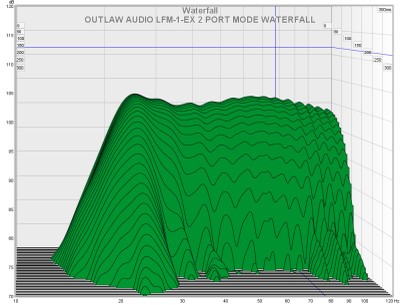

Outlaw LFM-1 EX 2 Ports mode: Waterfall Decay

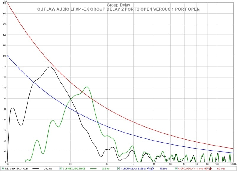

Outlaw LFM-1 EX: Group Delay Both Extension Modes
The waterfall and group delay plots for the LFM-1 EX are good for the most part but exhibit some ringing or delayed energy release near the tuning point of the ports. The group delay exceeds 1.5 cycles briefly near 24Hz while the deeper extending 1 port open mode never exceeds 1.5 cycles. This is typical for bass reflex alignments utilizing steep high pass filters at or below tuning.

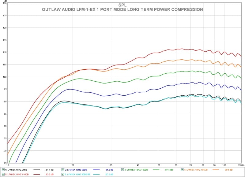

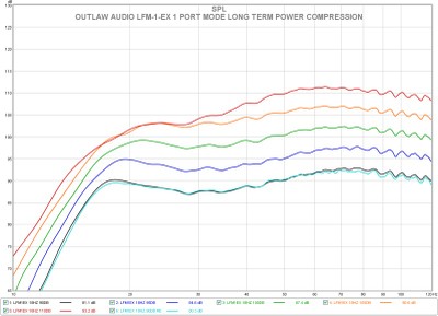

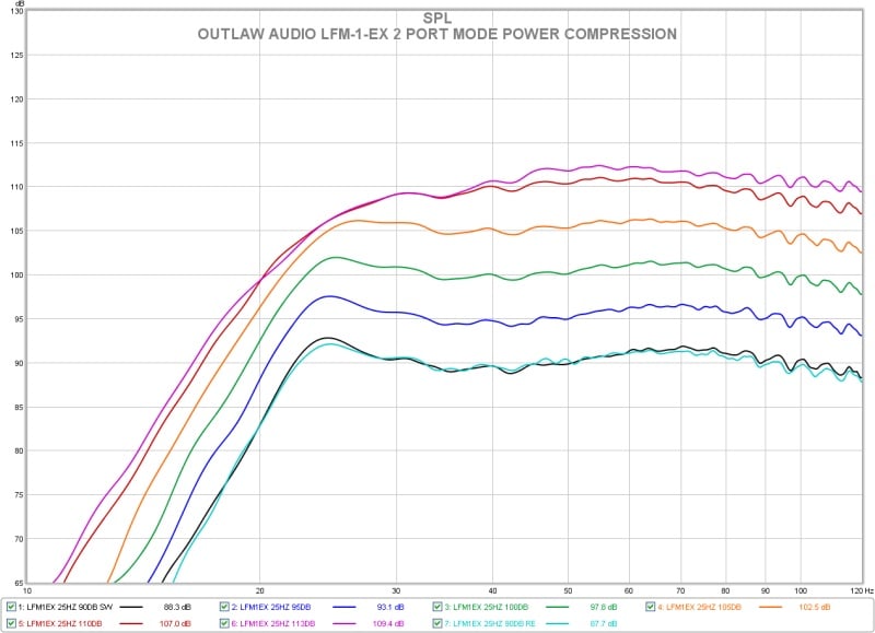

Outlaw LFM-1 EX 1 Port Mode: Long Term Power Compression
Outlaw LFM-1 EX 2 Ports Mode: Long Term Power Compression
The long term power compression sweeps indicate that the LFM-1 EX does a decent job of maintaining its response shape in both one port open and two ports open operation. The compression in both instances appears to be largely related to overloading of the ports at the level that the sweeps were stopped. The LFM-1 EX exhibits much less overall compression in two ports mode than in one port mode. Likely due to the larger vent area, but the last two sweep levels still exhibit notable vent compression with both ports open. This is normal to see in most ported subwoofers. The LFM-1 EX did exhibit some distress noises and vent chuffing especially in one port mode at which point the sweep level was capped at 110dB. I also noted what may have been some cabinet or panel vibration on the loudest sweeps. With both ports open the LFM-1 EX was able to complete a nominally 113dB sweep level. Looking at the maximum output levels attained the LFM-1 EX exhibits good bandwidth uniformity maintaining a 6dB total response window from 25-120Hz in two ports open operation and in one port open mode a 10dB total response window is maintained from 19.5-120Hz.

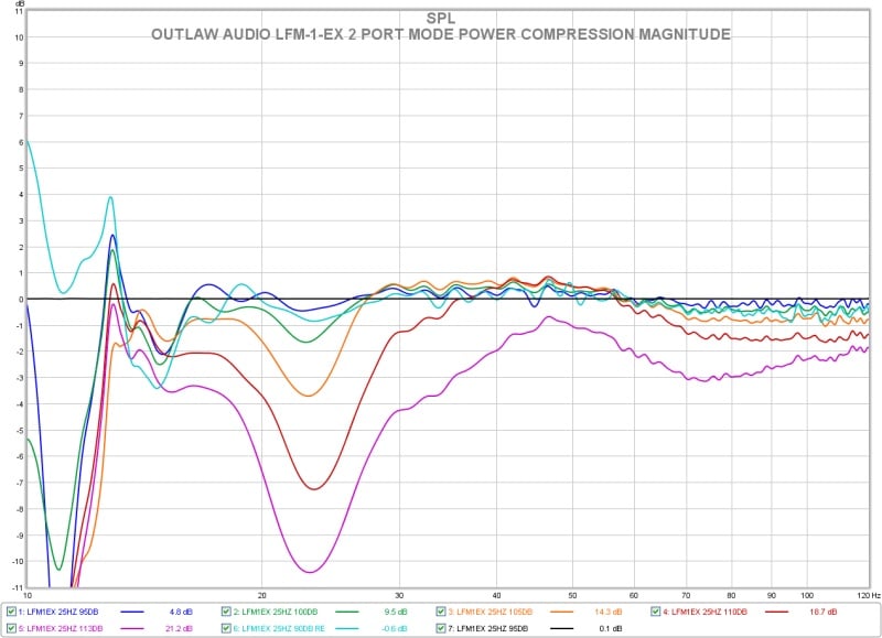

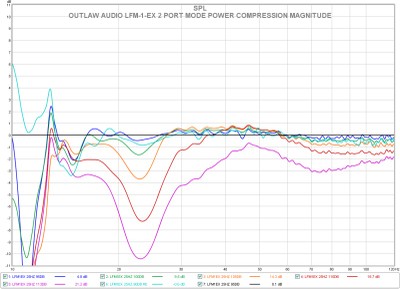

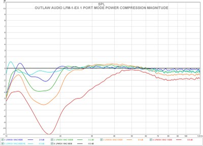

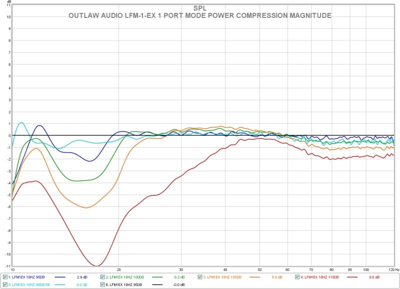

Outlaw LFM-1 EX 1 Port Mode: Power Compression Magnitude
Outlaw LFM-1 EX 2 Ports Mode: Power Compression Magnitude
Looking at the amount of compression exhibited only it can be seen that the LFM-1 EX performs very well above 40Hz even at an 110dB sweep level. The compression is centered at the port tuning and the amount of compression due to the ports starts to get significant at the 105dB sweep level and higher.

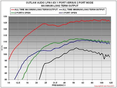

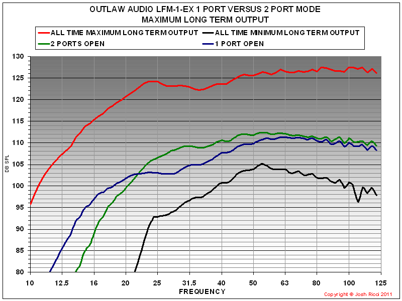

Outlaw LFM-1 EX: Maximum Long Term Output Level
The maximum long term output achieved by the LFM-1 EX during output compression testing is in the middle range of all subwoofers tested historically. This is a solid performance in light of the size and cost of the unit. Operating with two ports open the LFM-1 EX has slightly higher output everywhere above about 23Hz. The output advantage belongs to the one port mode in the deepest bass frequencies as expected.

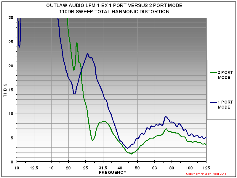

Outlaw LFM-1 EX: 1 Port and 2 Ports Mode 110dB Sweep THD Comparison
The total harmonic distortion results for the LFM-1 EX in both extension modes driven at the nominally 110dB sweep level are presented above. Overall the performance here is good. Distortion above 30Hz is under control for one port operation. With both ports open the THD level does not reach 10% until almost 25Hz which is a nice result.

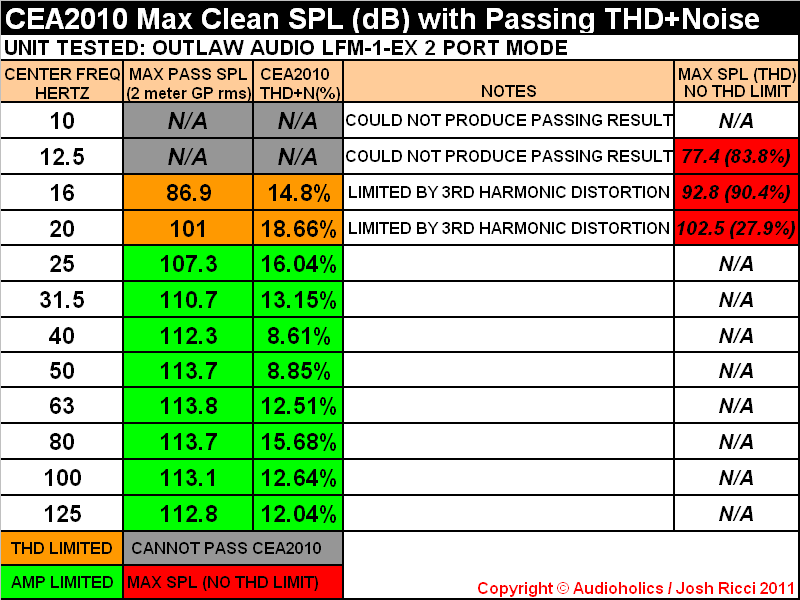

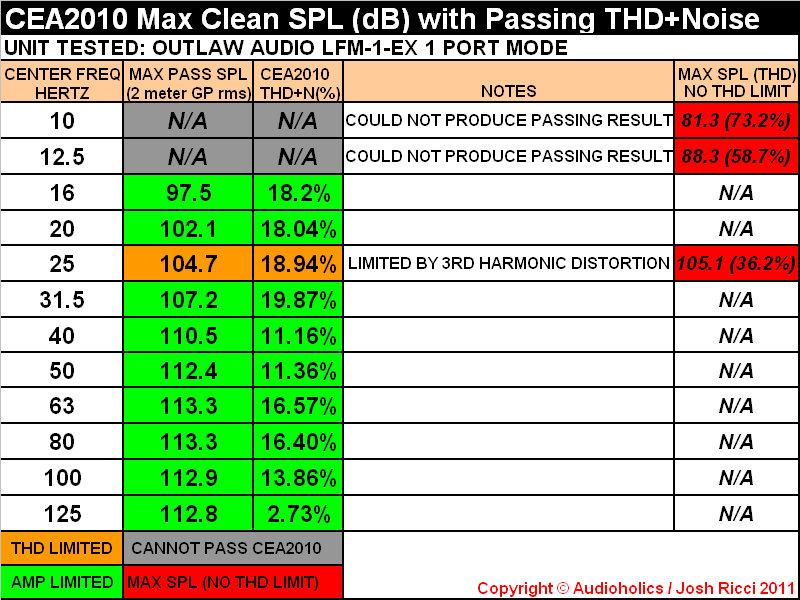

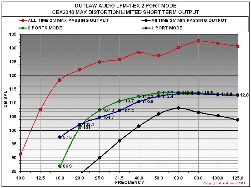

Outlaw LFM-1 EX 1 Port Mode: CEA2010 2 Meter Groundplane RMS Results
Outlaw LFM-1 EX 2 Ports Mode: CEA2010 2 Meter Groundplane RMS Results
Outlaw LFM-1 EX: CEA2010 2 Meter Groundplane RMS Comparison 1 Port and 2 Ports Mode
CEA2010 Results
The CEA2010 maximum passing results for the LFM-1 EX show it to be in the middle range of all subwoofers that have been tested to date. In two ports open mode it has slightly higher maximum output above 20Hz and is effectively amplifier limited at 25Hz and above. In single port operation the LFM-1 EX has slightly lower overall maximum output but trades that off for higher output at 20Hz and below, recording a passing output of 97.5dB at 16Hz which is impressive. The LFM-1 EX is effectively amplifier limited at 16Hz and above in one port mode having only an extra 0.4dB of output past its maximum passing SPL at 25Hz. Overall bandwidth uniformity is +/-3dB from the 125 to the 31.5Hz band in both modes of operation which is quite good. From 20-125Hz the maximum passing output fits within a +/-5.6dB window in one port operation and within a +/-6.4dB for two ports open operation over the same range.
